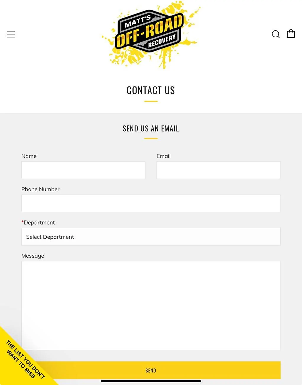

If you didn’t do a diff drop, you should keep this handy…
