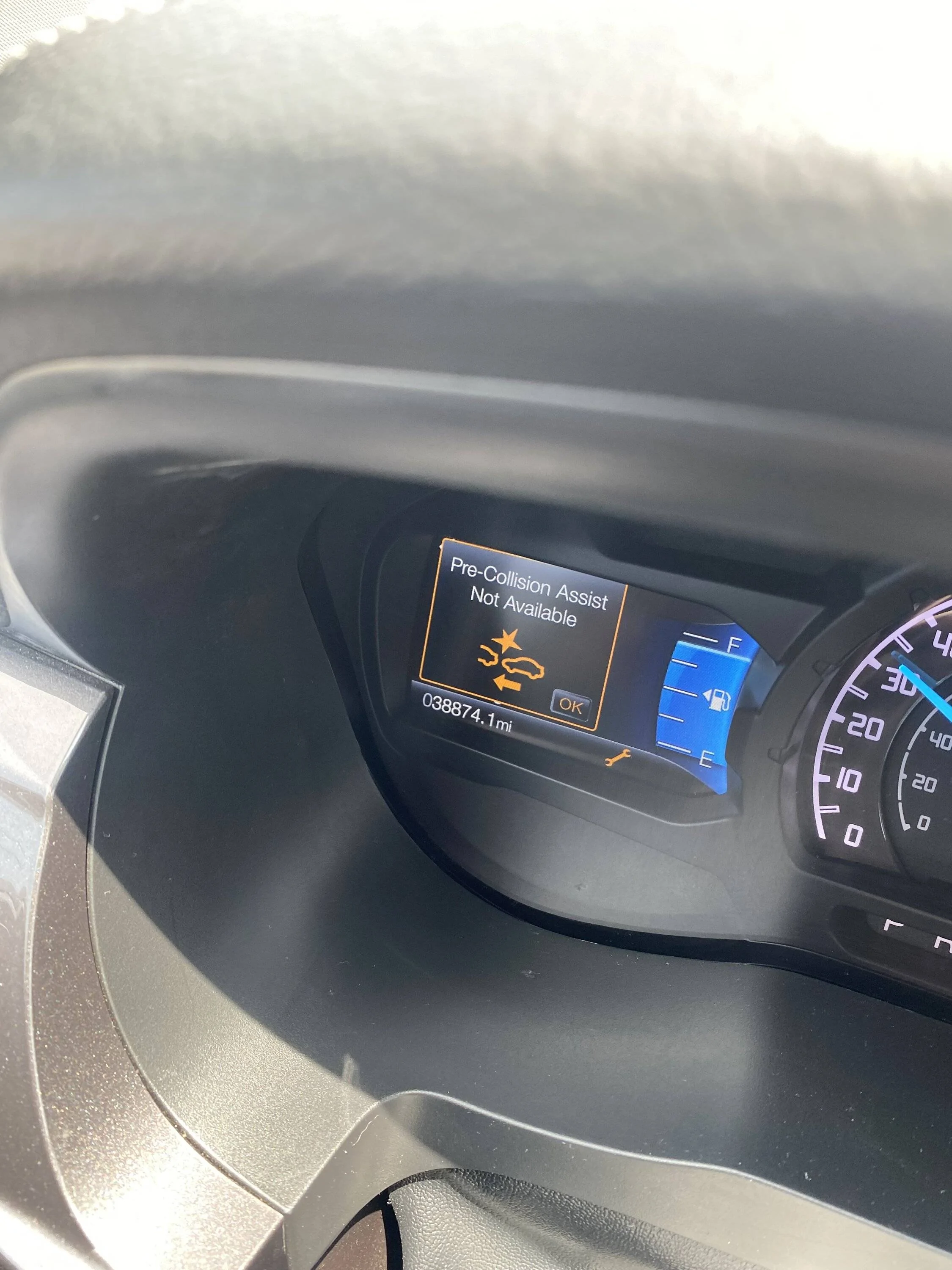

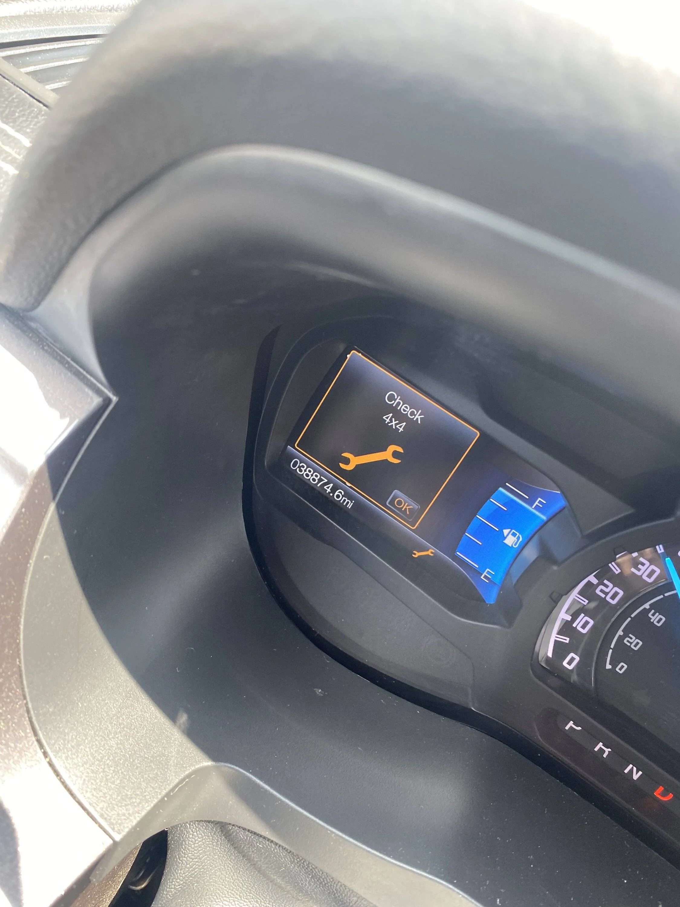

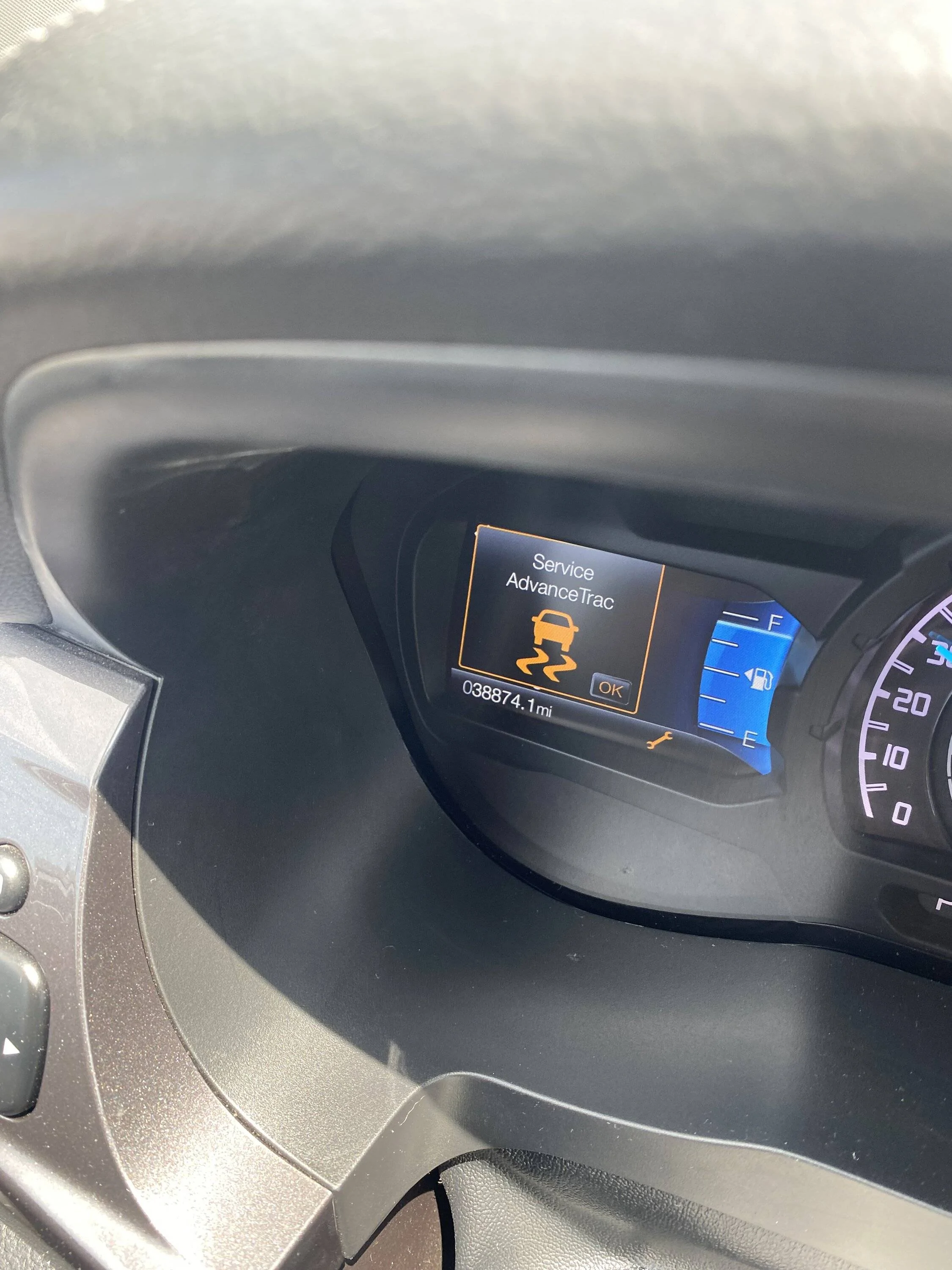

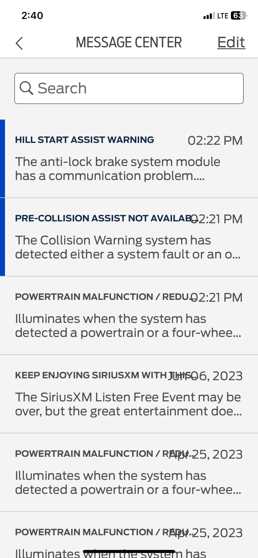

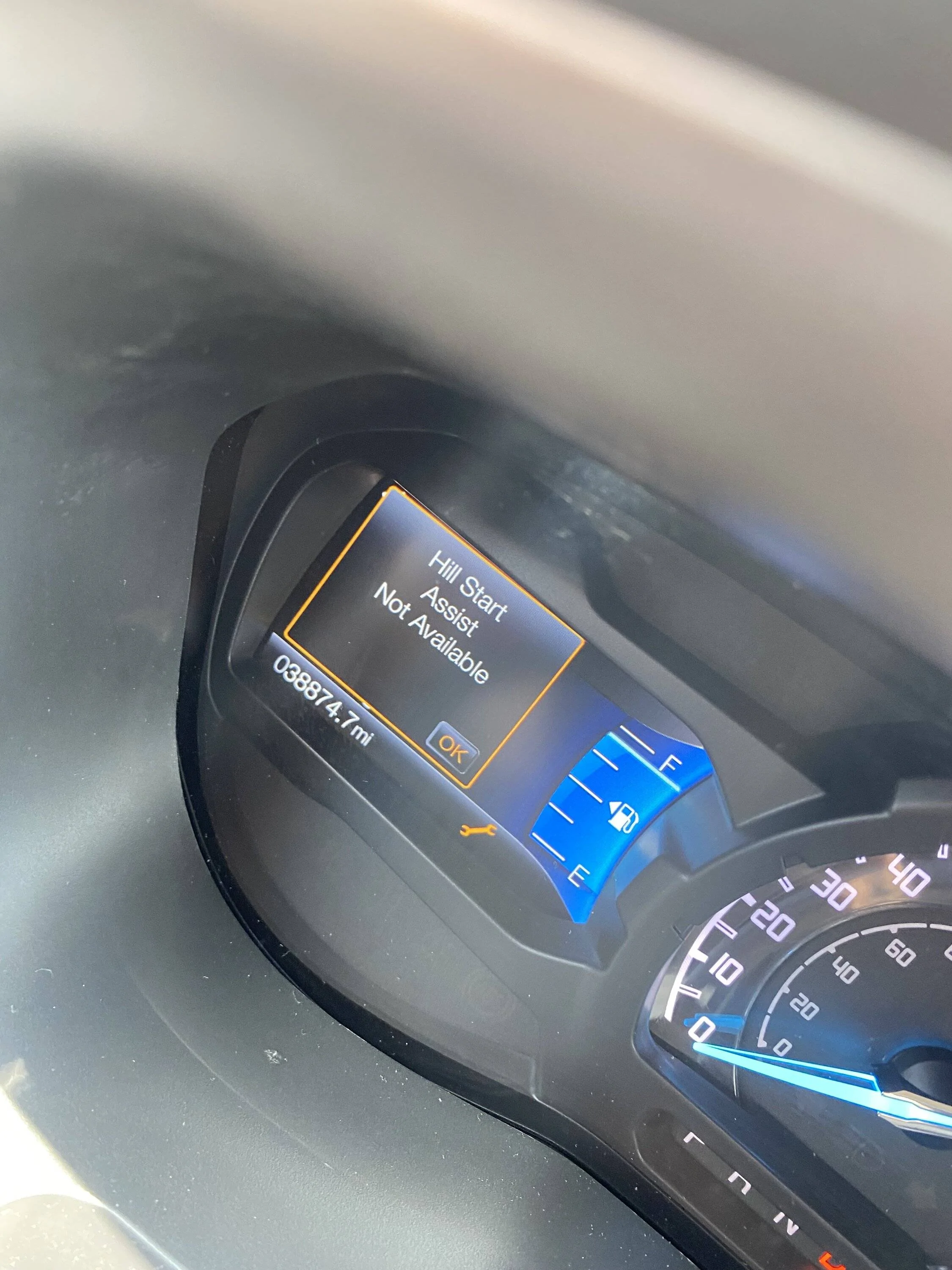

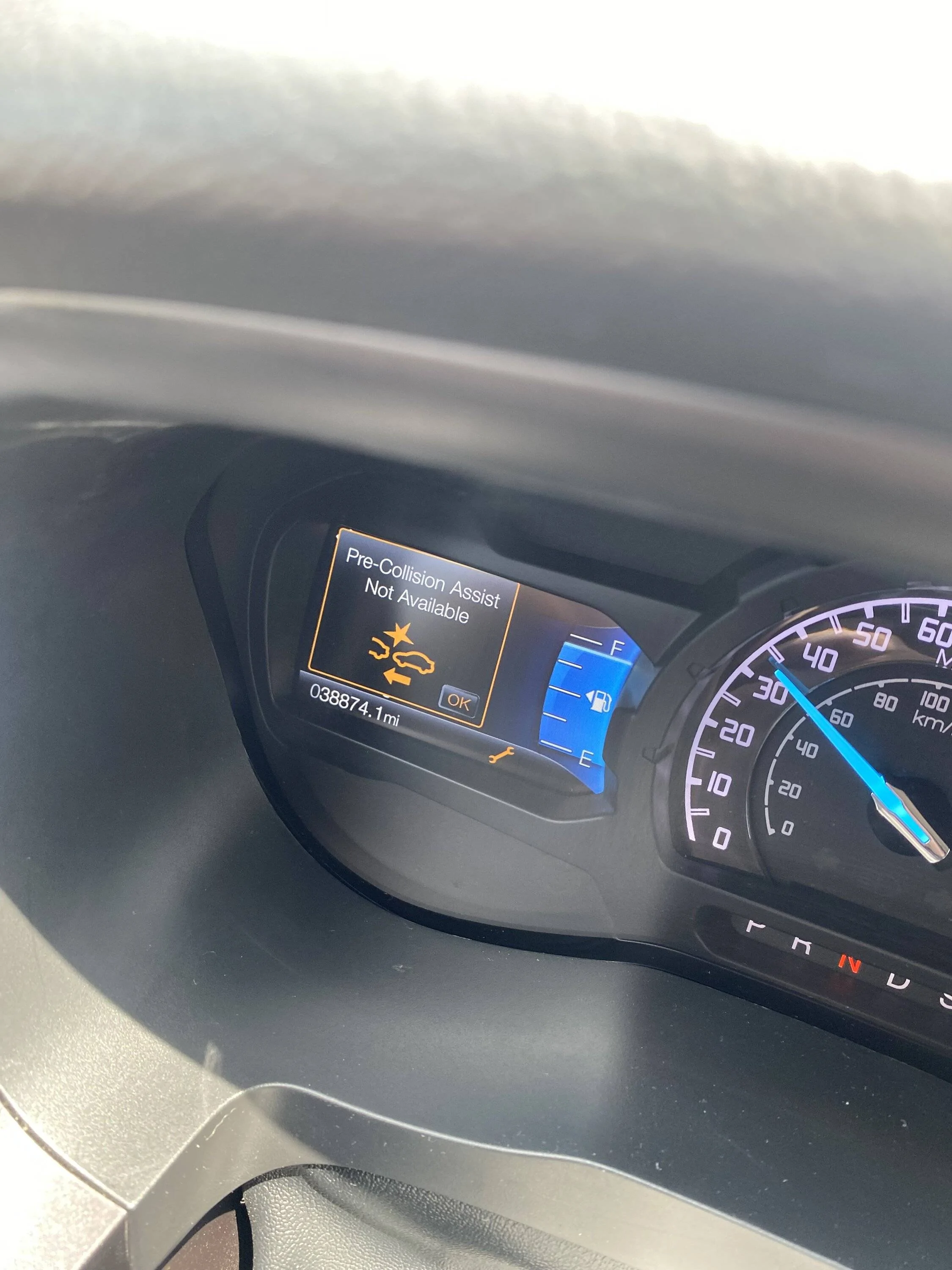

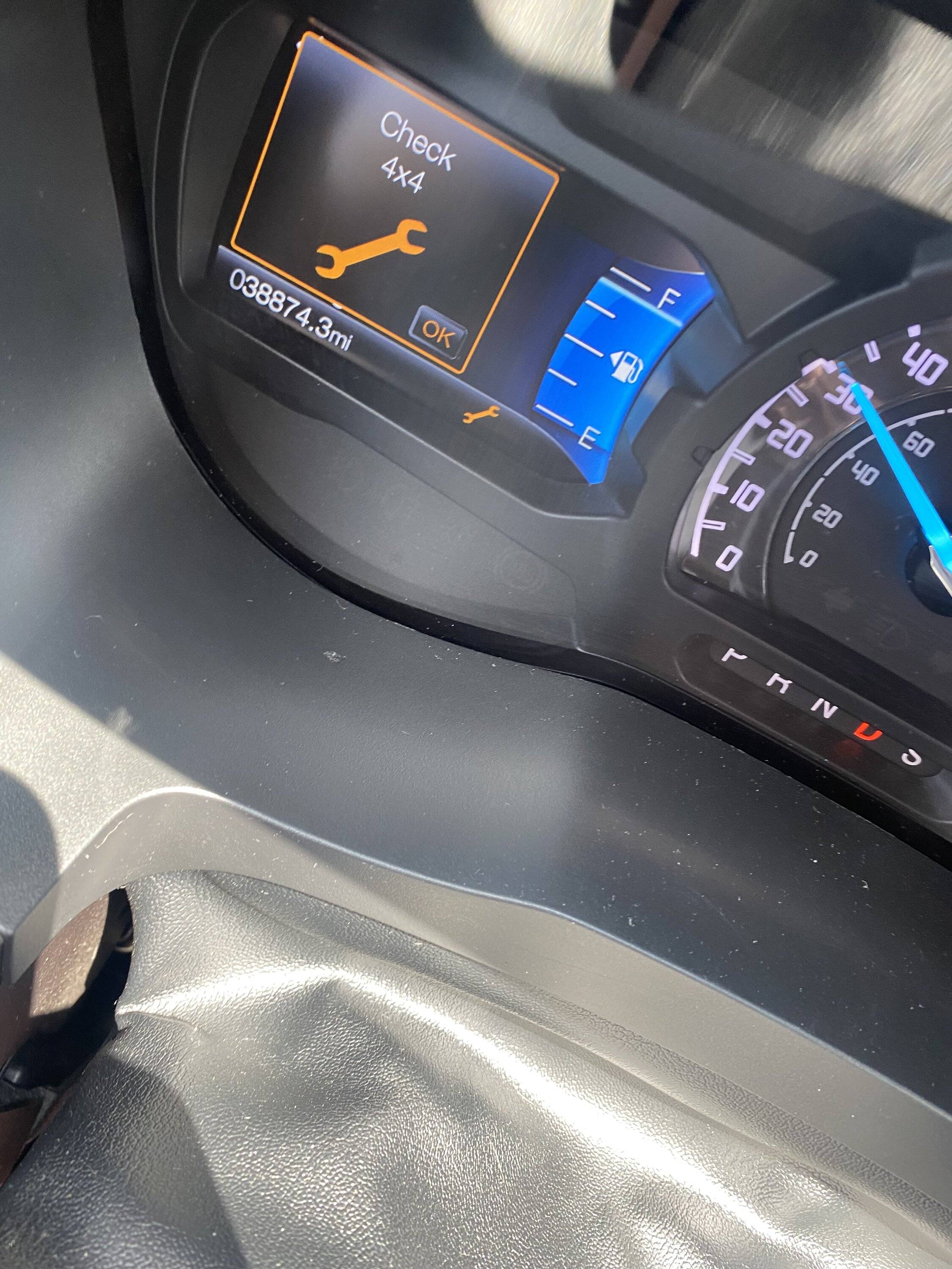

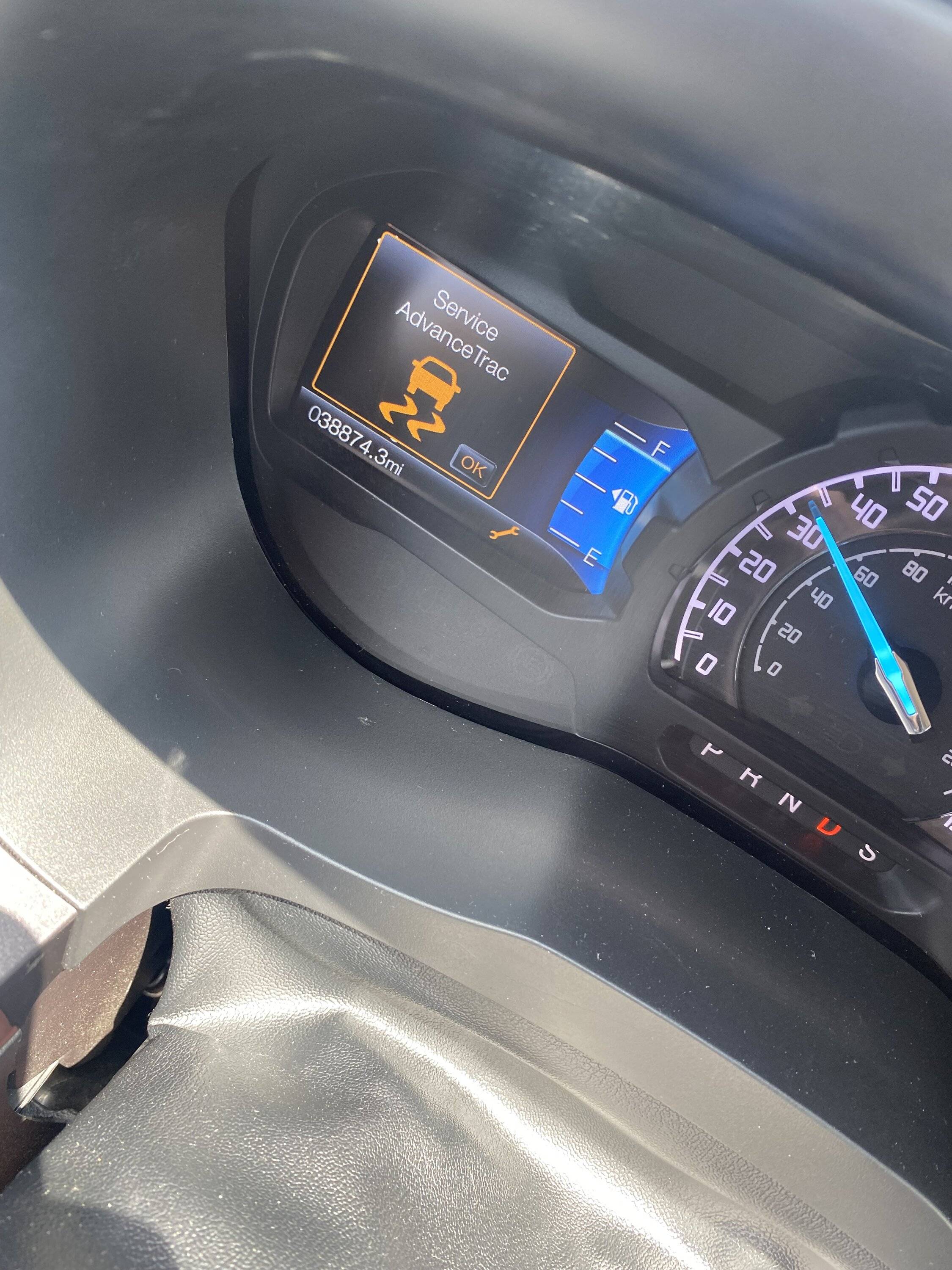

Update, system fail, again. Driving normal, starts throwing alarm, error displays: check engine, traffic sensor not functioning, check 4x4, etc etc.

low battery voltage ? I think there is a thread on here with all those lights going crazy and it was a bad battery ... is yours the original battery ?
When I bought it in March it did this within 40 miles of the dealership. They said it was a battery sensor cable and replaced. Did it again a week later and they had it for 3 weeks and replaced the 4x4 PCM. Now it has happened again after a month. Same issues.
Did they replace the battery ? They are known to act crazy after year 3 or so , you can check for codes if you have the adapter but you are due if thats the OG battery methinks , winters right around the corner sir! (i dont sell batteries , but damn it , maybe i should ?)
Thanks, I’ll pass it on. Still warrantied. So aggravating for the money spent on this vehicle.
Good chance a 2019 has had the dash pulled out for the AC box replacement , maybe something didnt get plugged back in good enough , its their baby if you have a warranty, but please keep us updated as we crave Ranger knowledge here ...
oh , one other Ranger that went crazy like that ended up being a chaffed wire inside the tilt steering column , one or two bare strands of copper causing all kinds of mayhem , once fixed , all good , as yours will be ...
