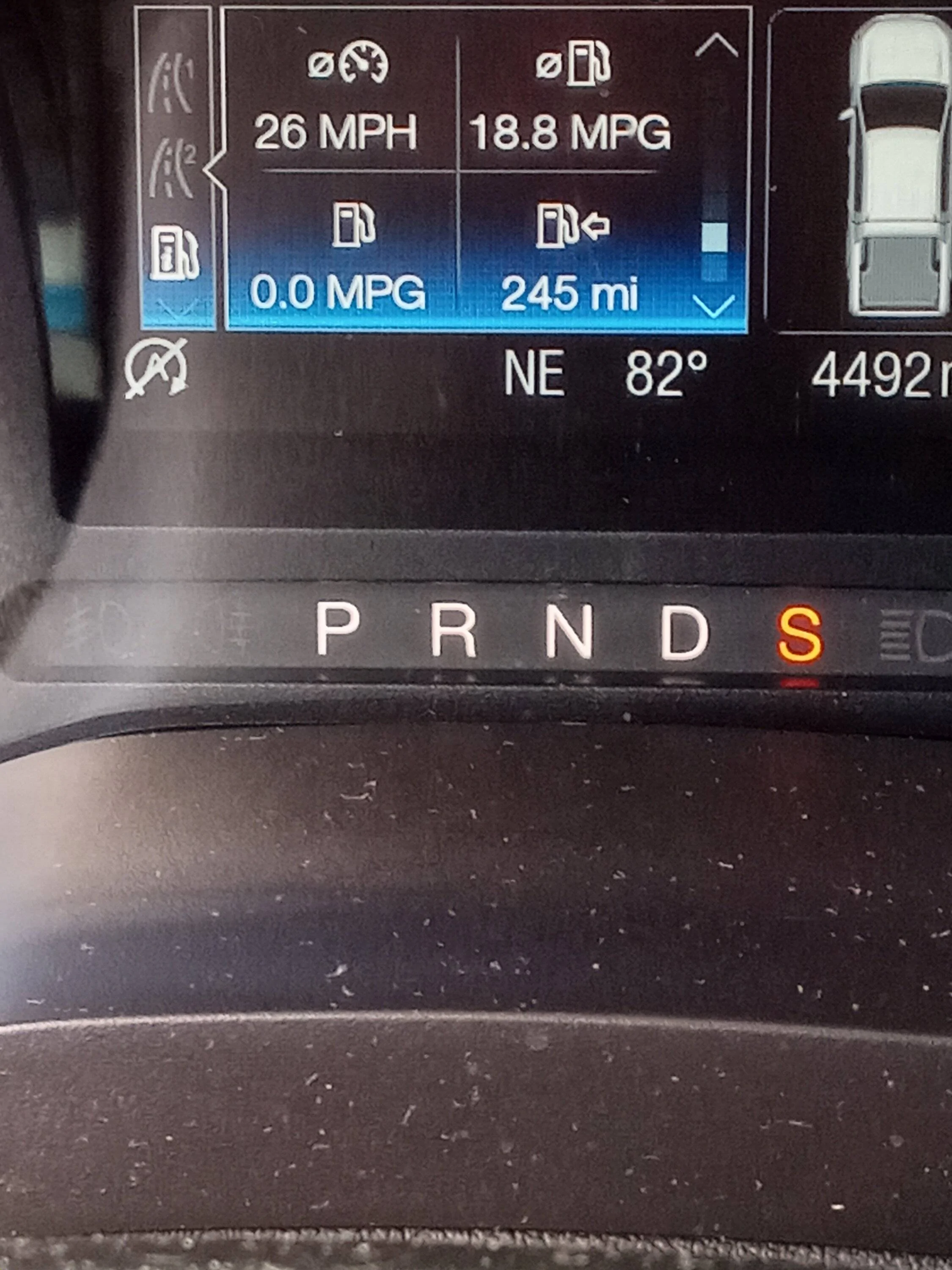

Ok , when you pull it back in Sport , the Ass button on console lights up that it's "off" , IF you push the button , it will "go off" ,indicating that ASS should work , tried it all the way home , sometimes it did , mostly it didn't, McDonalds drive through, engine stopped at the speaker , but 2 other complete stops, it kept running and the little @ with the line through it would come on like it wanted to but "wasn't allowed"... 2 stoplights on the way home , died at one, purred through the other ... tow mode seams to not let the ass work at all , no matter if you hit the button again or not ... so , I must have turned the Ass back to on while in sport , which I assume I've never done before since it's never worked that way before , but now knowing it's supposed to have ASS in sport mode , it sucks even worse than I originally thought , perhaps I'll get a shovel and dig a little, then I'll see if I can tell my ASS from a hole in the ground...

There are a couple of conditions that will give the no ASS symbol. Battery charging, heavy HVAC usage, etc.
If you select the "economy" display one of the screens will tell you why it's not allowing ASS to function.

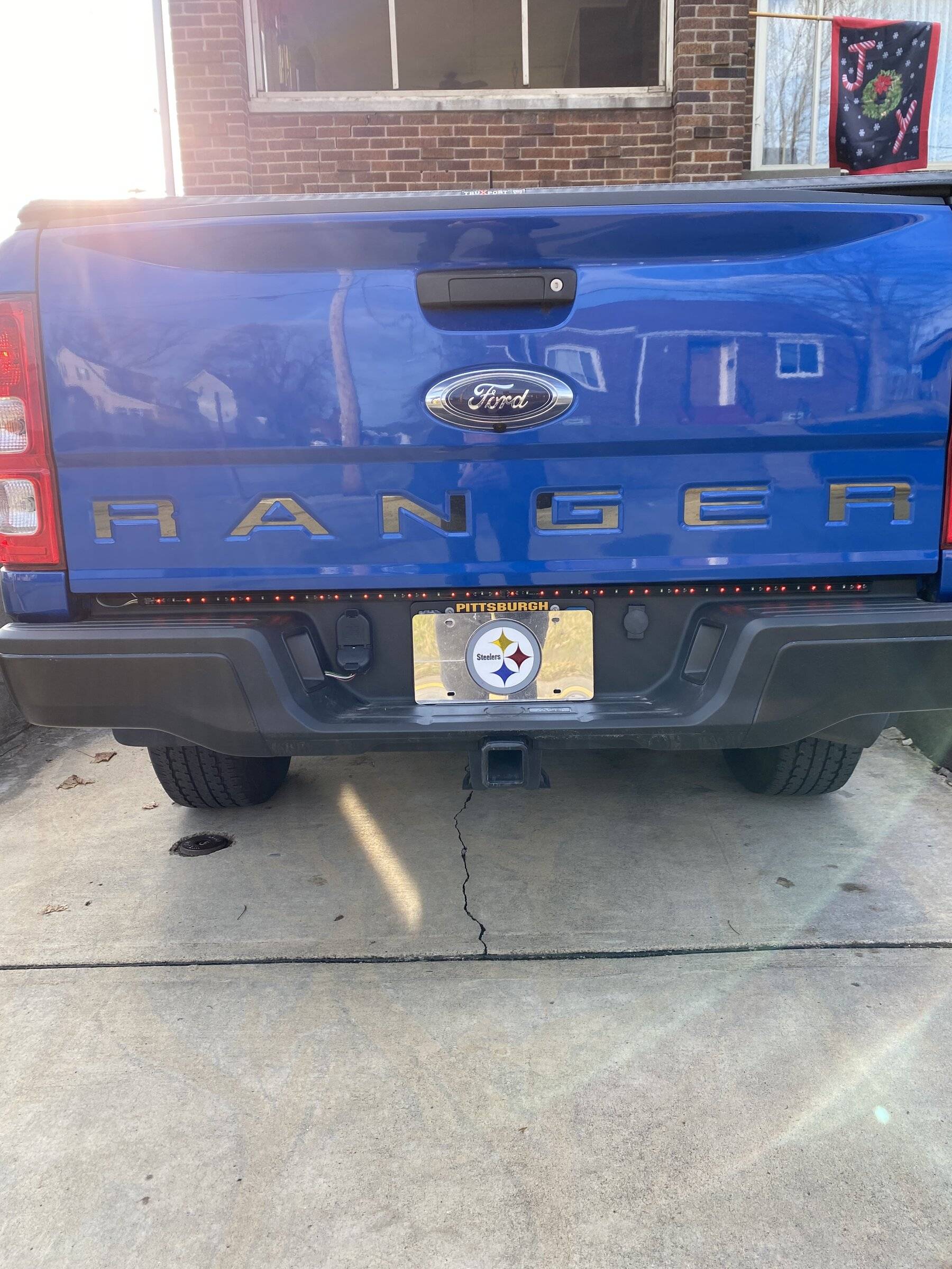

I got a tailgate light bar that plugs into the 4-pin trailer plug and that disabled the A.S.S.
