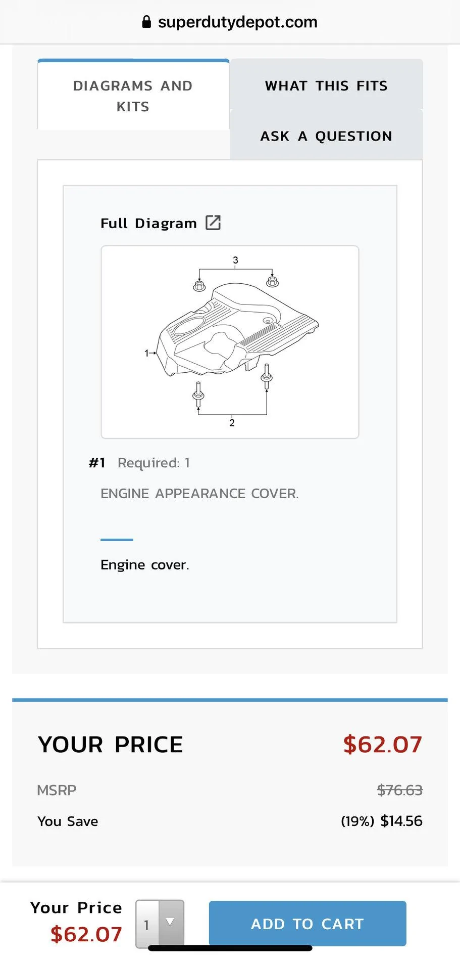

I ordered my engine cover the 22nd of January 2020 from my dealer and the Ro says 76 for the cover and 46 for the bolts for 122.00 , never thought anything of it because I am going to use my Ford pass rewards for it , then I thought what, 46 for two bolts, no they are packs of 5 at Fastenal because Ford doesn't sell them in two packs. The parts man really didn't know for sure , anyway I cancelled the order for the bolts and went down and paid 3.50 for a pack of 5, don't need 5 but that is fine, I save
everything like a pack rat does, hardly ever throw anything away incase I may need it later.
Before I ordered the cover I looked under the hood of a Lariat to see what they looked like and also cause there are 4 threaded screw holes, 2 on the left , one in the front and one in the very back , must be for the other vehicles that use this mighty little four banger.

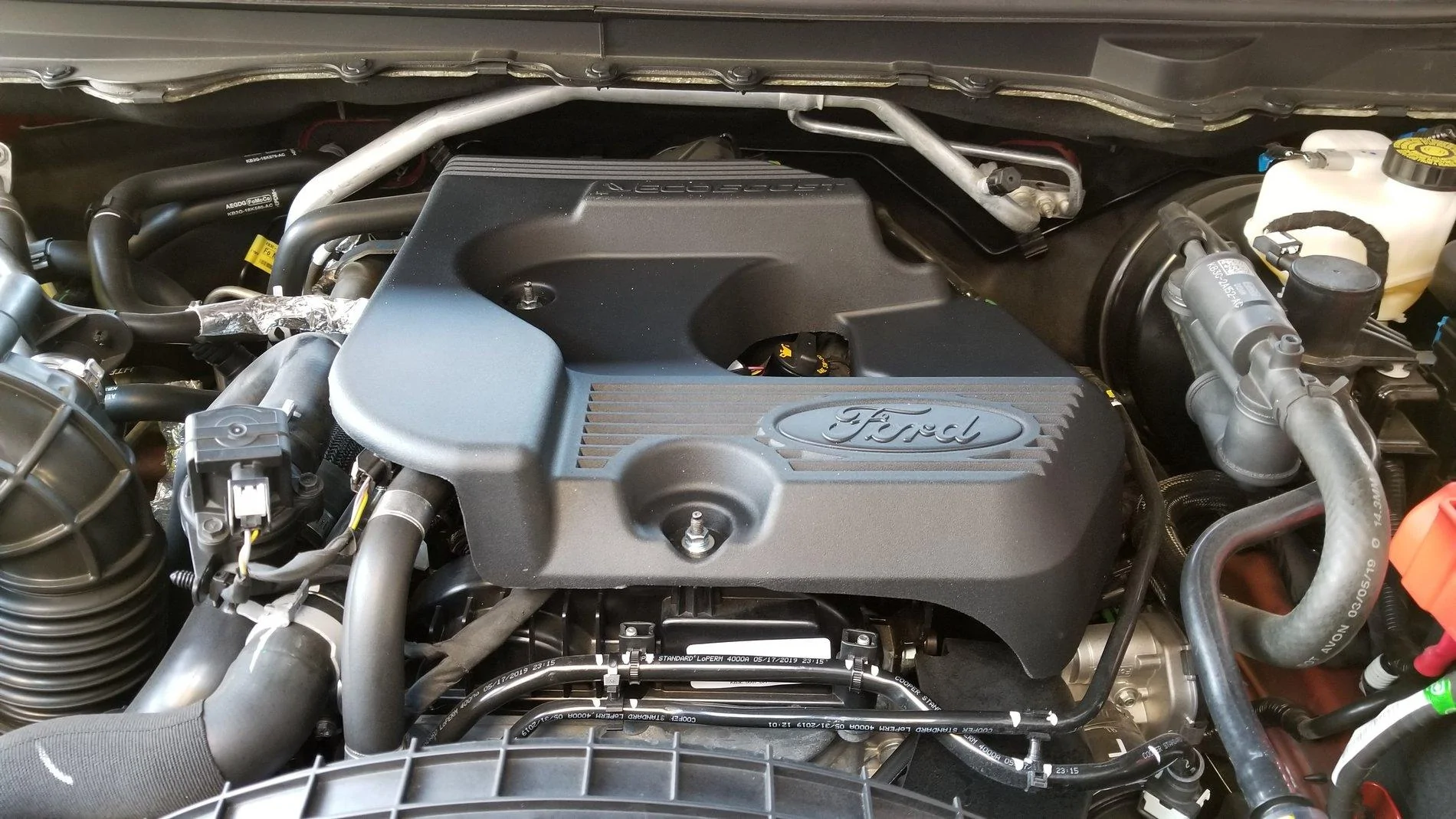

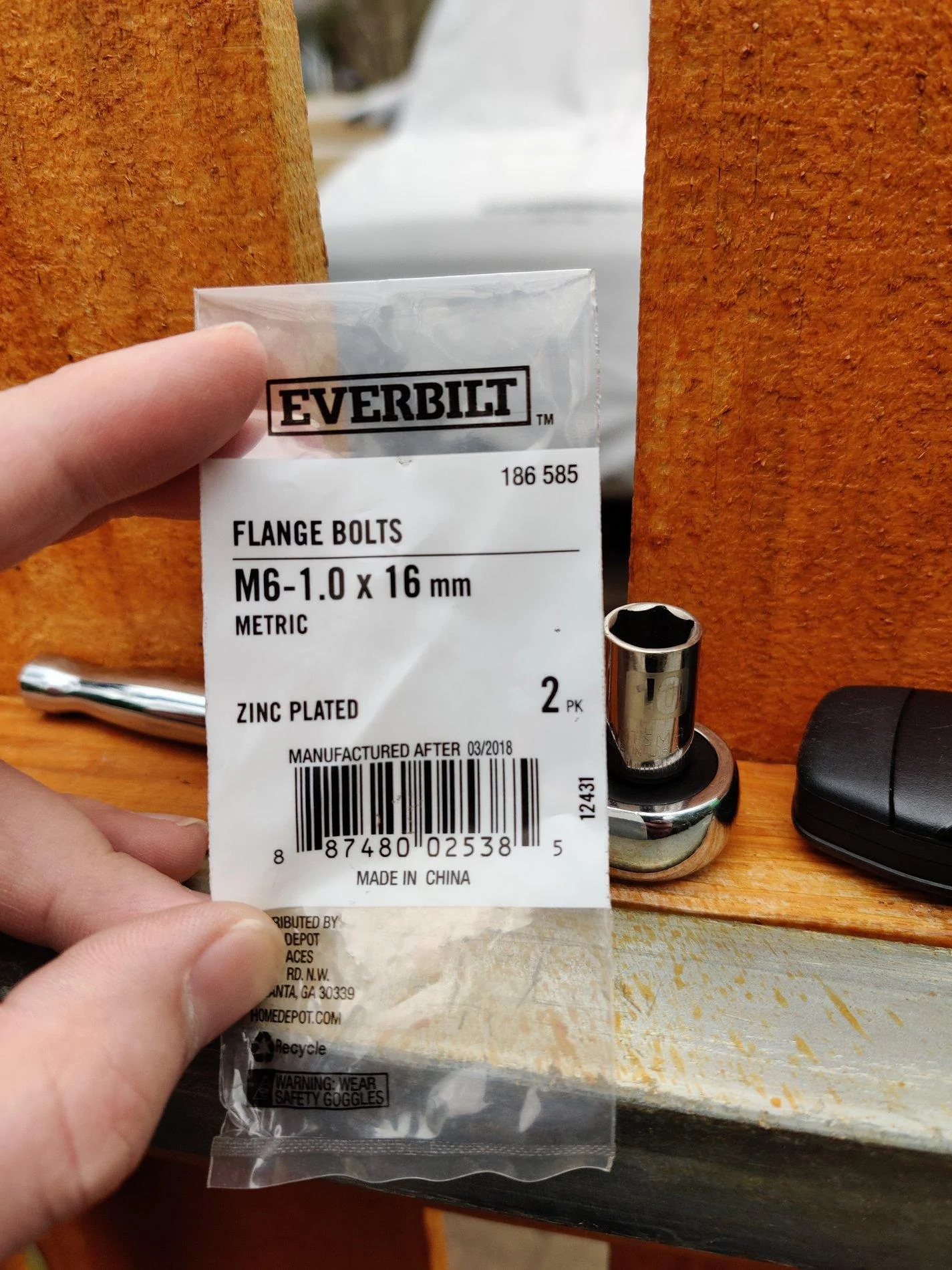

Just installed mine today. A noticeable difference in the injection noise. Definitely quieter than without the cover.
Went to Home Depot and got bolts for the cover. OEM is outrageous for small parts. Attached a photo of the bolts and 10mm socket you'll need. Worked perfectly for about $3

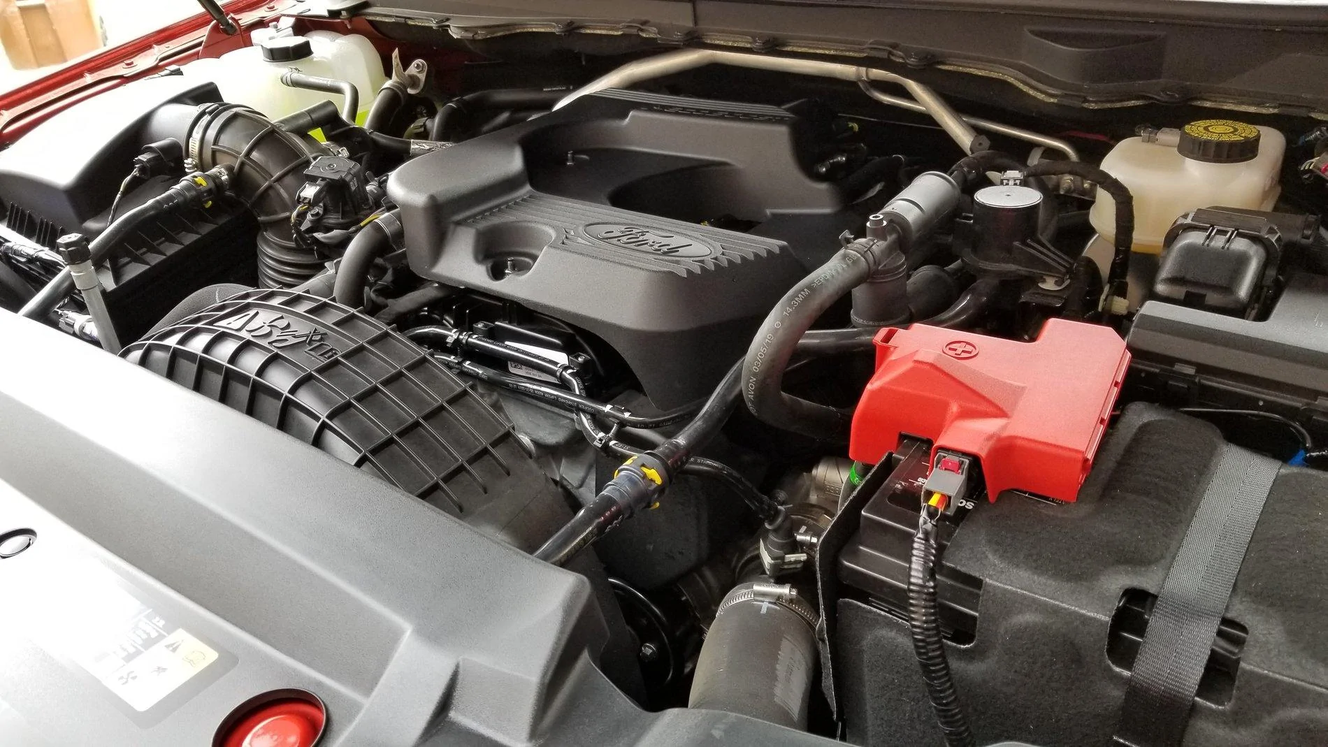

I installed the cover yesterday. When I ordered I requested 2 of the mounting studs without realizing you don't get the nuts to secure the cover. I went to Lowes and got them and installed within a few minutes afterward. I personally like having the cover installed and I think it looks more complete.

Just received and installed mine for $66.02. That was cover, 2 bolts, and 2 nuts. Free shipping and was from cheaperford parts.com. Ford dealership out of Sacramento.
