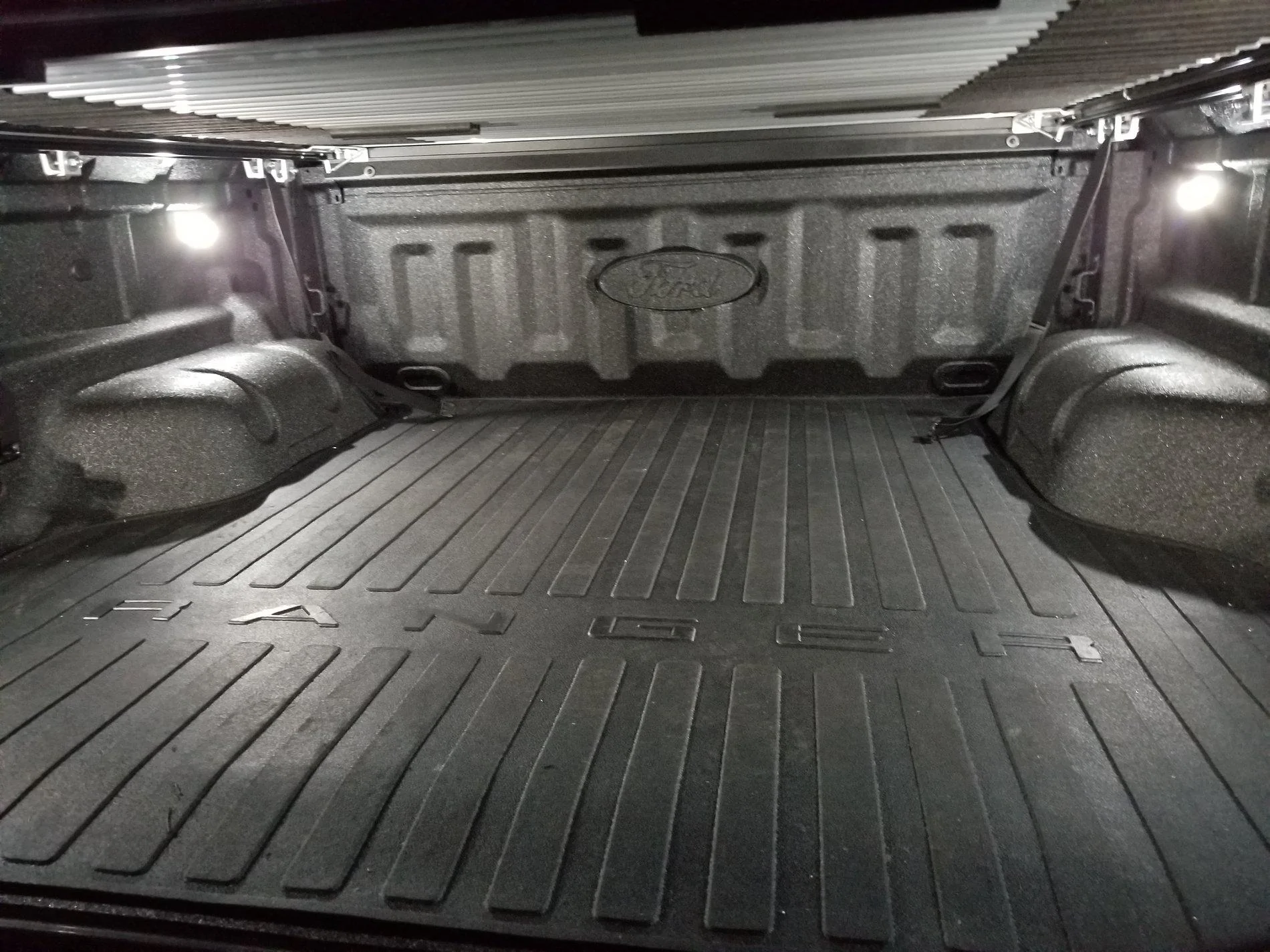

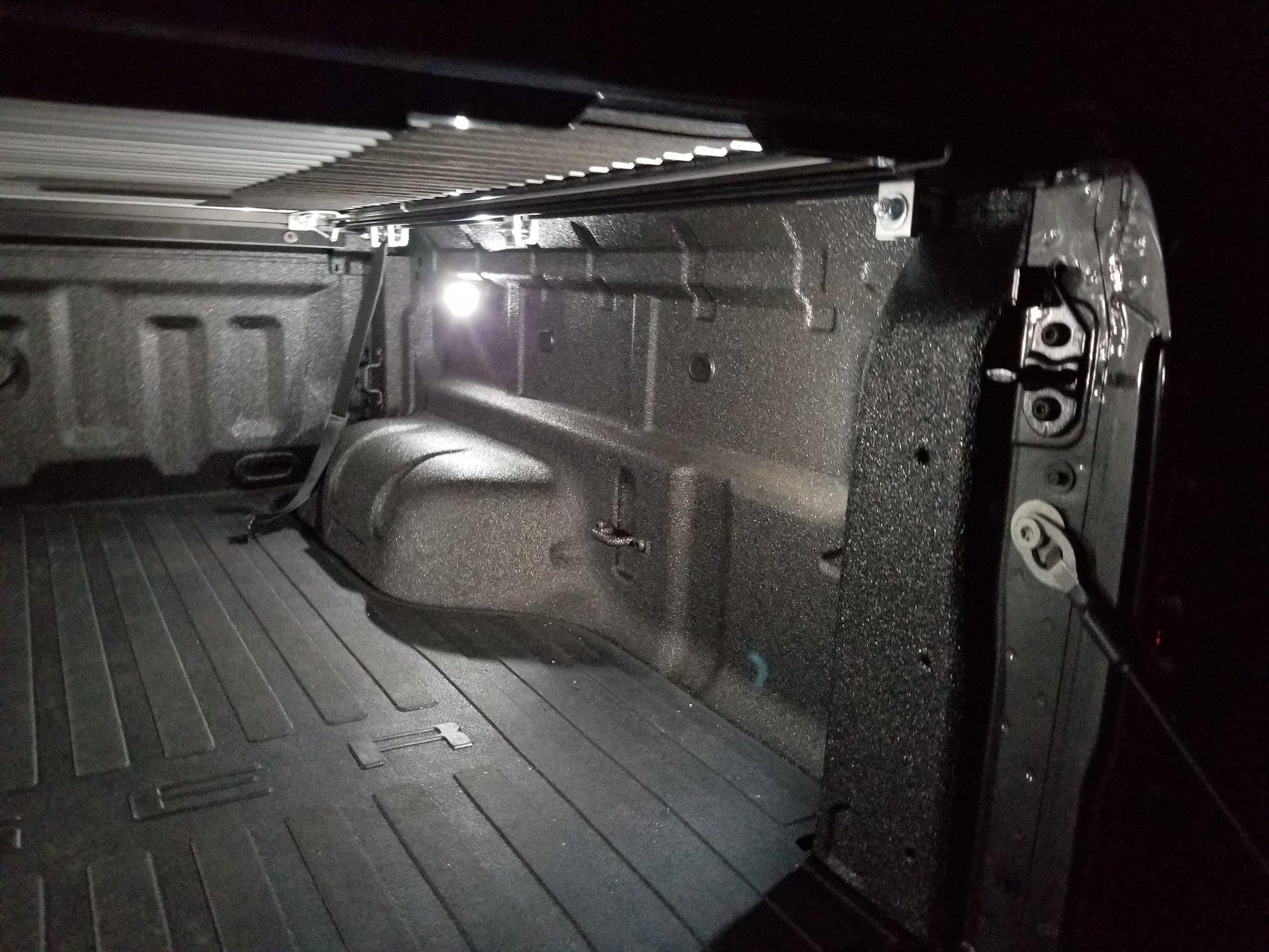

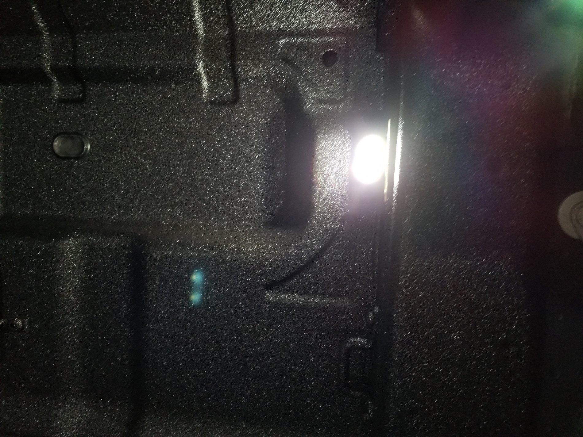

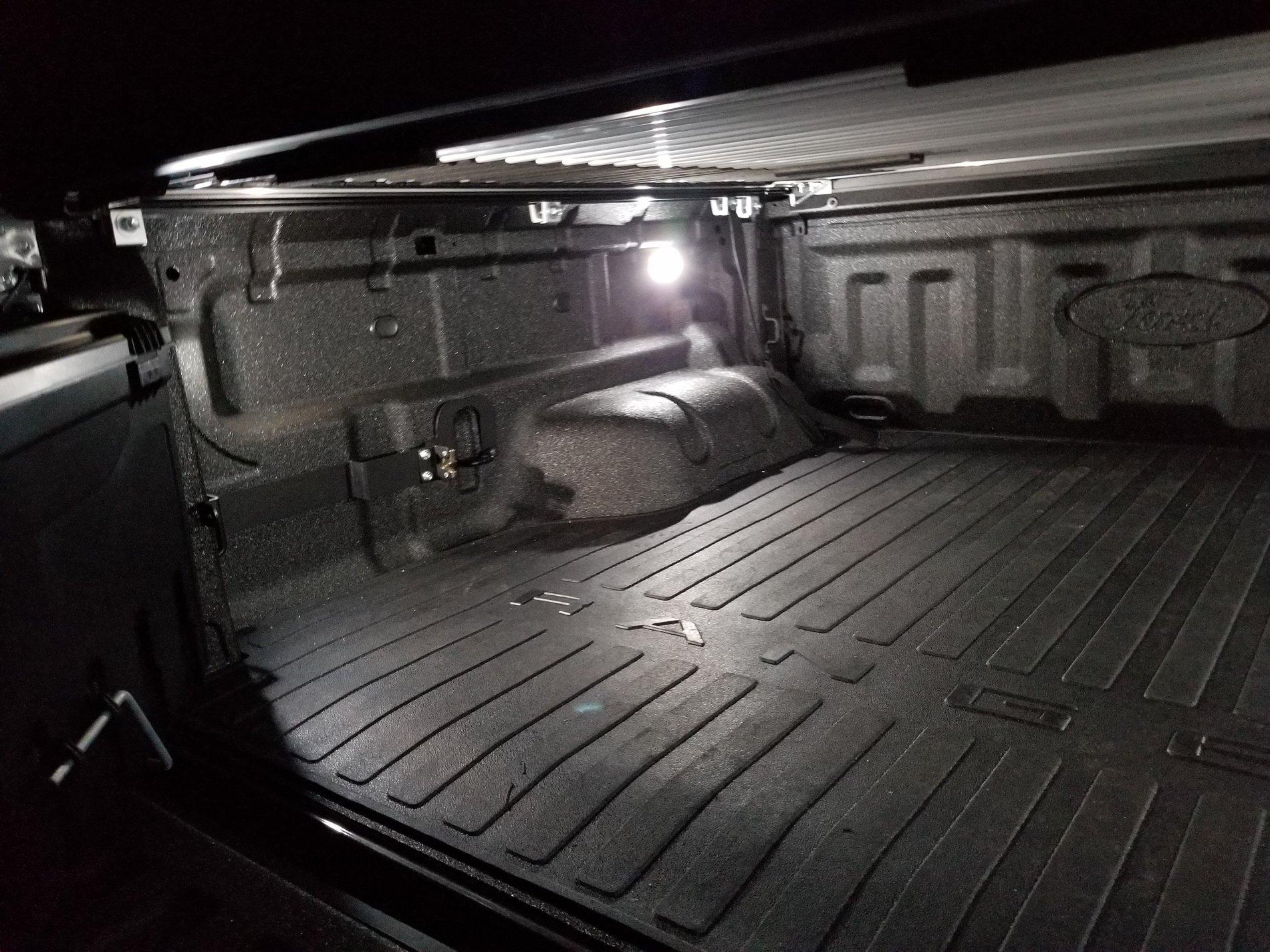

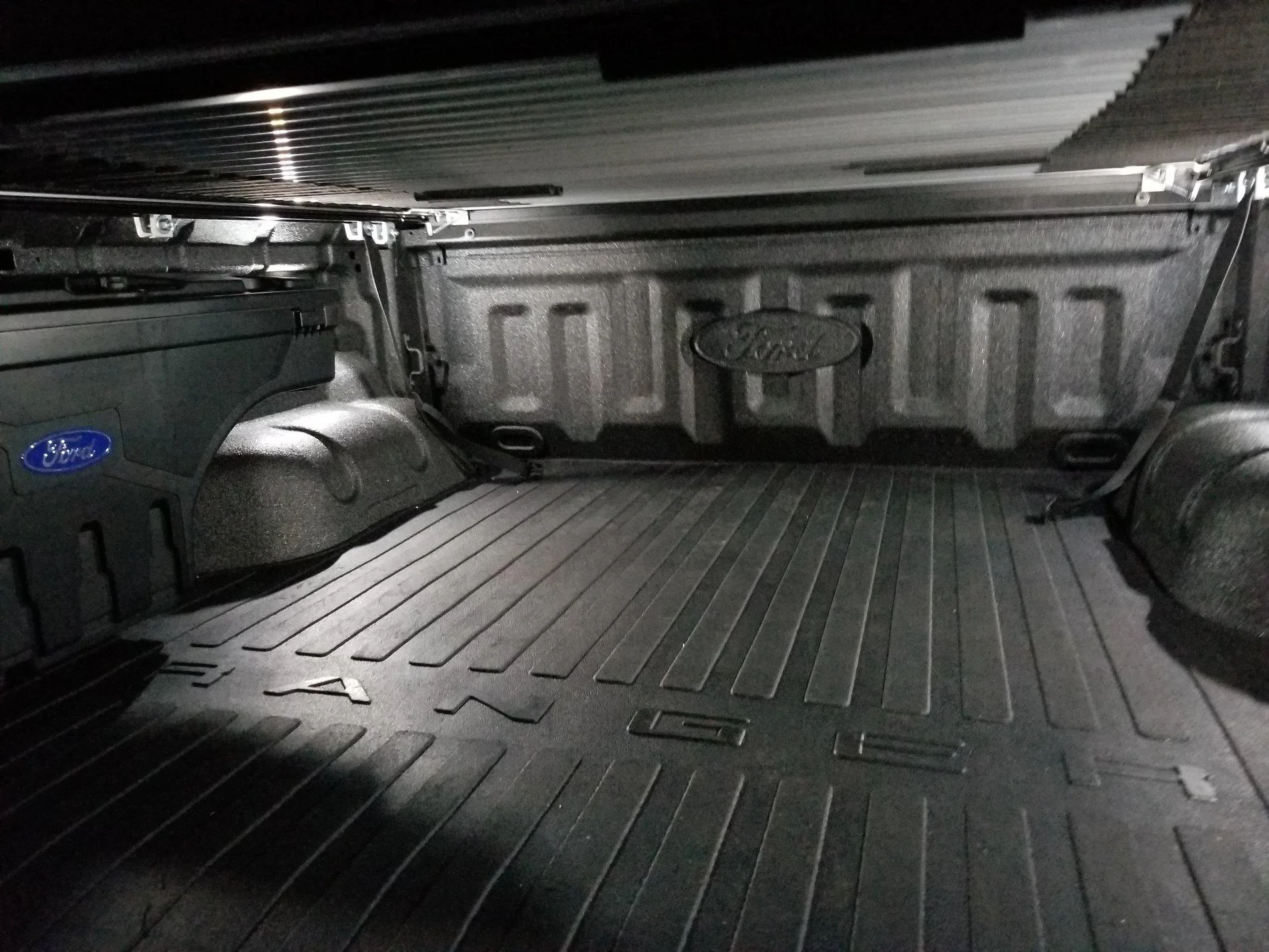

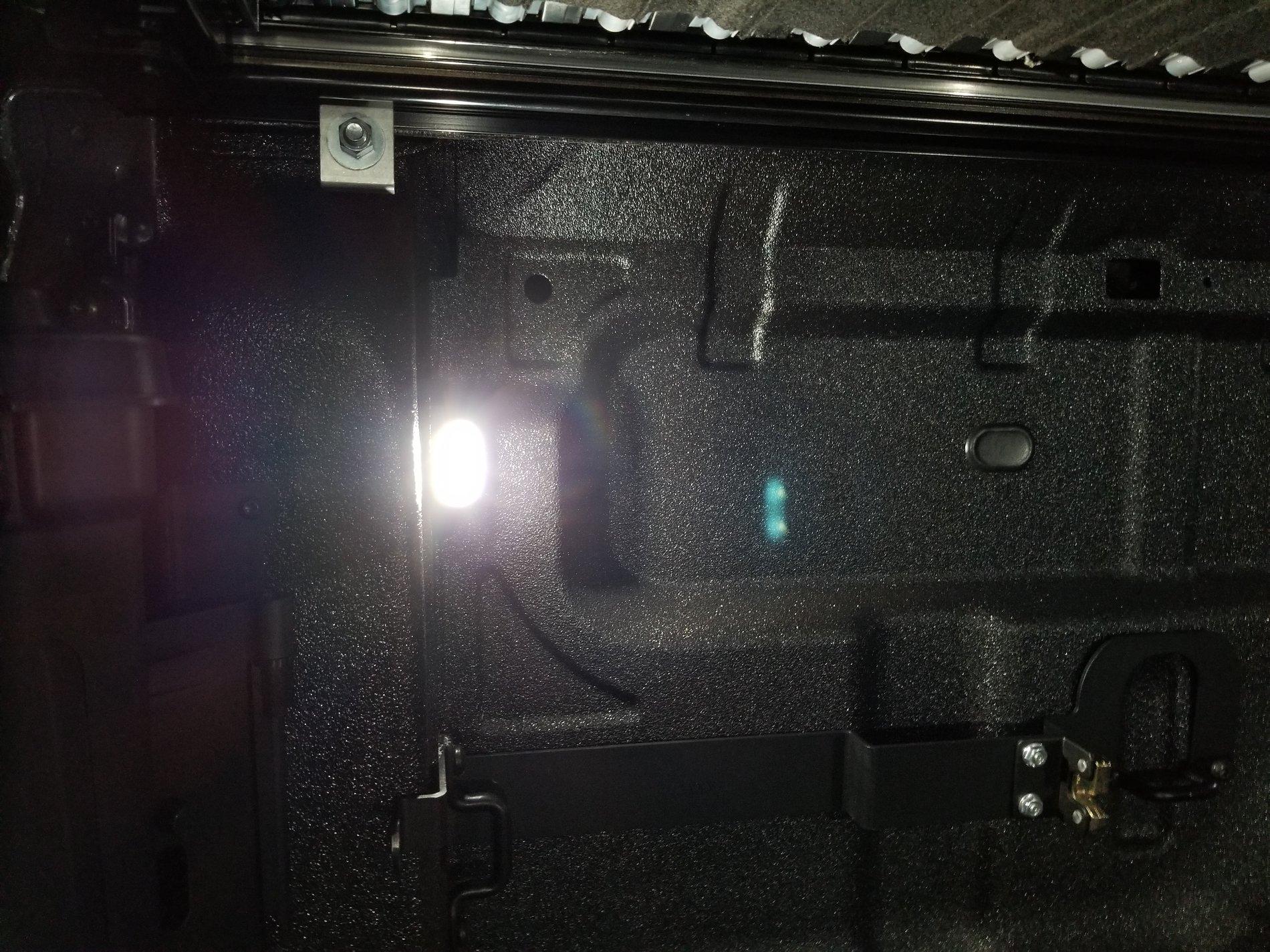

Here are the 'DARK" pics.. I'm PLEASED.. the side mount tool box blocks a little light but can be swung out and you can see great.
Don, I really like your setup. I have a couple of questions for you: (1) How difficult was it to remove the tie downs given you have a spray-in bedliner? (2) Are you planning to relocate the tie-downs that you remove to install the SwingCase? I am having a hard time with the idea of no tie-downs in that corner of the bed.

OK, I can see in your photo that you installed the tie-down over the brackets. Yay!

I installed mine a couple months ago and I like them. They are very helpful at night, especially with the bed cover closed.
