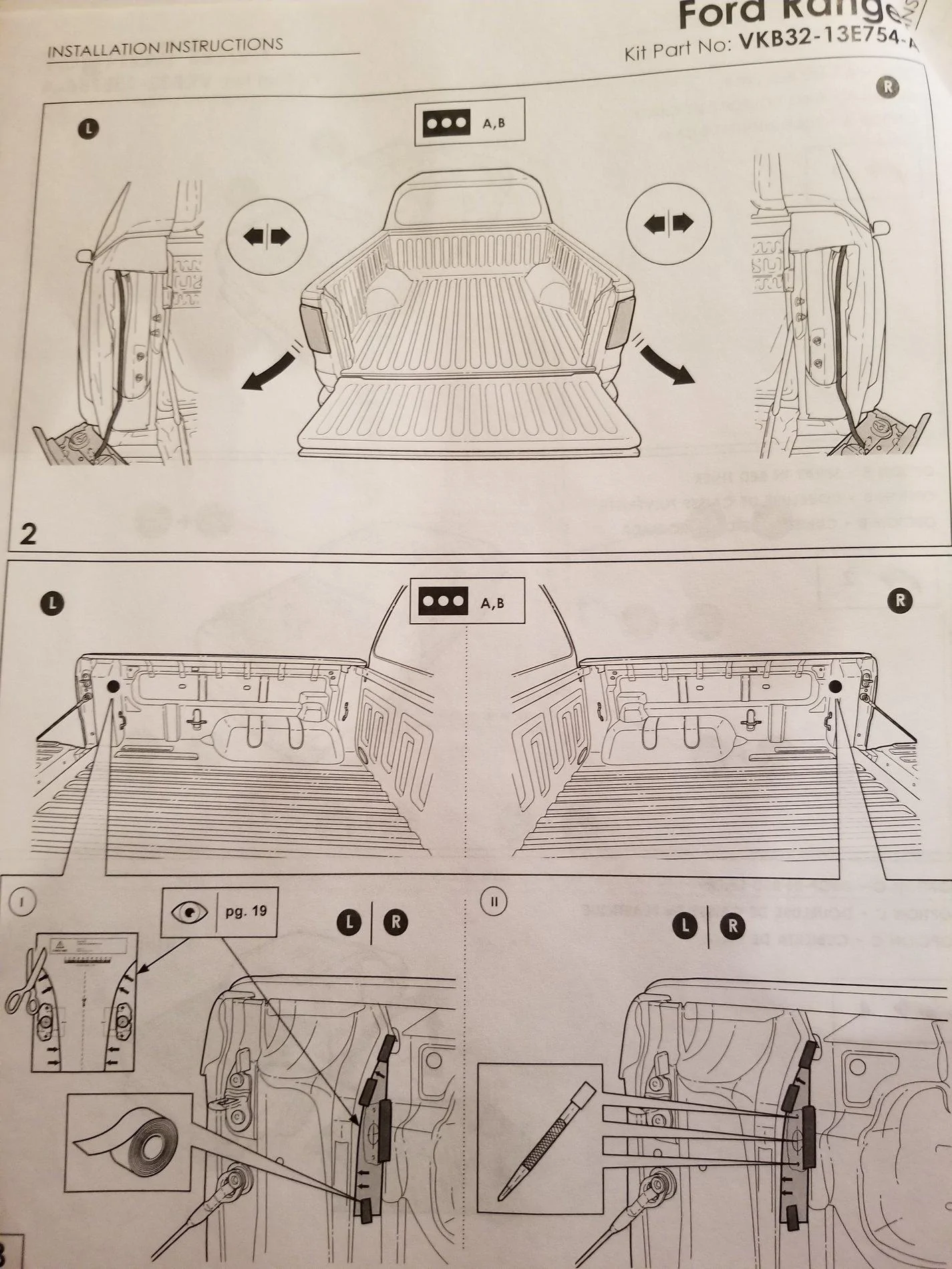

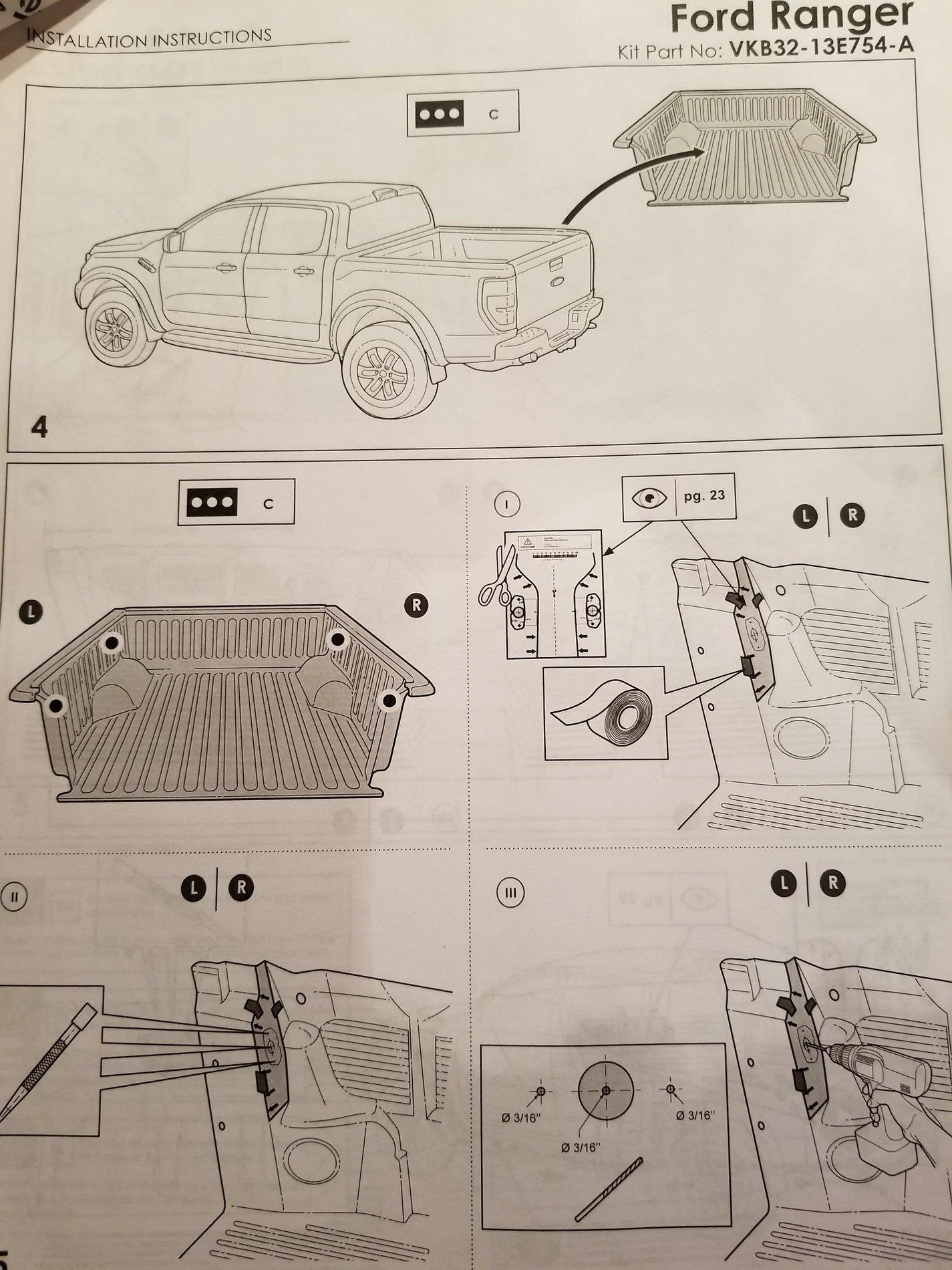

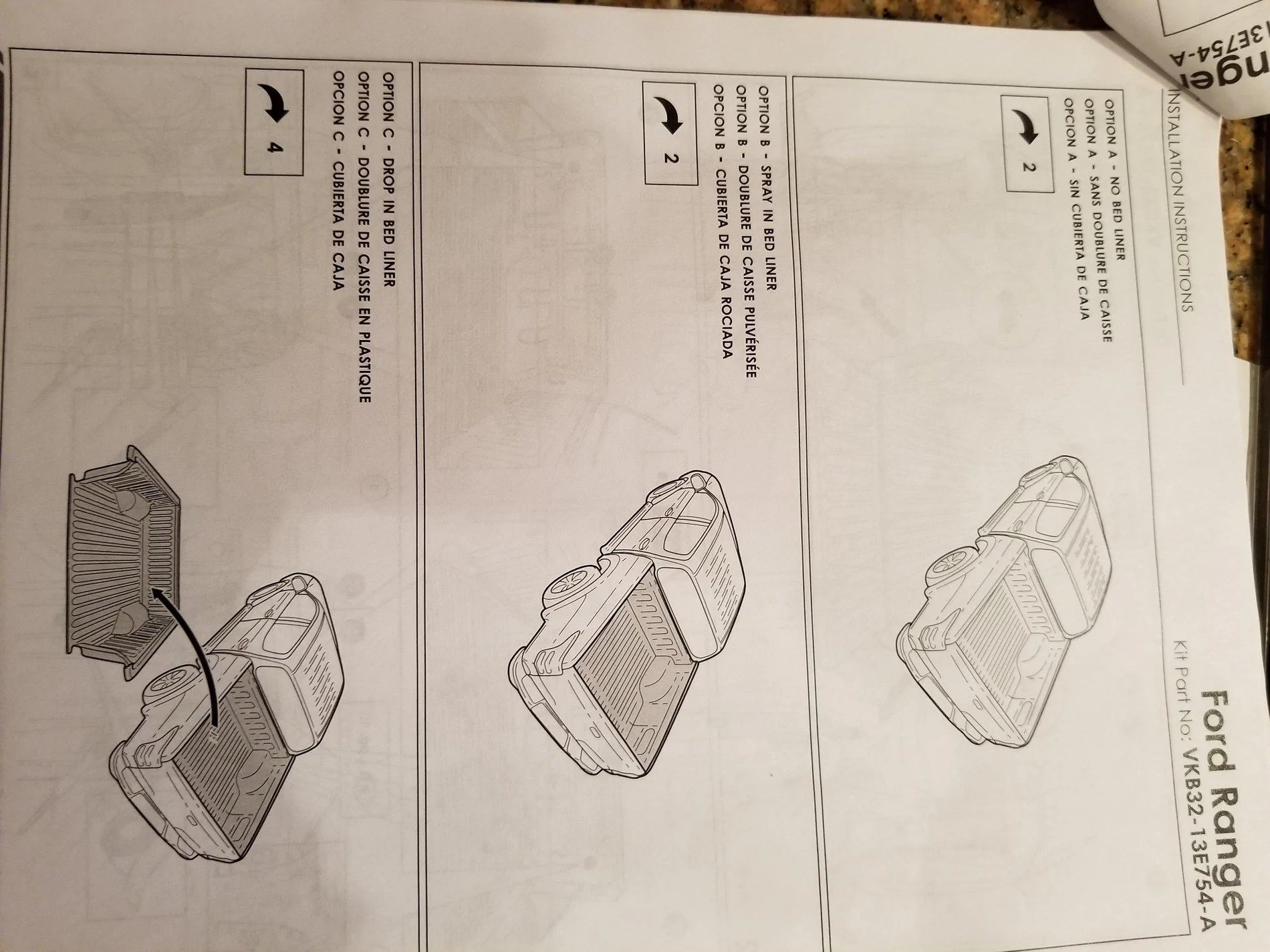

A lot are repetitive between spray in and drop in bed liners.
Thanks for posting the instructions! I can't tell from the document how the 4 lights are sealed against the bed spray liner. Is there a gasket on the backside to prevent moisture from getting behind each light?
