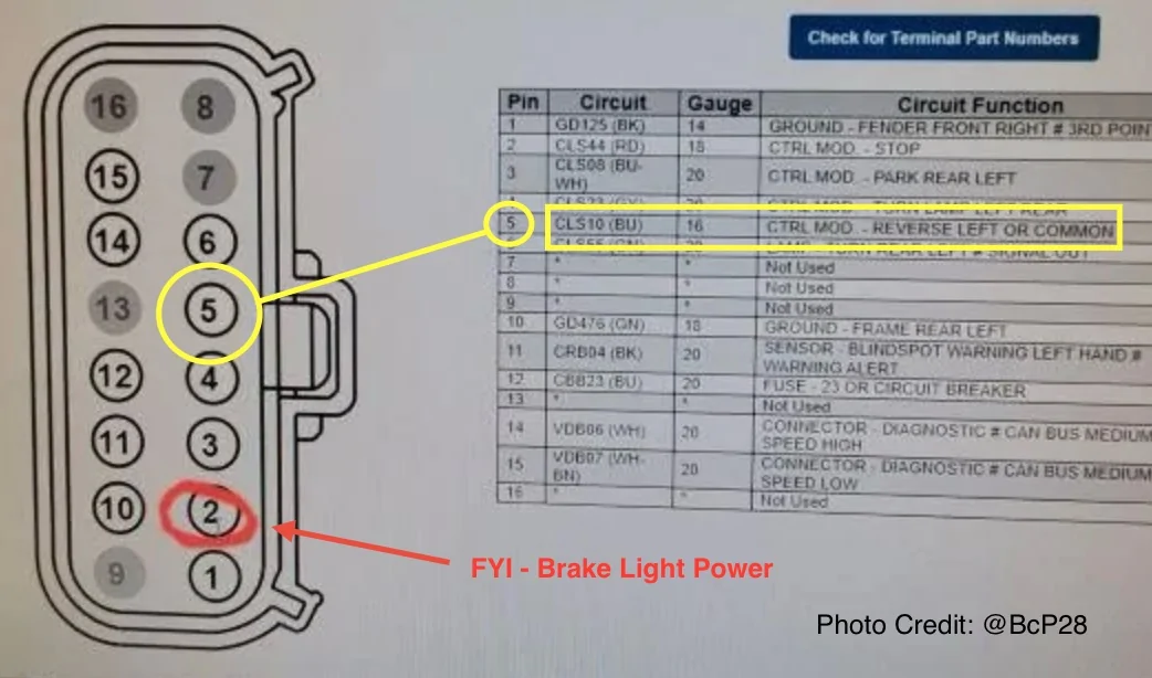

It’s easy enough to tap into it.
Pin 1 is GROUND
Pin 2 is Brake Light Power
The wires from my topper’s third brake light are tapped into my driver side taillight. I was able to find the entry point to the back of the taillight assembly. It’s up in the top corner at the back of the bed - just big enough for small wires. Remove the two screws of the taillight and carefully pull it back and out at an angle. There are two push pins holding it in place - do not try to hinge it out. It takes a bit of force but it will pop out.
Remove the harness to make it easier to work on things. Pull the red tab back on the connector to unlock it. Then, press your thumb on the grooved tab and wriggle the connector off.

This is EXACTLY what I needed. Thank you very much!
