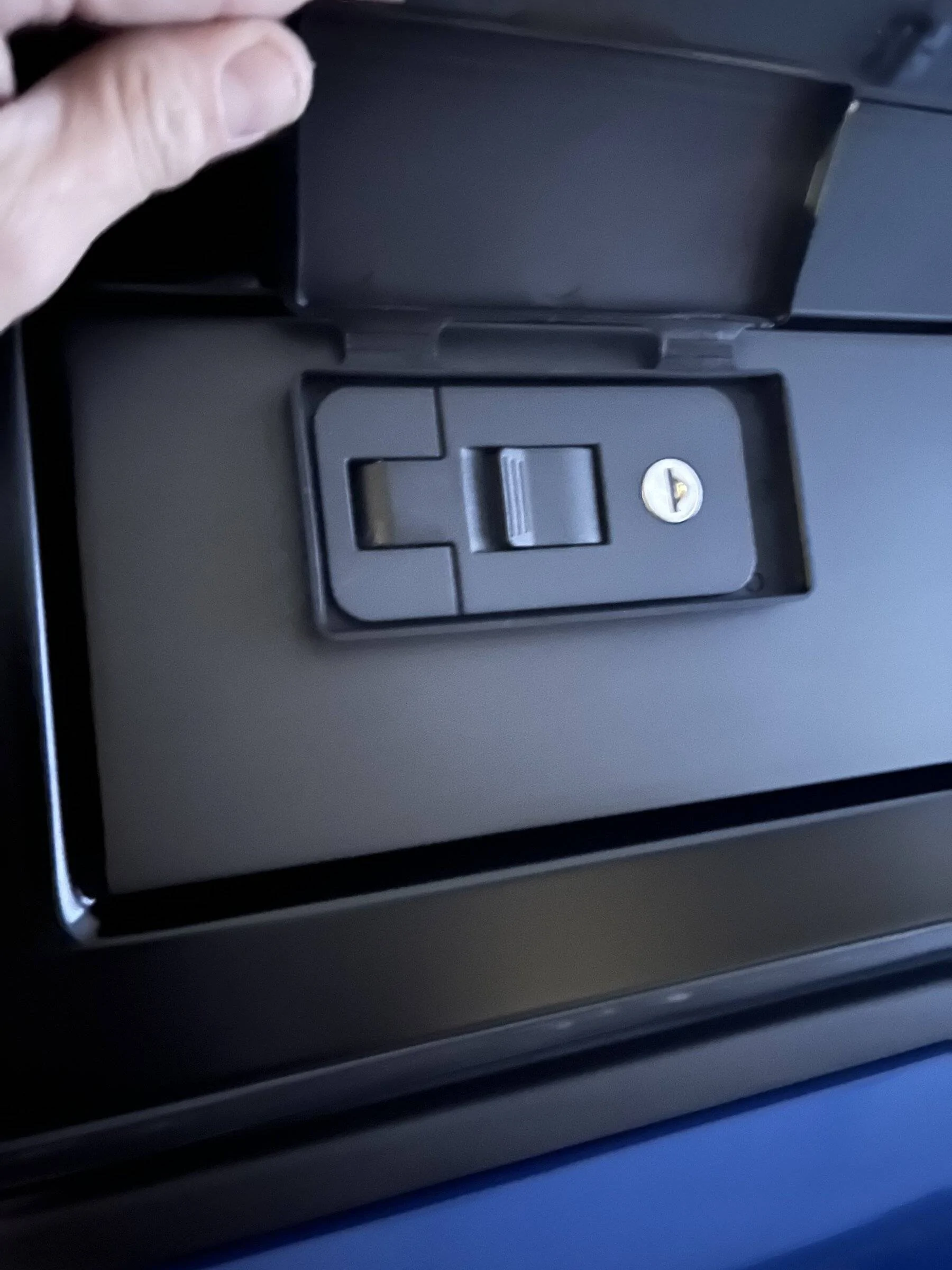

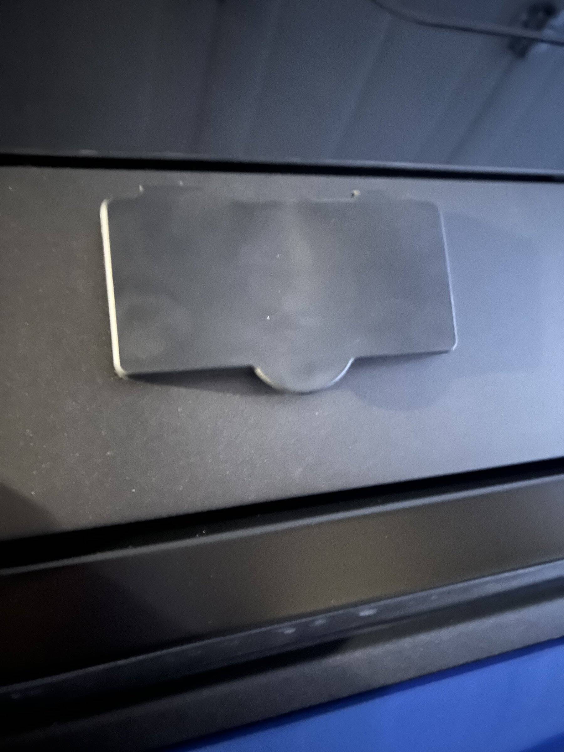

Also, for you Smartcap owners. These guys have covers that will (hopefully) prevent ice from building up around the locks. They have sold a bunch of these lately and even mentioned that they have been shipping them out around the country. If you’re interested, let me know and I’ll get you the phone number.

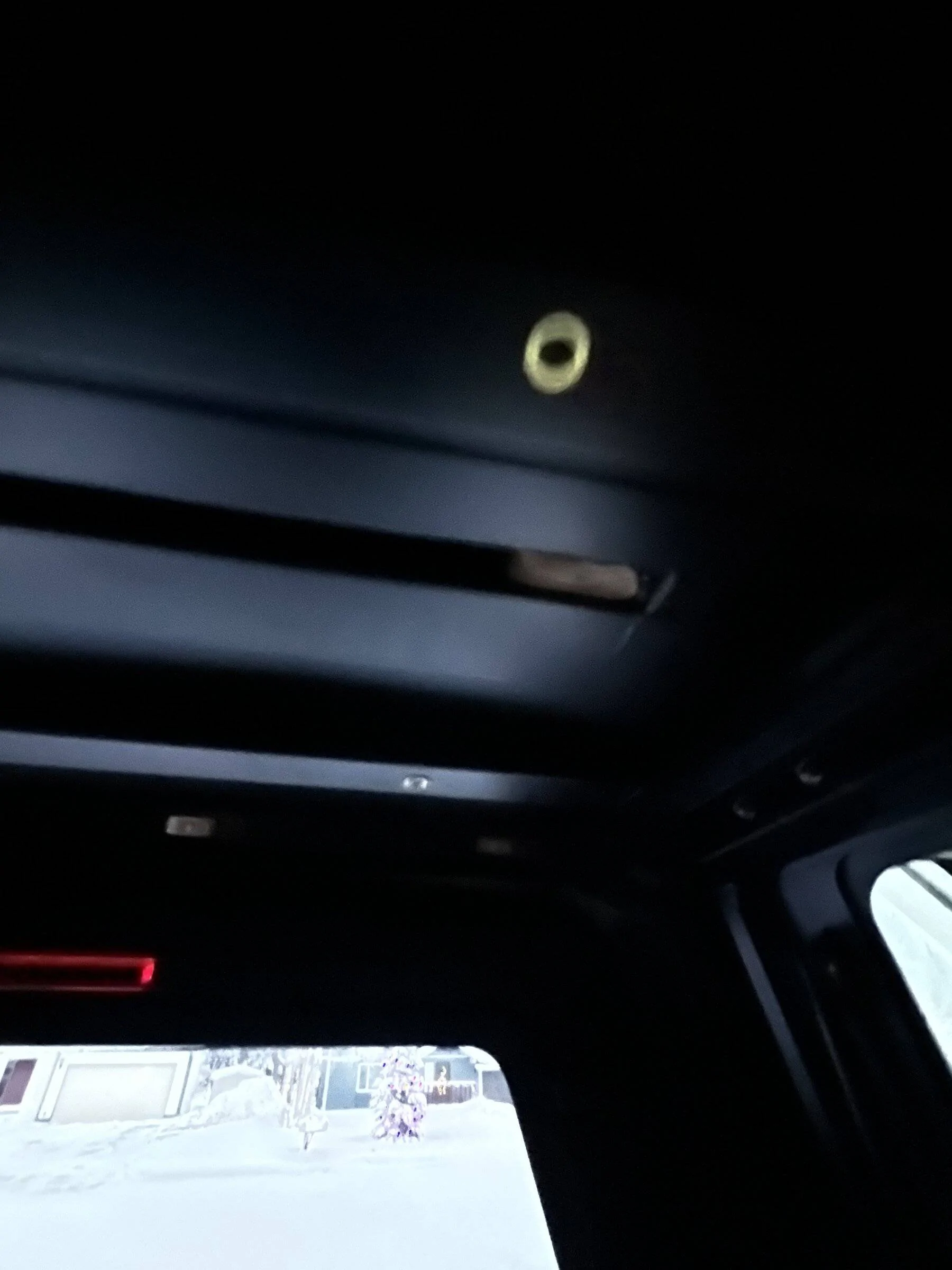

And, the top vent I have heard let’s in water during car washes. They are using putty on the edges of the vent and they said it is doing a good job with the touchless car washes that we have around here. I’ll let you know how it works for me when I go next.

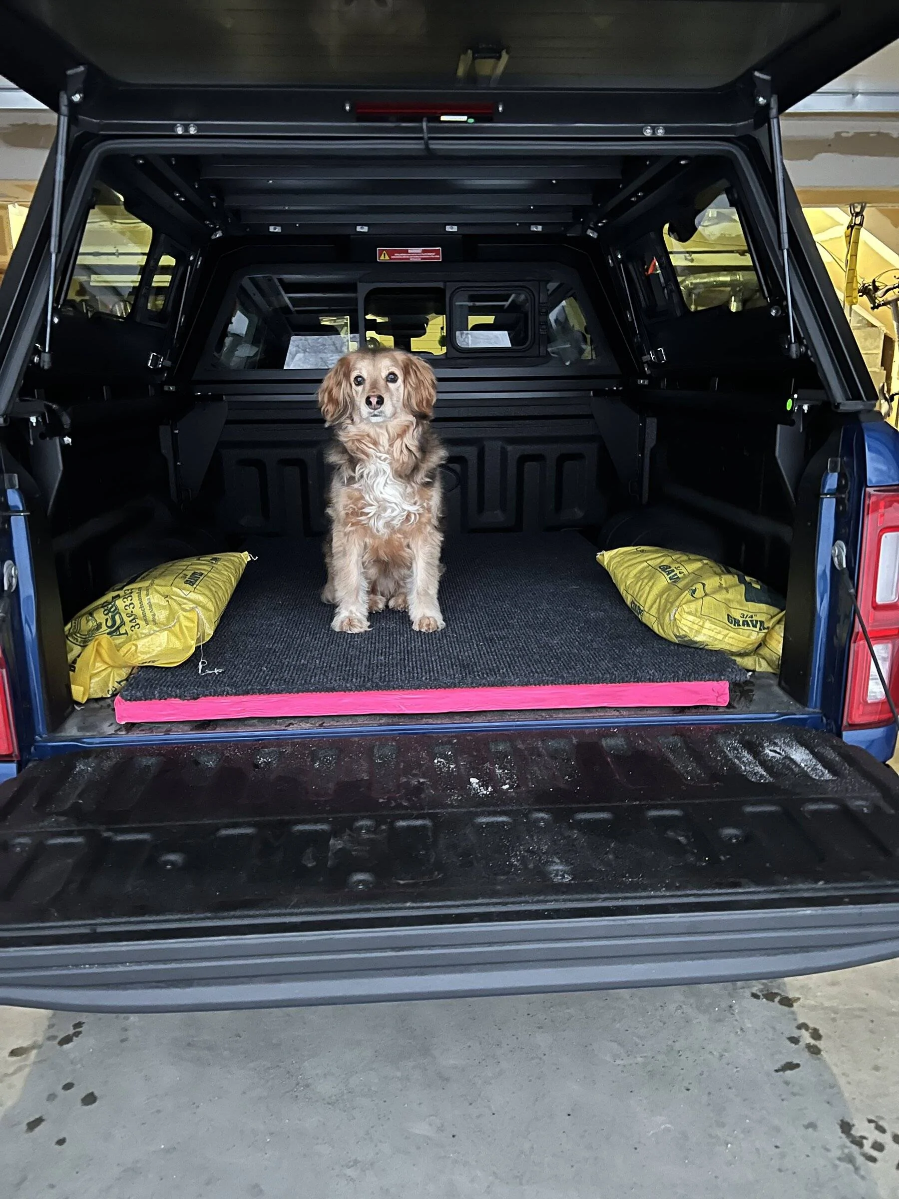

And let’s not forget the obligatory mutt in the back picture. He’s happy he gets to go on more rides now!
I could use those lock covers too!

Yes, I‘am. But the Number wouldn‘t be the way for me. Because Time Gap between Europe and Alaska and also I think the freight costs would be a bit over the top...
Would/Could you please tell us the manufacturer of these lock covers for further google search?

Pupperoni and all!!! That is so cool dude, congrats <3 How long did it take for the cap to get to you??

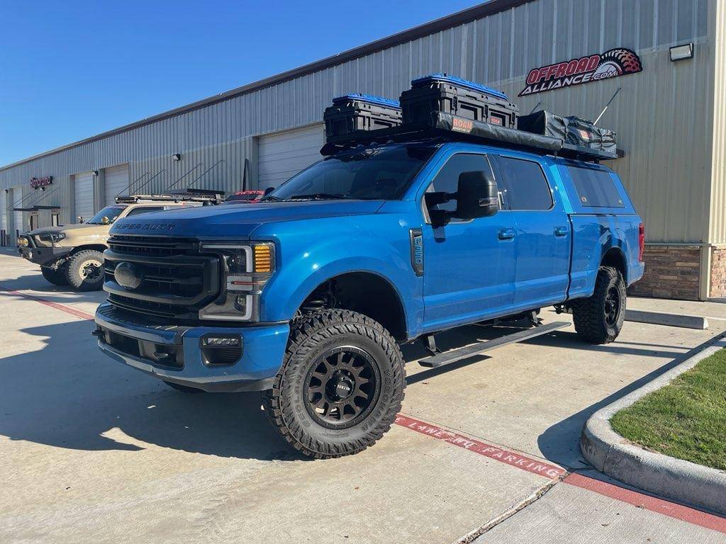

As mentioned, they do only come in black for the Evo Sport and Evo Adventure. The Commercial cap is all white. We've done quite a few paint to match caps, but only offer that service locally to our shops. Here's a Superduty build we did with custom two tone paint to match Evo Commercial cap.

I’d love to see more details on that build. My SuperDuty is in order, but who knows when I’m gonna get it with this chip shortage.

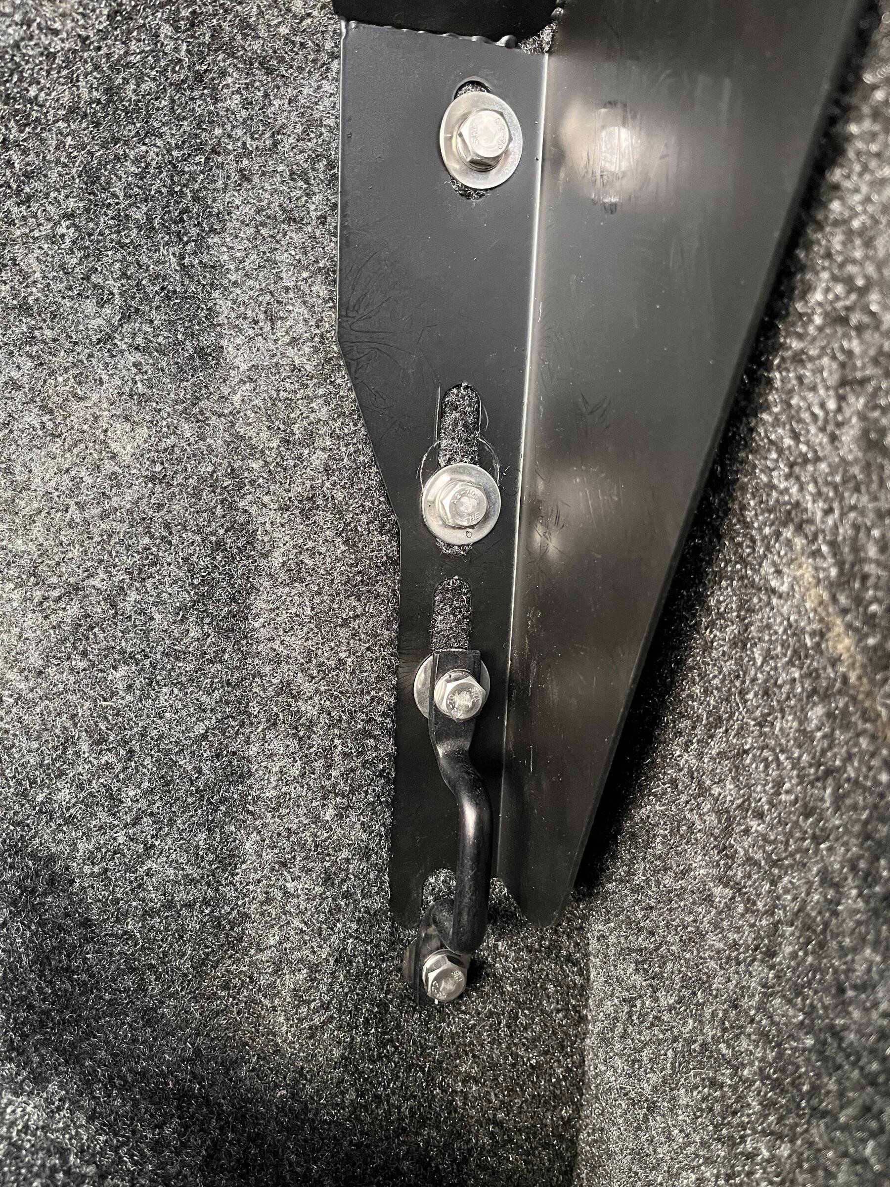

Yeah I had the same issue. Still solid after a 1000 miles including a pretty crazy snow storm a few weeks ago. I meant to contact rsi to see if they sent the wrong brackets but never got around to it.

I talked to senior rep at factory and he said that as 3 of the 4 on front are holding will be Ok as is - as for the back they will be sending out a 25mm rubber spacer and longer bolts so back ones will have full support - apperntly ranger is eastern markets differ from the us and canada maybe because of plastic bed rails on top of bed
