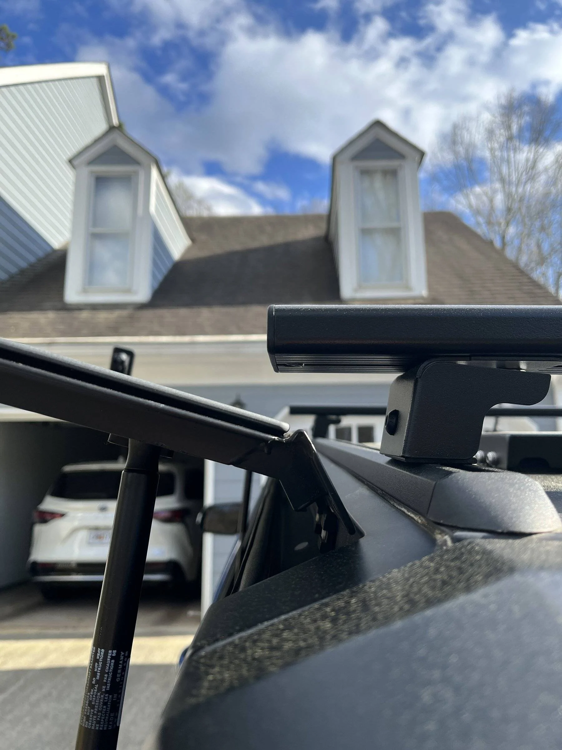

I just installed the 1165mm (45.9 in) bars from Front Runner. With the doors up there’s about another 3 inches of clearance on each side from the end of the bar to the door. Their 1255mm bars (49.4 in) should fit with the bars centered.

That’s exactly the kind of view I was looking for, thank you very much! I might just be able to fit the tent and the awning up there but it will be close.

No problem! If you need me to take any more measurements just let me know. I’m very pleased with the quality of the Front Runner load bars. I can’t speak to any differences between the RSI ones, but the FR bars work and match perfect with the cap.

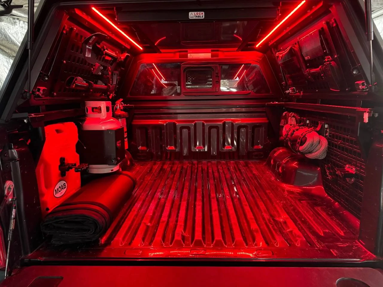

Don’t have issues with it leaking but I do periodically tighten hardware. Like any aftermarket mod just part of regular maintenance not a big deal. Recently purchased lights and wired them up with wolf haus 12v power for bed. For those interested here’s a few links. The lighting made a huge improvement can’t wait to camping now.
https://whor.us/store
https://mattgeckoleds.com/shop/ols/products/rsi-smart-cap-led-light-kit-with-bed-mounted-switch
