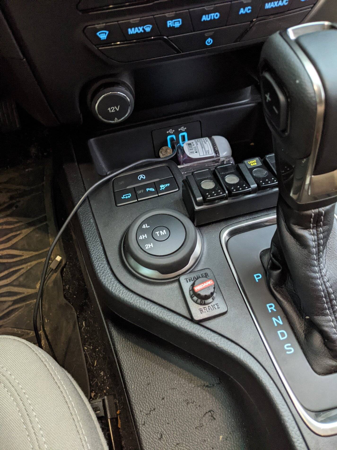

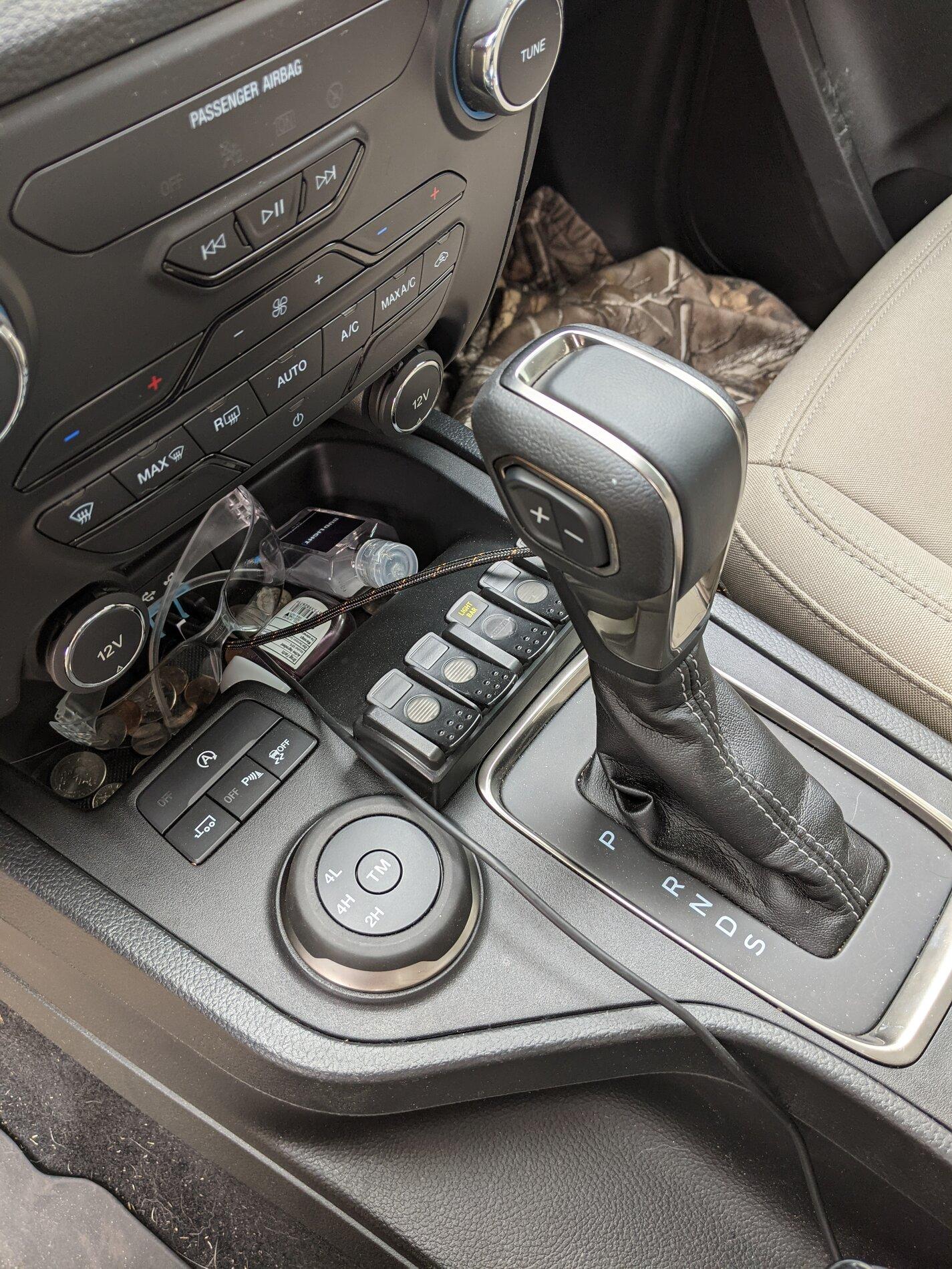

Where did you put your Trigger 6 switch panel?

I like that spot. I was thinking about the overhead console but I think I like that one better. I really want to get that same system.

I looked at the overhead originally but decided against it. The angle wasn't right and I hated having to look up for the switch. Having down on the console makes it easy to work by just feel and not having to look at it. I really like the system though and fully recommend one.

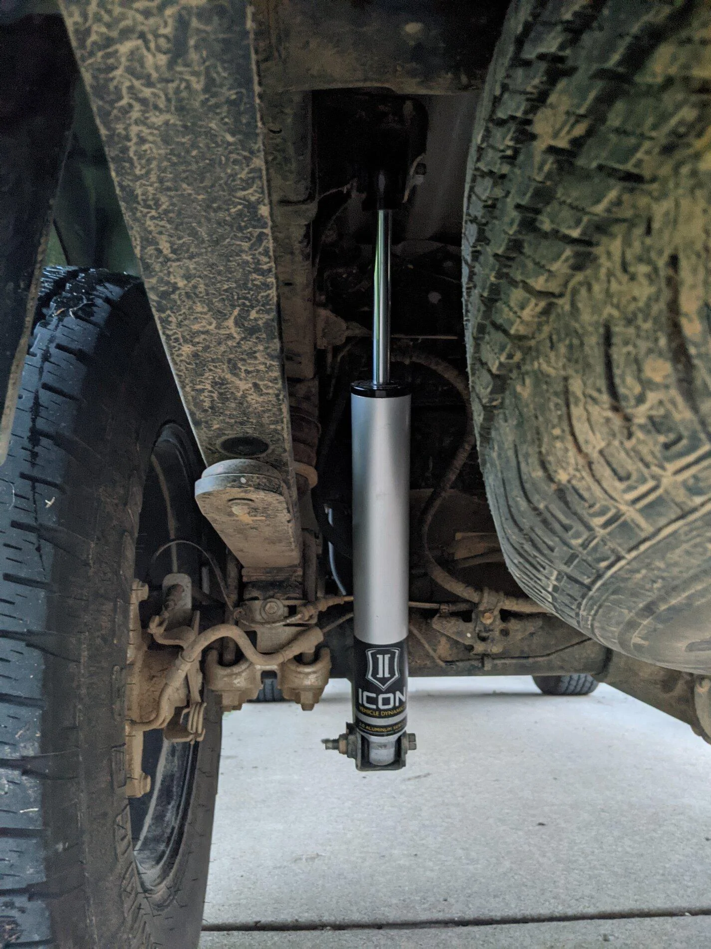

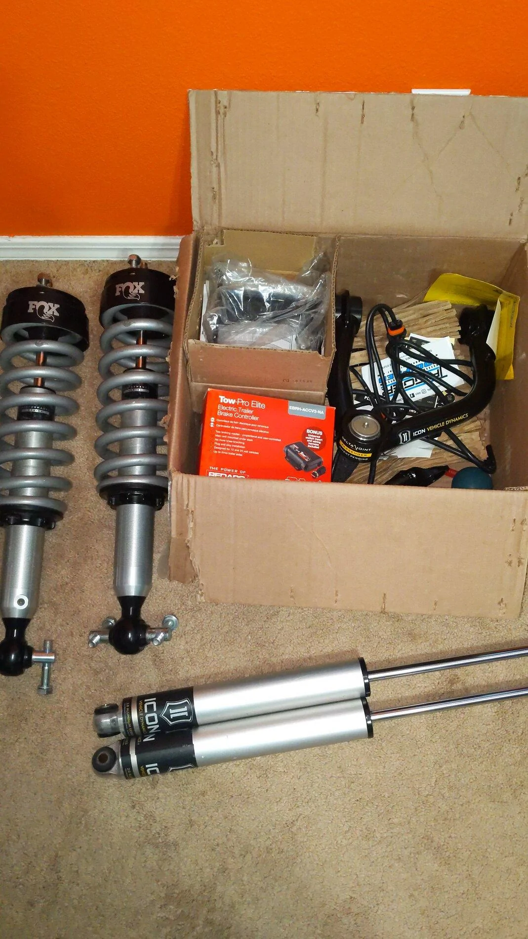

Installed Icon 2.0 rear shocks and I'm surprised how much of a difference they made. Truck feels more planted and stable. Fox 2.0 coilovers also arrived. Need to install the Redarc this month. Probably just paying a shop to install the UCA and coilovers. I just don't have the time unfortunately. The ARB skids are calling my name now....

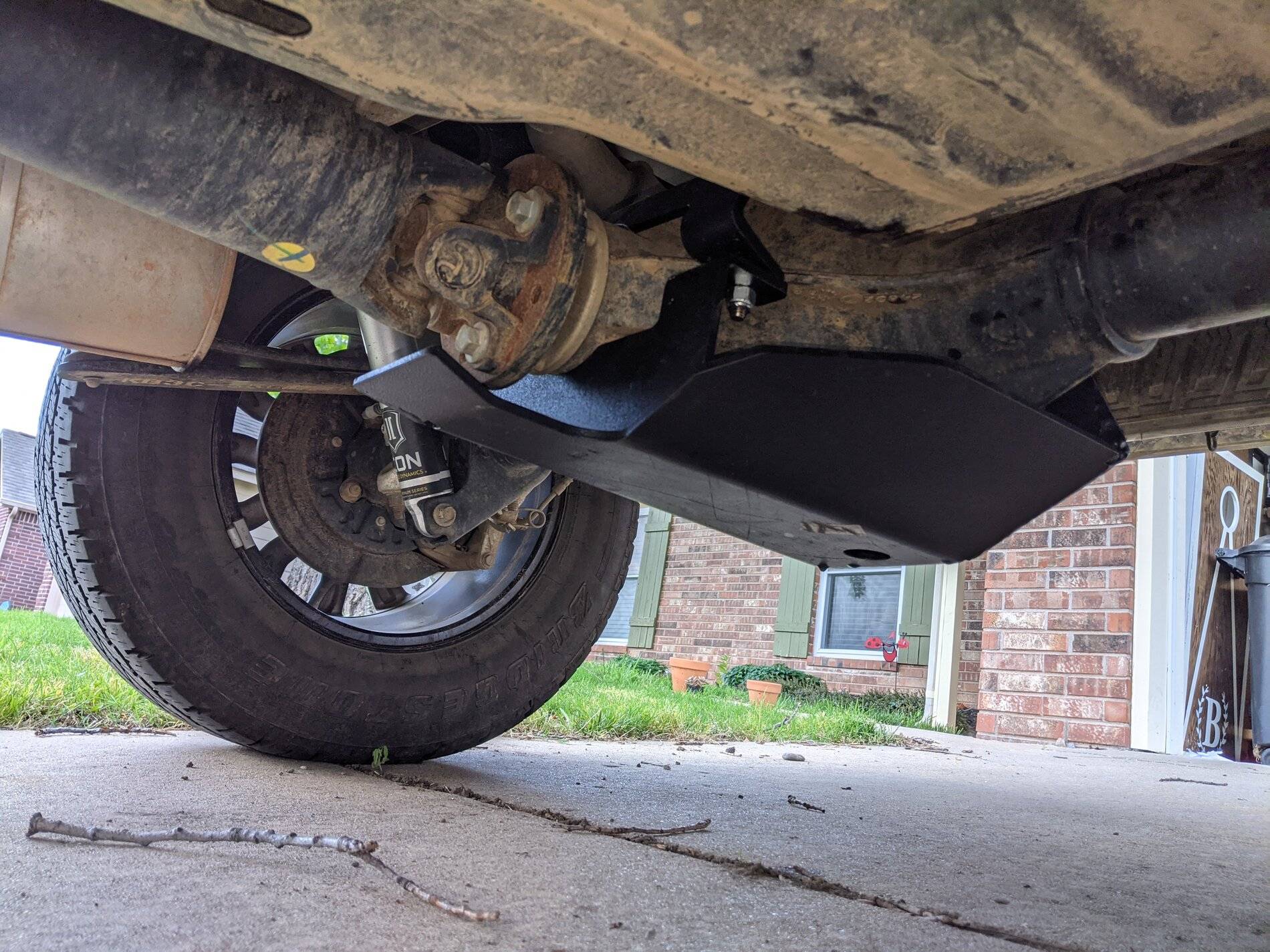

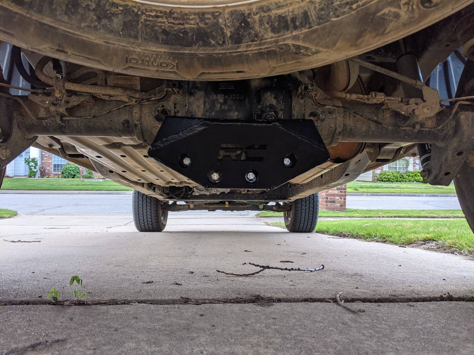

Decided on the rough country diff skid plate instead of a new diff cover. I think it'll be more protection and for less money. Got fresh fluid in the differential while I was at it to get ready for towing a camper. Also got the Redarc Tow Pro Elite installed finally. I do wish I would have put the knob closer to the shifter though. The reinforcement grid pattern messed me up. I was too focused on getting in the middle of one of those grids and misjudged the alignment. All in all I'm happy with it though!

does anyone know if the differential cover on the Tremor is a different size then the stock one? I want this skid plate but wanna make sure it'll work. thanks y'all.

Can anyone confirm that the RC Diff skid plate will fit a 21 FX4? I want one but hate having to send stuff back.

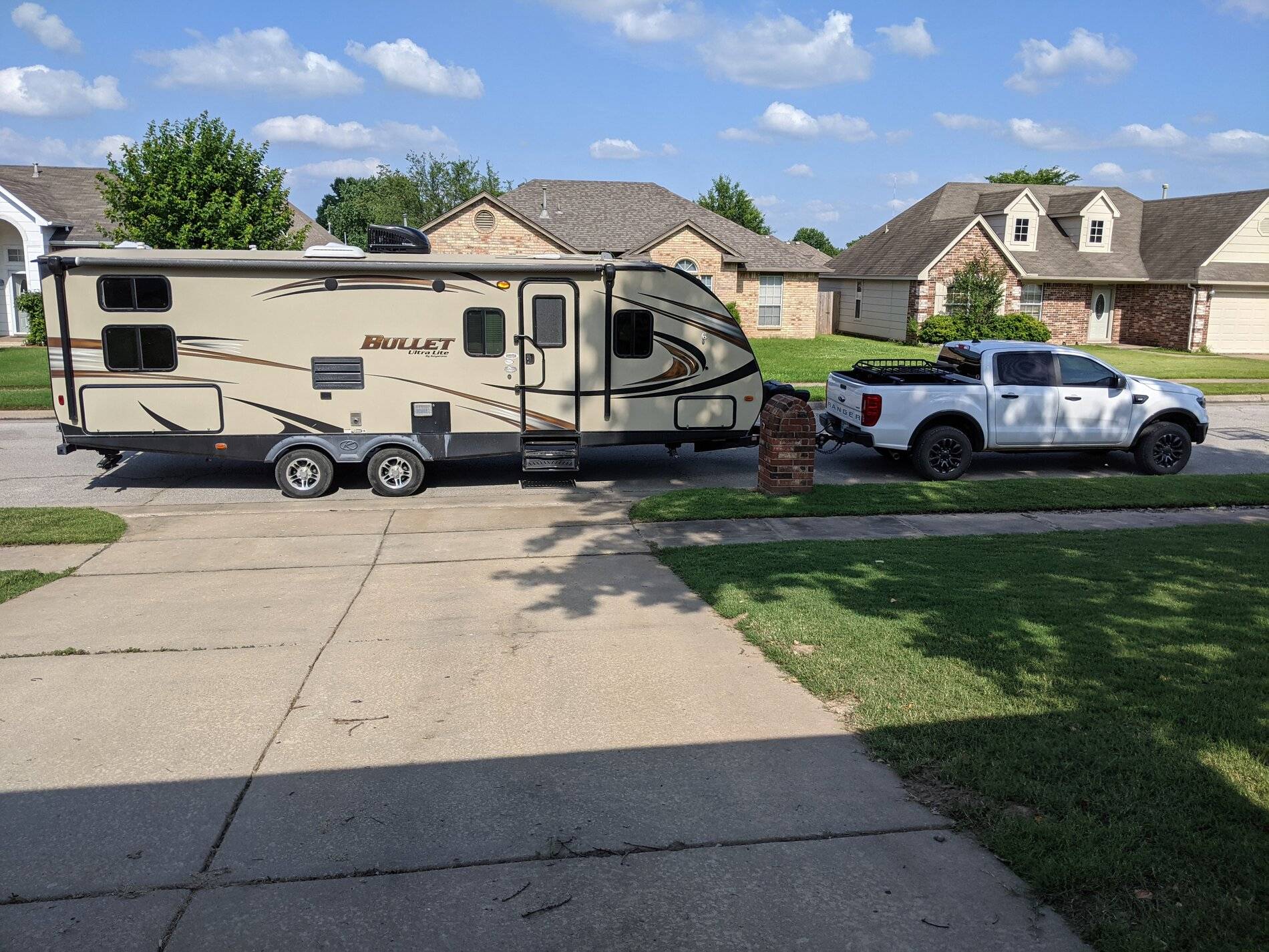

Took a trip to Arkansas with the family earlier this month. Rented a camper to take with us too. Fully loaded the trailer was probably somewhere between 6,000-6,500lbs? Pulled it pretty well for the size of it but I was definitely taking it slow. About 30 minutes outside of town though I started to get a CEL and loss of power. Truck started to shutter really bad and struggled up hills. Turned around and borrowed a family members truck to finish the trip and took it straight to the dealership when we returned. Cylinder 1 misfire caused by water around the plug. Replaced the plug and boot and that should fix it. Right now though its still at the dealership. Getting them to fix a defect in the tint they applied but the tint guy wont be there till next Friday. I really need to get the coilovers and UCA installed but I'm not paying the $750 they quoted.
