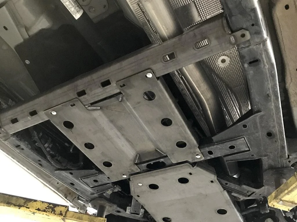

What's that long, slender piece to the right of the photo? Also, no gas tank skid in the kit?
It all looks pretty beefy! Paint them red.
Long piece is the horizontal bracket that ties in the last skid. Here it is installed on their pic. I'll have my own pics soon. No gas tank skid. No red, haha, too flashy. I actually really like the natural patina. Hope you and the family are doing well and staying safe Pat!

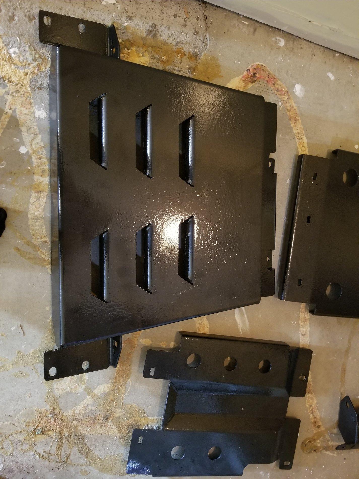

I also got mine in this week. I just finished painting them with rustoleum hammered black. I can't wait to install them and bash them against rocks. They appear plenty strong.

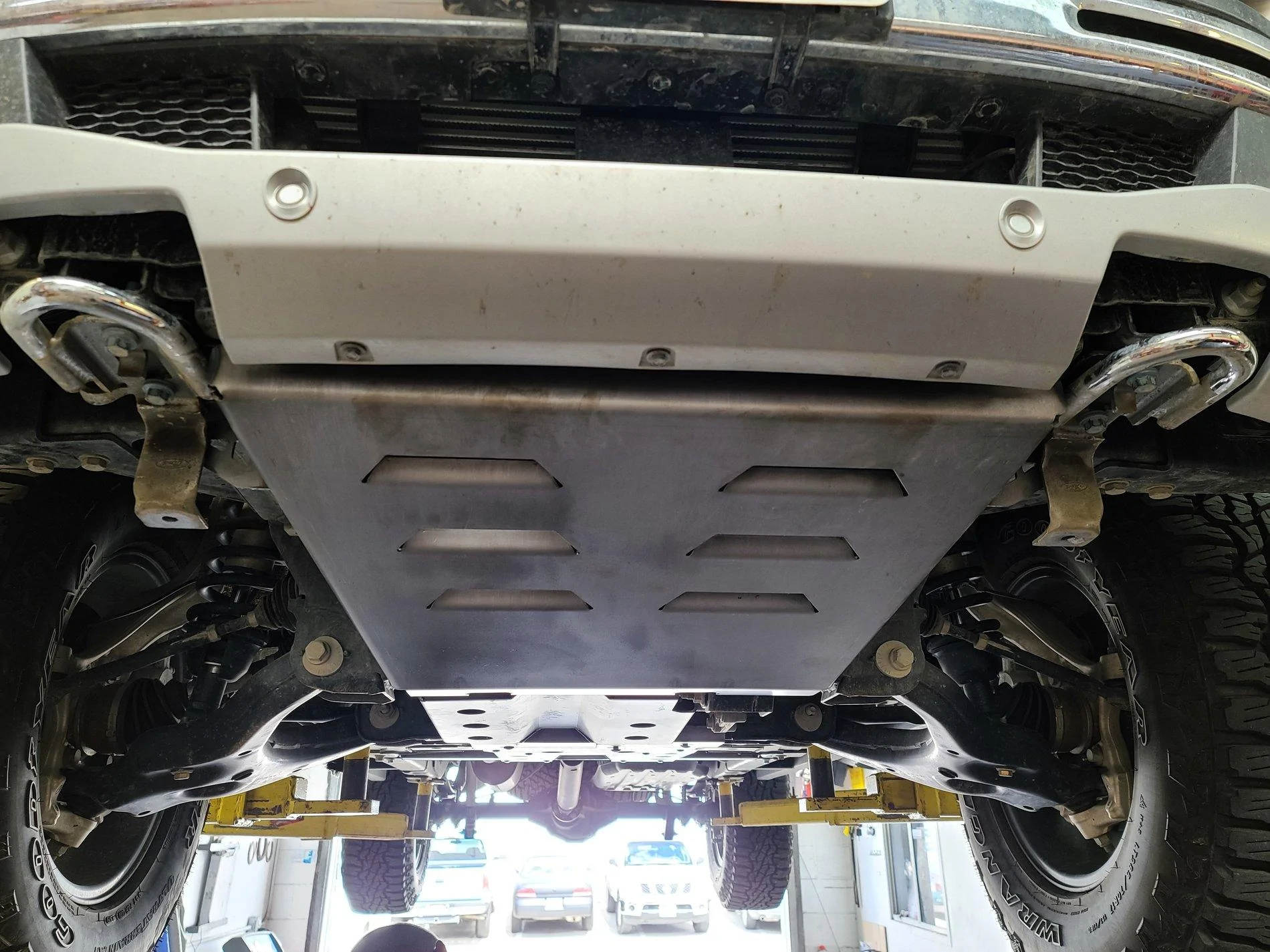

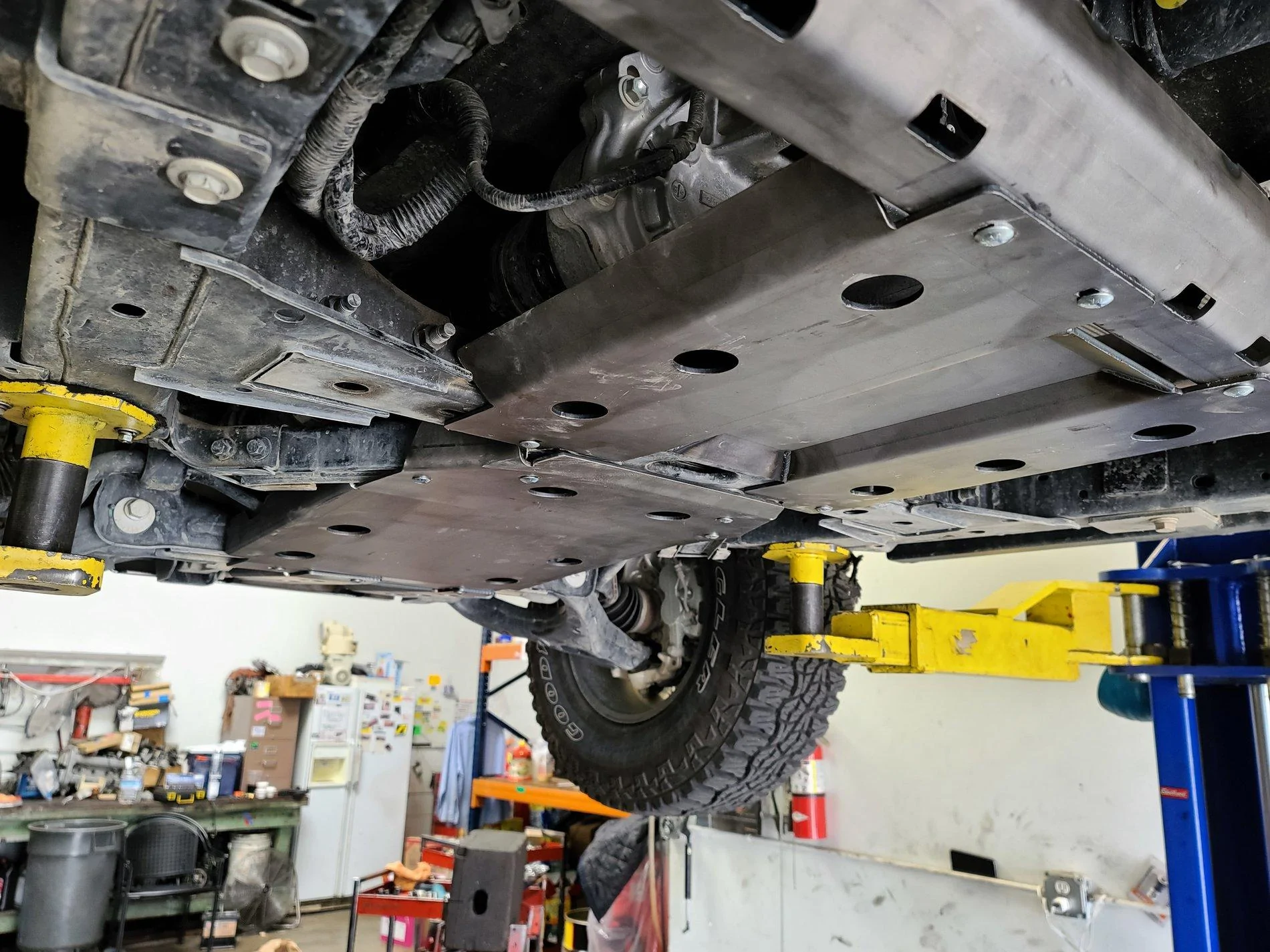

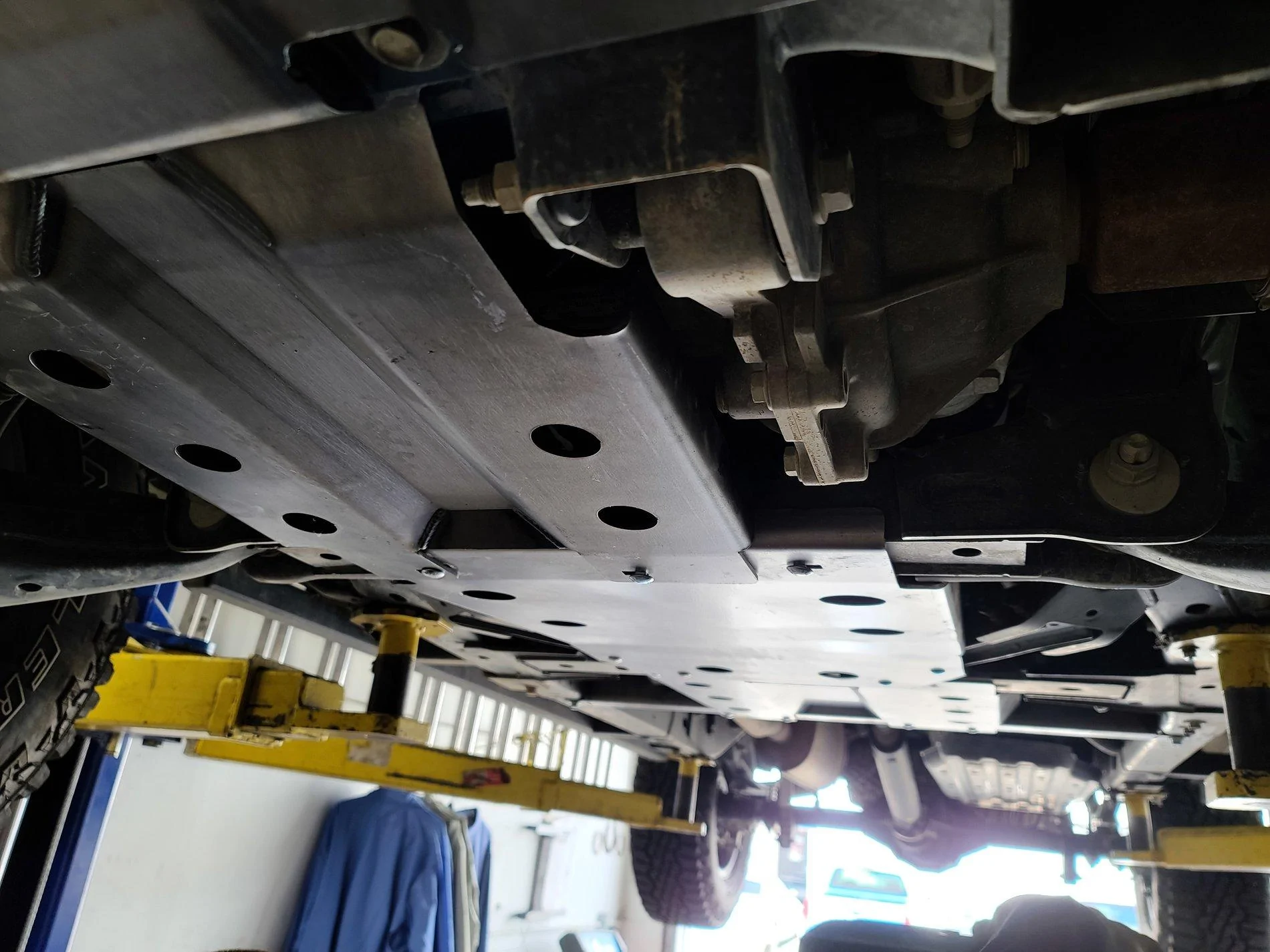

They don't use the same frame rail holes, but I highly recommend drilling the horizontal cross member into the frame.
With that in mind, I think I would still do the sliders first, since the skids will limit your access to the inside the frame rail for the front slider mounting plates and hardware. My buddy dropped the stick nuts into the frame rail the used a magnet to get it lined up to the 3/8 holes we drilled for the lower bolts.
Overall install was pretty straightforward. I will cut the extra tow hook pieces off later or not at all depending on when I get a front bumper. Leave everything finger tight so you can make minor adjustments, but the carriage bolt install makes it pretty smooth.
