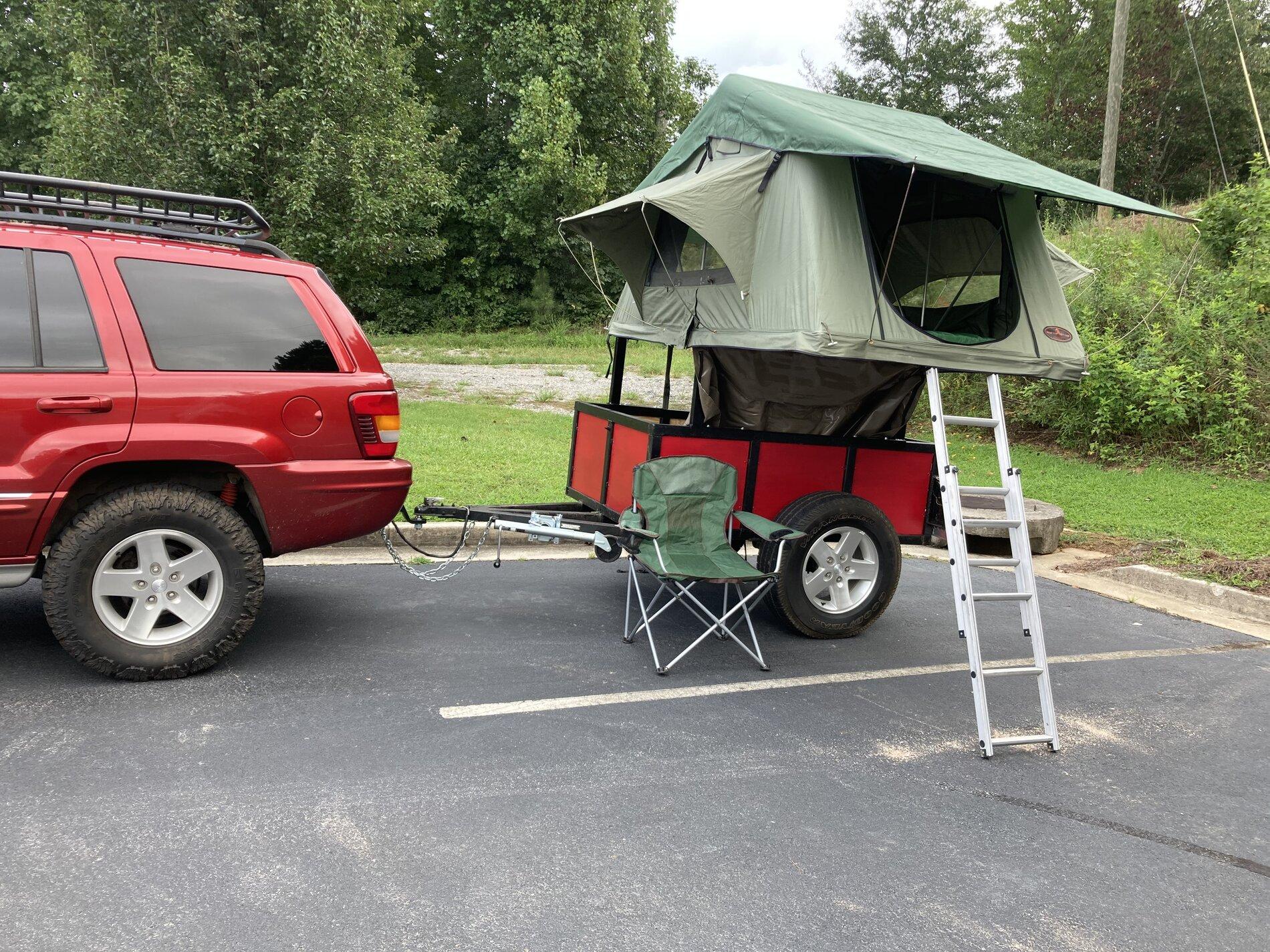

No pics in the wild and not mounted on the Ranger, but the Ranger can surely pull it.
I actually used to have this tent mounted on the roof of my former SUV, but the wife didn't like the climb and I didn't like having to close everything up to drive the vehicle.
So, I bought a 4x6 utility trailer off CL and built it into this.
I've had this tent several years now.
Thinking about getting a Free Spirit in the spring.

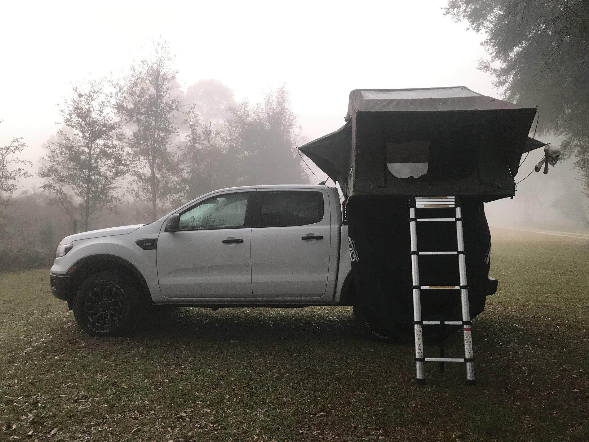

More of my CVT Mt. Shasta and my brother has a Smittybilt Overlander XL Gen2. The fog sure gave it a Silent Hill vibe.

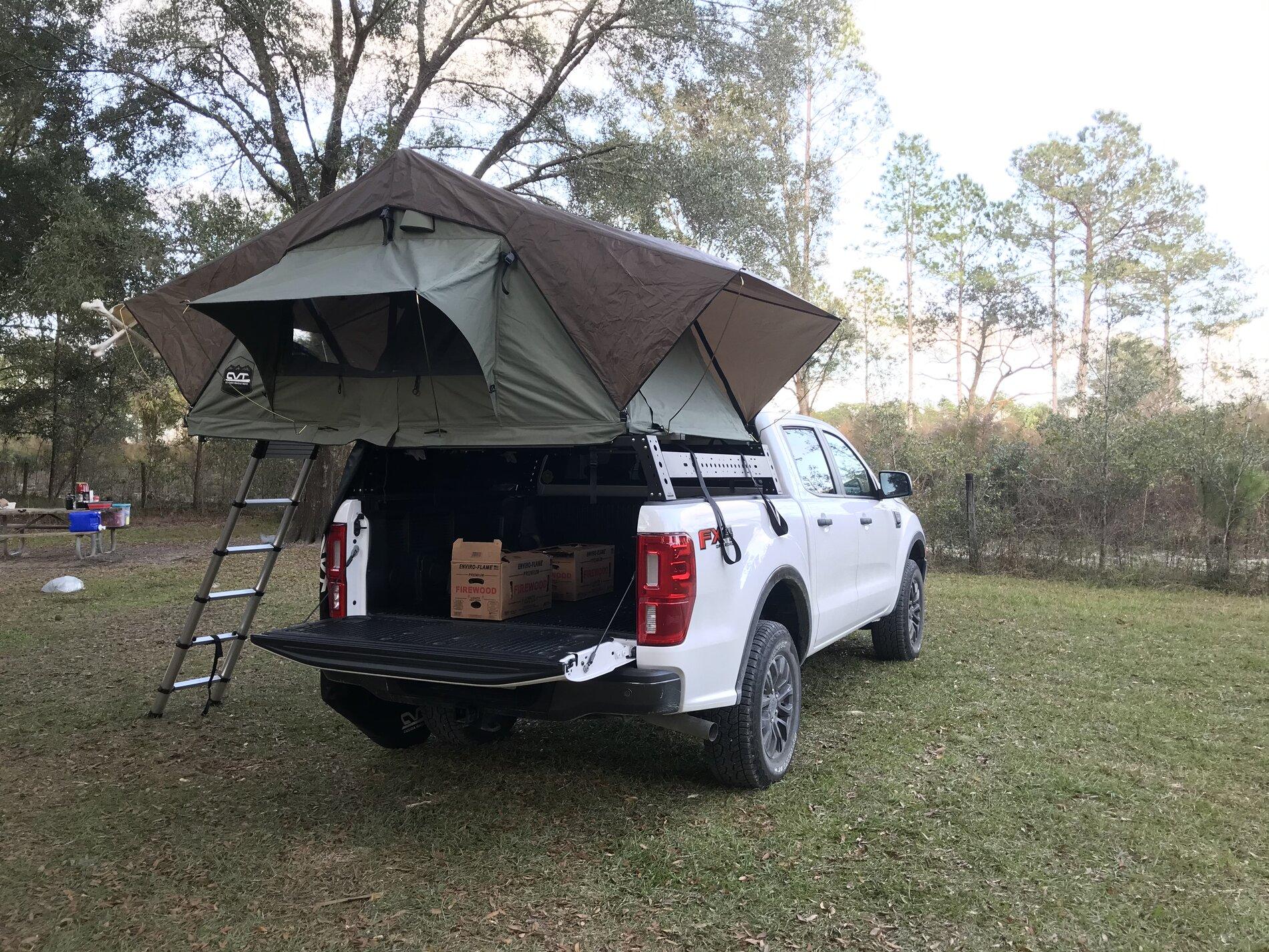

Here’s ours, we’ve had it 18 months and just spent our 16th night in it. Surprised at how much she likes it. Home made rack on Retrax pro cover.
I haven't run the numbers on the weight situation there, but we also have the Retrax pro and have had great success utilizing Yakima cross-bars for extra gear. Would these have worked for you, or did the weight required necessitate the home-made rack?

I actually found a “mother lode” of aluminum 1X2’s locally for free (long before i even bought the truck) so I never considered using anything else.
did you build the risers? if so, could you share details of materials, etc,
76
6,666
40,686
Living The Dream
I did, sort of.
A buddy gave me an old ladder rack off of a truck he bought.
I used the 2x3 rectangular tube uprights from the ladder rack to build my uprights.
They already had the right angle brace at the bottom so I just cut them off at the height I wanted and then welded in a 2x3 plate of 1/4" steel on the end.
I drilled and tapped a hole in the center of the 1/4" plate cap to bolt on the crossbars.
I still have a lot of steel left from the ladder rack and I'm going to use some of it to make a kayak bracket to fit on the front wall and the tailgate.
That way I can carry all 4 of our kayaks with 2 on top of the trailer body and 2 on the racks where the RTT mounts.
I should still have enough after that to make an awning mount rack.
Gotta get some fenders on it first though :)
