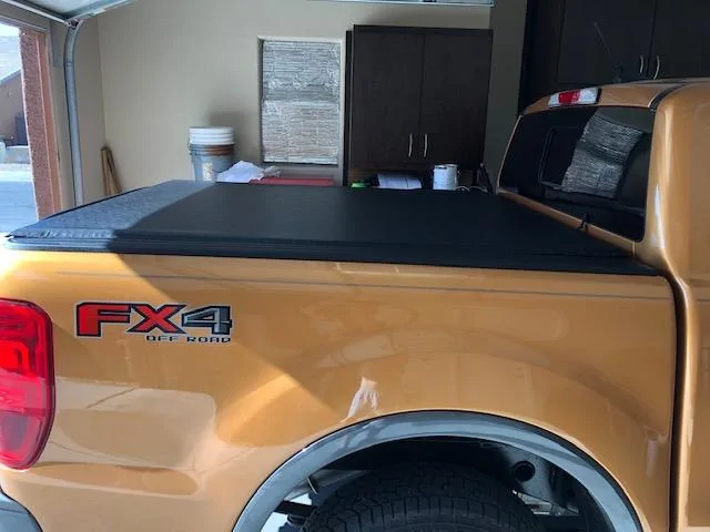

Easiest way to tell is if yours has the Fx4 on the back of the rear quarter panels.
Thank you! Yep, I do not have that package, definitely not. I basically just wanted a base truck with nicer looking wheels/rims. :)

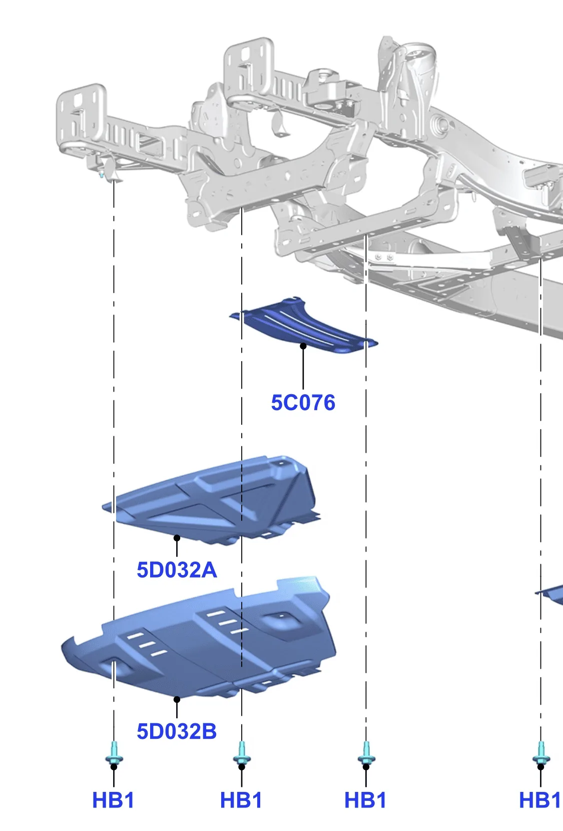

If your truck is a 4x4 then yes there should be a skid plate. If it is a 4x2 then no it does not have a skid plate.
The FX4 has the 5D032B, it's painted an aluminum color, the std 4x4 (non FX4) has the 5D032A skid plate, it's smaller and just not as snazzy looking.
More here: Skid plate

Wait, I thought 5D032A was just some sort of liner for 5D032B. Did you mean all the other trucks have 5C076?
Look at the link above. There are pictures that answer your question.
Skid plate
Yup, thanks. I thought I remember reading something around here for the FX4 skid plate upgrade that some people do, it has a liner for noise control and I thought that was it in the picture above.
I can confirm that I have 5D032A on mine. You either have 5D032A, 5D032B, or none.

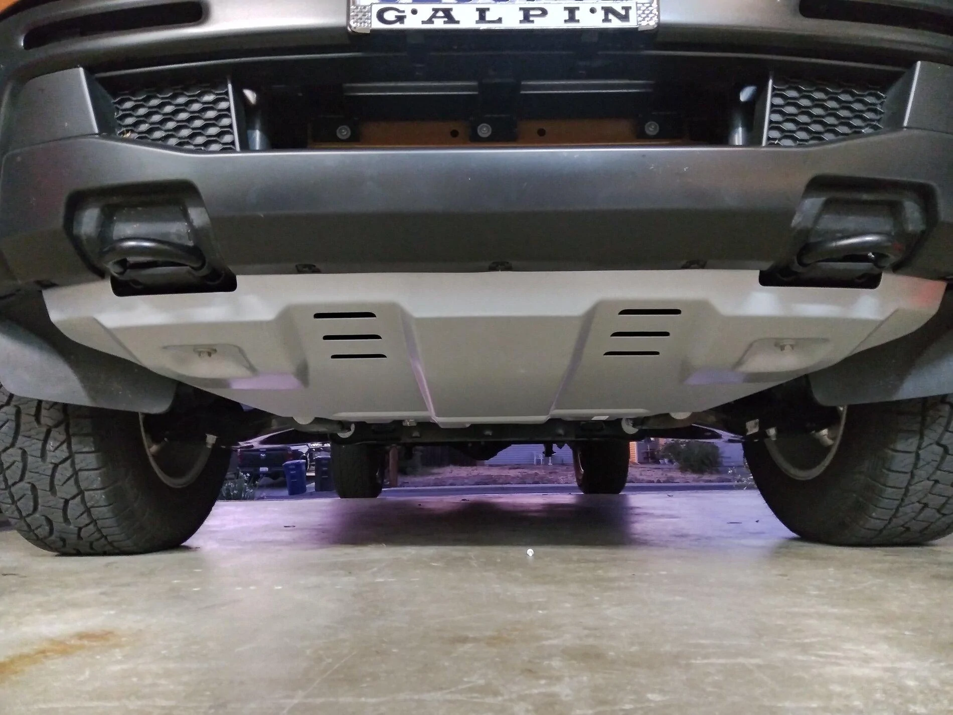

No Engine or Trans skid plates on ANY 2wd model, not even the FX2 (ask me how i know, oh, i have a FX2- but you do get a piece of silver plastic that looks like 1/2 a skid plate on the FX2! -yes, really.) No worries though, super easy to add them both. Trick is, you need to buy 4x4 Tow hooks, as these have the welded on brackets that the front plate bolts to, 2wd ranger hooks don't have the brackets welded to them. the trans plate will bolt right up to any Ranger, no parts required. just added mine tonight! Don't forget the 6 bolts you'll need. Trans and Engine share 2.
Oh, and it's the Trans plate that need removal on an oil change, not the engine one!
