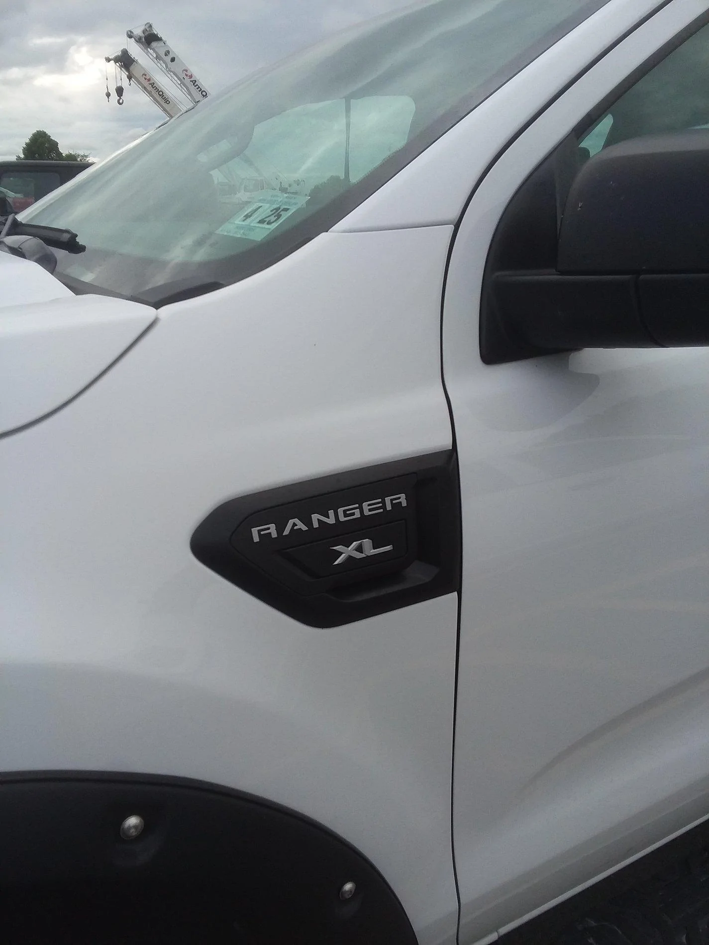

I don’t know if that’s correct. I have a base XL no FX4 package. And my truck has skid plates.
Oh wow...I stand corrected. Thanks.
Can you get a picture? Per specs, the only NA Rangers that have skid plates are FX4 models.

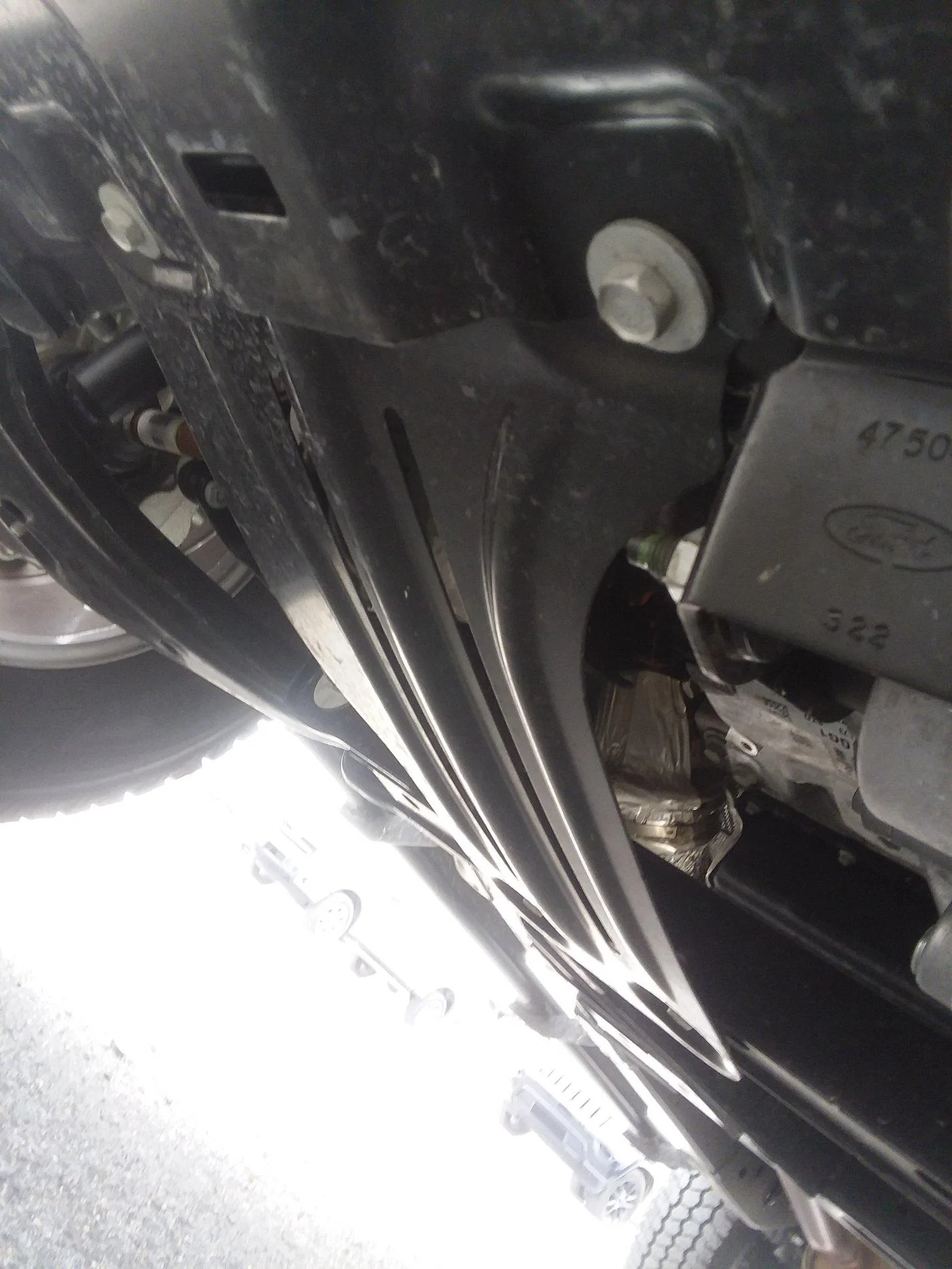

Here ya go. I believe the op is refering to the plate in the first photo. Its held on with 4 bolts. Only the back 2 have to be completely removed for an oil change. (Losen up the front 2 and slide the plate backwards) The xl 4x4s have plates. They just aren't as sexy as the fx4 stuff.

Here ya go. I believe the op is refering to the plate in the first photo. Its held on with 4 bolts. Only the back 2 have to be completely removed for an oil change. (Losen up the front 2 and slide the plate backwards) The xl has plates. They just aren't as sexy as the fx4 stuff.

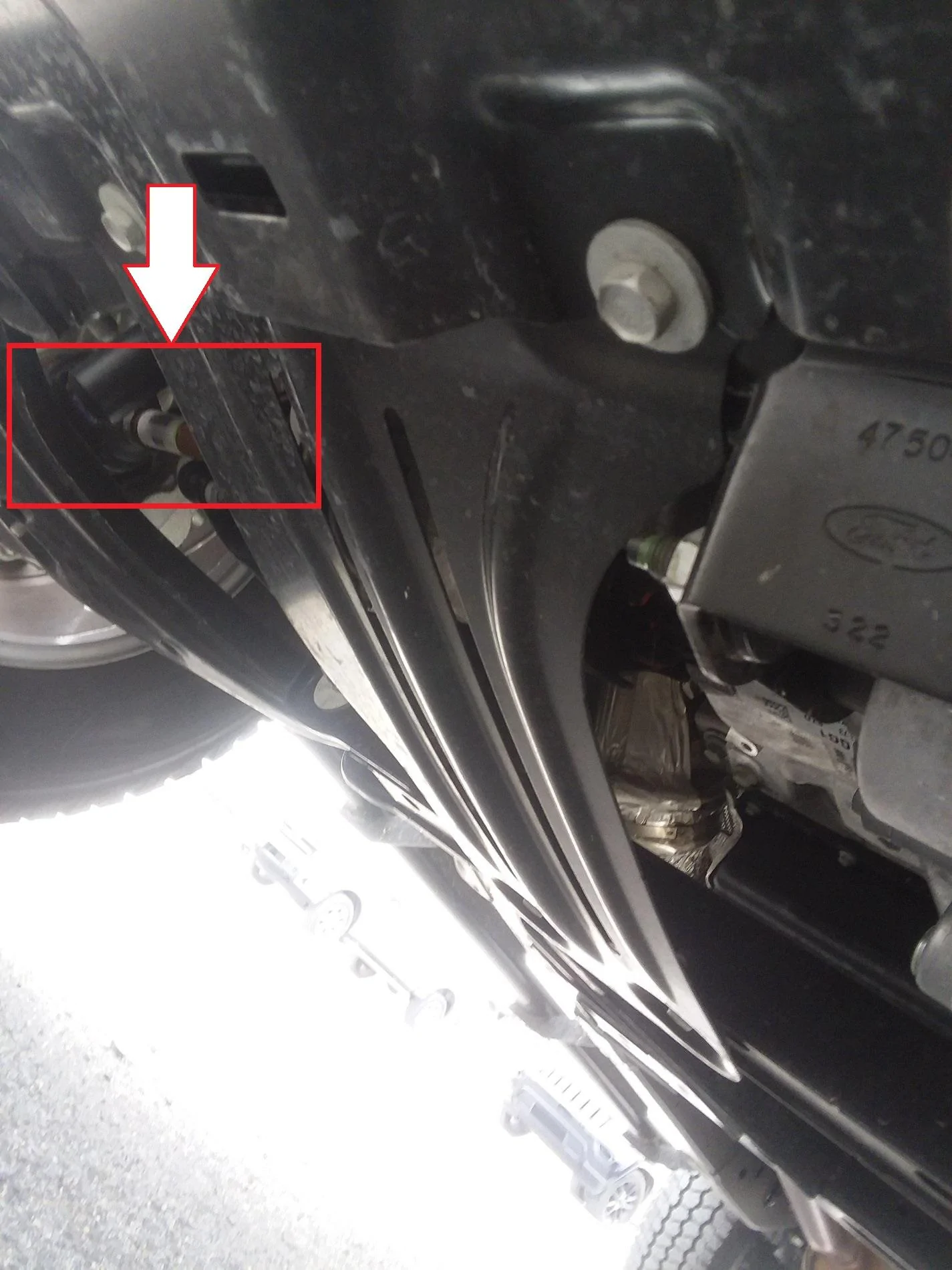

You can see the half shaft in the photo... he has a 4wd
Yep, see that! Maybe 2WD’s don’t have the skids, as I see on some online instructions for oil change says to “remove skid plate if present”.

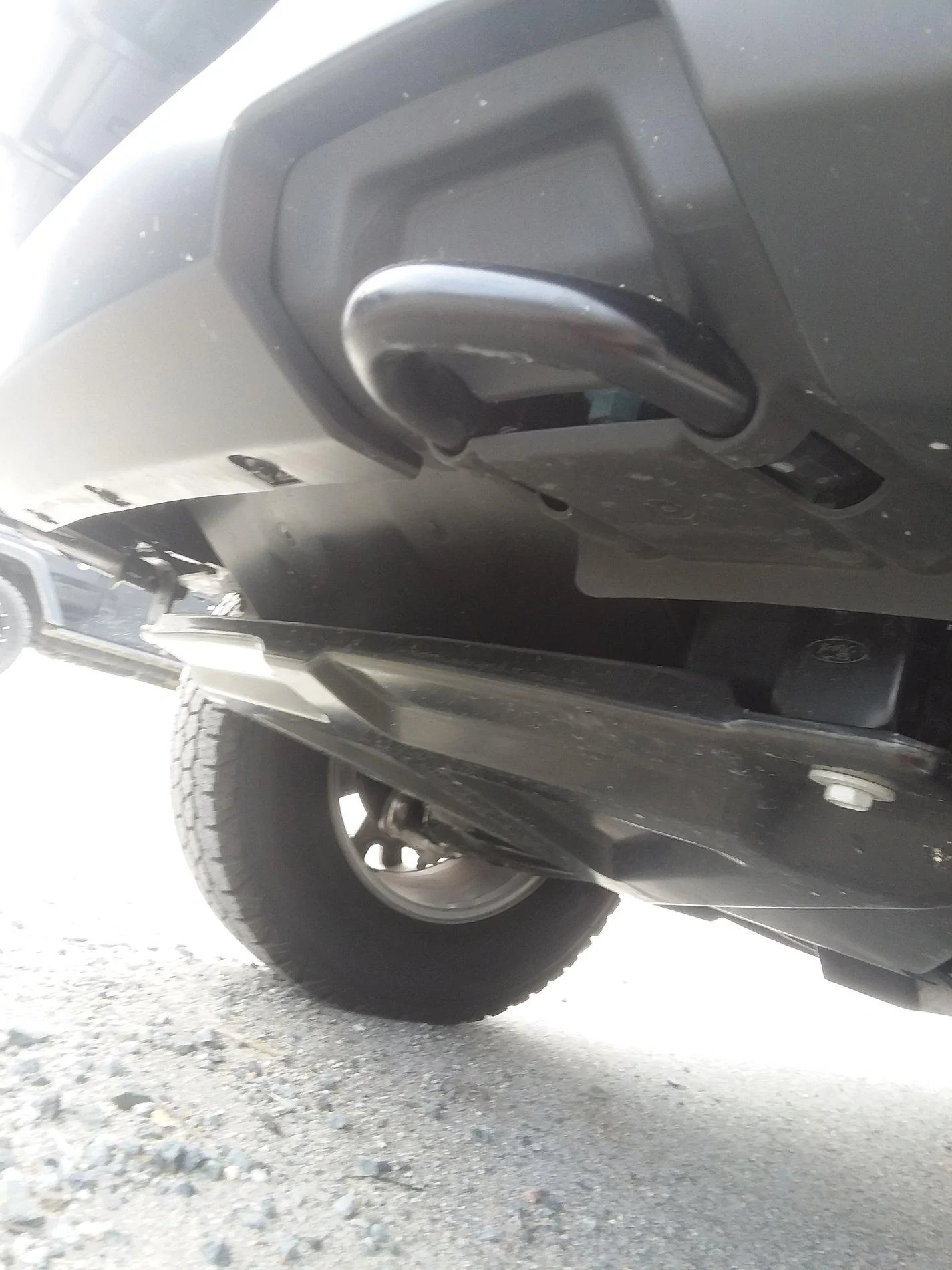

this is what I think of as a Ranger skid plate
