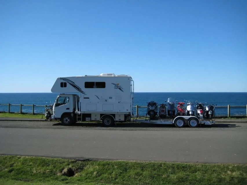

1. Is the rear end suppose to be lifted that much higher than the front? I imagine its like that for heavy loads but I haven't seen any other truck brands with such a lifted ass. Does that bother anyone else?
My Fuso cabover rode pretty high in the back. I took 2" out of the spring pack and it leveled out nicely.
