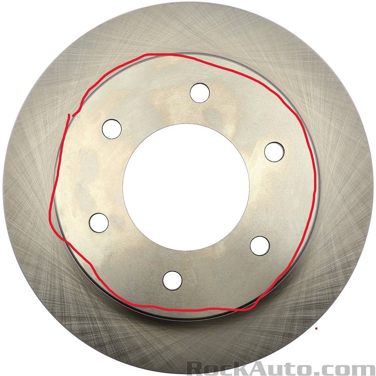

I was thinking the same thing but found that the rotors are part of the hub casting (not a separate part).
I am talking about this - The Rotor Hub (Hat)
If this is distorted it will cause the wheel not to sit flush (O/B) side and not flush (I/B) side to the Hub Assembly.
Improper Torque Procedures are the main cause of this, and with the OP stating that the issue arose just after wheel / tire swap and then reinstall of original set - with same results leads me to this as a highly possible area of concern.
Sometimes even proper torque procedures can bring this on, it has to do with the memory properties of the metal and the heat that is generated by the braking action.
Warpage in this area does not ALWAYS cause brake pedal pulsation but will cause the wheel to wobble (side to side) when rotating.
Now with that said, yes it could be an alignment issue or driveshaft issue or worn suspension bushing's etc. but with the issue coming on just after swapping the wheels, I am focused on this point as a highly possible point of issue.
