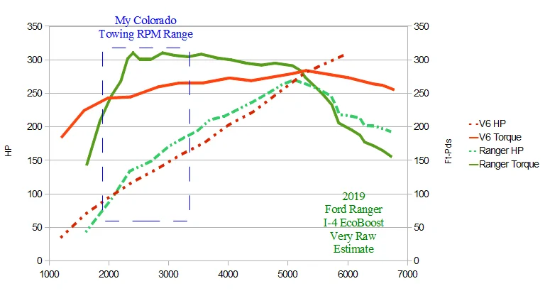

If this engine were a Subaru FB 25 flat 4, which below 1900 rpm it makes barely enough torque to turn its own crankshaft, I'd be worried; however, if you take a look at first, the design of the 2.3 (long stroke=high torque), second at the tuning/turbo boost and gate settings, you will quickly realize just by looking at the steepness of the torque curve, that it indeed has plenty of torque at 1500 rpm to handle its own weight and the truck, especially at 60 mph...one little twitch on the skinny pedal and it downshifts to peak torque (310 lb/ft @ 3000 rpm). In comparison to my old Ranger with the 3.0 vulcan with a 5-speed manual and 3.73 gears, this combination truck engine/tranny has GOBS of low end torque; take a look at this shaft HP/torque curves someone plotted to compare a Chevy Colorado to a 2019 Ranger:
The solid green line is the Ranger Ecoboost....The 3.0 vulcan in my old Ranger was rated at 150 HP/185 lb.ft peak...at ~1650 rpm, the ecoboost makes almost as much as the vulcan did at peak...at 2000 rpm it makes more torque than the old SOHC 4.0!
not worried in the least...
That graph says a lot. I'm amazed at how much torque these ecoboost engines have at relatively low RPM - they are approaching diesel engines.
