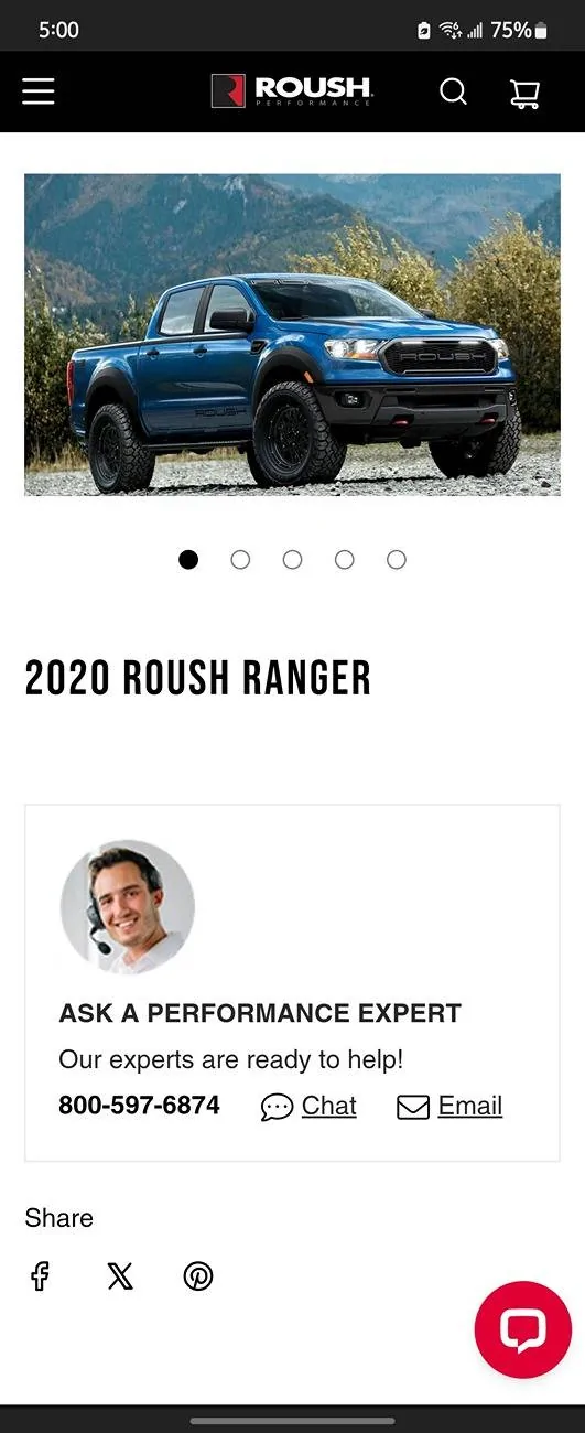

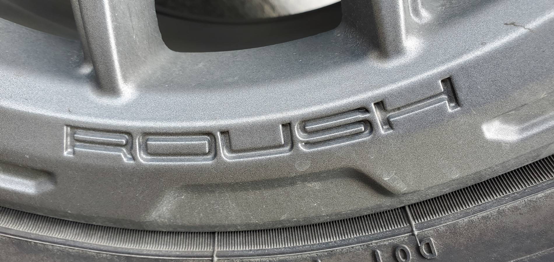

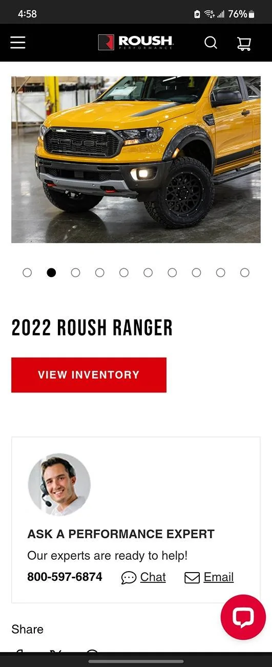

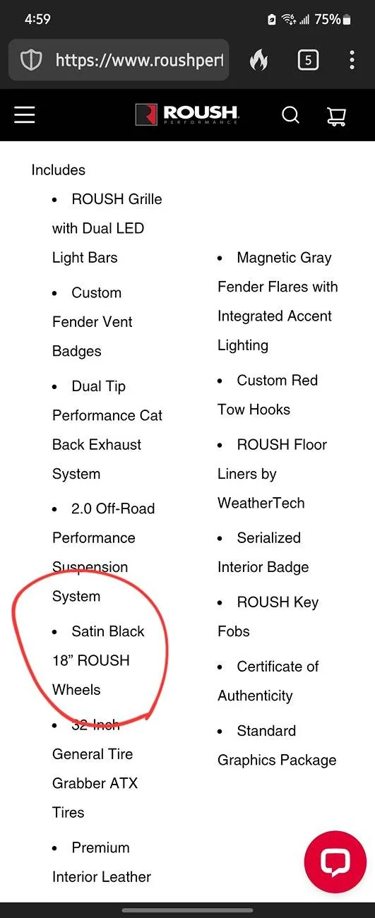

All the Rangers built by Roush ('20, '21, & '22) came with the Satin Black 18" wheels. The 17" Roush wheels were never an option. I like my 18s. But if I ever did switch to 17s, I would definitely consider the Roush wheels.

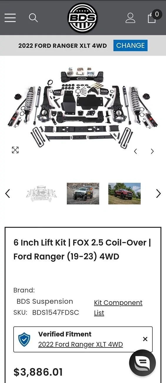

I've considered the 6" BDS lift with the Fox 2.5s, but I'm not sure i want to go that high. And I worry about how it would affect on-road performance.
Yup, the roush ones that grandaccess has are geared towards the bronco.. 17x8.5 +25 offset.. i actually really want them.. the ones on the roush ranger are a 18x8.5 +40’something offset (could be totally wrong on the offset tho)
I believe BDS claims that its lifts are designed well enough that the factory stability management, traction control, and terrain modes will all function correctly… I forget all the specifics but hearing/reading that somewhere is why I think bds is the way to go.. 3.5 or 6 is just gonna depend on how tall of tires… unless you really need/want all the ground clearance

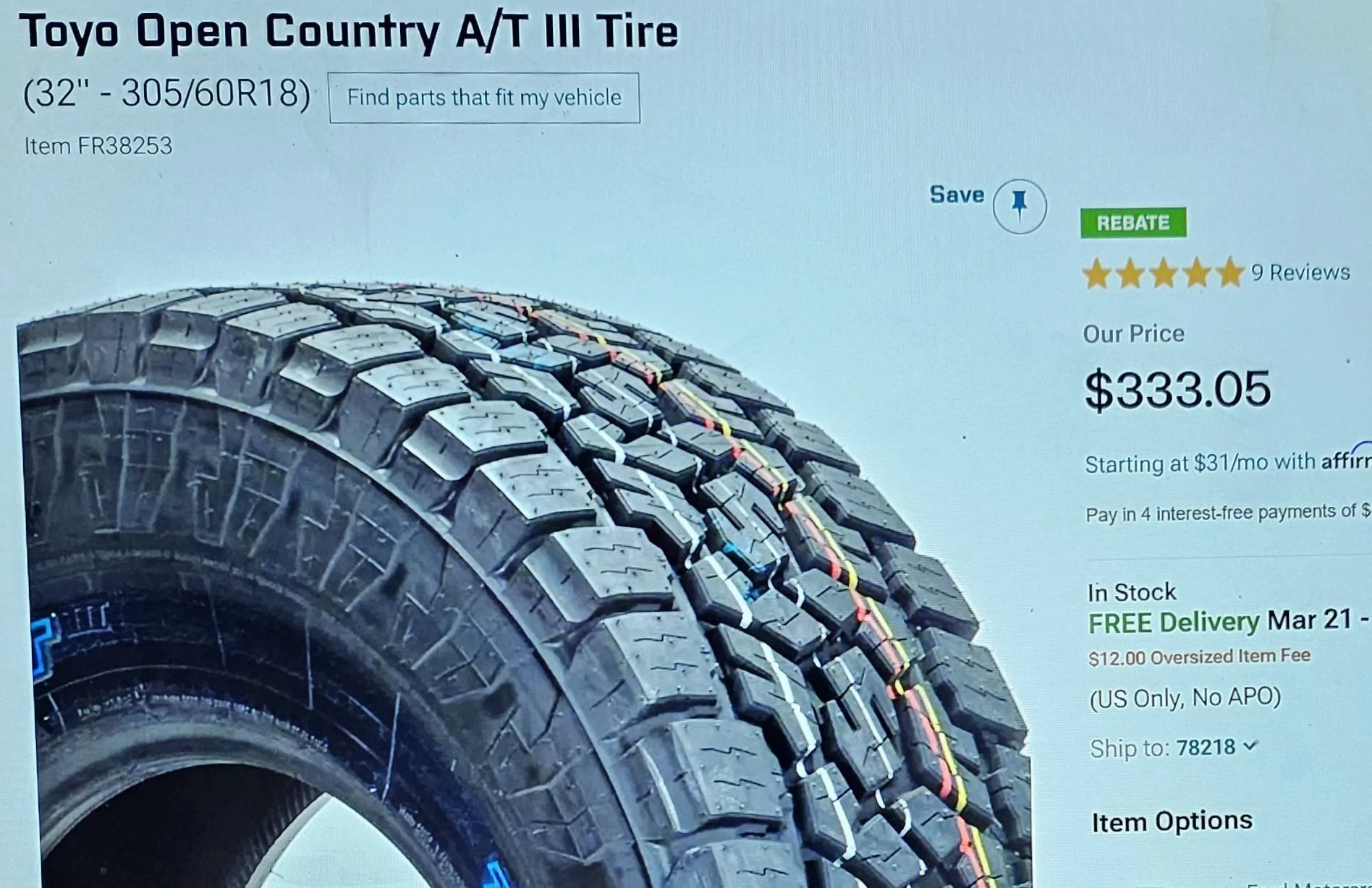

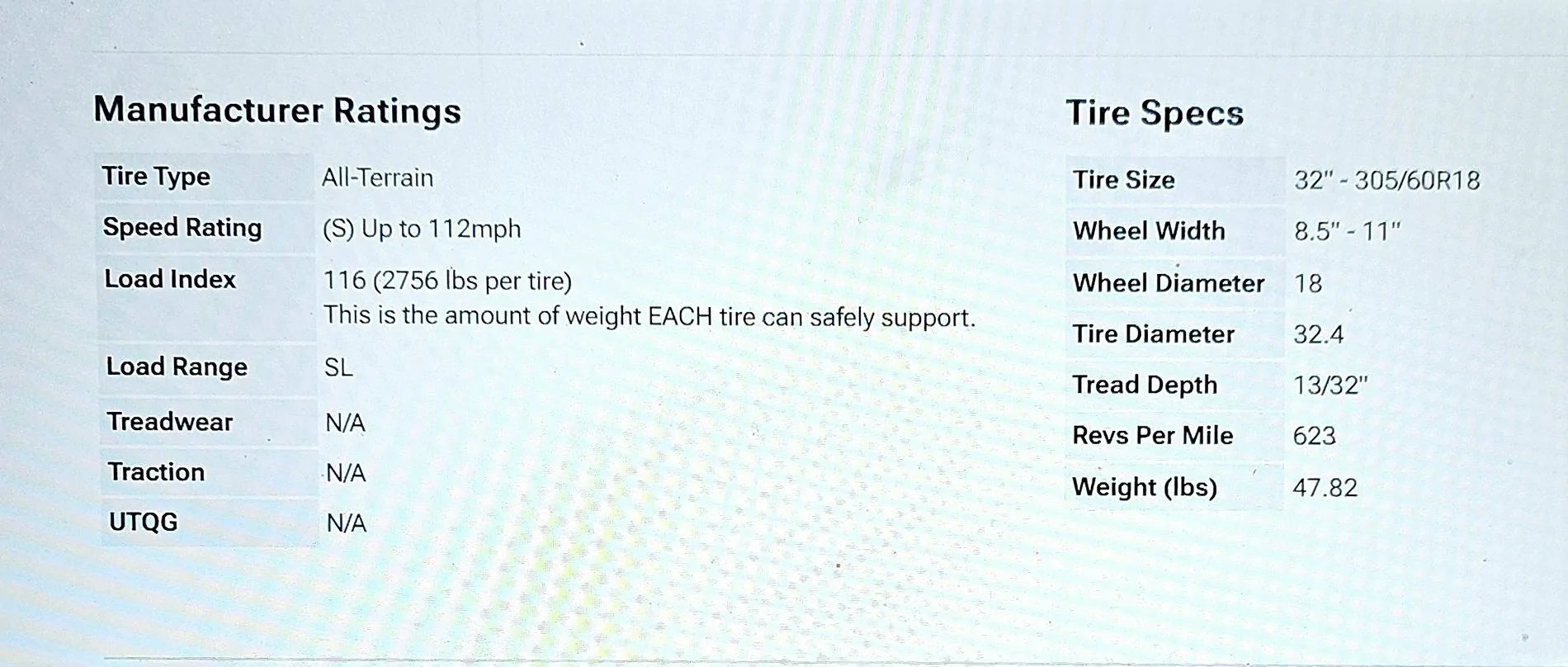

I totally agree with that. I could keep my current suspension set up and simply add the Fox 2.5 shocks on all 4 corners for less than $3k. Those shocks are definitely worth the price. My truck is 95% street princess and 5% off road. Google Mars Family Off Road Park in Lin, Texas. That place is a blast to do easy trails, tight trails, small hill climbs, small mud runs, and a dirt drag strip. There's nothing extreme there. I could go almost everywhere in 2wd. My current set up is fine except for the 4 or 5 places where you can apply WOT. I just want to install better UCAs and the Fox 2.5s initially. Dial it in, and then decide if I need more travel. I would love to find a 4.5" Long Travel Lift Kit. I'm not sure if such a thing exists in the real world. The tires I had my eye on were the Toyo Open Country A/T III Tire(32" - 305/60R18) weighing in at 48 lbs.

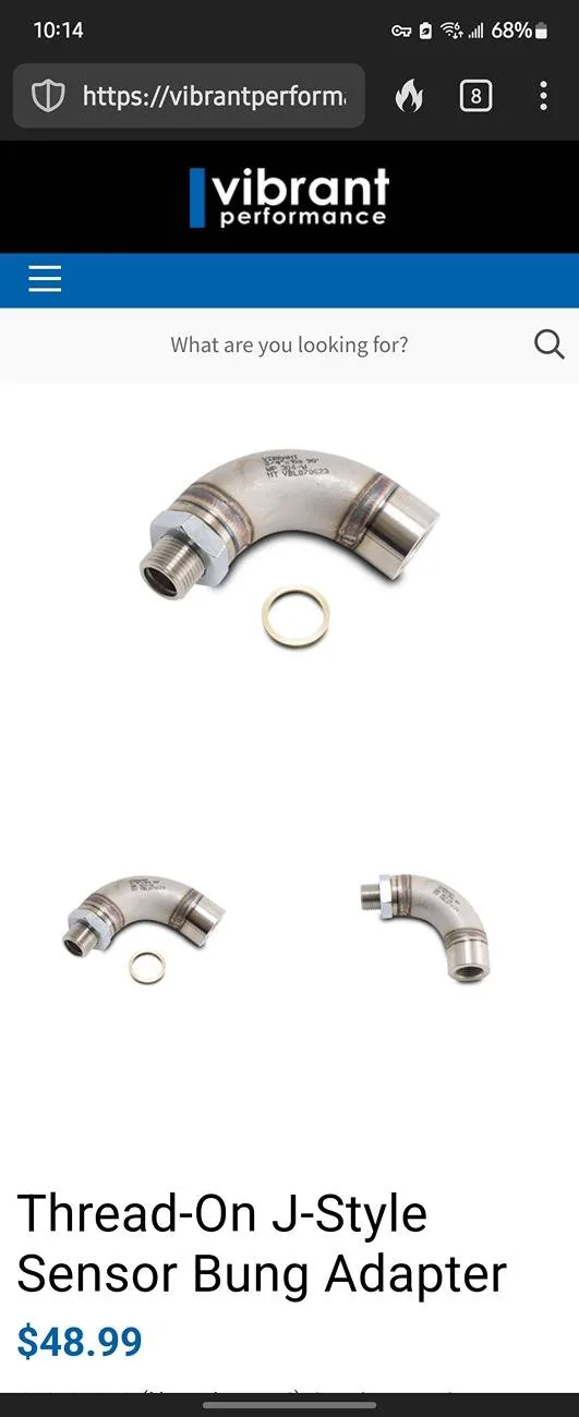

Yes. A LOT. It got a lot louder and there was a noticeable power boost. Just don't go with the 3" mid pipe. I did and it was loud in a horrible way. I went back the next day to cut it off and weld it the stock 2½" mid pipe. Now it sounds sound in a good way. Just make sure you have the O² spacer to avoid throwing any MIL codes. I think CVFab includes the O² spacer with the units they sell now. But mine didn't come with one.
