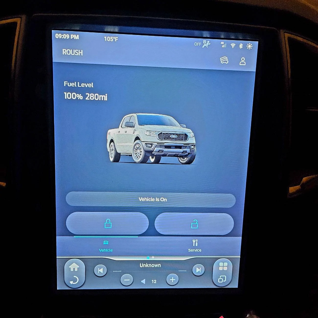

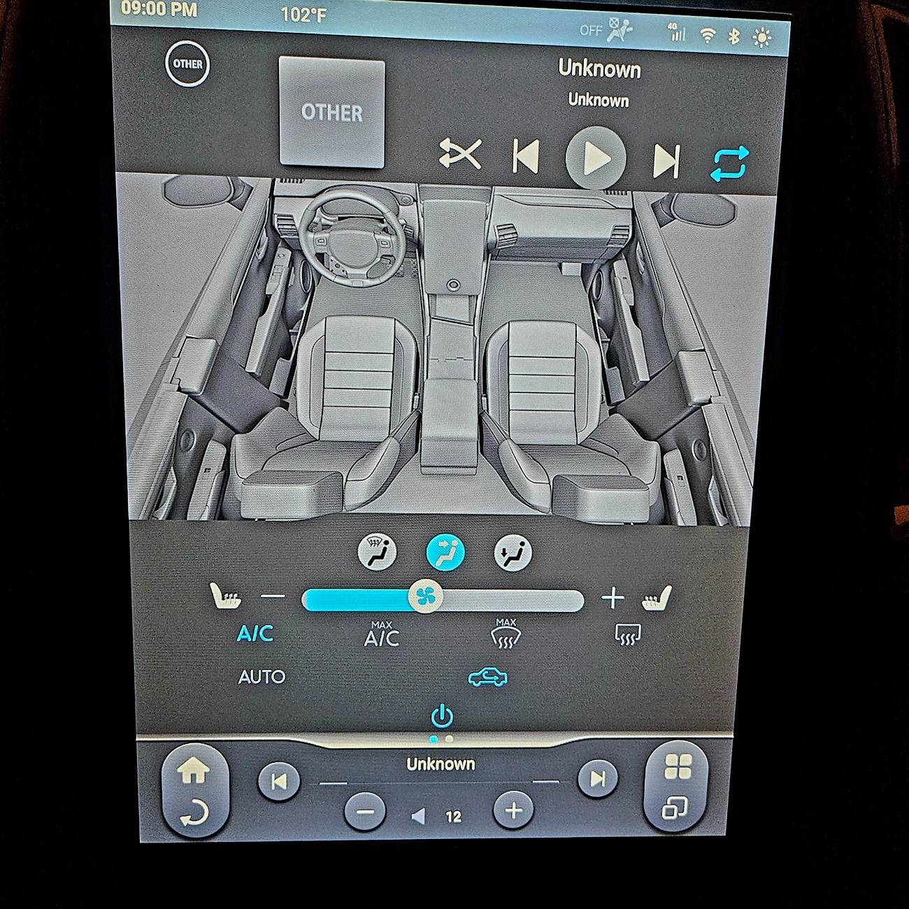

Nice looking Ranger 👍
Did you lose any of the original functions when you installed the Linkswell Gen6 T-style Radio?
Nope. All the Ford things still work perfectly. I like the HVAC controls a lot more with the Linkswell. All the steering wheel controls are the same.
