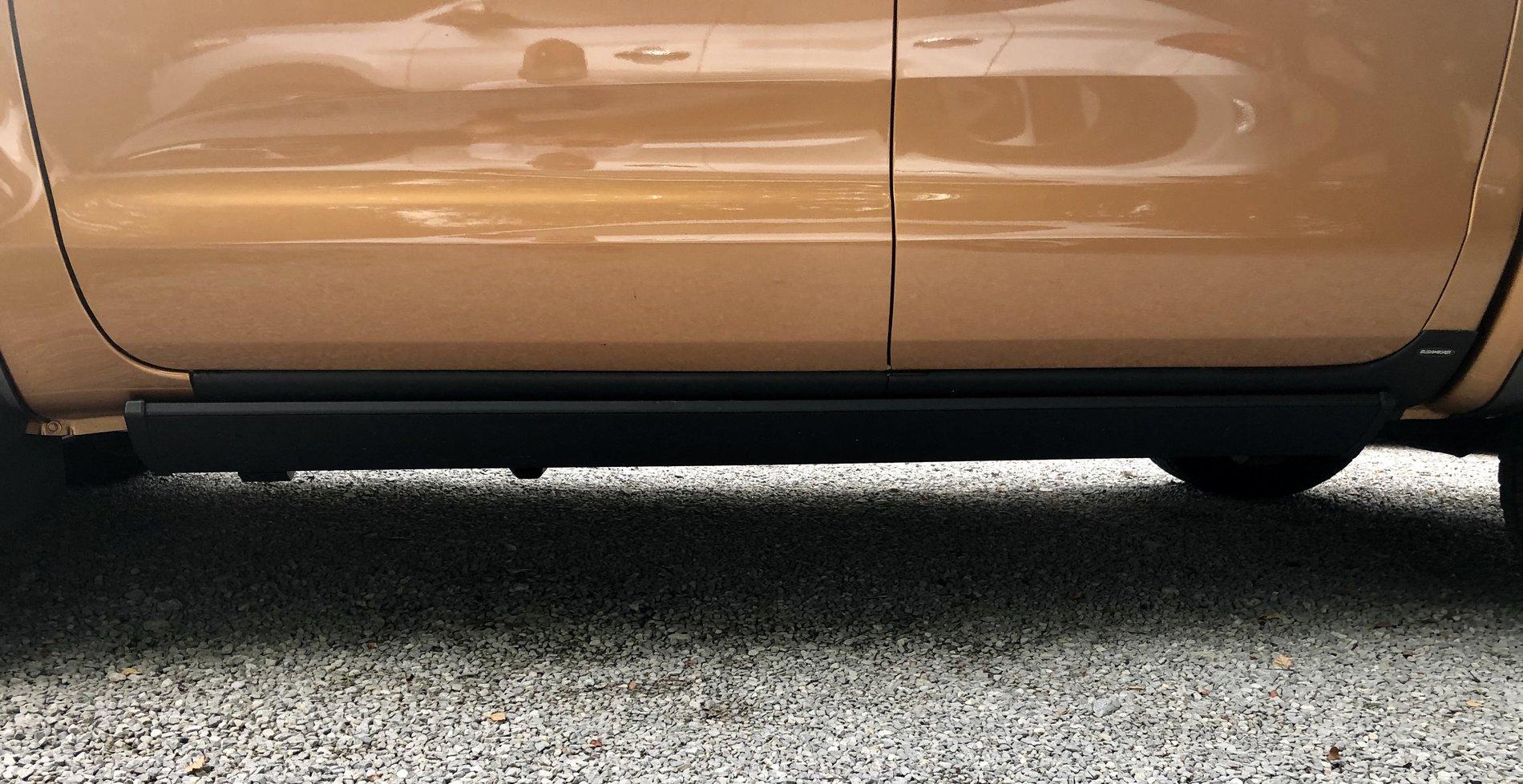

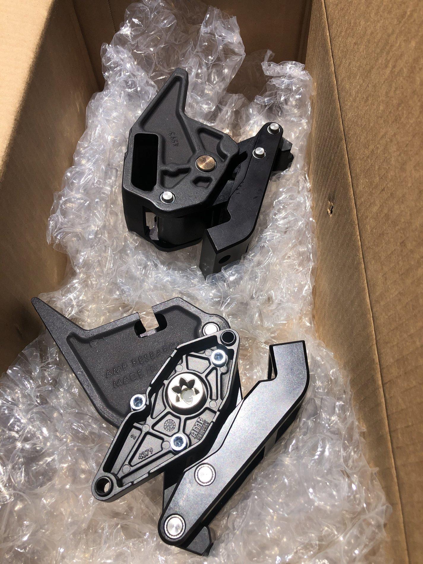

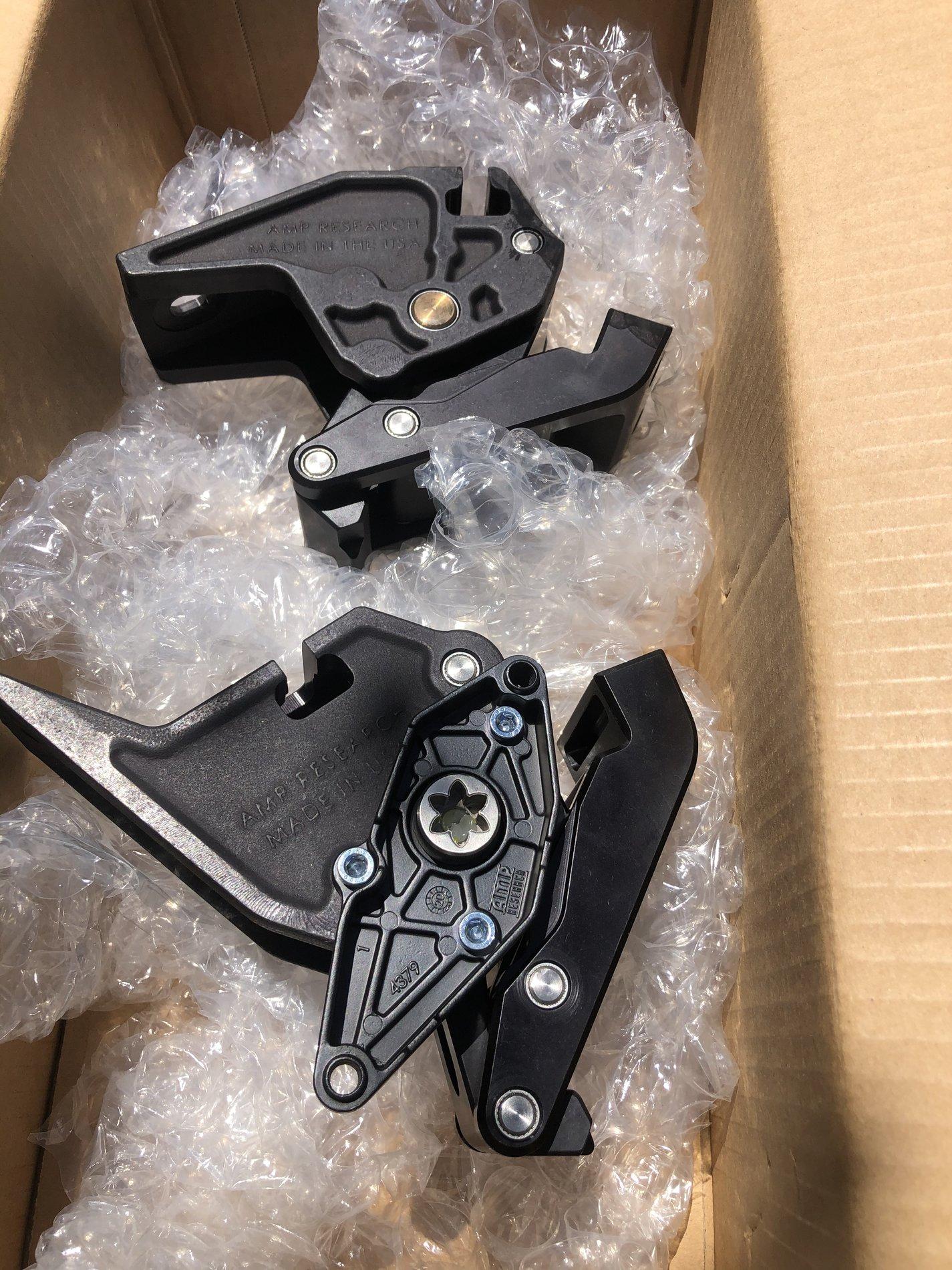

AMP Research Power Step.
After almost a year they offered them for sale.

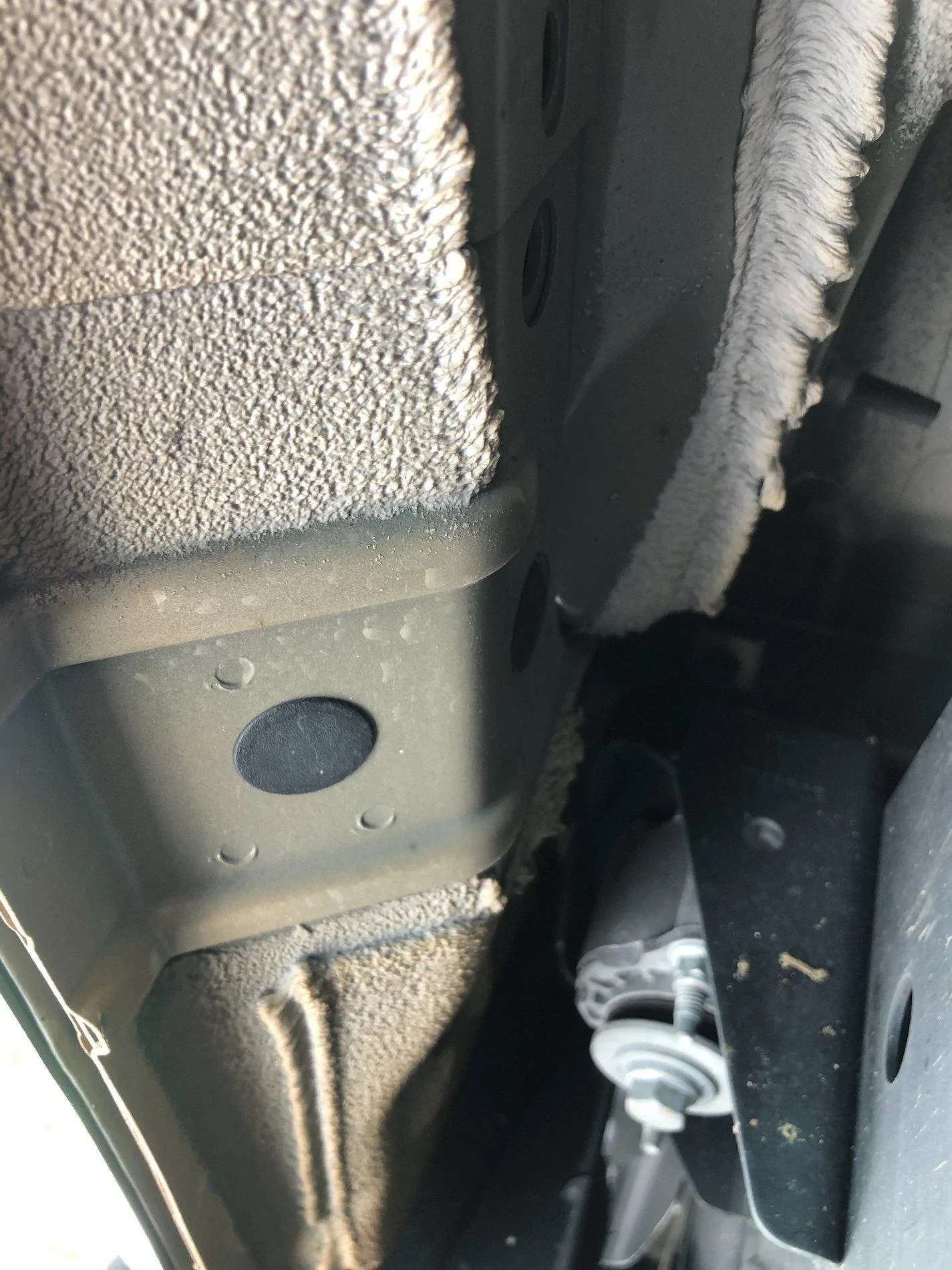

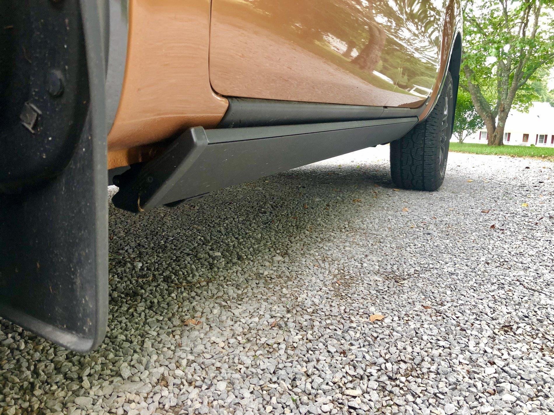

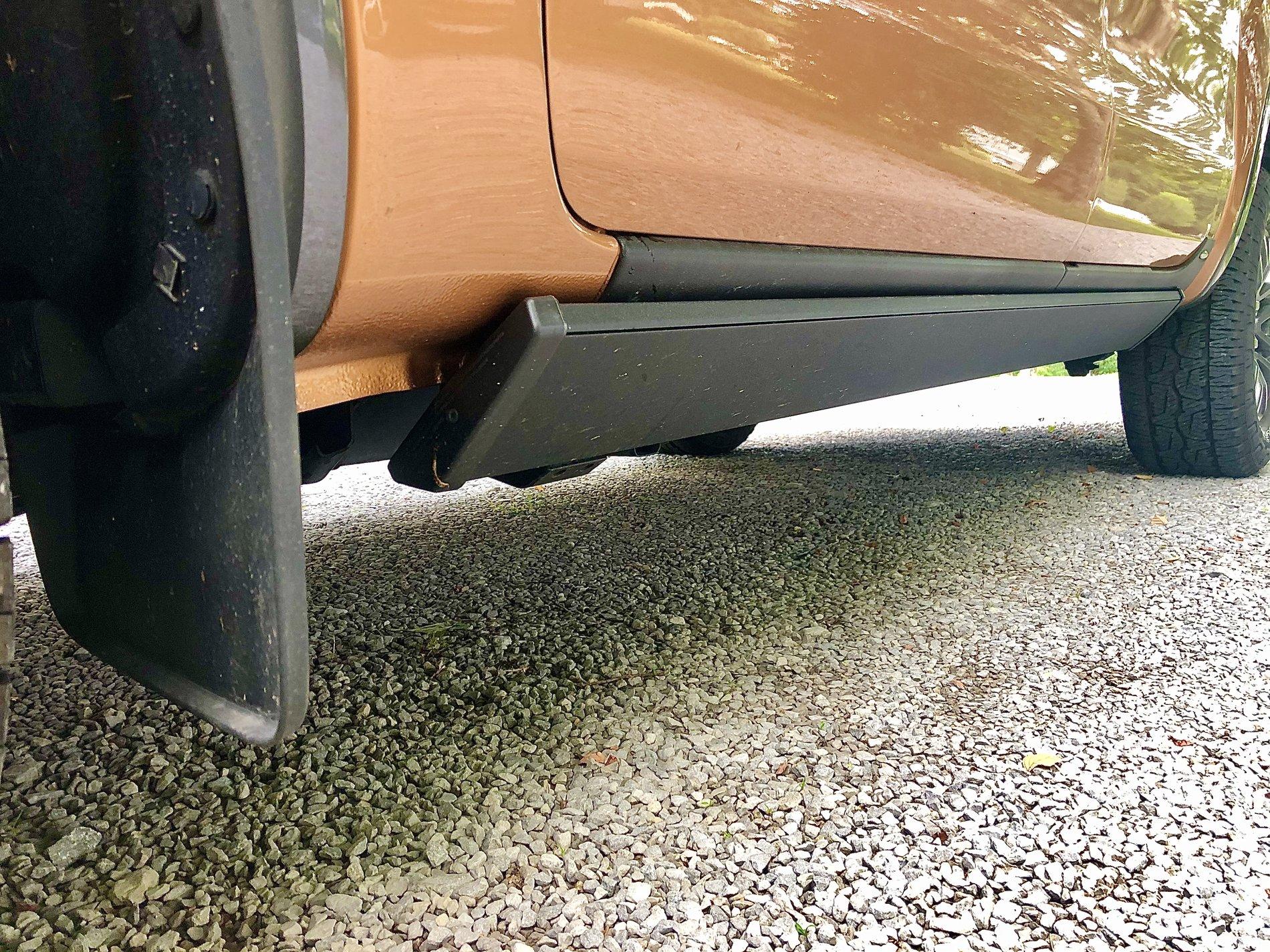

Worked over the weekend to install. Did Mechanical one day and the electrical the next. I like not being in a daylight rush on projects and we had some cool weather at night.
Install went OK. Many steps to the process and took my time so cables ended up in good spots. Reference Forum Member Josh Mills video, which was good help. All but lights. Once finished I installed in line fuse which is removed in early step. Learned fuses can go In backwards, as nothing happened. Flipped fuse and it worked as designed. A quick video while I was checking operation. It has a very mechanical terminator sound when operating. Will make same more videos later.

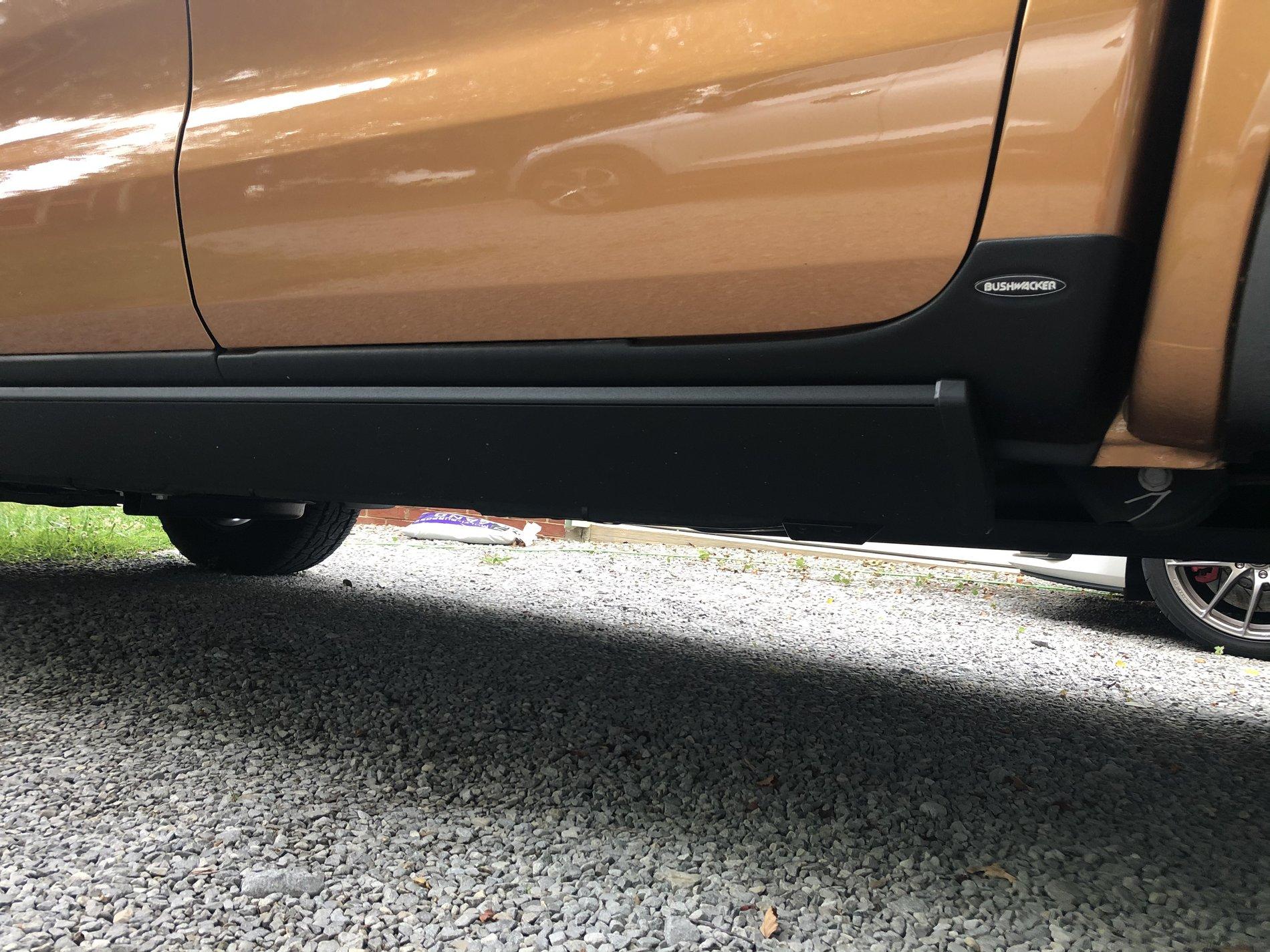

Fits and looks good with the Bushwhacker sill guards. Touches just on the rear. Plastic to plastic. Sill guards have a slight curve out at rear.
Everywhere else it is 5mm from touching.
Video used for reference.

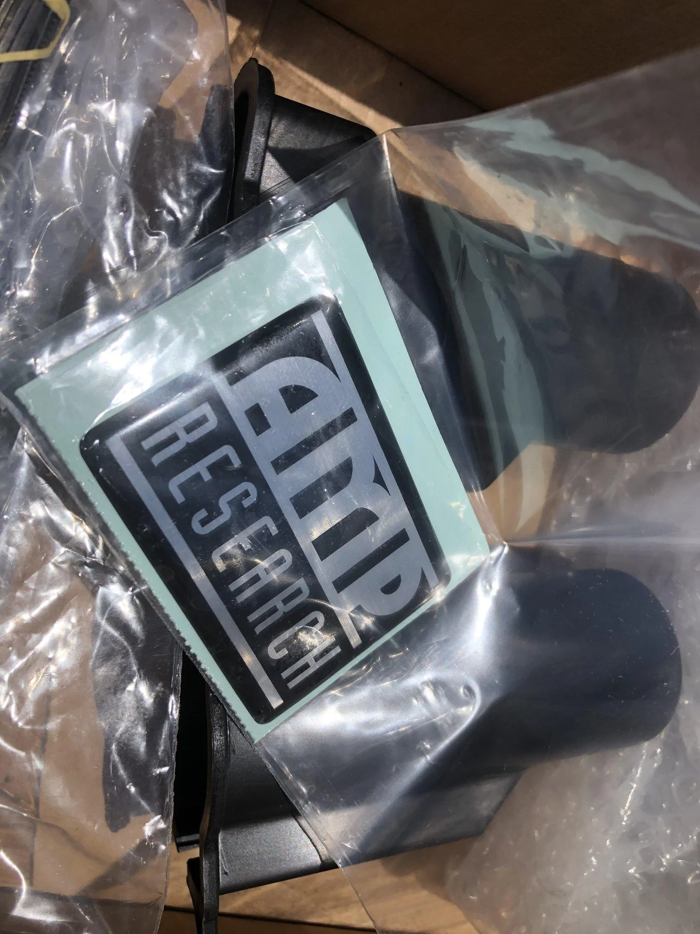

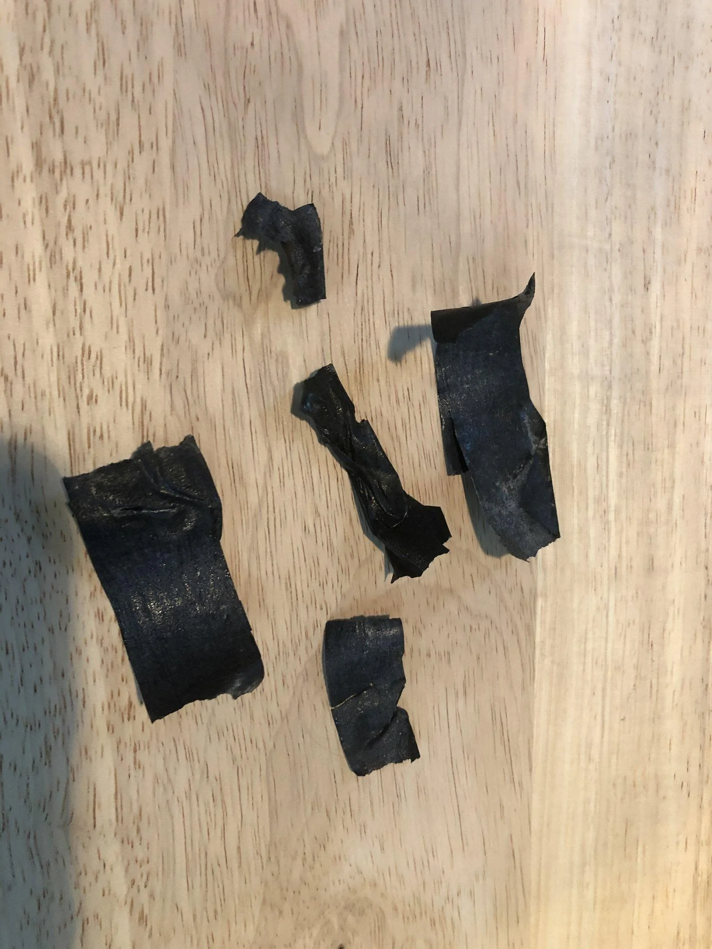

More tape found during AMP Step install.

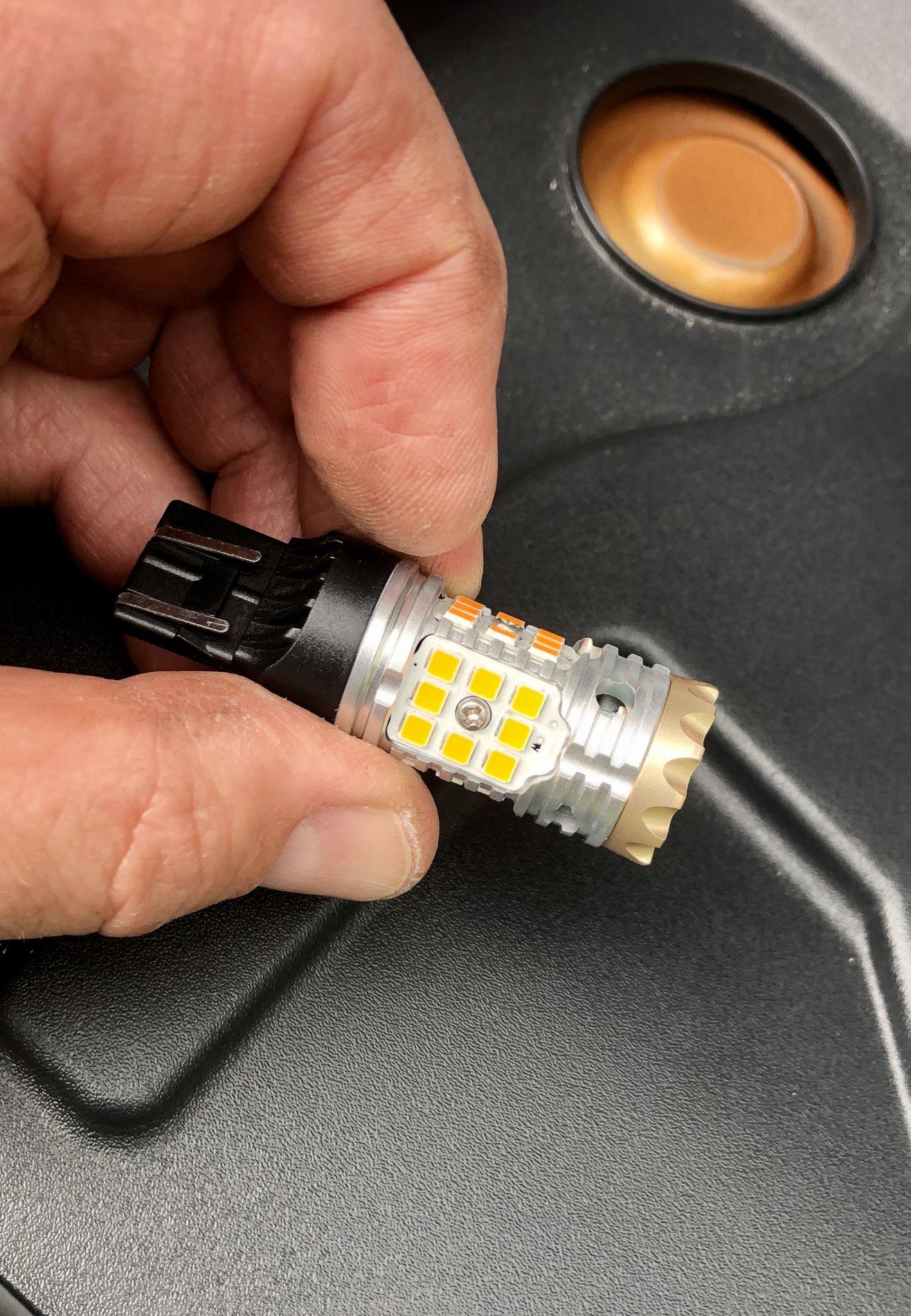

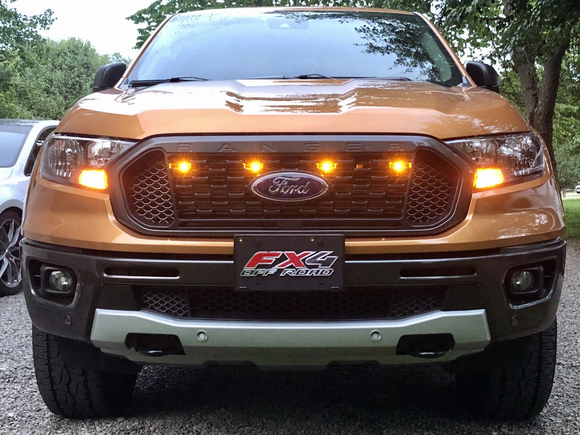

Front turn signal LED.

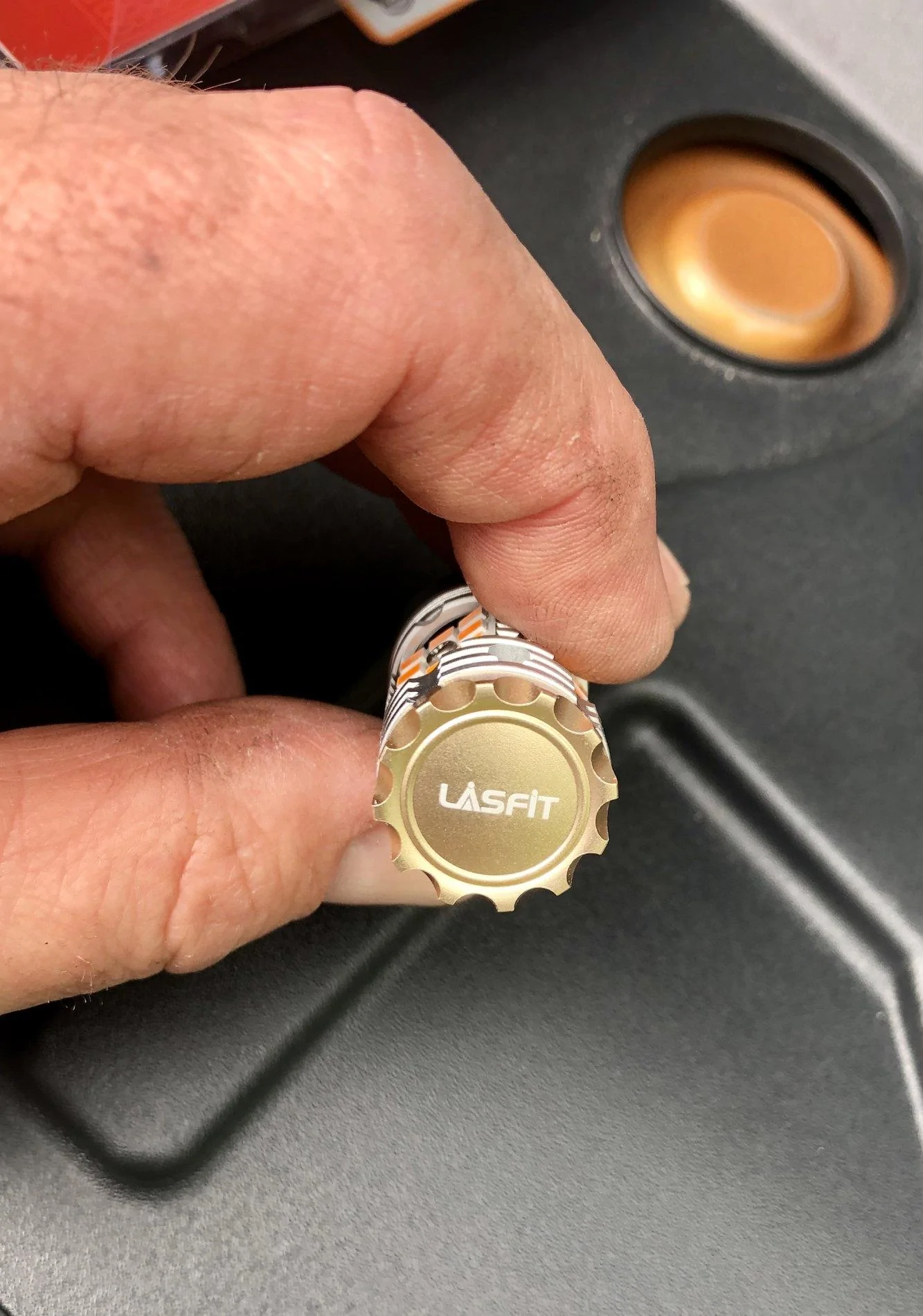

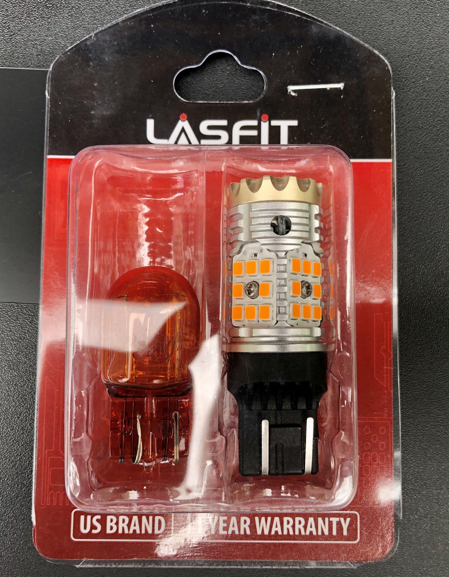

With my Ranger I found that Lasfit LED bulbs work well. Nice design, normal cost and good support.
Had a bulb go out so they sent a replacement.
This front turn signal bulb comes in Amber/Amber and I think a switchback form that goes to white light if you want. I picked Amber/Amber as I like the look with my Saber Truck.
Normal lights at daytime, slightly brighter than OE, but turn signal flash is super bright. I will get some shots when it gets darker.
Driver side an easy swap, passenger side needs the air intake snorkel removed. An easier job if you remove filter and lift up on bottom of snorkel inside air box and rotate bottom out from box. Same movement for install. No error codes.
LED bulbs fit one direction so you have a 50/50 chance of getting it right the first time.
Goes how many went in correct the first time? Zero. No lottery ticket today.
You can search web site by vehicle for other bulbs that fit Ranger. China made, sorry.

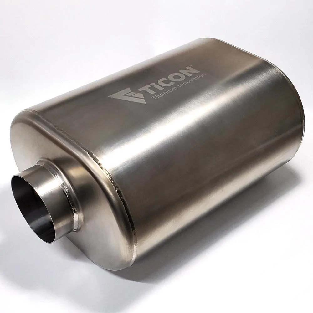

Like this.
No good reason but like Titanium. Also have SS version. Flow through design. Telling myself I do not need so right now just planning. Would need to verify pipe OD to insure good clamp.

Hey Pete!
Your Powersteps look great! They do sound like The Terminator! 👍
I also have a Saber Ranger and was wondering if you have any pictures from the side showing the truck & steps closed; to see the orientation to the rocker panel?
From other comments, it seems the steps do not retract under the rocker, but more to cover it?
I’d like to see how the black step looks against the Saber color? (I have the Sport/Magnetic trim, so that color is around the wheel wells.)
Thanks in advance for your help.
Cheers!
~Bryan

Hey Pete!
Cheers!
~Bryan

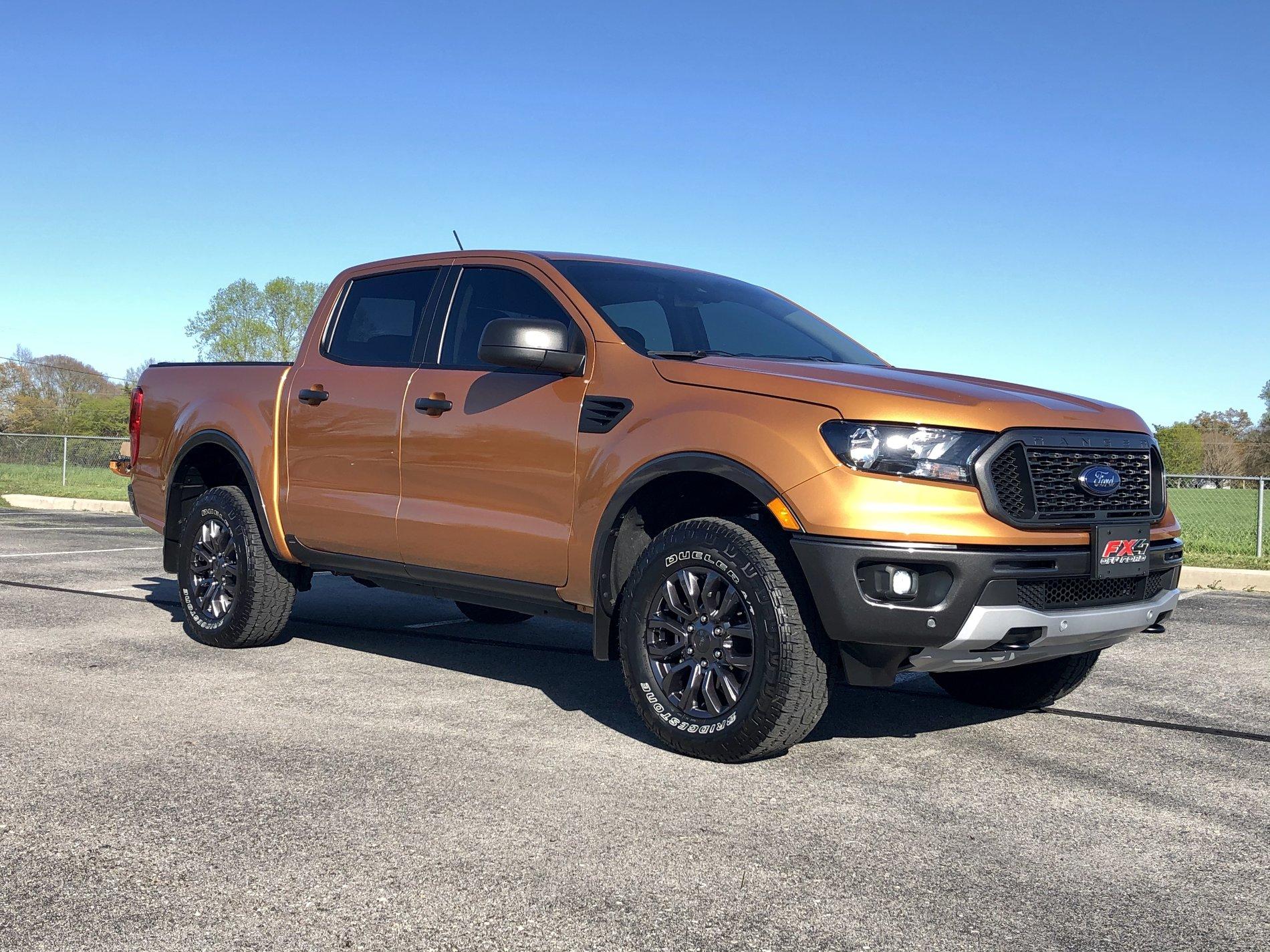

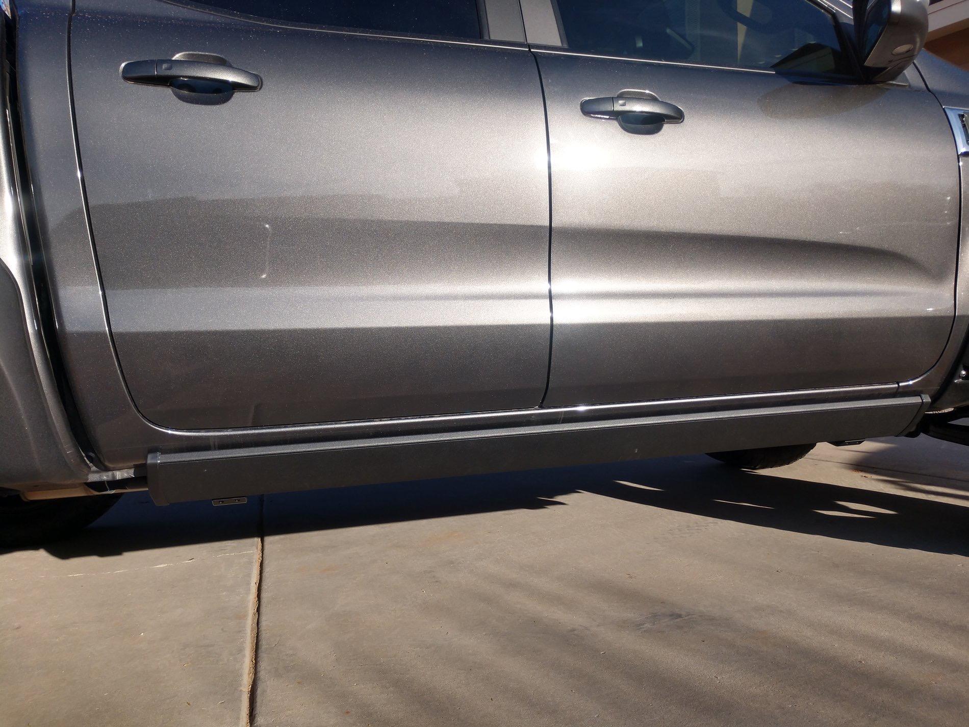

Here is one from another member. I will take some of mine later. I have sill covers that cover the entire bottom. So the step blend in with them.
Saber pics are with Bushwhacker sill guards only installed.

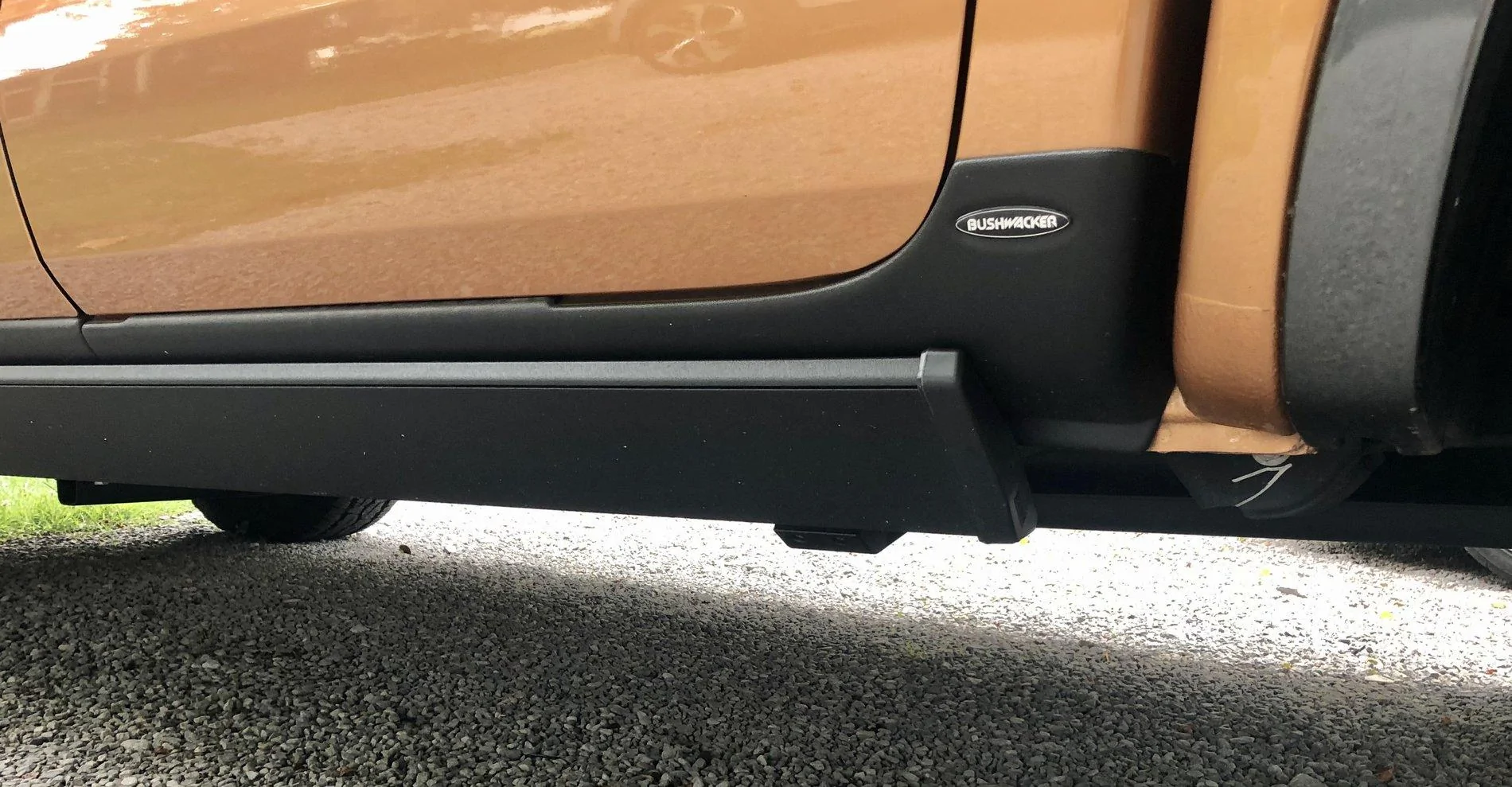

Saber with Bushwhacker Sill Guards.
BButah
Bryan
Aug 8, 2019
226
610
Draper, UT
The sill guards are nice! Your truck has the Sport Trim like mine and the black guards blend nicely with the Magnetic Sport Trim.
I look forward to seeing your truck from the side with the steps when you get the chance.
Thanks for the info!

Hey Pete!
Cheers!
~Bryan

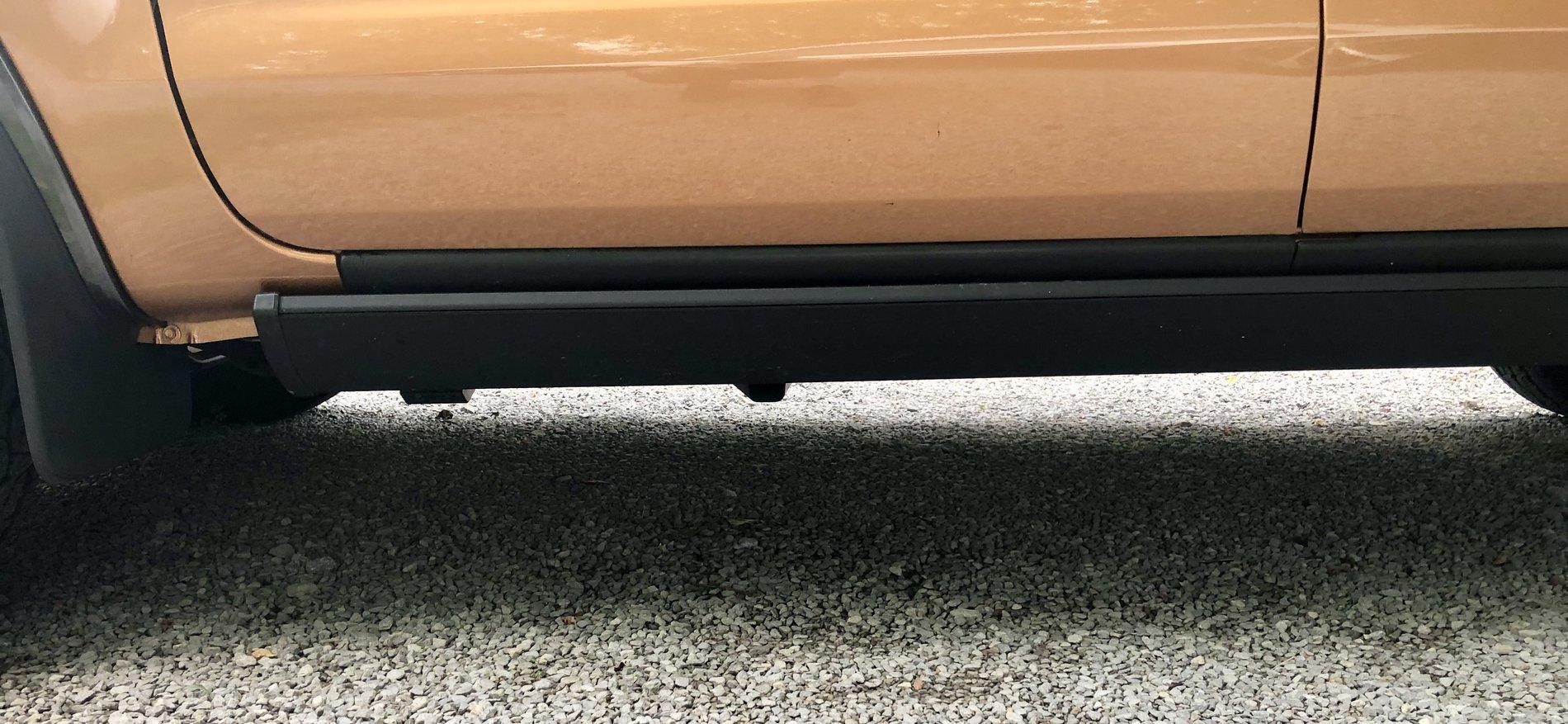

Requested AMP Research steps on Saber Ranger.
BButah
Bryan
Aug 8, 2019
226
610
Draper, UT
Those look great and blend in nicely with your Bushwacker sill guards.
Personally, I wish they retracted more under the rocker; but this way they will certainly double protect from rock chips down there.
Thanks for the pic's!
Cheers!
