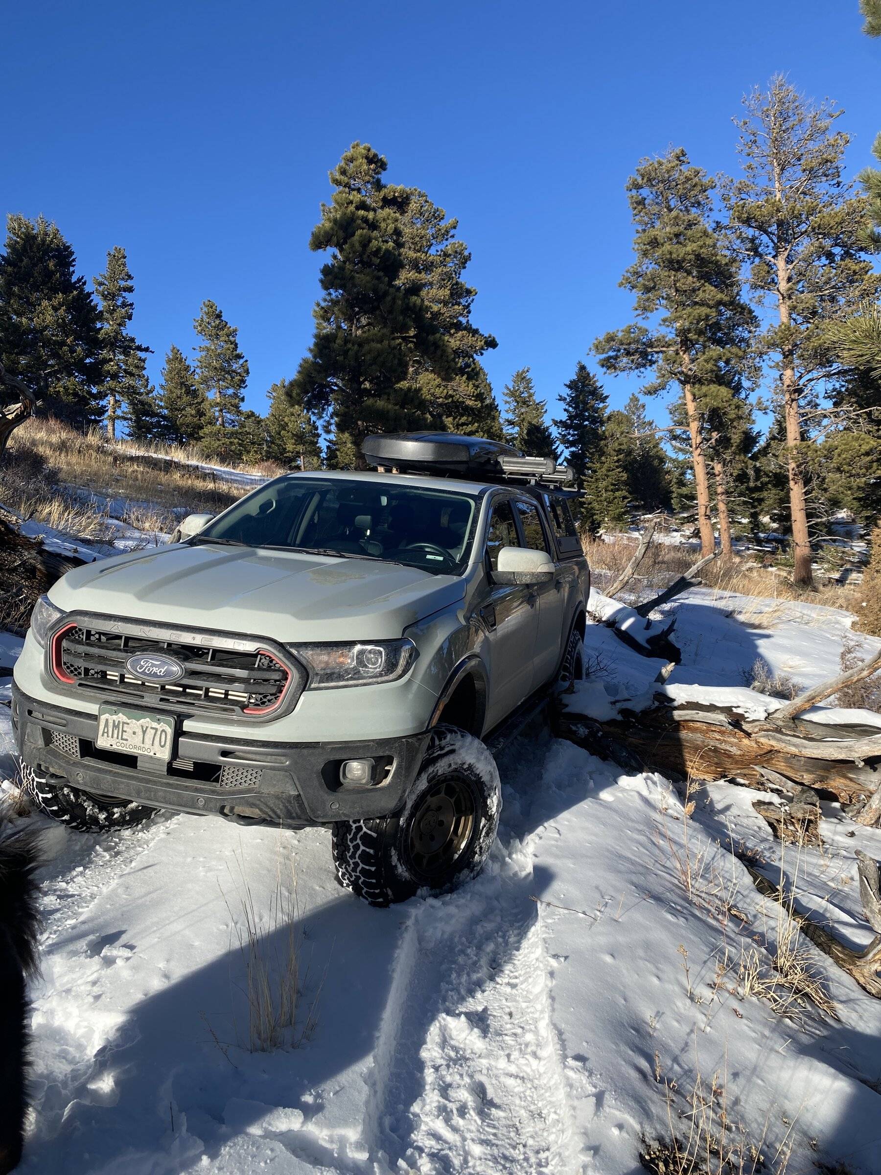

Pretty old, but ended up going with Go Rhino Dominator DSS Sliders. Definitely not true "sliders", but they meet my needs pretty well. I just wanted better clearance and something to help me reach stuff on the roof rack...which should be here this weekend!

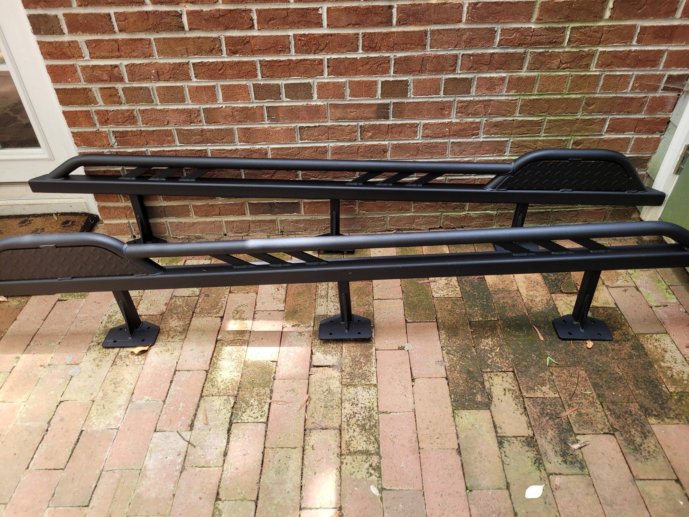

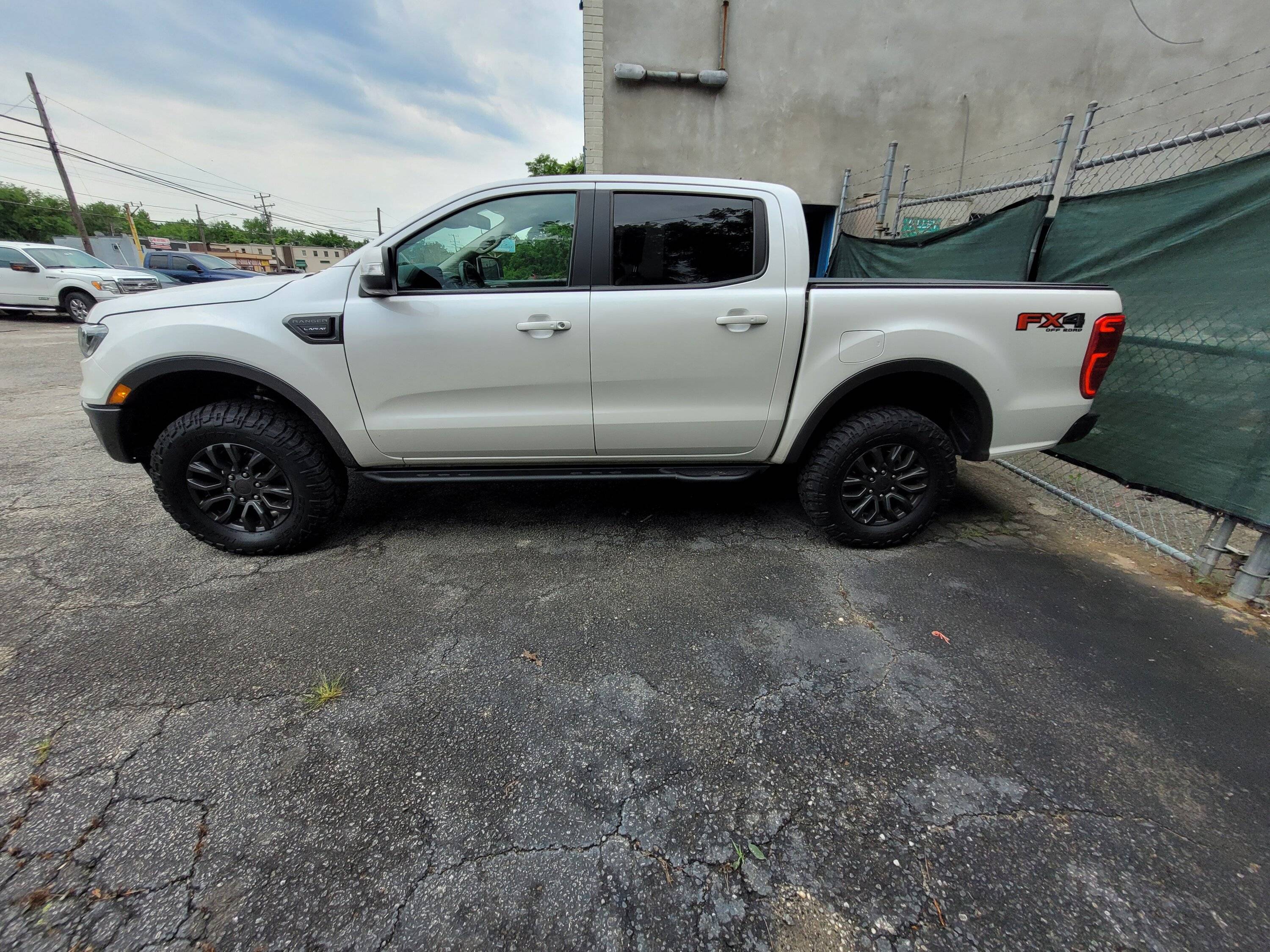

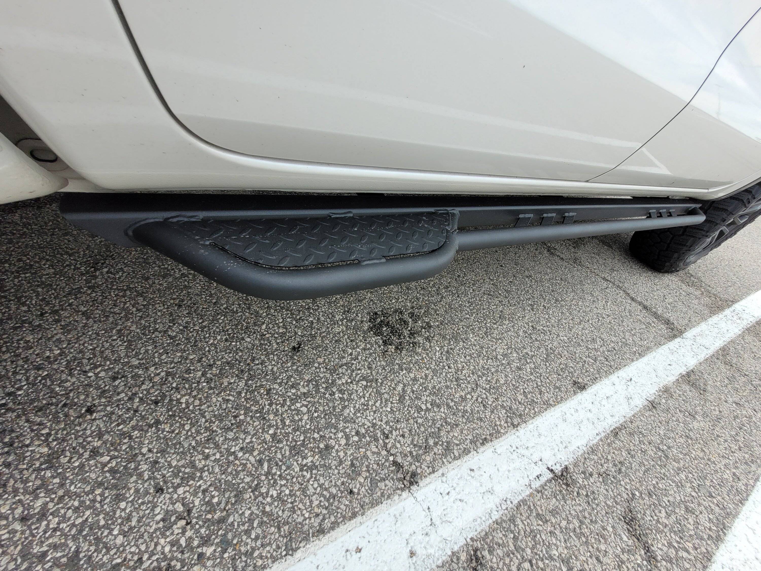

My Rock Road Outfitter " kickout" sliders arrived last week that I ordered in January. Pretty stout. Having them installed Friday. Will posts pics then

Did you drill the 24 holes or have them welded? I still have not decided
I drilled them. It wasn’t fun but I managed to get it done by myself. Slow drill speed is the key. If you run the drill too fast then the metal will get hot and make it tougher to drill through. Also the top row is hard to get to. You really need a 90 degree drill to get those in straight. If you know someone who can weld, that would probably the quick and easy route.

I want to weld them for strength and not perforate my frame. But if they get bent or I decide to paint them...?
Regardless I and impressed how well they are made and they are difinetly up to taking hits from rocks and stumps.
