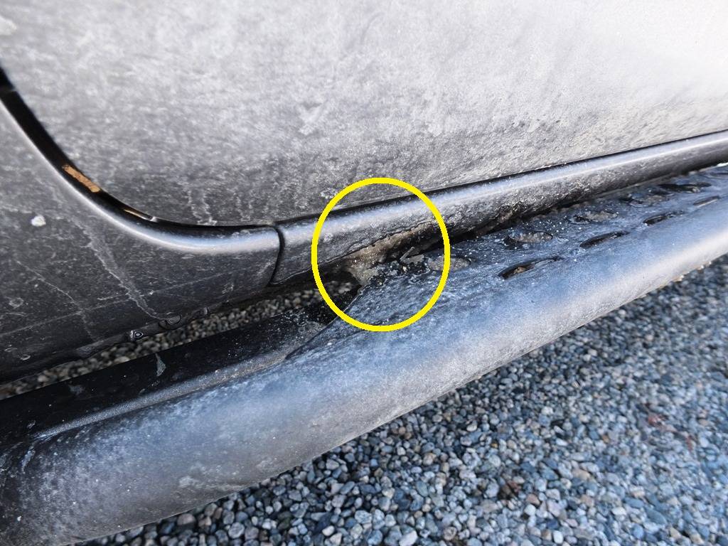

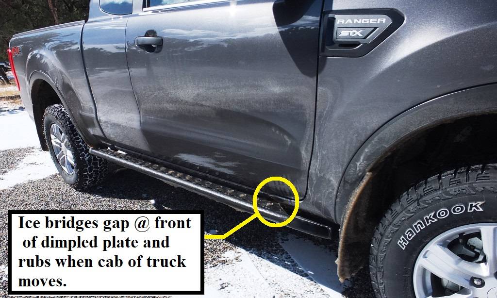

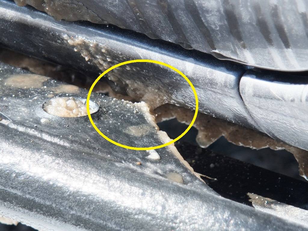

Something to keep in mind.
The tightly tucked sliders are good and bad.
Our Shrockworks sliders are tight and in the winter, they accumulate ice and when it starts to build up it actually hammers against the body of the truck. Since the rock sliders mount to the frame... and not the body... the body flexes and moves independent of the sliders.
Same thing can happen with small rocks trapped between the slider and body.
YMMV

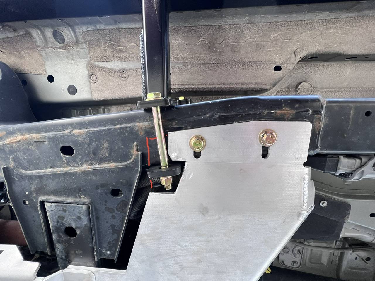

Heads up.. white knuckle sliders driver side front mount conflict with the RCI transfer plate. Needs a bit of cutting to make work.

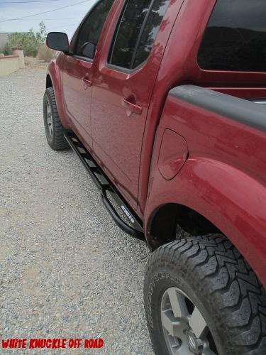

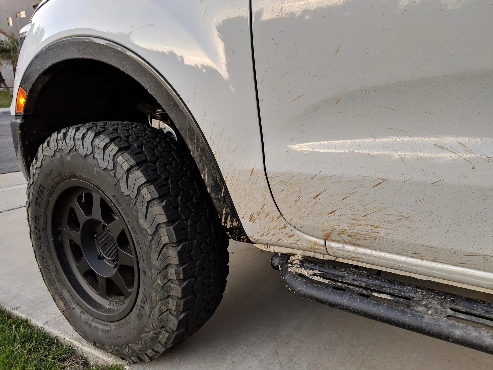

The white knuckle can be ordered angled up
Mine I ordered straight out, even then if you were to drop a plumb from the door handle it wouldn't touch
Can also be ordered with or without finish. Mine are powder coated and holding up well, scrapes are on the bottom anyways

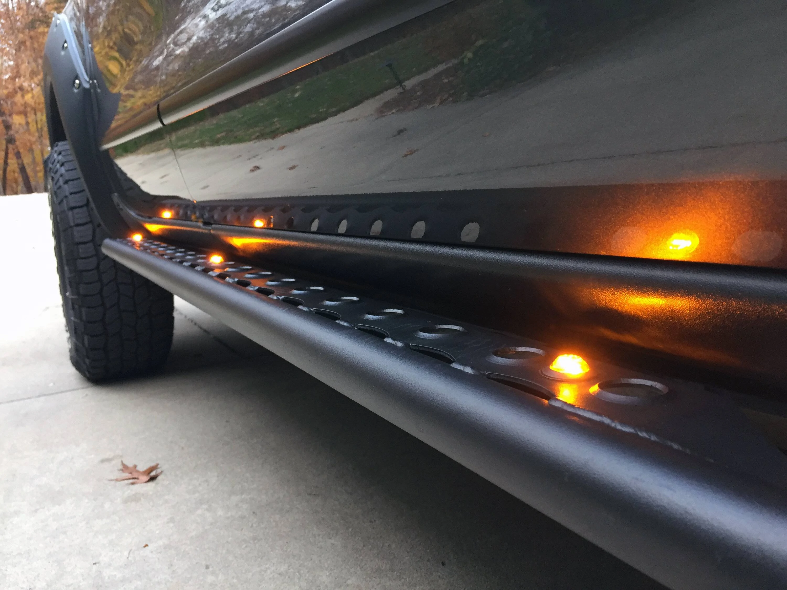

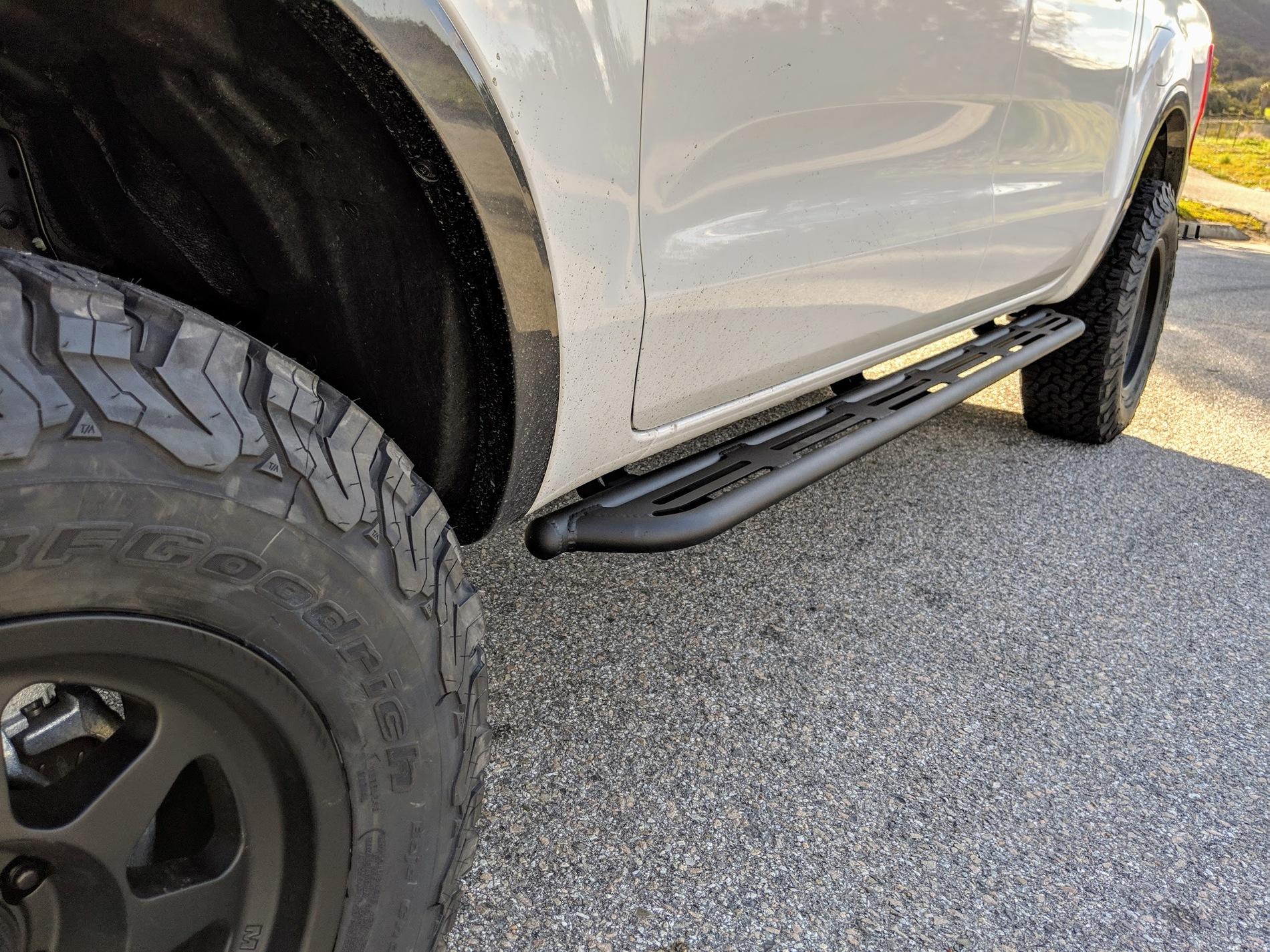

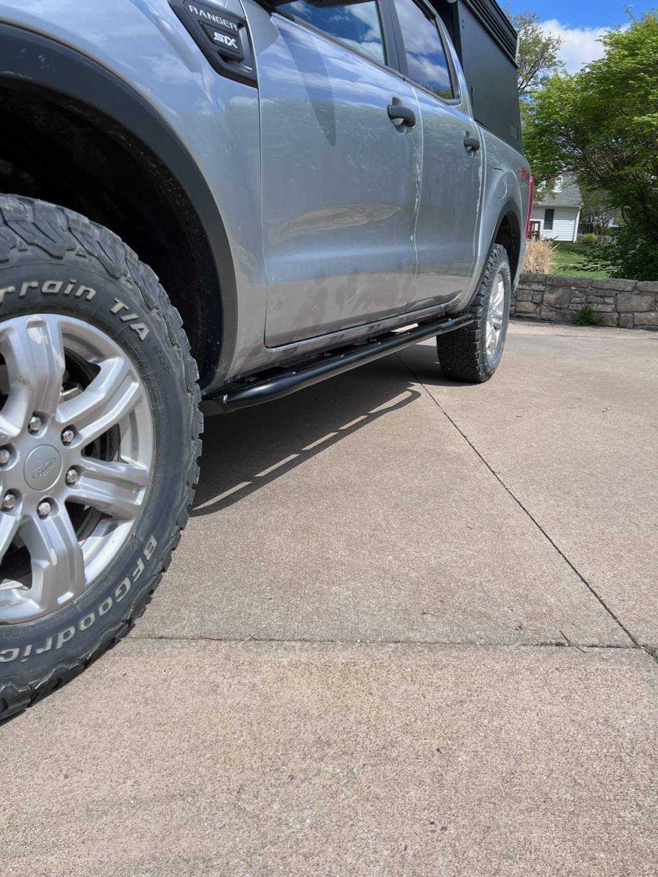

I ordered mine angled as I wanted them fairly flush with the cab. They barely stick out enough to use as a step. I’d suggest putting grip tape on the top if you actually need to use them as a step.

Thanks much for the pic. It shows exactly what I wanted to see. They don't appear to stick out as much as they looked on their site. That is the fit I like.
