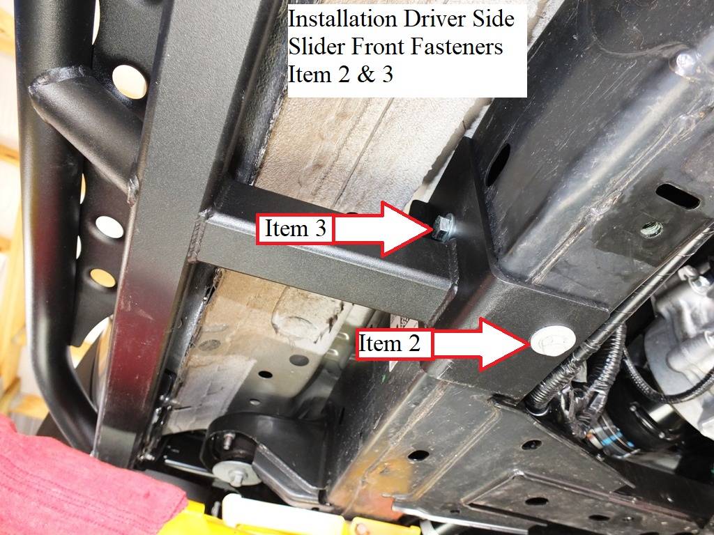

A question to add here: Shrockworks has plates on the bottom of the frame and side, but all other models only have side mounts. Is there a benefit to the bottom plate? Does it add strength? I come from a world of weld on sliders, so bolt on is foreign to me. I don't mind drilling the hole, but I like the kick out on other models. If the strength of the bottom plate is worth giving up the kick out, I am fine with that.
The side of the frame is weak, it's little more than sheet metal on our Rangers. So the Shrockworks design is much stronger unless the welded side mount you are referring to has a large reinforcing plate to distribute the load across the entire face of the frame.
See how the Shrockworks bracket ties the side and bottom of the frame in the photo below. Thus the load is distributed.
Also look at the holes in the frame on the side.. see how thin it is. I was amazed.

I have the shrockworks and they work well. Bolt to the frame only. I even made use of them as a jacking point when I got a flat tire and had to put on the spare.
Thanks. Kind of what I thought. The RRW have backing plates that mount to the inside of the frame, instead of below. Thoughts on which type of plates would be better? I like the kickouts, but don't want to sacrifice strength. I don't rock crawl, but I want my cab to be protected for when I get out and have to get over things.
