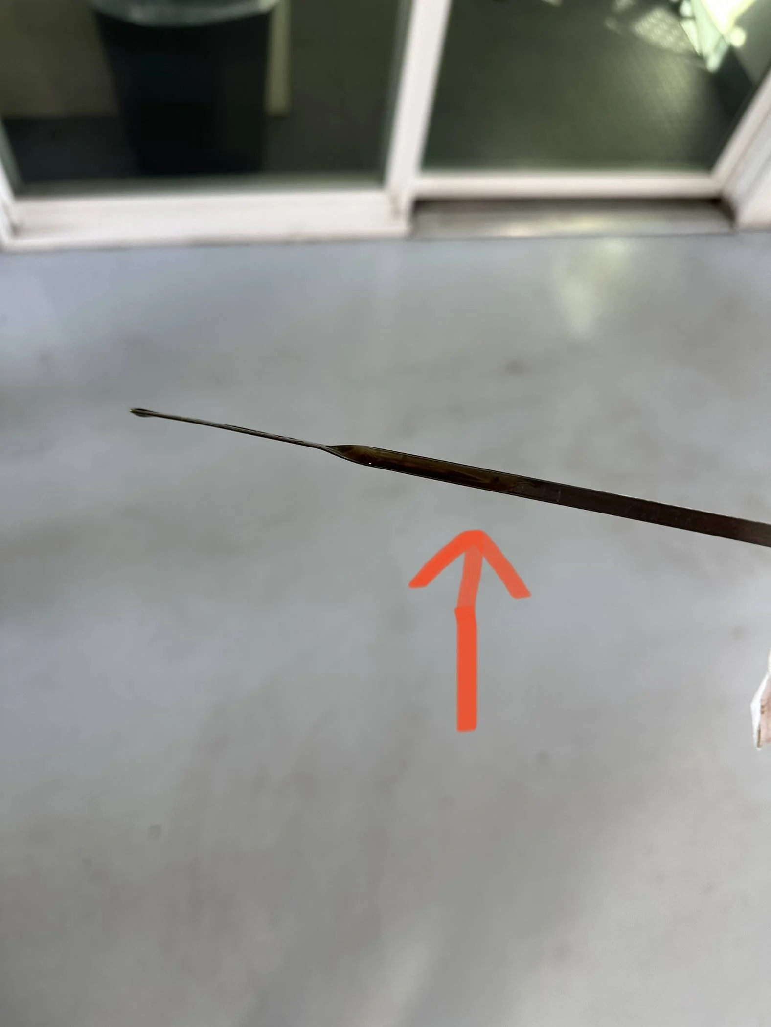

I know this is a common issue with our trucks, but how high are you seeing the levels rise? I just pulled up to the dealer for a scheduled oil change and decided to check the level before I let him pull it back. The oil was was off the chart on the stick, like to the top of the Ford motor co sign. The guy tried to tell me that was the max level on the stick ?‍♂
edit: this was after 6k miles on the oil, total of 11k miles on the truck. 21 tremor

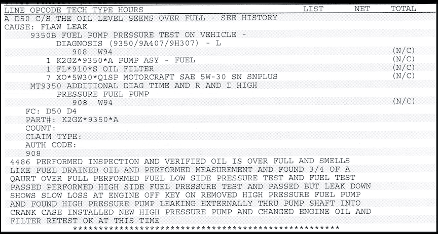

The vehicle should be sitting at least 15 minutes before checking the oil level.
Since the dealer is doing an oil change and you suspect the level is rising, have them mark the dipstick at the correct level and then check it after 1000 miles.
My truck was creating its own oil and the dealer marked the stick, checked it after 1k and it was indeed overfull.
They found that the HPFP was leaking fuel into the crankcase.
Replaced the HPFP and no more issues.
Edit: Found the thread with my service ticket

Oh ya, I can smell the gasoline before I even pulled the dipstick. The dealer changed it, and I want to say I checked the level afterwards and it was fine. On the first oil change I told the dealer about it, but he just dumped the oil and didn’t document the level rise. It wasn’t this high last time though .
