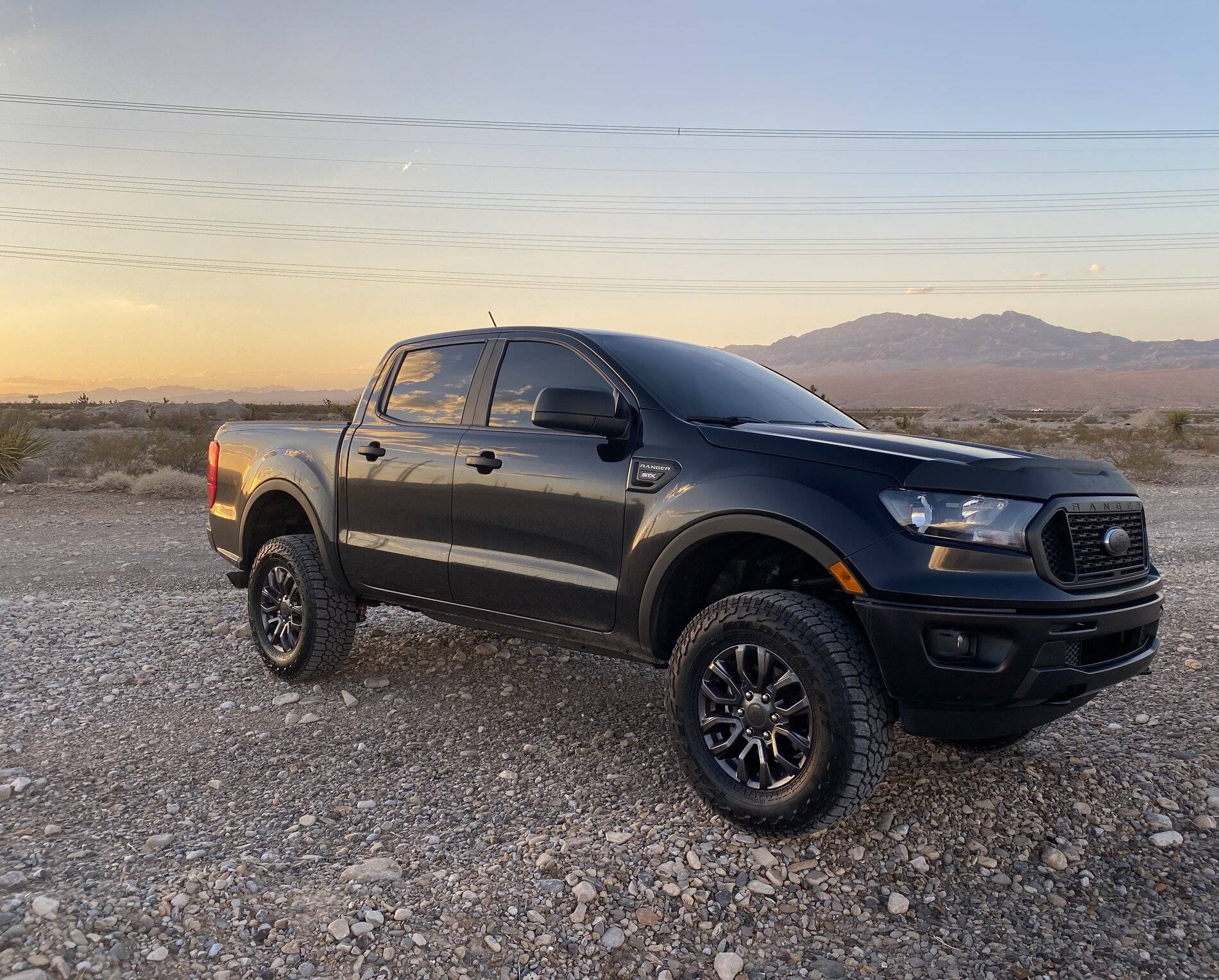

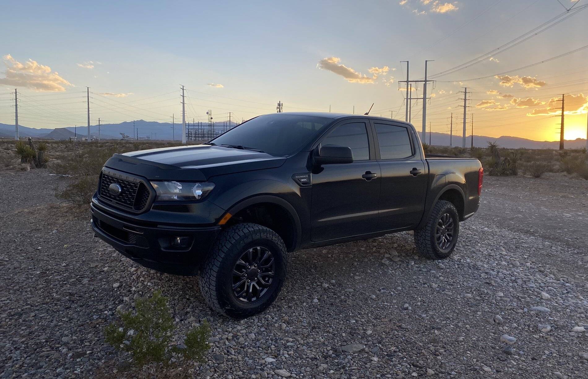

On mine I did the eibach leveling struts in the front and set them to 3”, and have the eibach rear shocks. It’s a bit bumpier now but nothing too crazy. I kept the stock 17” wheels, but went with 265/70/17 Wildpeaks. Freaking LOVE the way it looks now. Some say I over did it by going to 3” instead of 2.5, but honestly how much of a difference is half an inch going to make on the UCA and CV stress points? I dunno
