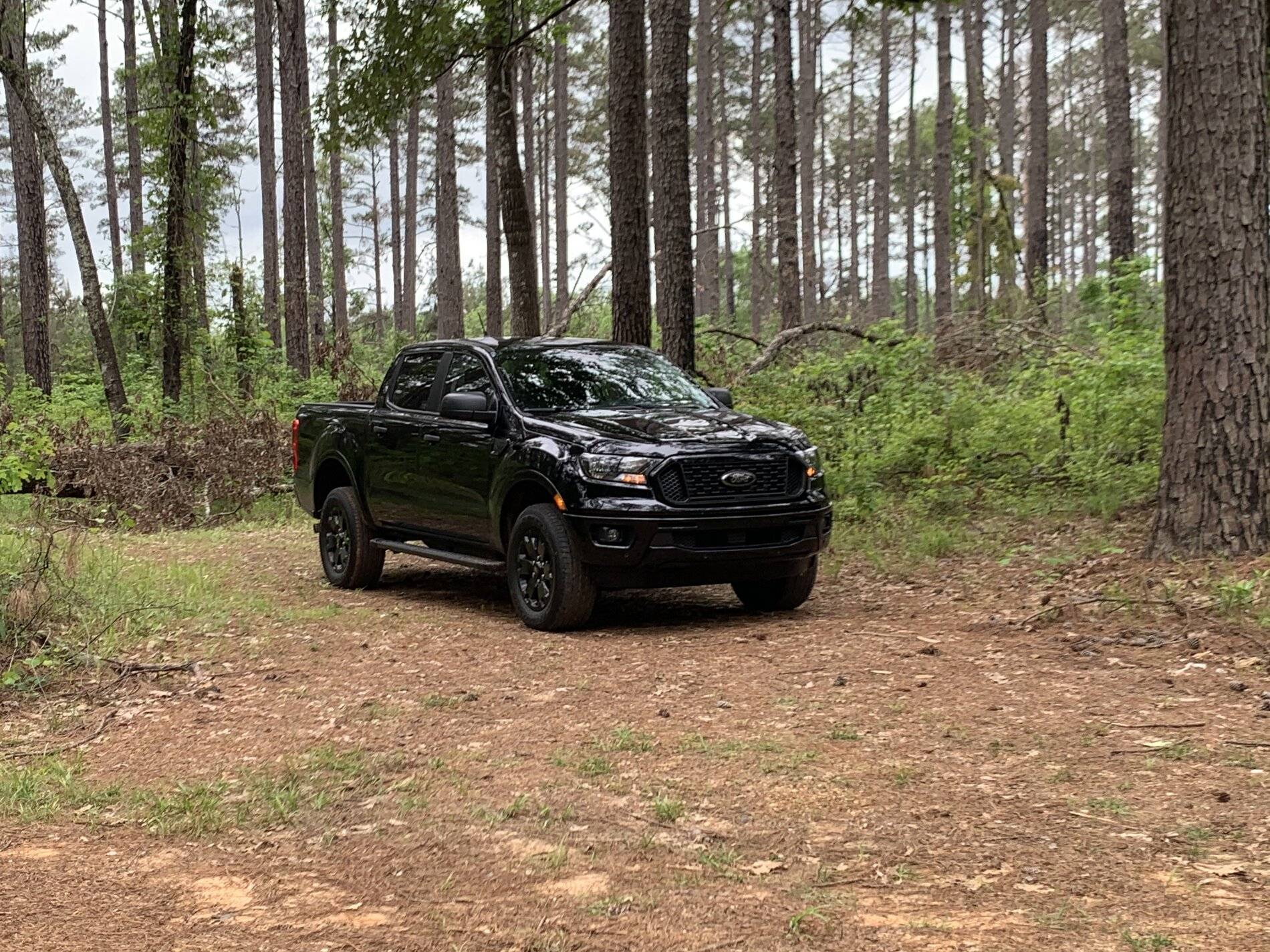

19,000 miles on my 2.5" leveling kit with Nitto Ridge Grapples 255/80/17 tires. Just over a 33" tire with zero issues and no rubbing. No suspension issues and I drive the truck rather hard with some 4x4 at the beach and deer lease.

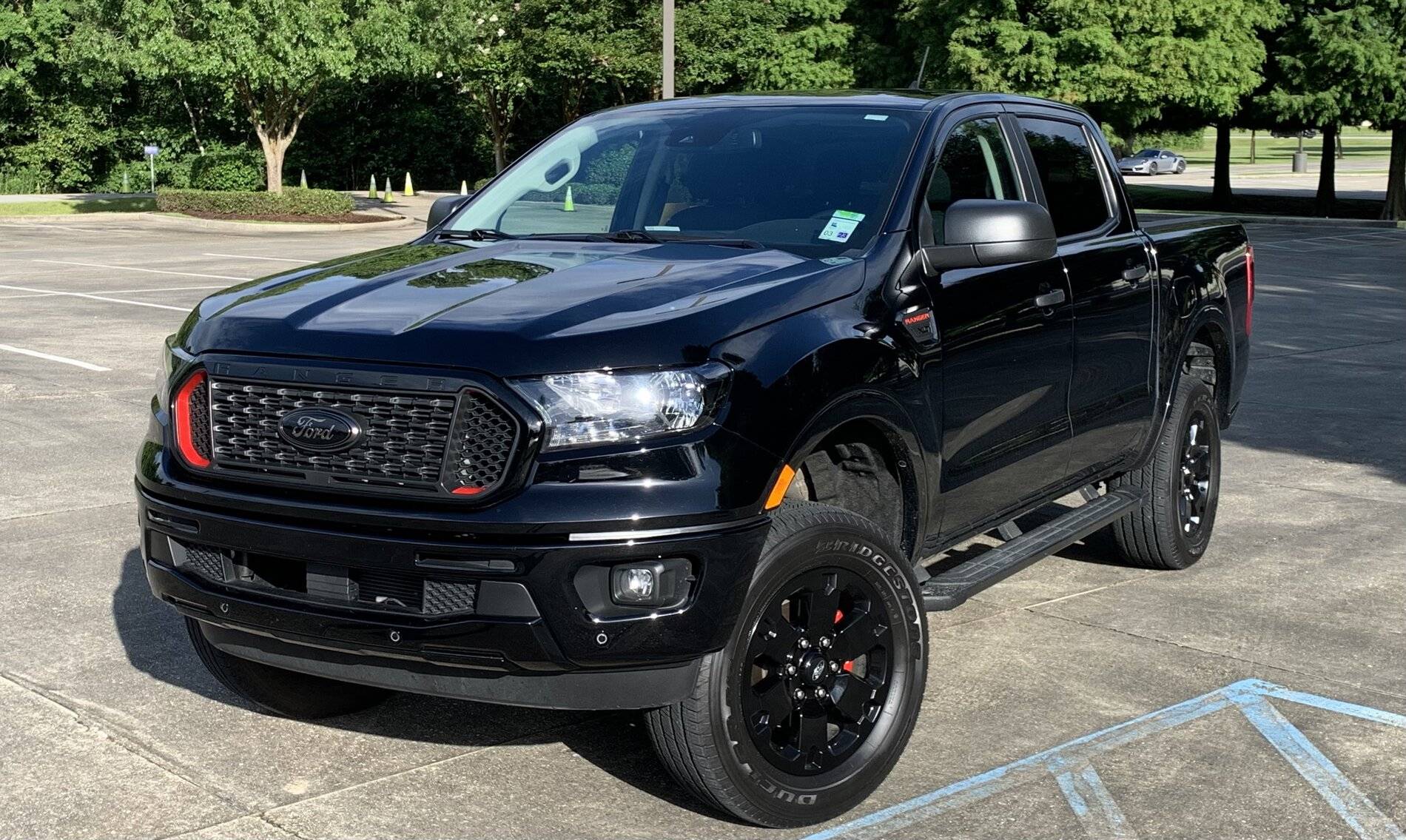

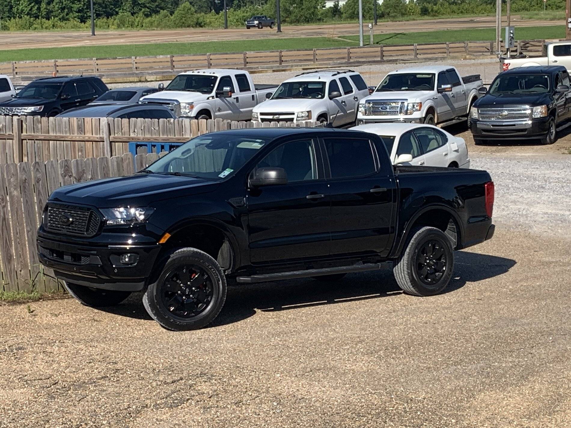

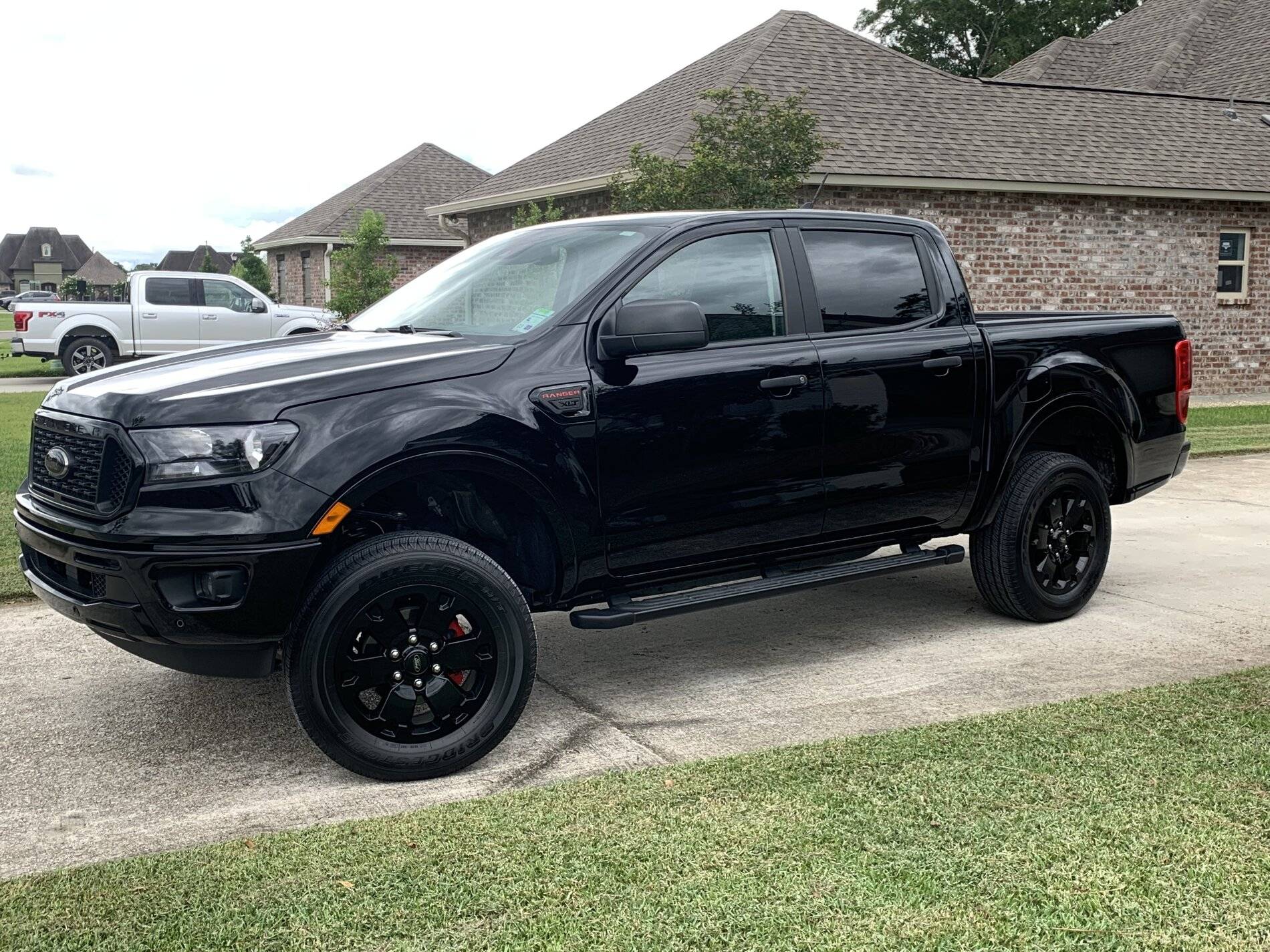

2.5” Rough Country level kit. $108 after tax online. About $200 to get it installed.
definitely how this truck is supposed to look.
I added the oracal 651 vinyl accent on the grill ($4) and painted the calipers myself ($30). Total mods cost $342. Completely changed the look of the truck. in my opinion the level is an absolute must.

You can do a 2" or 2.5" level which will give you what you're looking for. You will need to get an alignment after too. If your just replacing the tires and not the wheels there's nothing to worry about as far as offset. You can go up one size on the stock wheel and still have no issues. I have the RC 2.5" level with Nitto Ridge Grappler 265/70/17 and there's no rubbing.
Edit: As far as voiding your warranty short answer no. But If you have a front end issue and they can prove the level caused it they can void that portion of it, not the entire trucks warranty.
After level on stock tires
After new tires
Tires really made it come together
Now get some bigger rubber and you are set.
Did you have to remove any crash bars?
I want to run a narrower but bigger tire for my adventures in Colorado.
