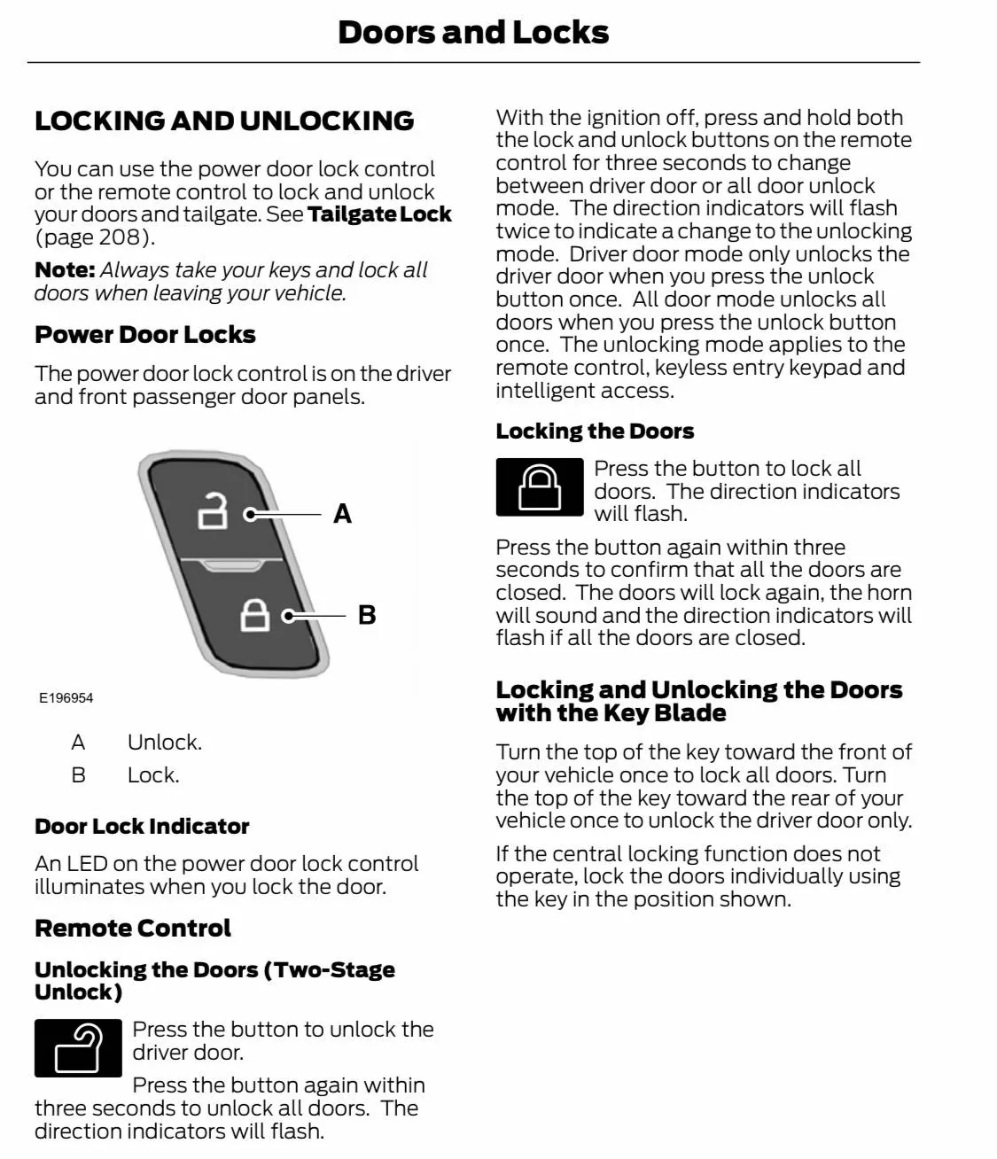

Is proximity unlock set to unlock all 4 doors or just the driver's door? If this is to set for all doors then the tailgate will also unlock when unlocking anything other than just the driver door.
Yeah I have to hit the unlock button twice to unlock the other three doors in the tailgate. I don't know why I was told they didn't have that feature. Thanks for the info.
