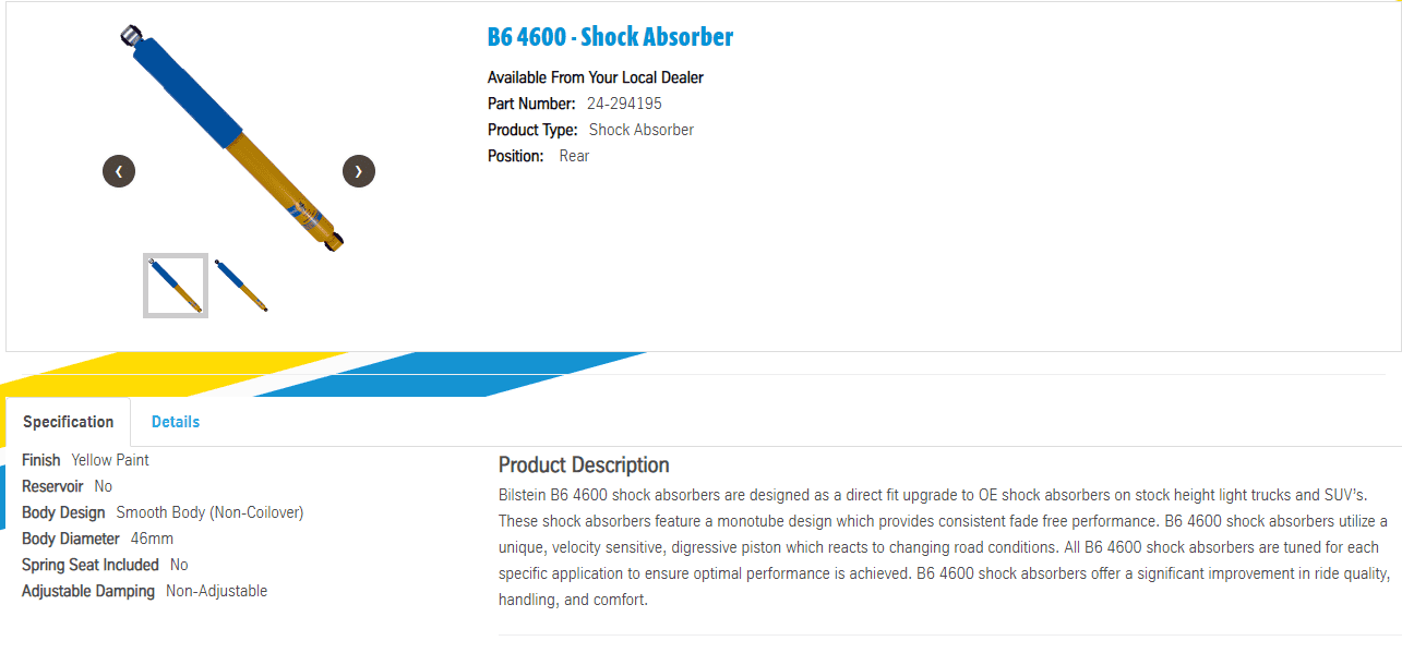

I just looked up 3 of them and I might go for this one. Anyone have this one and how is it?

You won't find a better place to spend $200 improving your ride than Bilstein 5100s in the rear.
HERE is an extensive thread detailing the Bilsteins.
If just the rear, the Eibachs are also highly recommended.
I have the 5100s front and rear on my truck and the ride transformation is extremely impressive.
Touch base with Frank on here @Stage3Motorsports
They are a forum vendor and all my dealings with them have been top notch.

As already said changing out the suspension will be a night and day difference. I just did Eibach coilovers and all I can say is I wish I did them 3 years ago! I wanted to go with the Bilstein but they were backordered at the time and I wanted to replace them before going on a month long trip. Either of those along with Fox will greatly improve the ride quality.

At slow speeds on uneven ground it would buck me side to side occasionally too. I hated that. Rear shocks alone made a huge difference for $200. I ended up doing the front also and am very pleased with the results. It’s by no means a cushy Cadillac ride - it feels like a truck but my bobble head side to side is 95% gone. It also got rid of nose dive.
