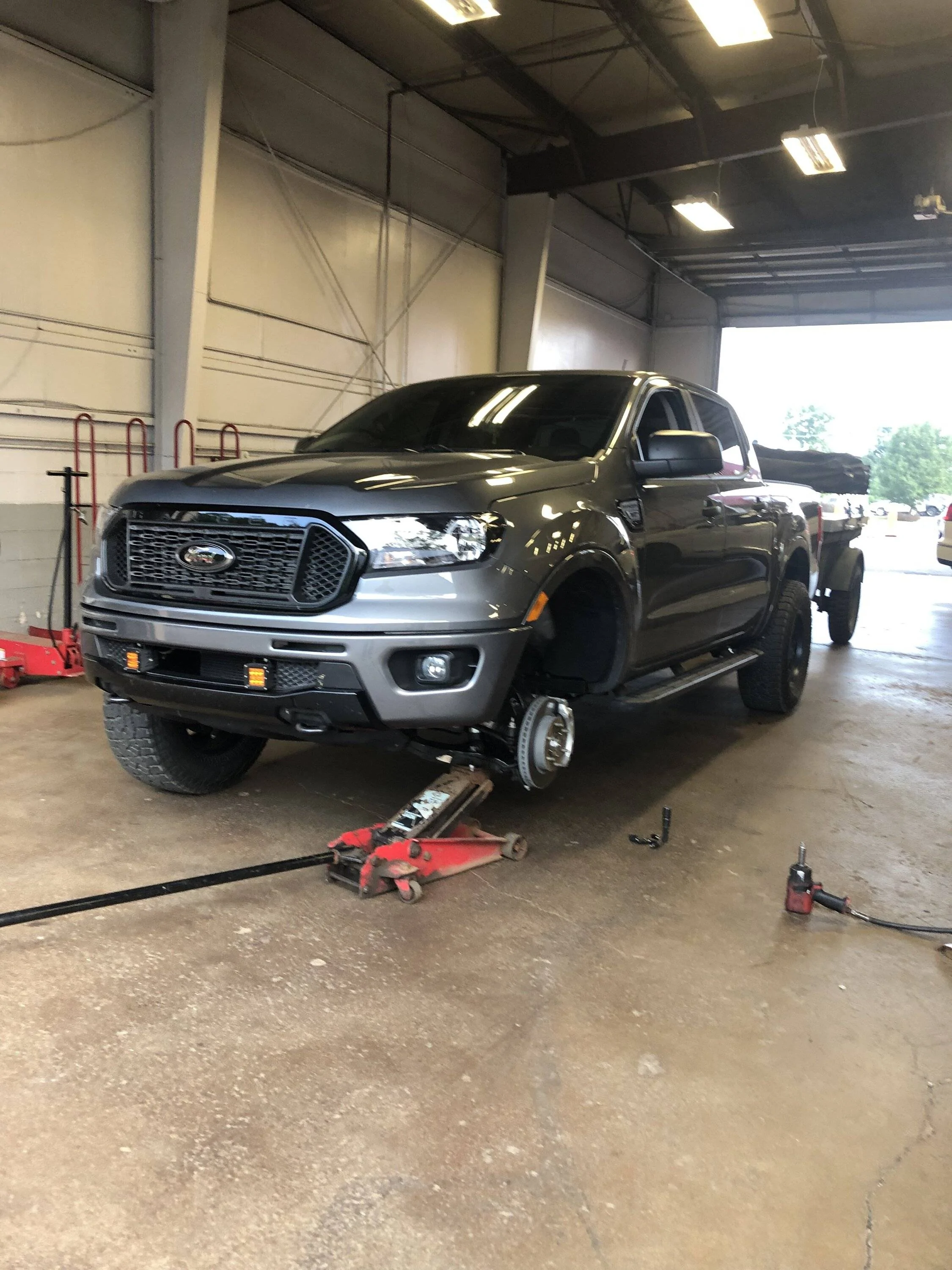

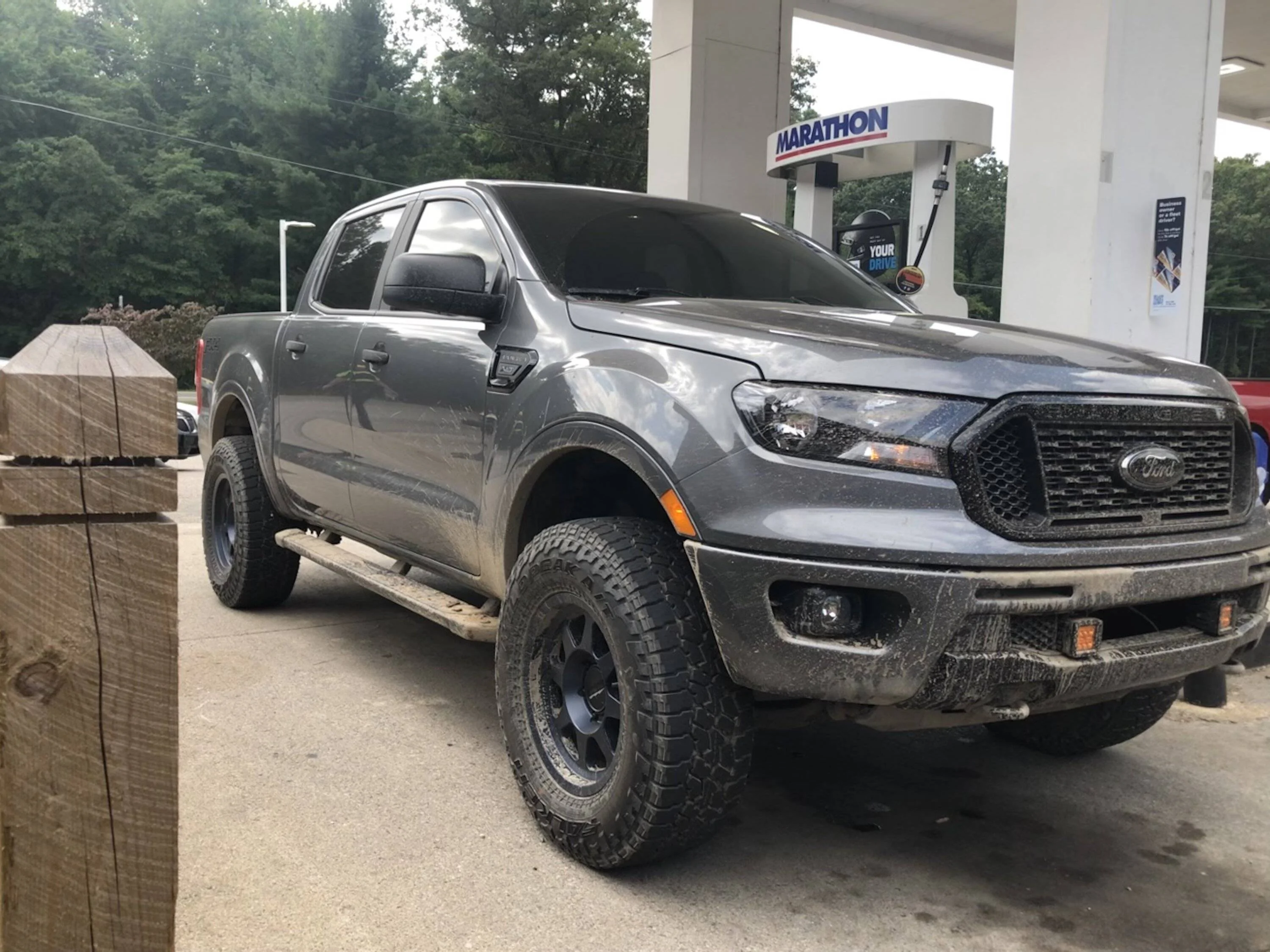

I would put money on the balance. Did they put weights on the barrel just inside the spokes AND weights on the lip? If not, you got a static balance, which will never be as good. I'd have them rebalanced before you start looking at hub rings. I have NEVER found hub rings to be necessary. As long as you use the right lug nuts for the wheels, and the correct mounting procedure, they should center up just fine.
also yes its just on the barrel near the spokes so my guess is improper balance but no time to take it back before my trip sadly...

Who did the install? You should be able to get them to do a quick balance before your trip.

discount tire but i leave tomorrow at noon and i work 2nd shift so not much time tbh i can call and see but i highly doubt it

If you can swing by at 0800, they should be able to knock it out quickly. Call them and set an appointment. Tell them you just had them done and they aren't right. They should be able to take care of it quickly. They can also install hub rings, if you decide.

ya im gonna call on break but hub rings id have to order some and tbh ive never had any so im not really worried on that i just dont want a vibration haha

ya thats my thought as well and tbh im gonna get the ball weights where its always balanced. you know where they put them into the tire? cant remember what its called lol
agreed ive never needed hub rings besides on cars with odd lug patterns but never on a truck so figured id ask
Have you had those weights before? I tried them once and they worked great until about 65 mph and then they bunched and caused a wicked heavy spot. Regular dynamic balancing, using wheel weights, do a really good job.

ya ive had em in the past when i had 34s the larger the tire the harder it seems to balance it seems
