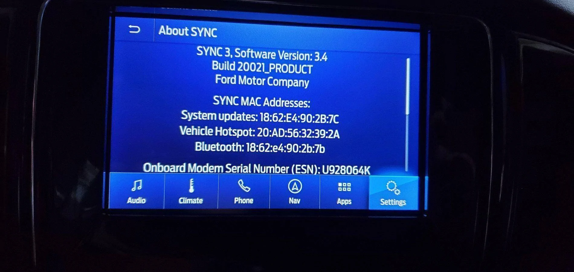

The MAIN thing to check - is the Sync Screen - displaying the ESN for the modem.
Like This: Note: This is an Older Sync Version, just a ref for the ESN
Plus also note - Ford Pass just had 2 recent updates - last week, that may be the issue
Yes 2 (in the same week) - sometimes those updates causes it to drop its handshake with the truck. I have a feeling this is your issue.
You may need to (unlink) the truck and (relink it) - The Handshake (Authorization)
It has been out for 5 or 6 months. When I went through a troubleshooting process with fordpass help line i remember that esn number being there. I'll check that again!
