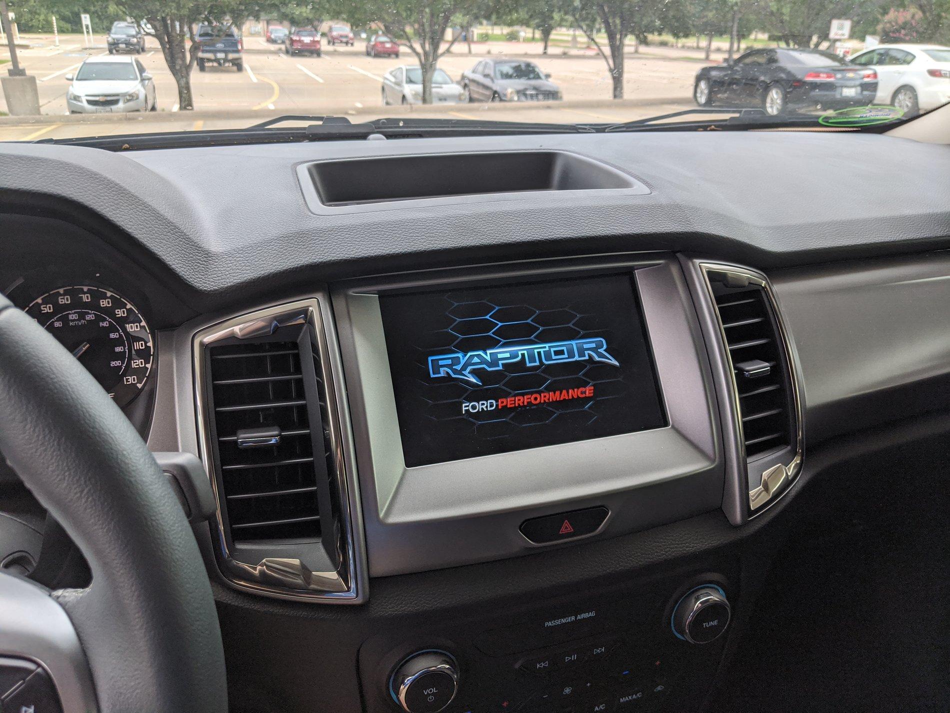

(2020 Ranger XLT, Sync3) Press "Next Track" button on stirring wheel controls and "Next Track" under the infotainment screen at the same time for about 10 seconds. A Speaker Test will start. Press End Test. Then a menu will pop up. If you select "Enable Test Settings" this hidden menu will now be a choice on your normal settings menu. If you scroll down, on the "hidden menu" there's a test-settings, inside those options you can change the splash page logo.
Yes, this works but will disappear as soon as you turn the truck off.
