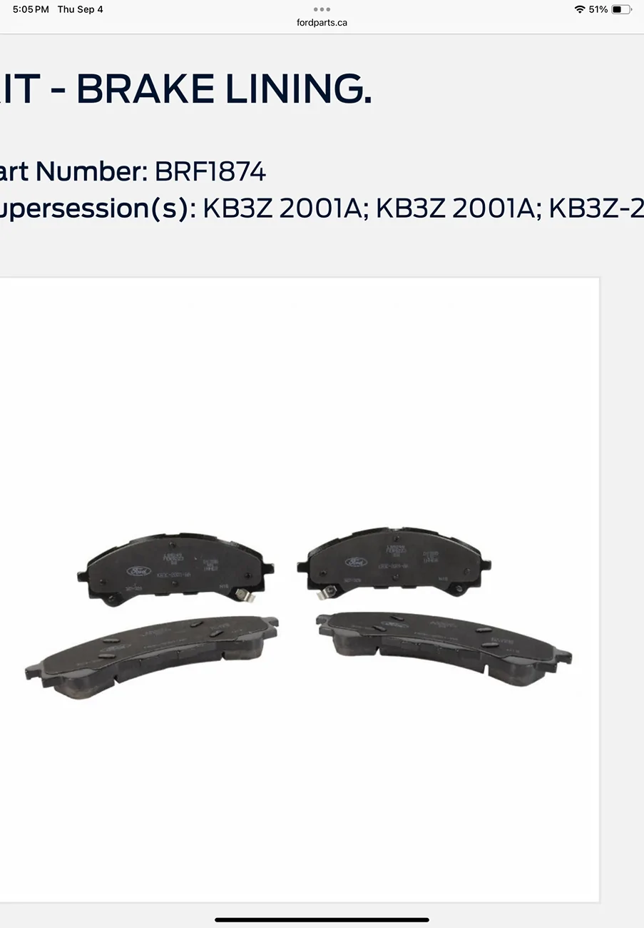

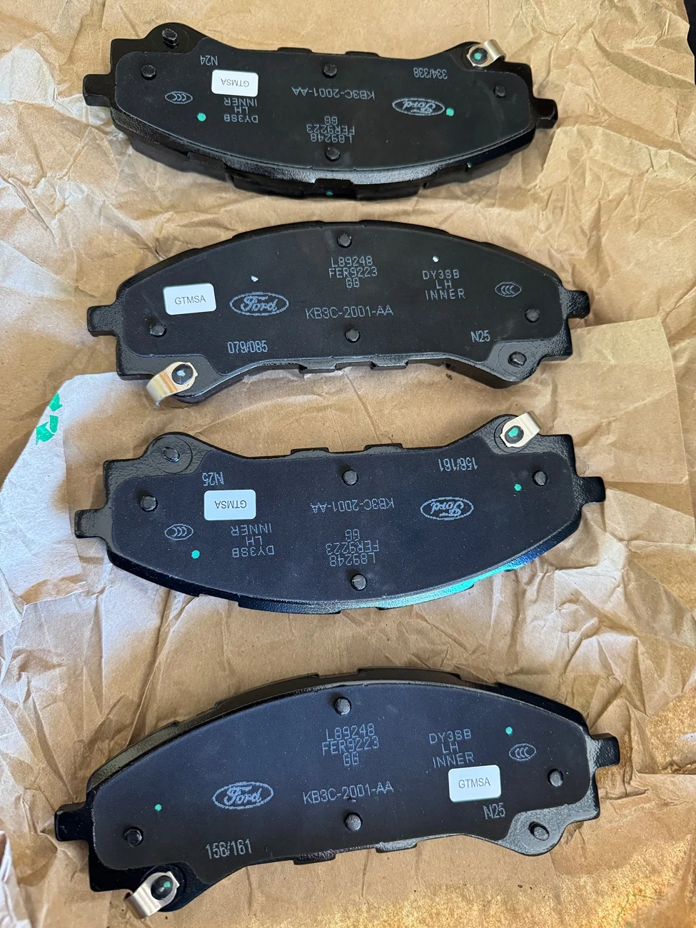

Jumping in on this older thread cause I wonder if what is pictured is correct? BRF1874 and all 4 pads say LH INNER. I can match them up left and right but…….Is this right? Don’t want to get started only to find out I’m screwed.

Are those your fronts or rears? Problem if they’re rears.
Your part# suggests fronts but ford parts site shows these…
The ones in your picture look like the outers have been swapped for inners.

@jovey70 - looks like you've got 4 LH Inners where you should have one of each: LH & RH Inner, LH & RH Outer
I think that’s the NASCAR Ford Mustang setup. You know, so they can drive 200 mph all afternoon, making nothing but inside left hand turns. ;)

The outer pads do not matter - side specific- but the inners do, the squealer tab (installed) position needs to be down
