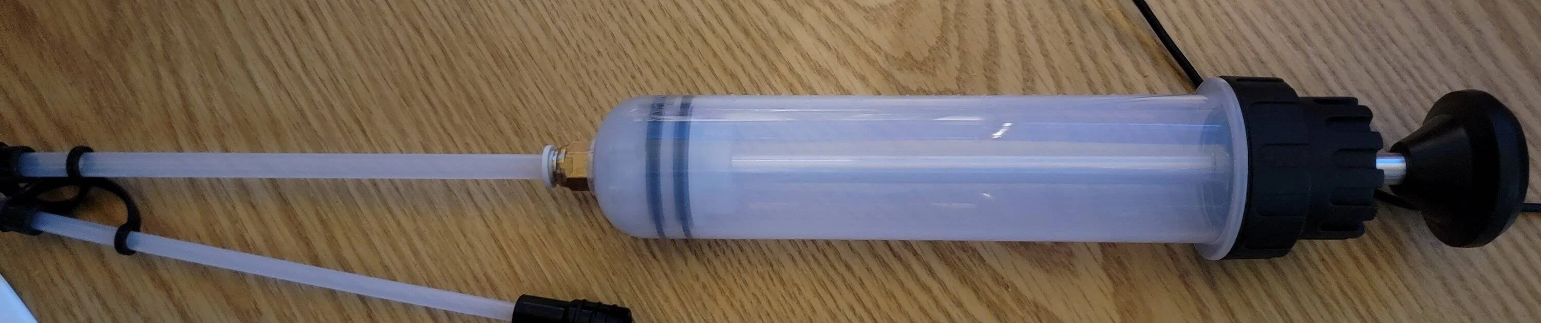

Thanks for the tip, but I've got a nice little baby funnel and hose that works great with MBS Dipstick! ULV drains quite fast using it, and I won't risk over filling.
I'm going to use this: ($12 on Amazon)
About a 1/2 cup at a time. Unless the transmission is leaking/using a LOT of fluid, just a couple shots from this should do it. (Also works grate to suck the brake fluid out of the reservoir when doing a fluid flush.. fill with clean and start bleeding... much quicker)

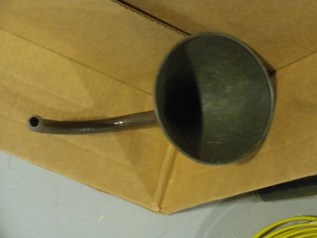

I was able to use this. My vintage funnel. The tip fits the FitzStick perfectly. Checked mine after install & had to add about 1/3 of a qt. All is good. :like:

Those old metal funnels are great, those used to be the standard until the cheap straight plastic ones came along.
Glad it went well? Thanks
