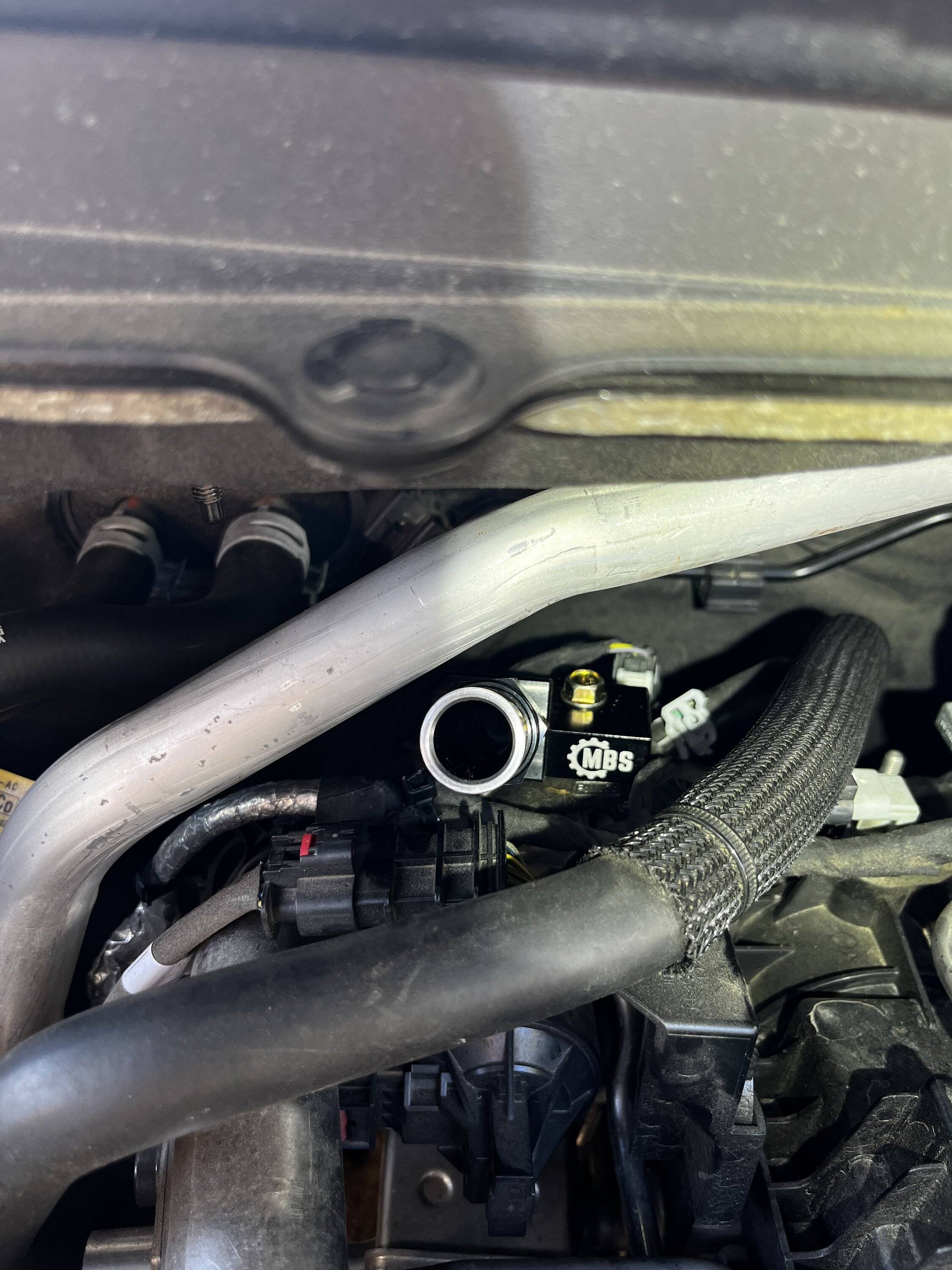

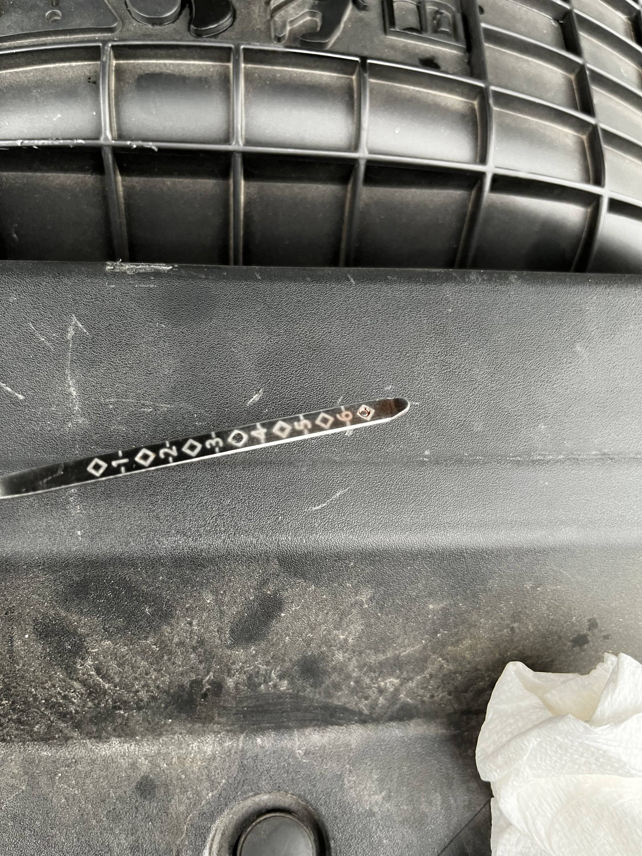

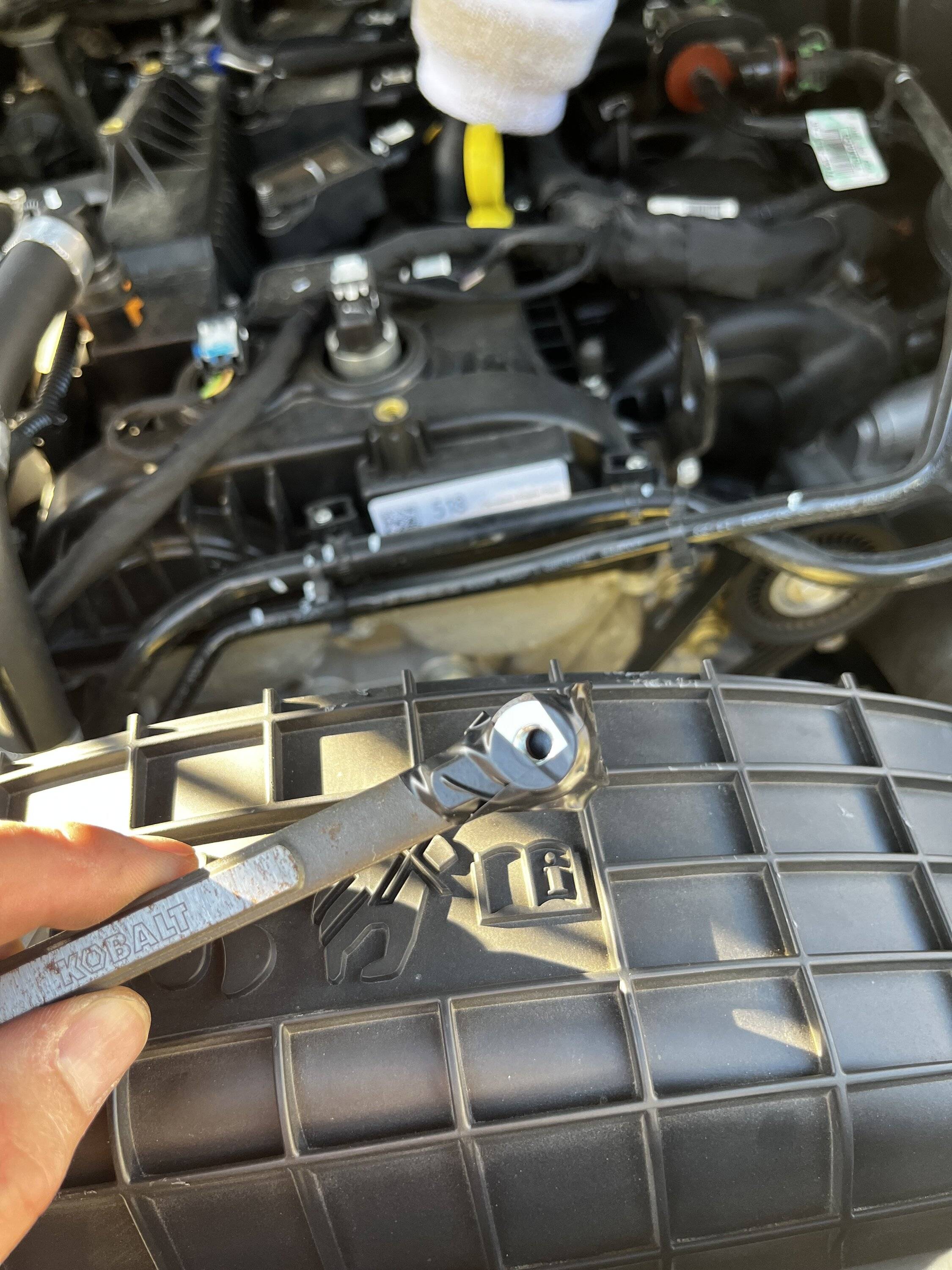

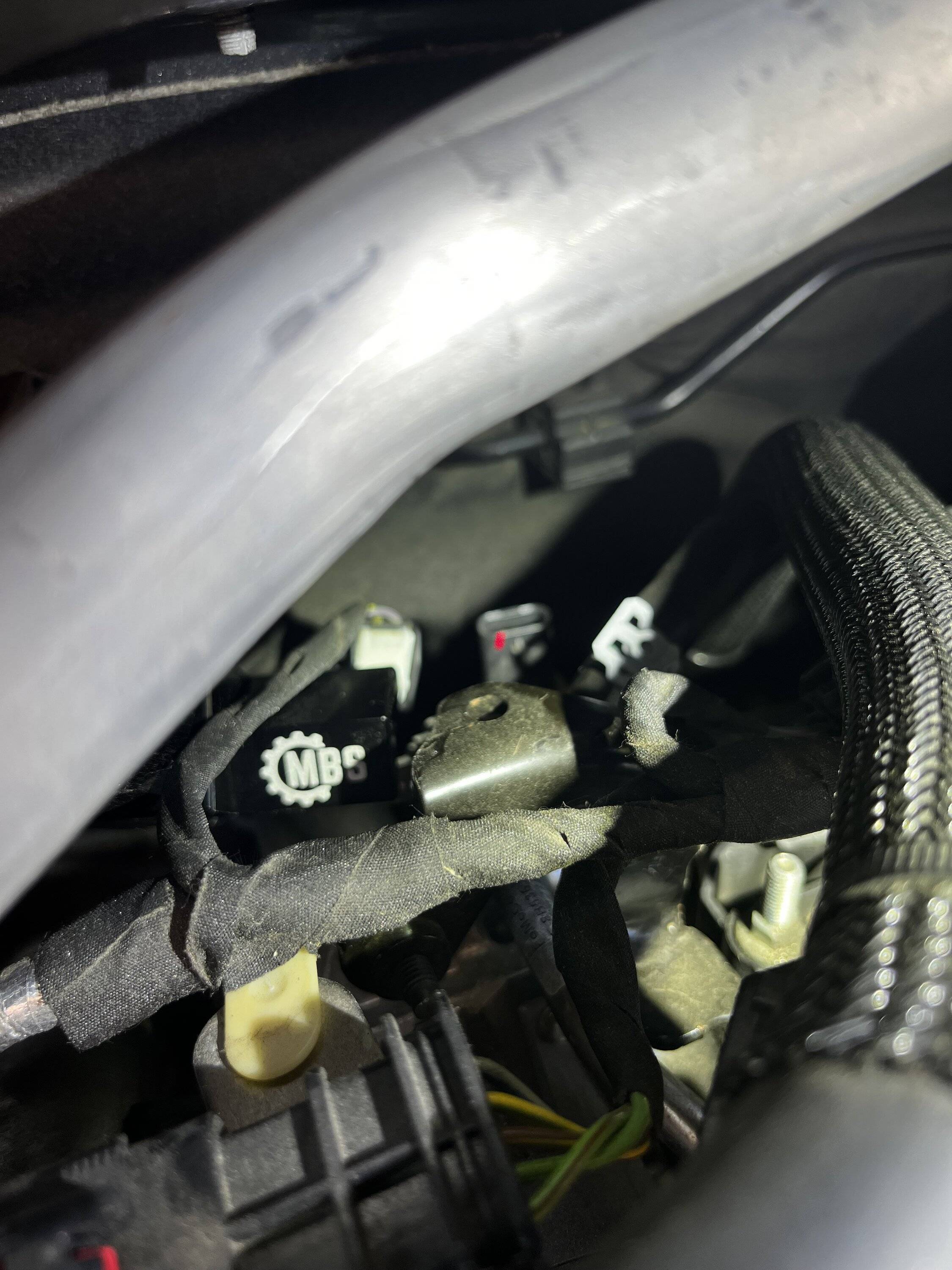

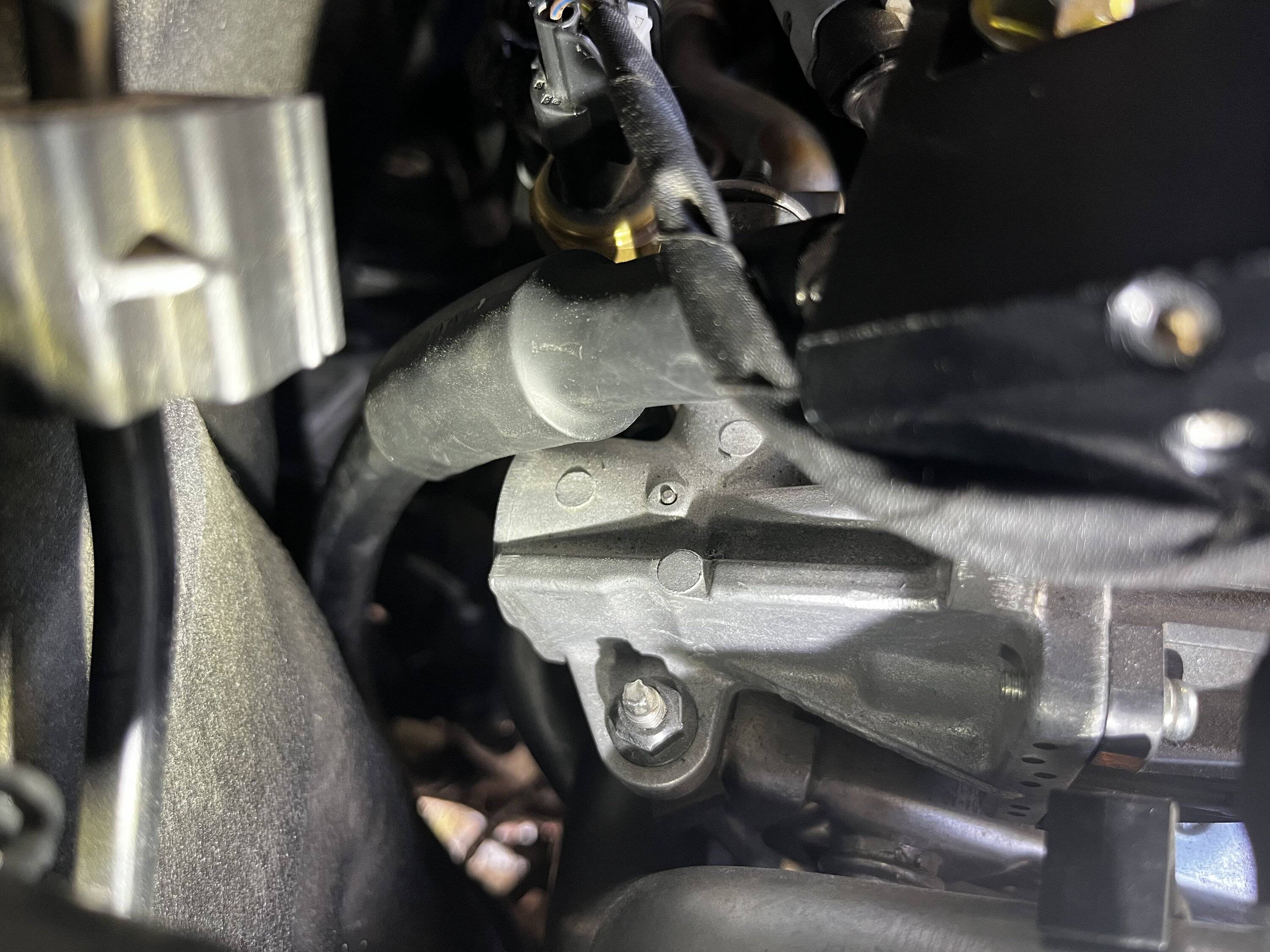

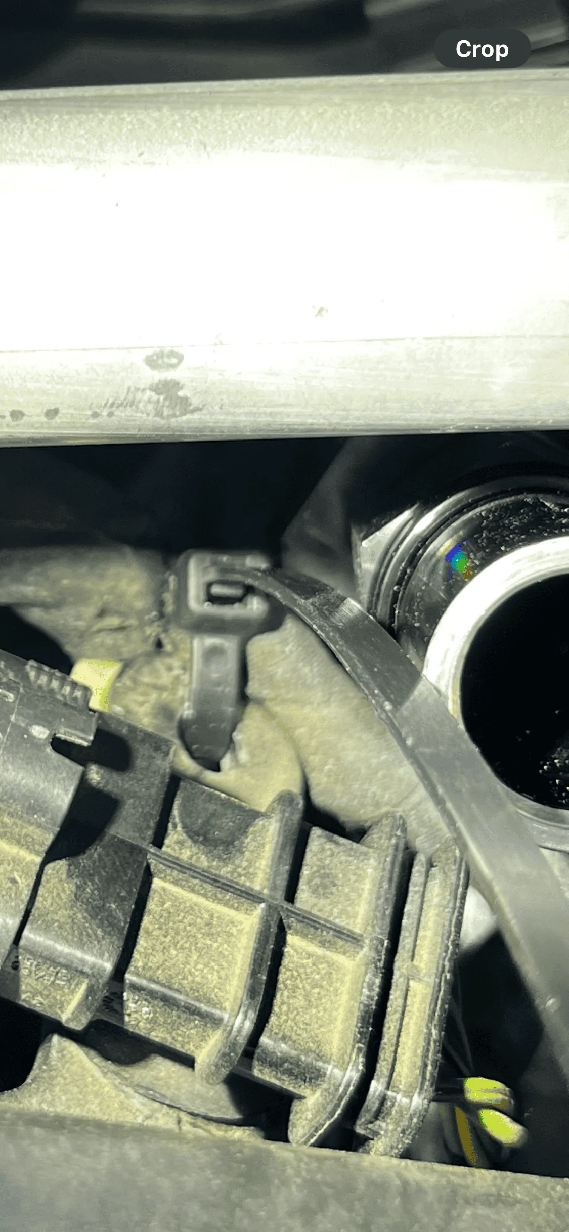

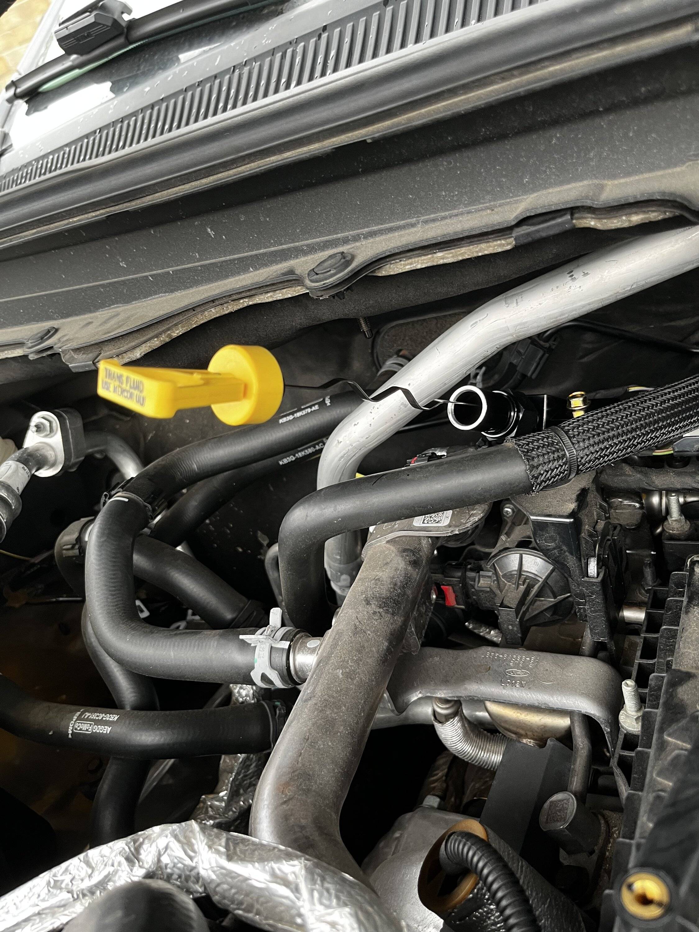

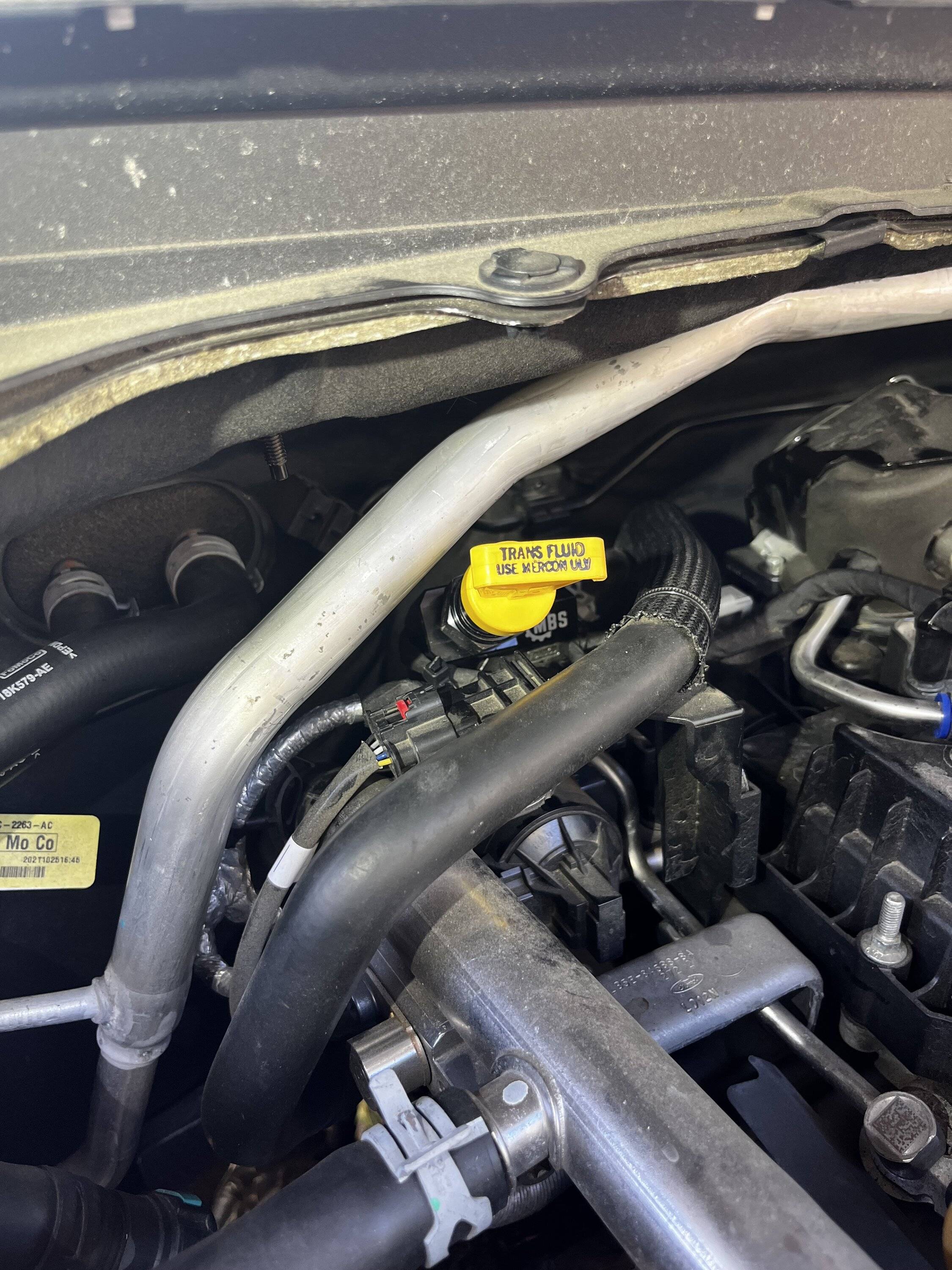

Okay. I completed the install Friday and was finally able to check the fluid (the correct way) today. Everything fits great and fluid is sitting right at ‘4’ on the stick. Pay attention to the photos in the install instructions. I recommend looking at them digitally so you can zoom in. My printed set were not as easy to see the details.
*NOTE 1* To check the fluid, on my 25 minute drive to work I did some spirited driving in S mode holding gears at 4k rmp. When I got to my parking lot, I ran through P R N D for 60 seconds each then checked the fluid level while the motor was running.
*NOTE 2* I had to reroute the plug that is directly behind the dipstick mount. I ended up removing the christmas tree fitting and slit the wire wrap a little bit with a razor blade to get more slack on the wire. I fitted it back up with a zip tie to make sure it didn't jostle around.
*Note 3* Use some tape to hold the nut on the washer if you go this route to avoid dropping it into the abyss.
*Comment* only minor comment is the dip stick takes some negotiation to get fully seated as it wants to hang up the last 6”.

I am very curious about what loom you moved, I knew as a mass produced vehicle they would all be a little different, the A/C line is in a different place on every truck I've seen for example.

I think I got it, been studying the pics.
Okay, I see another important point, there is a long tab off the large steel tube running down the side, it holds the wire loom and the connectors off the tube, on Dr3wDrop's truck, that tab looks higher than others, (or at least mine and the 2 others I have installed it on) it bends really easy, you can bend it down a little and still keep the wires off that tube, that should give that loom more room.
If anybody gets in there and has the same issue as Dennis, see what the best solution might be, zip tie or bracket adj or?? then I can add it to the instructions.

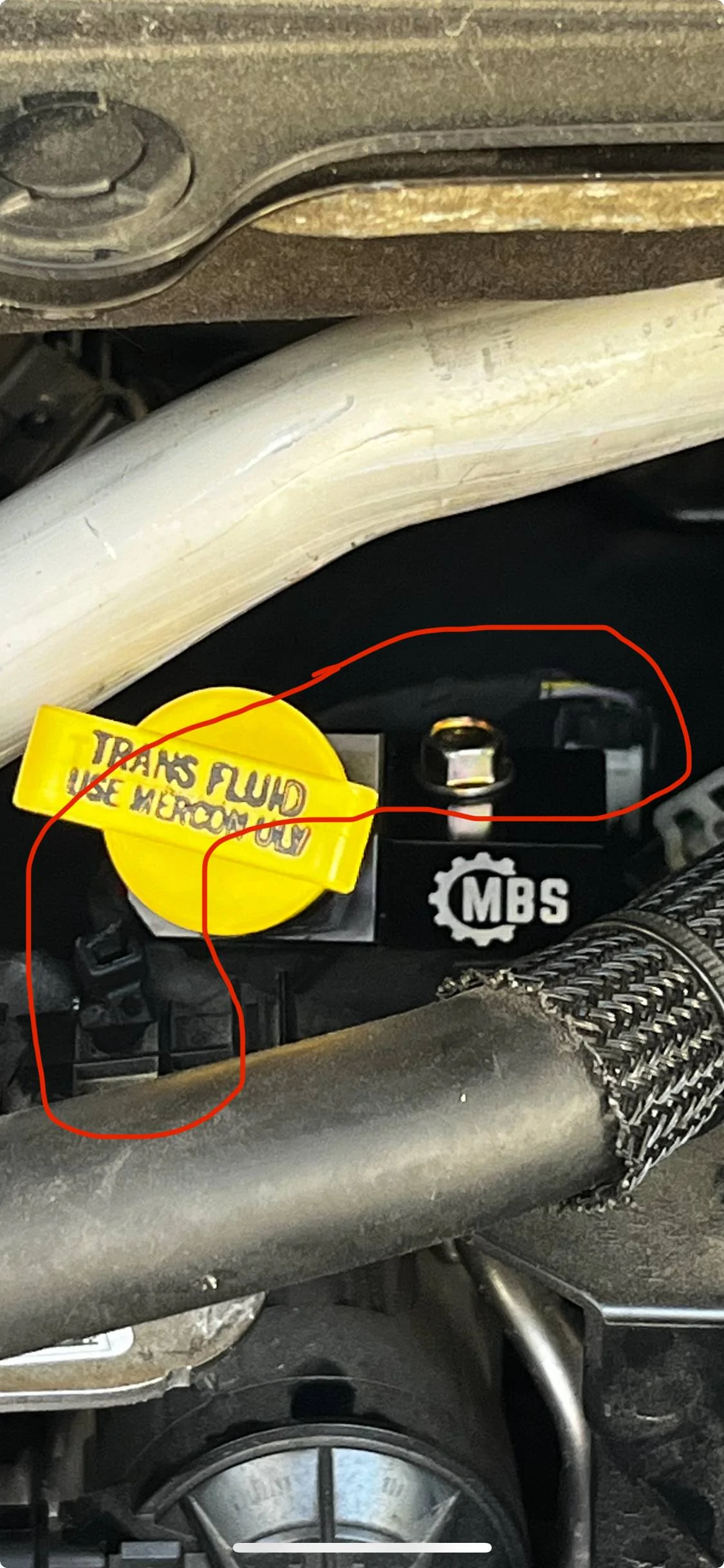

Maybe just a note in the instructions to not pinch that wire and make sure it has some slack for the connection. I tried to use the laser on my flashlight to point at the connection point and what harness clip I was talking about.
Based on your install photo's you had that wire go under your bracket.
I once heard that when you have bright red text on a page of black text the red is missed because it a different color than the main body of the text :facepalm:
This is where I first mention it on page 2 in bright red text:
NOTE: BE SURE TO KEEP WIRE LOOMS AWAY FROM THE BRACKET AREA WHEN TIGHTENING DIPSTICK TO BRACKET.
This is where I mention it on page 4 also in bright red text:
It is important make sure the small wire loom does not get pinched between the engine bracket and the dipstick bracket.
The instructions are only 5 pages long, two out of five pages mention it, I did the best I could
