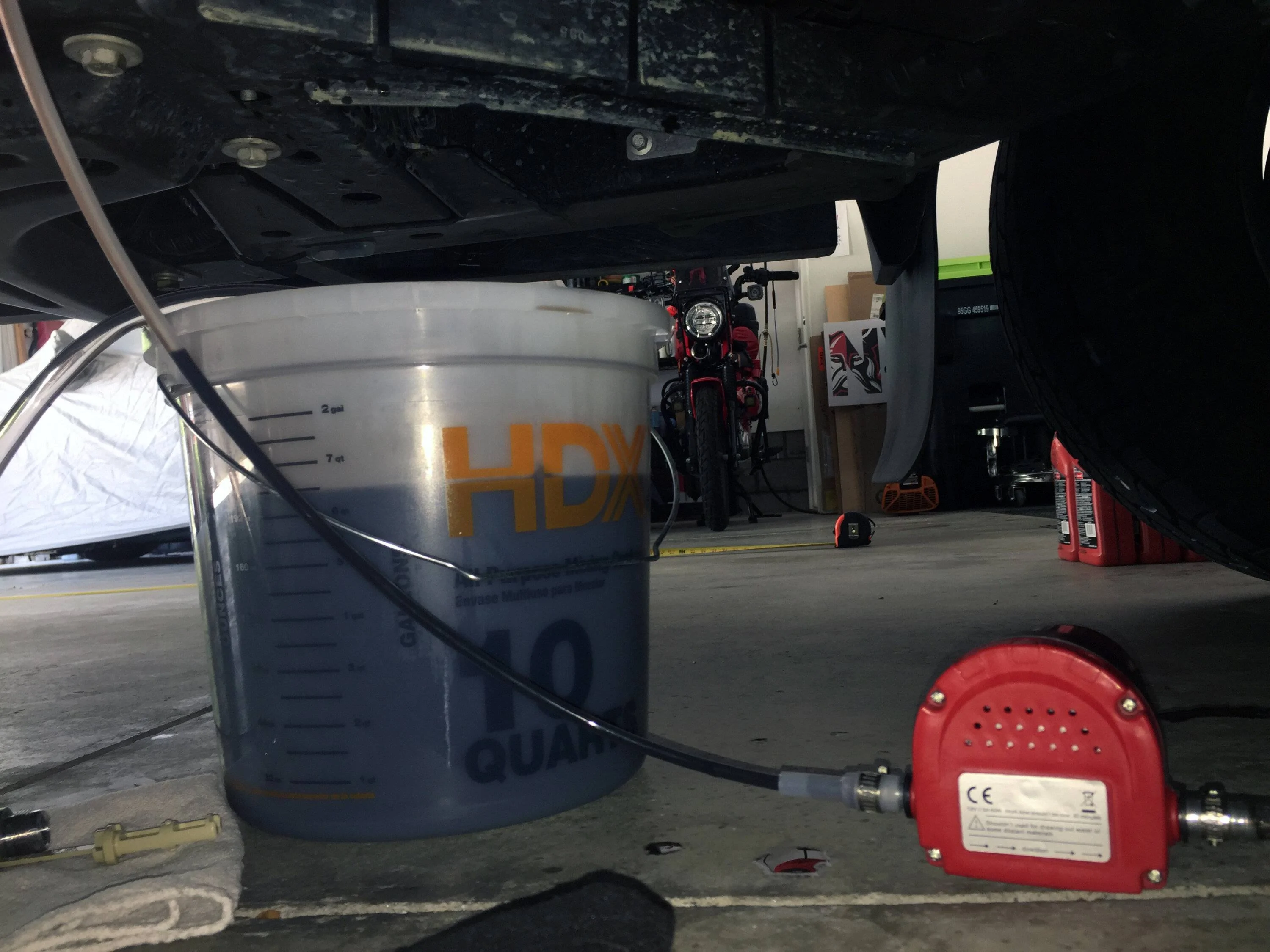

I drained mine by pumping out fluid with 3/8 nylon hose and got 7 quarts out...
A longer hose should be able to accomplish the same result with less mess...
LOL, that's the same pump I have. I made the mistake of not putting a clamp on the outlet tube the first time I used it, AND I powered it off of an 18 volt battery.
You can see where this is going.
The ATF went EVERYWHERE, all over my Type-S, and inside the truck slightly since I had the windows down.
And I had a truck with no transmission fluid in it, so I couldn't just move it out of the garage and wash it off, (I could have rolled it I suppose).
Off topic, but funny story, don't let it happen to you if you buy one of those. Take some time and a couple hose clamps and clamp those @#$@# hoses on. Don't be me and assume 'those fittings are barbed and pretty tight, should be fine'.
Back on topic.
The little nylon hose should fit down the dipstick hole I would think, It is pretty narrow and stiff.

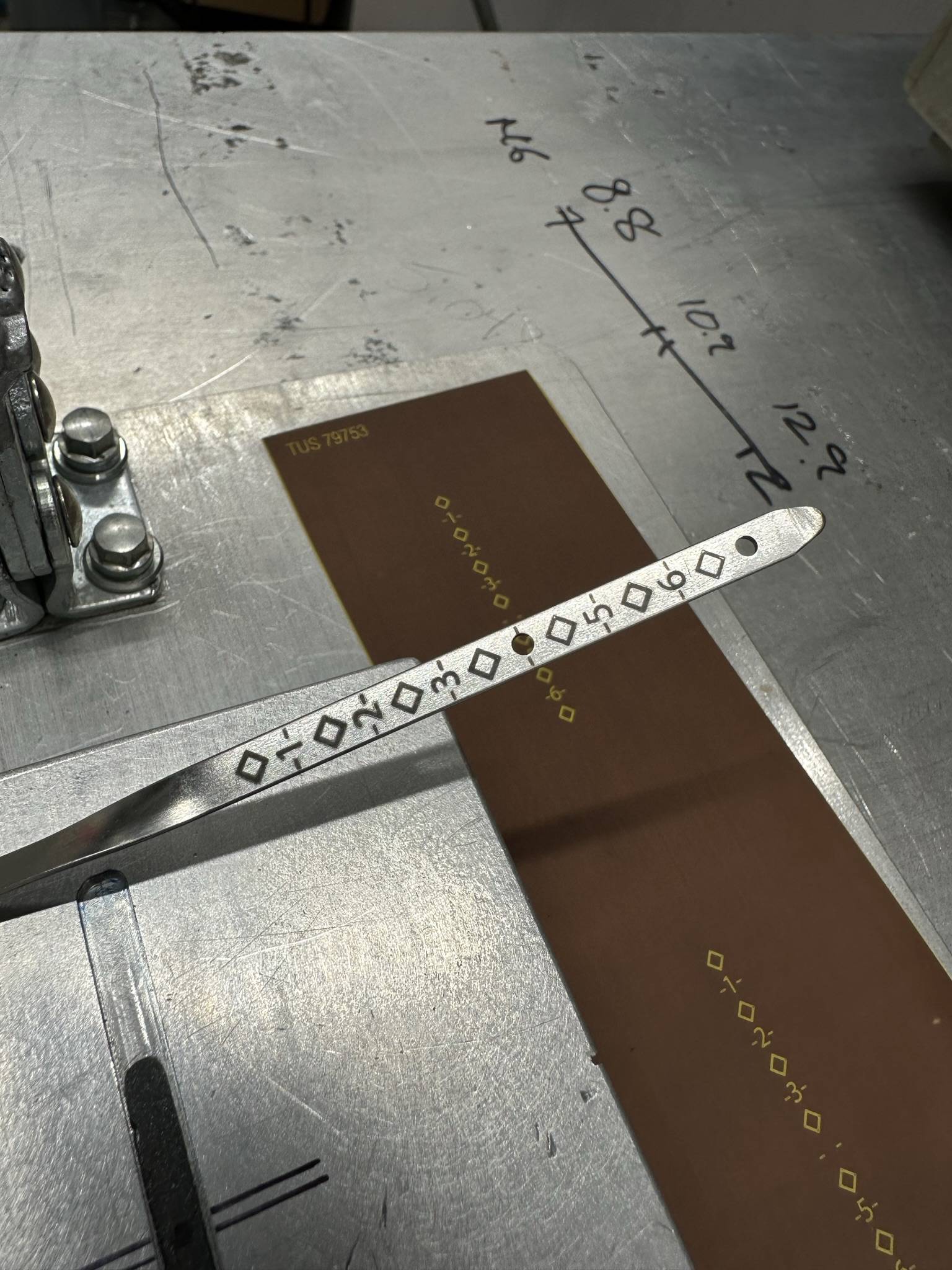

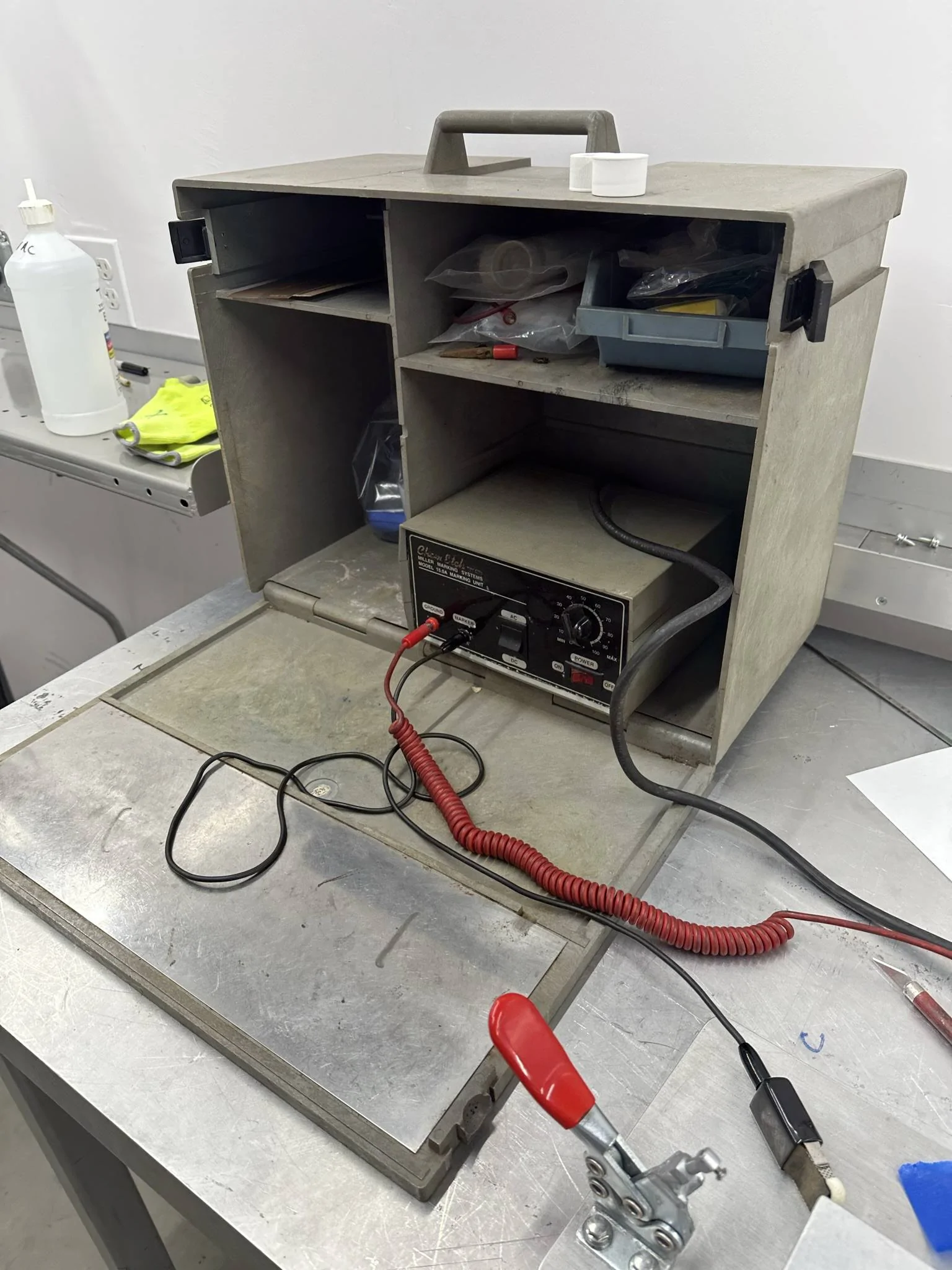

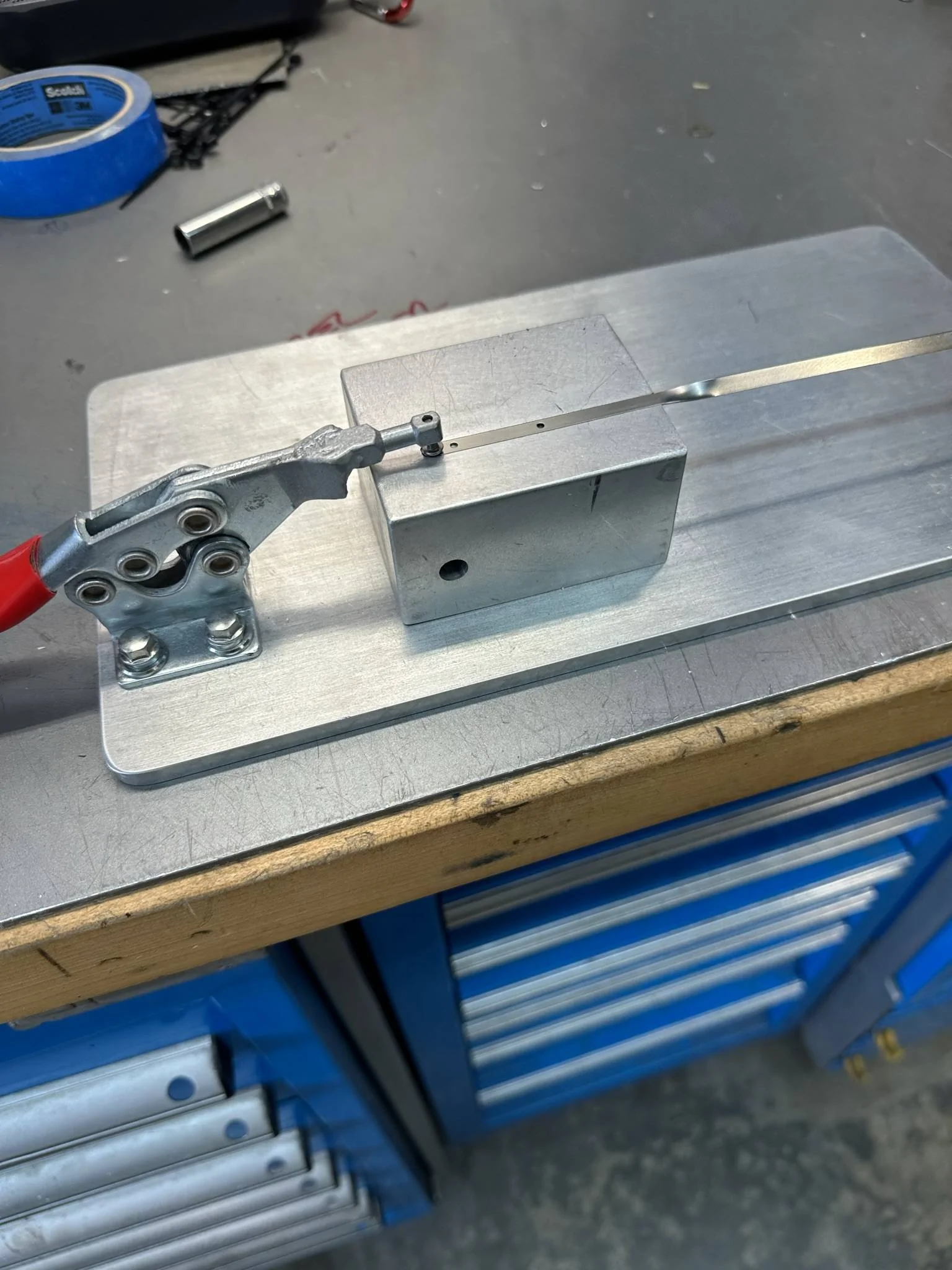

Okay, bit of a update, finally got the stencil revised, I wanted it to look more like the factory stick, ran a test piece. I'm very happy with the results, it's clearer than the factory marking on the other side.
I made it so where the marking on other side that says "do not add in cross hatch area, check hot in park" the bottom of the crosshatch is 4 1/2 on the Ranger marking I added, the Ranger is supposed to be between 4-5, does that make any sense? I did it so if someone reads the backside of the stick and sets the fluid level by that, the level will still be correct.
The bracket and top fitting parts are supposed to ship in about 10 days, then it's off to have hoses made, taking forever but progress is going well at this point.
I made the marking jig, seems to work well, I machined a slot for a magnet to hold the stick flat and epoxied it in, the clamp holds the tip, seems to work quickly and well, I got lucky, got a ancient electro-etcher off ebay for $150, the stencil company wanted $450 plus the marking contact.
I still have to make the heat shrink shaping jig, haven't quite figured that one out yet, I may plug one of the test hoses at the bottom and fill it with a liquid 2 part epoxy, so the hose will harden in the perfect position, then make the jig to that shape.
