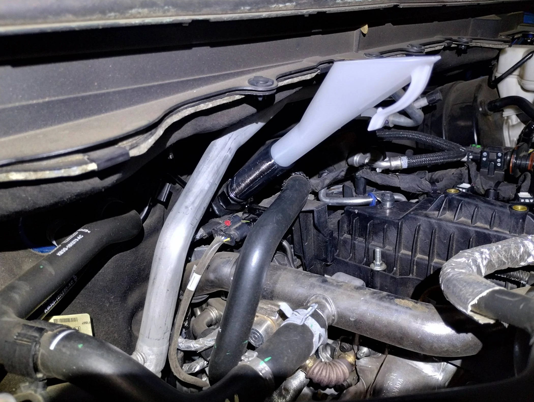

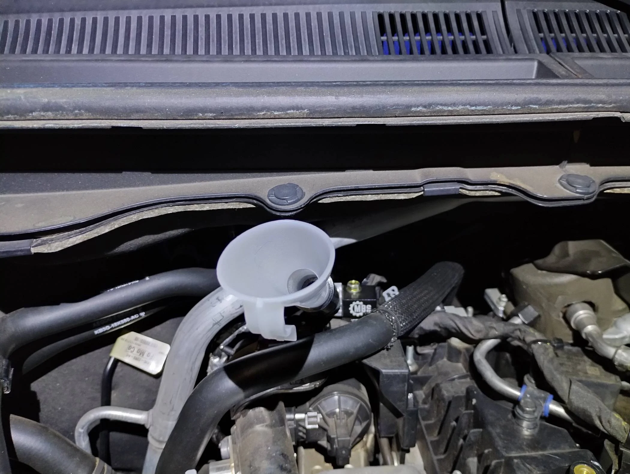

This is the funnel type I use with our FitzStick. Good fit. No mess. Like two bucks from wallyworld.
That's desecrating the Fitstick! How dare you! ?

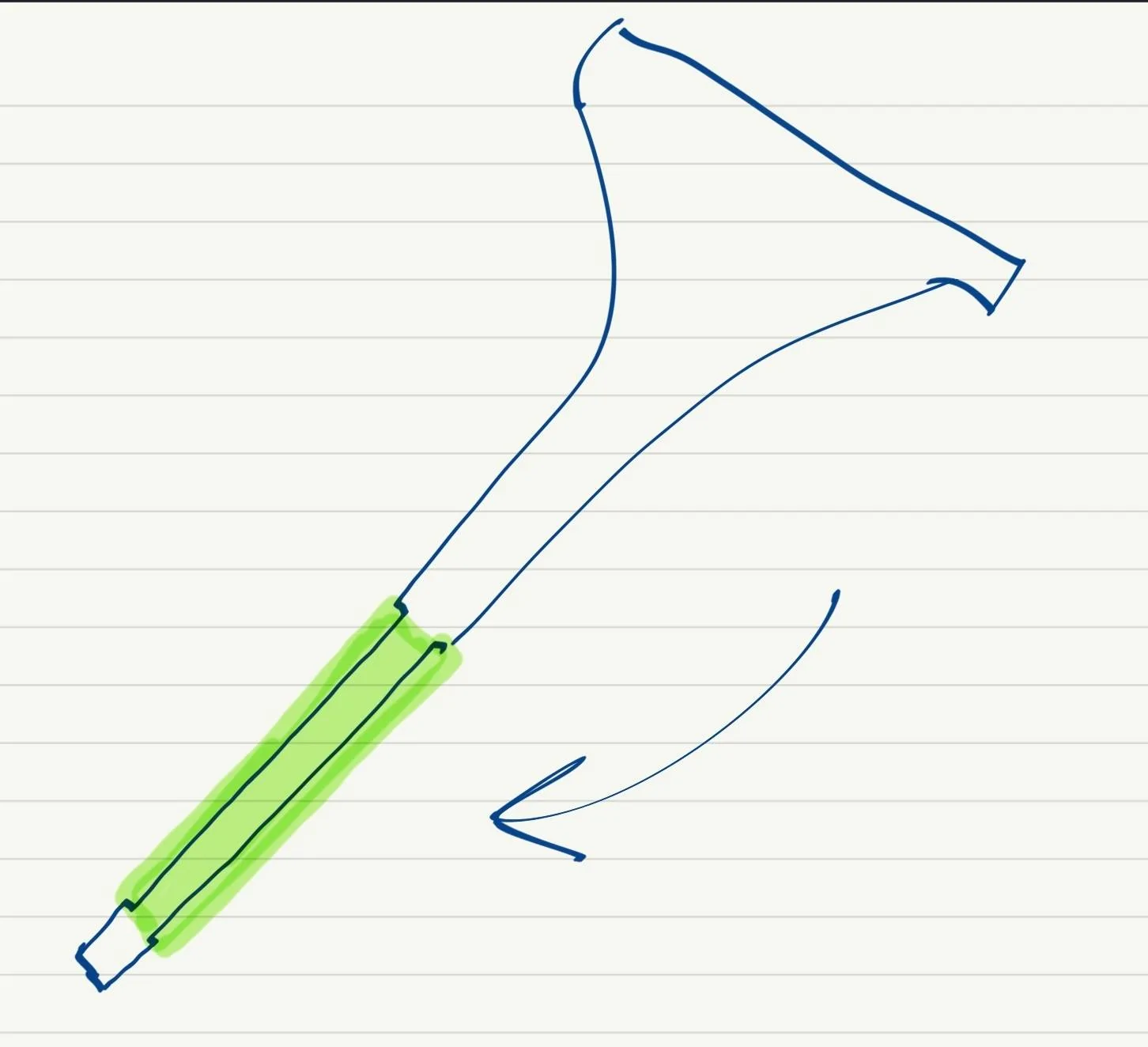

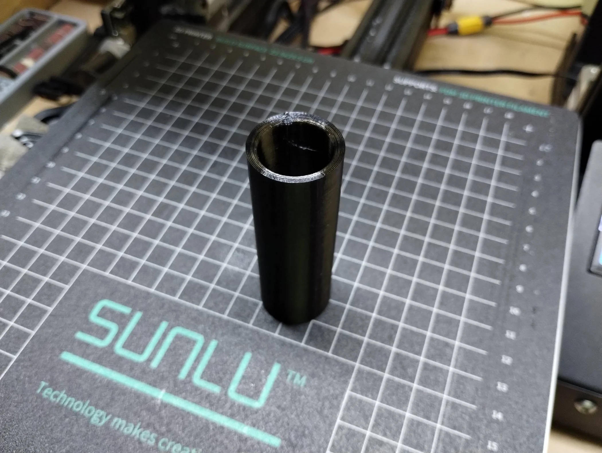

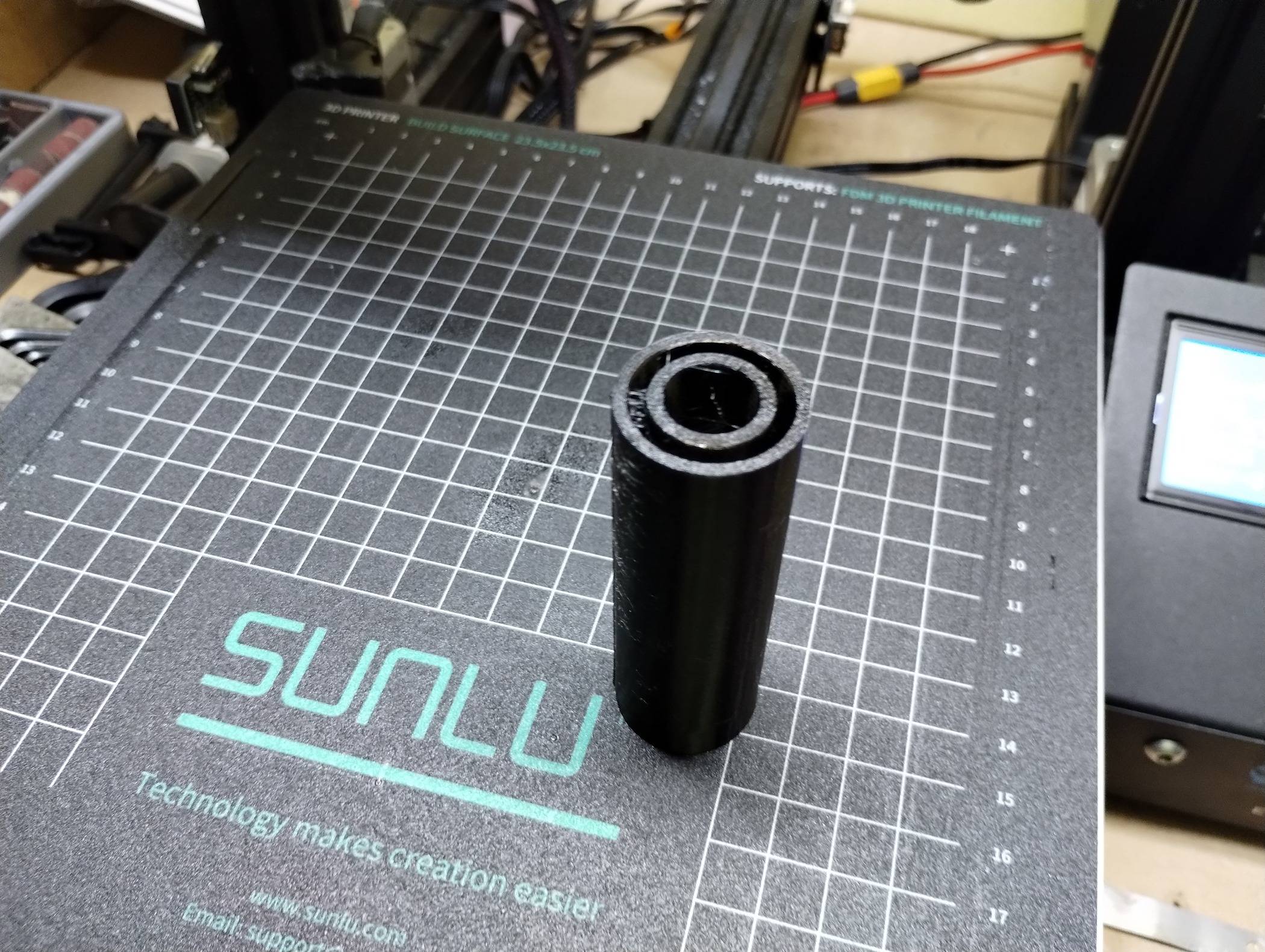

To be honest, like I said, I wouldn't trust a printed funnel...it could snap off at the head and leave you with a stuck part that would be a nightmare...you wouldn't be able to cap your oil filler...
Print it out of TPU, Still fairly stiff but yet semi flexible and much stronger than PLA.
I'll probably draw one up and make it this week sometime, I've got a whole drawer full of Orings that I can use.
TPU is probably too flexible (given the thickness, 2-3mm)...PETG or Nylon would be my next choice but still there's potential for layers splitting...I'd go with injection molded parts that needs to take rotational stress...

I presume a groove to retain an o-ring would be in order.
