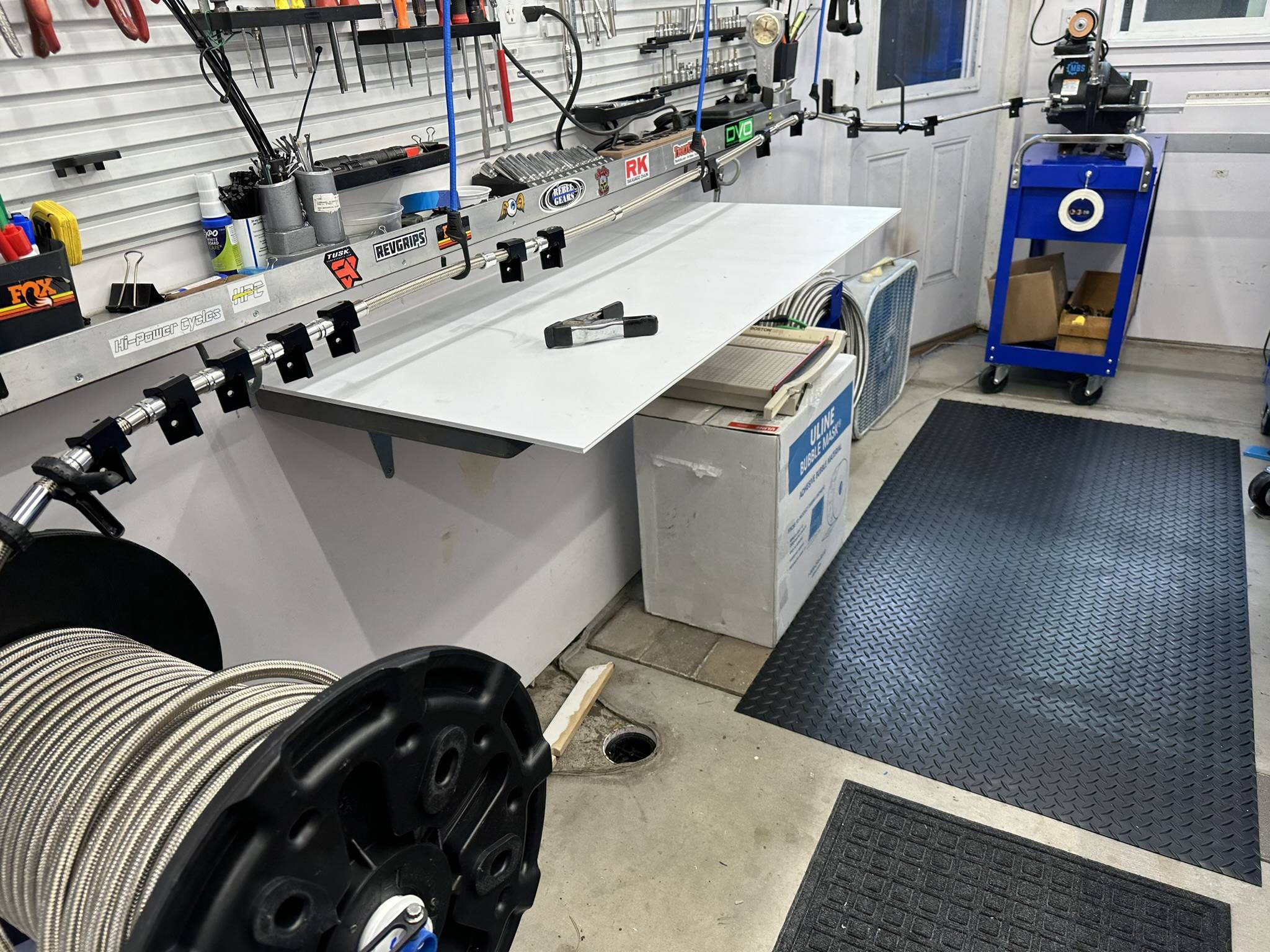

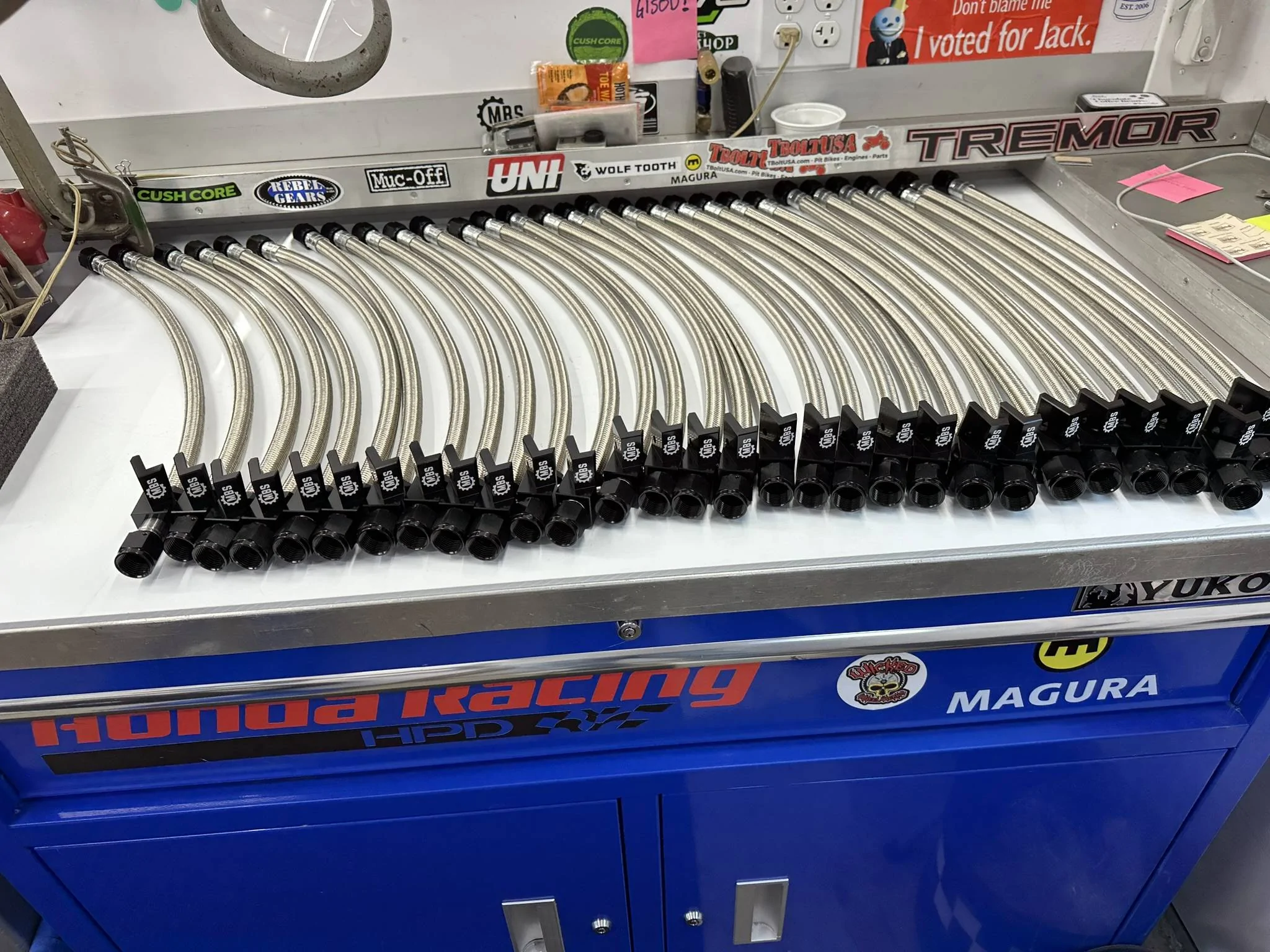

It's funny, with this group as customers, I knew I had better make it as good as I can, there are a lot technically savvy people here, and everyone is connected through here, so if it was great or crappy, everyone here would know right away.
As well as my own standards, I had to keep it off the firewall, it had to look stock and it had to be plug and play.
Now I have to work on streamlining the build process, they take a while to assemble, when I was at Honda it was all about efficiency, how to build race engines in a compressed schedule, you work on streamlining the work flow.
So, I used to have to put 2 collars and the bracket over each cut hose, I built a reel, a guide rail and other various things to cut the time in half, I load 10-15 sets on the hose and move it along as I cut and crimp, still needs some fine tuning, but I knocked out 30 of them yesterday, it's now so much faster and less finger pokes from the cut braid :LOL:
Big pile soon!
