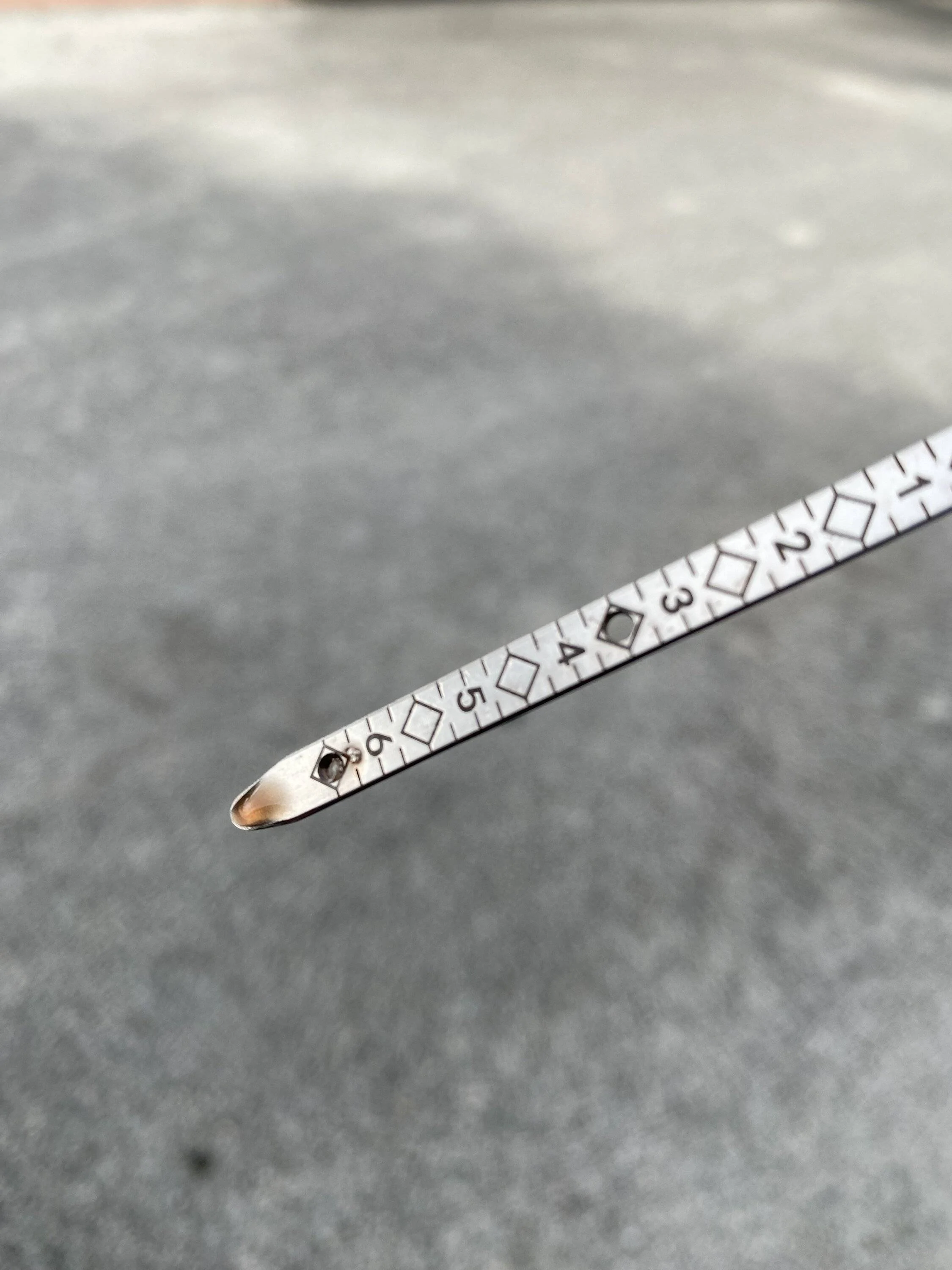

Below is the reading I got today driving home. The drive home from work is only about half and hour, but it’s on the highway, and I had it locked in seventh gear. RPMs were turning about 2500. While I cannot say the transmission was up to temp, the reading matches what I saw yesterday after driving for a couple hours on the highway at 65mph.

It's a little fuzzy, it focused down on the tip, if it's not between 4-5 like the instructions on the stick state, add some!
That stick has been designed to be accurate within 1/16th of an inch when properly installed, use it, trust it, set your fluid level with it, that's what you bought it for?
If you think that maybe it's off, something happened in shipping or something, I have the stick lengths recorded, give me your serial number and we can verify the length.

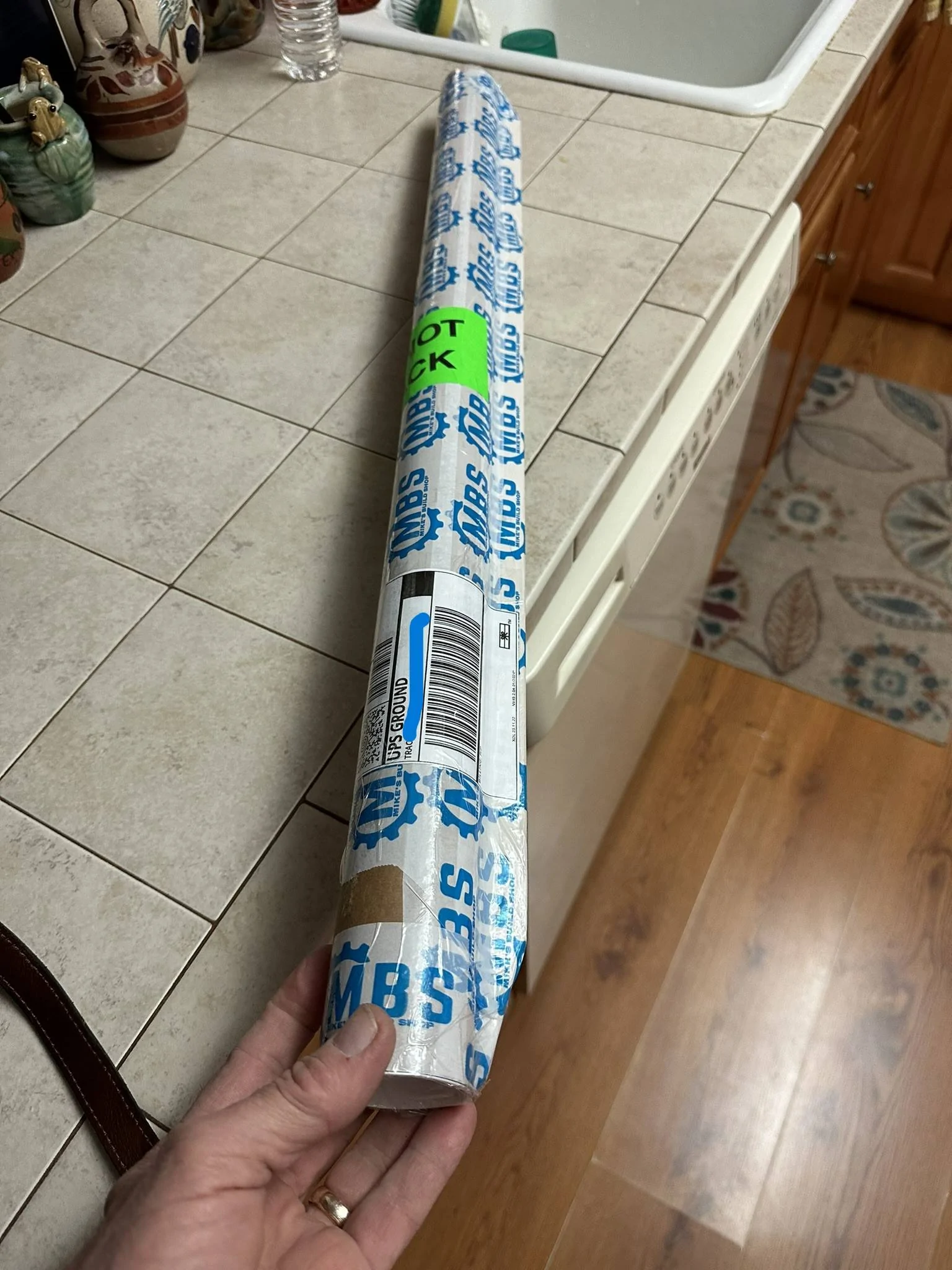

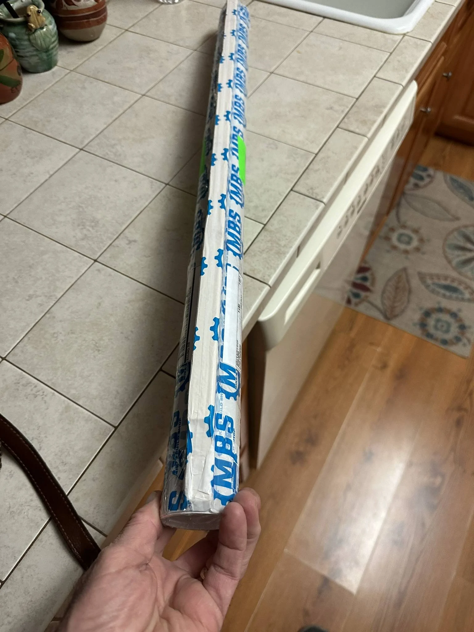

Hey, you guys on the replacement sticks, I hit another shipping snag, everything was fine, I was bonding a 3/4" wood strip to the outside of the tube to strengthen it, then tapping over it in MBS tape so the wood was covered, shipped quite a few sticks no problem, tube was in tact when delivered... until UPS doinked me, hard, apparently everything has to be covered in corrugated cardboard, tape over the wood is a chargeable offense :facepalm:
I am going to try bonding it inside the tube, that should be funny, Gorilla glue on a 3/4" square wood strip down in a 2" tube, then I have to clamp it... wait, maybe I can staple it through the wall of the tube, Ugh, if the box wasn't almost double to ship I would just use it.
I wonder if someone smacked someone else with the tube and went OUCH? I thought it was perfect, wont roll around the truck and get crunched, extra strong, hard to fold.
Whatever the case, I gotta go to plan C or D or wherever I'm at now!
Oh well, who said it would be easy:facepalm:
