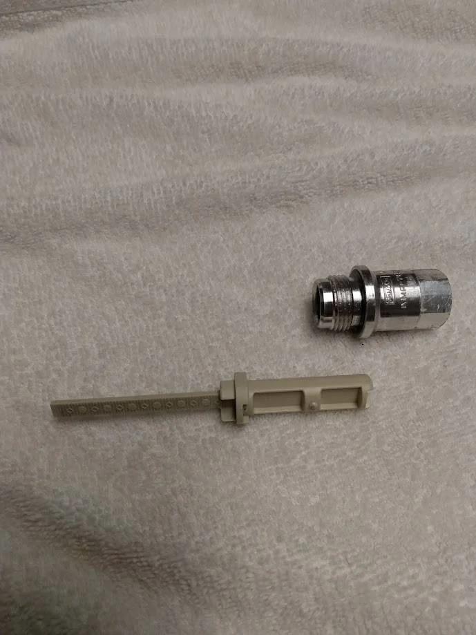

OKI have a problem so I got my stick. I'm trying to put it on today. Well, trying to get that cap off. The transmission from below is an effort in futility. For me , now I'm up above and I put my long extensions and the socket on it. And I just wanna make sure that Turn to my left, lefty loosen righty tighty. But that son of a b**** will not come off. That must have been put on by gorilla monsoon.
Any suggestions?

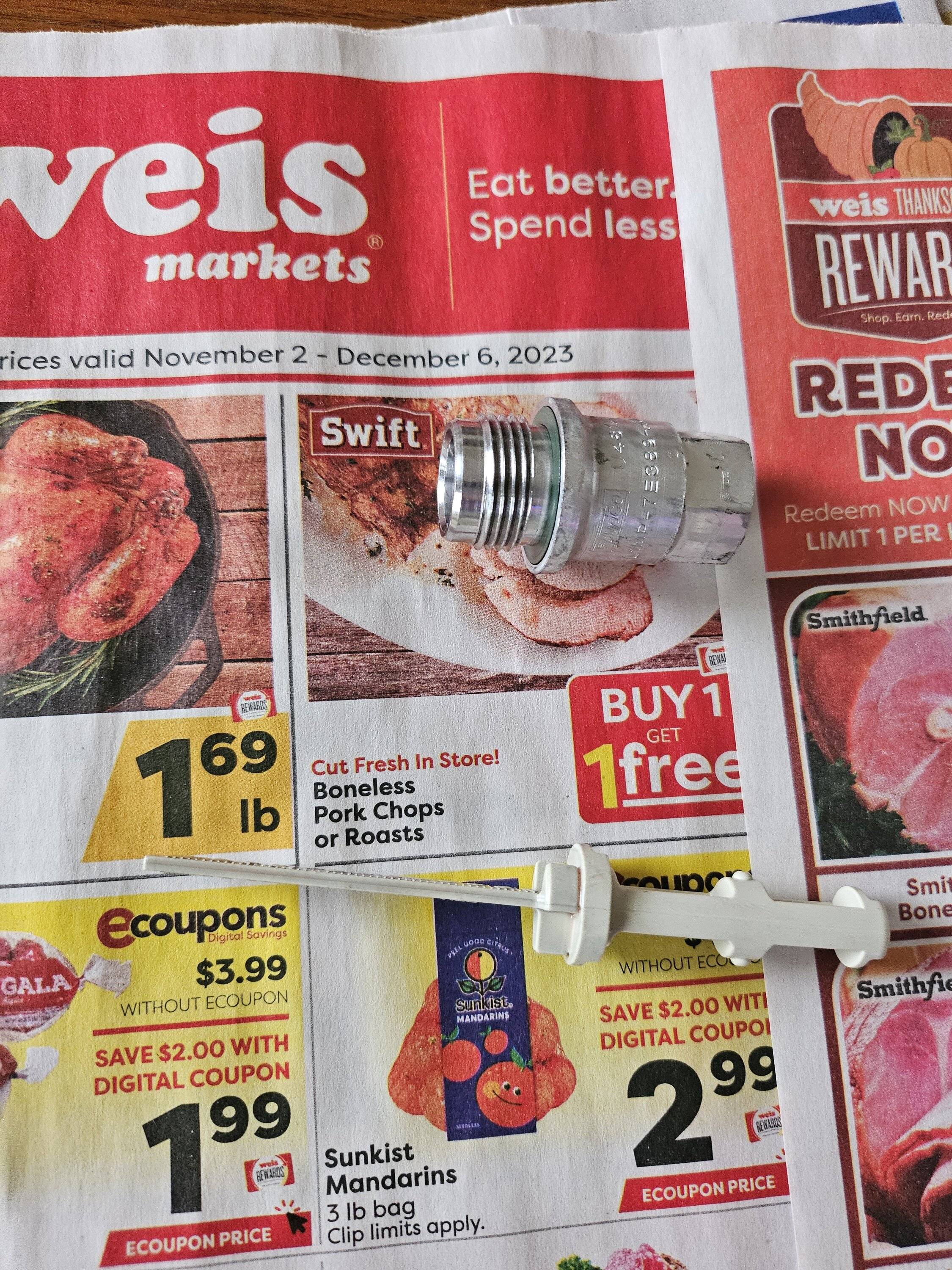

Here's a pic of the cap and stick if you've not seen it out...

The first page of the instructions shows the picture with the yellow arrow showing the direction.

Well I would like to see mine out! But I don't know i'm trying to use the three eighths breaker bar guess I will try a cheater pipe on it , It's sure ain't coming out like the video showed him taken his out?

Yes from the top turn left or counter clockwise. I had the same issue and with extensions as I had a hell of a time breaking it loose.

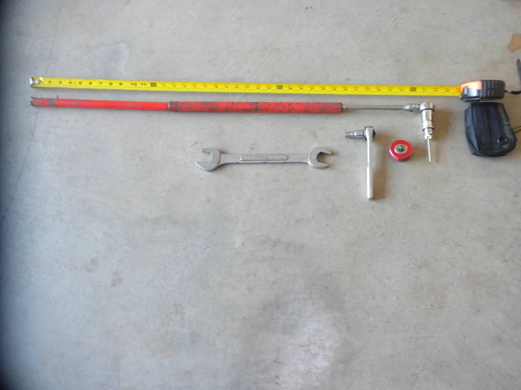

Here is a photo of what I used. I took the flap loose in the wheel opening made it easyier to get to. I could get better leverage. Yes it was Gorilla tight. Well worth the effort.
