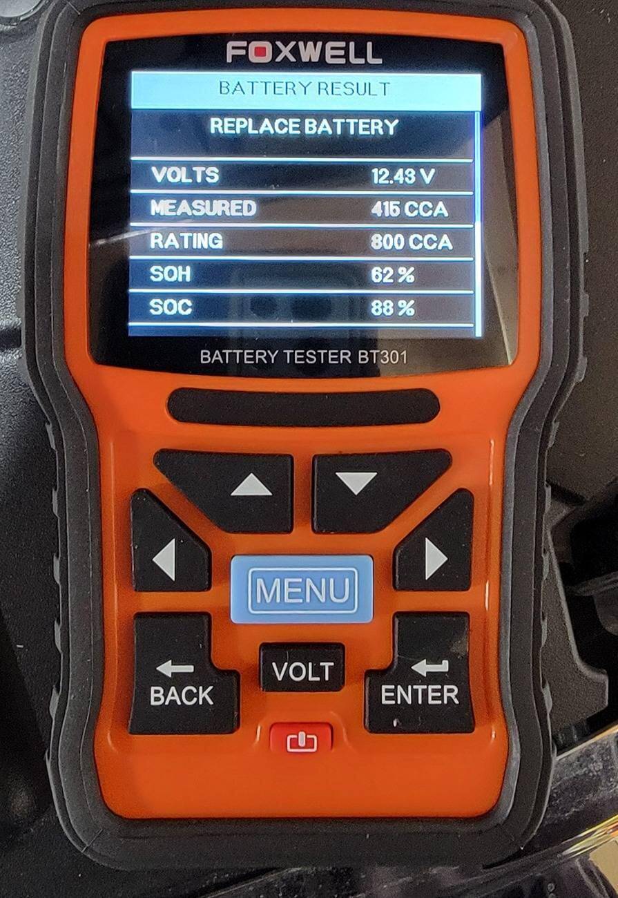

That doesn't look too good but the desulfator does wonders. . Can you get an IR (internal resistance) reading?
Yeah IR is really important.

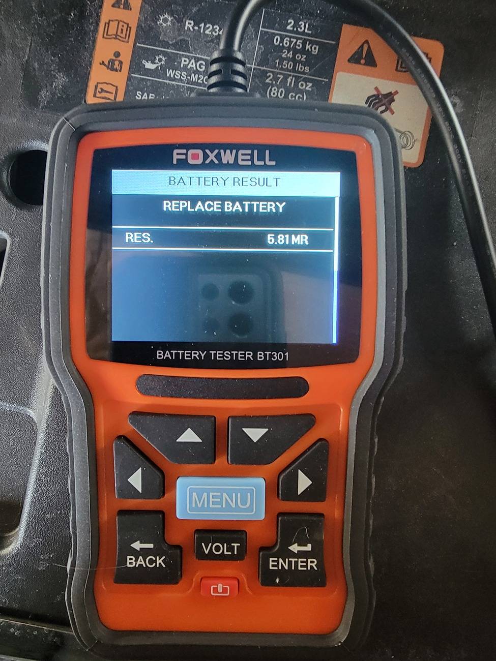

My tester arrived and I immediately tested the battery, but forgot to take a picture. The truck had been sitting overnight so it was a completely cold test. The result was actually better in some respects than what's shown below.
I find I get widely varying results when retaking multiple times in row. I guess it's the variance in how well the connection is. I go with whatever result is best.

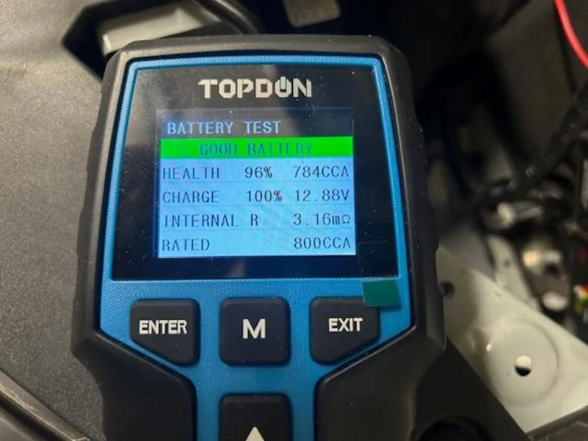

My last Test- Oct 2024

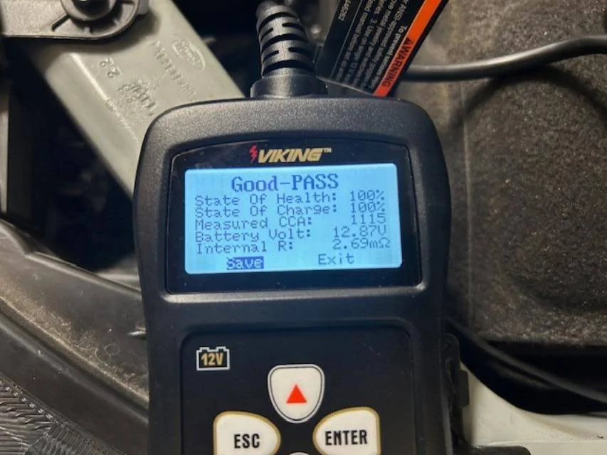

and to show how much the (Testers) can differ - this is hooked up at the same location and done just after the (TopDon) test was completed.
So, as you can see - the results will vary by each tool, it's in the design of them
But the Measured CCA and the Internal IR readings are the most important of the readings as they directly relate to each other.
The Higher the (IR) the Lower the CCA will be.
With the Foxwell Results Showing: 415 CCA then the IR is high (in the 5-6 Range), when it needs to be closer to the rated CCA of 800 which will make the IR in the Lower 3's Range.

I'll run the test again tomorrow. I think I might have needed to arrow down on the Foxwell to see the IR value. The battery will also have been on the Battery Tender all night so we'll see how that affects the readings.

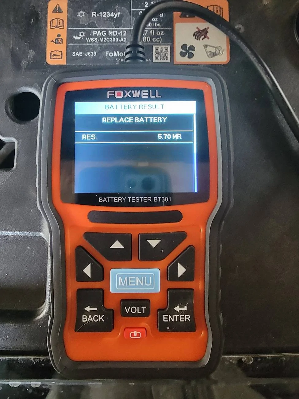

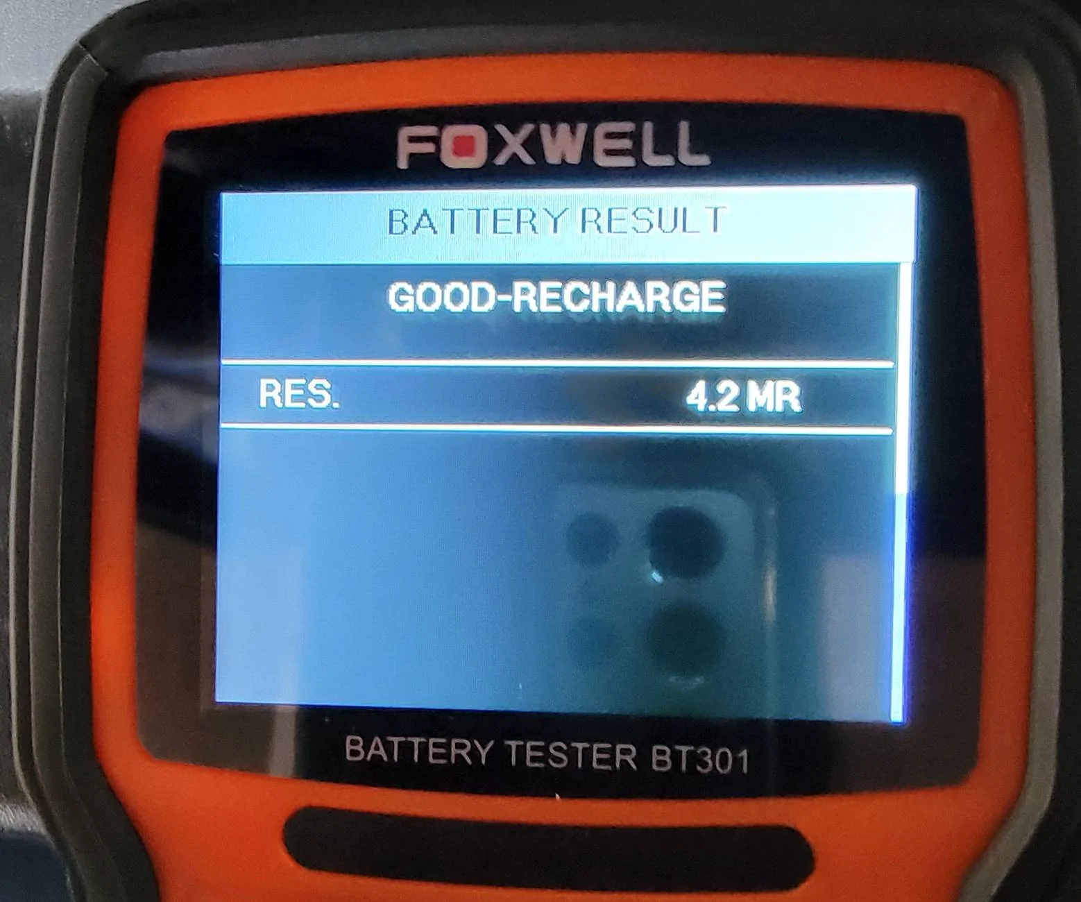

This is the resistance reading from yesterday.
The Ranger has been on the Battery Tender for close to 24 hours. The light on the BT was solid green, so showing the battery as fully charged.

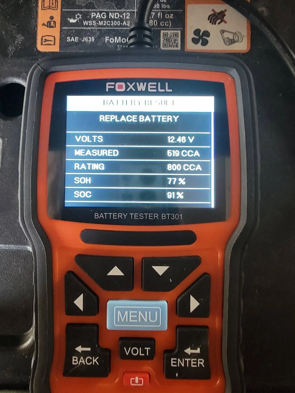

Here are the results of today's test.
So now my question is: "Does the desulfator I've ordered stand a decent chance of restoring this battery?", keeping in mind that the only issue I'm having is FordPass shutting down the remote start. I can live with that for a bit if it means not having to buy a new battery.

Looking better. Run the desulfator again and again until you get the IR down into the 3's and the CCA's up to normal.

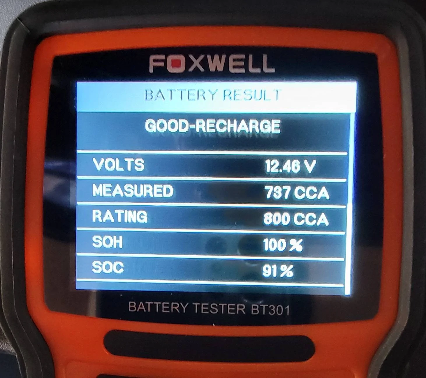

So the desulfator hasn't arrived yet, but I've kept the Ranger on the Battery Tender Jr. I also drove it around 30 miles on the highway today. Here are the readings after getting home.
I guess the short trips around town a few times each week are tough on the battery and just keeping it on the charger is all that's needed. The ASS and remote starting haven't been a problem since I started doing that.
