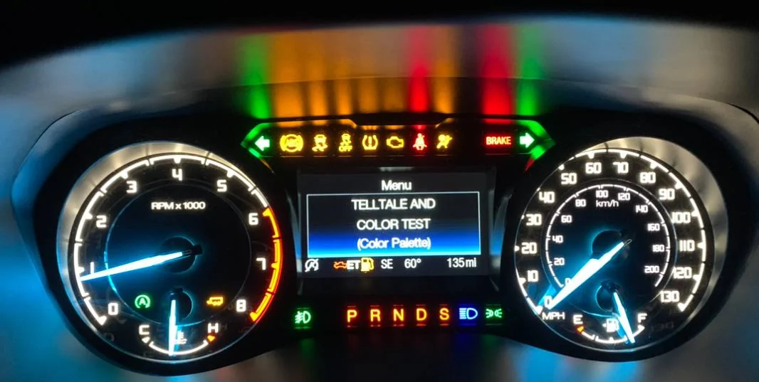

Idk if this helps but this is every light in the dash at least on a 19 xlt (used engineering test mode after buying the truck what seems like forever ago and grabbed some pics). Is it maybe one of these (though the only two red ones are the seatbelt and parking brake indicator it seems)
You know I forgot about E Test Mode, you know that might work but the manuals call out - Rolling Indicators, so some positions can be multiple indicators or colors, but it’s not very detailed on that description, so IDK if that means per programming of that space or will that space provide multiple indicators
I didn’t even think about that either when I was reading this and all the other replies. I know on my middle screen that bottom row seems to be pretty consistent though with placement.
the only thing red and angry I’ve seen take over the whole screen is the collision pre-warning alert but there 120% chance that won’t be mistaken for anything but. That goes off like the 4th of July until the sensors stop sending the alarm through.

Well, I used my scanner and commanded ALL Dash lights on, there is not (1) single light displayed that has not been covered already
