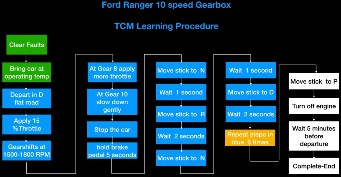

Here's a pretty good "Owner" video disccussing the 10R80. It consists of a rudimentary, but very good overview, and how to follow the TCM learning procedure. Worth the few minutes watch.
Here's a copy of the chart from his video. It is the same Ford previously mentioned and it helped in smoothing out my transmission after my fluid changes.
Ford Ranger 10 speed automatic gearbox issues and fixes

Understood. I had changed my transmission fluid earlier this year at around 48k miles. I didn't, however, do a "relearn" on the control module, which could, or would've probably helped kick the bucket down the road. But I knew I was going have to get Ford to cover it before it was too late. (Counting blessings on that one). I got the truck back yesterday and it's shifting perfectly. They overhauled just about the whole transmission (adding the newer version of the clutch drum being the main task) to include replacing the old valve body with a newer revision. I'm just saying all this, so you have extra info if you do ever decide on your own repairs. Interestingly enough, there is a full recall on the 2024-2025 F150 and Ranger to replace the valve body in the transmission, so the vehicle can't accidently slip into gear. Well, good luck in your decisions. We all like our trucks and get attached to them. Oh, and yea, don't think I didn't do a nice walk around on the Ranger Raptor parked nearby. I don't know if my thumbnail shows up here, but I have the 2021 Tremor version and I love it.
