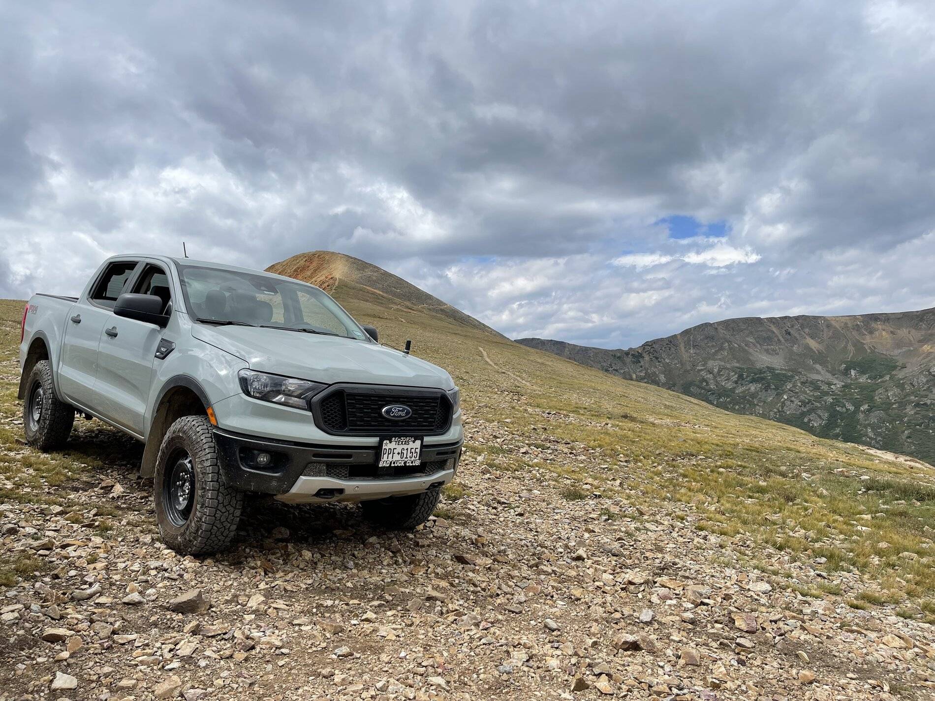

I can speak on Falken Wildpeaks for dry use highway only.. They perform amazingly on highway for "off-road" mixed tires. I did not notice a sound increase and they perform pretty much the same as the factory handkooks from speeds of 90mph+ which gives me confidence in their highway ability. It has not rained, nor have I gone towards the mountains for snow and I have not yet off-roaded in them since it has been quite warm out. Wish I could offer insight on these Wildpeaks for those situations. Amazing sidewall tread design though...
Nice looking tire. I just ordered them from a local shop, as I dig the way they look and the performance between the Coopers and those are very close from what I've read. $880 out the door with alignment, disposal, and everything. Not bad at all. Thanks for the advice! I'll update here after I've driven them for a bit.

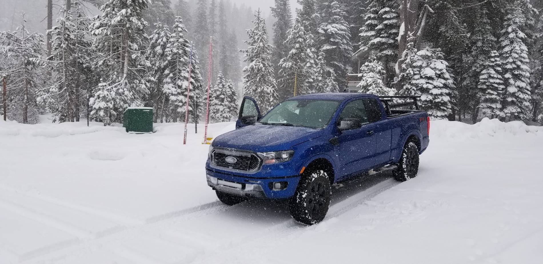

I had the Falkens last winter and ran them up into the snow several times. They were outstanding there and in hard rain. You'll be pretty happy with your choice I'd bet.

Man....that looks awesome. I have the chrome package, but I always regret it when I see those black sidewalls and black rims. Beautiful truck!
