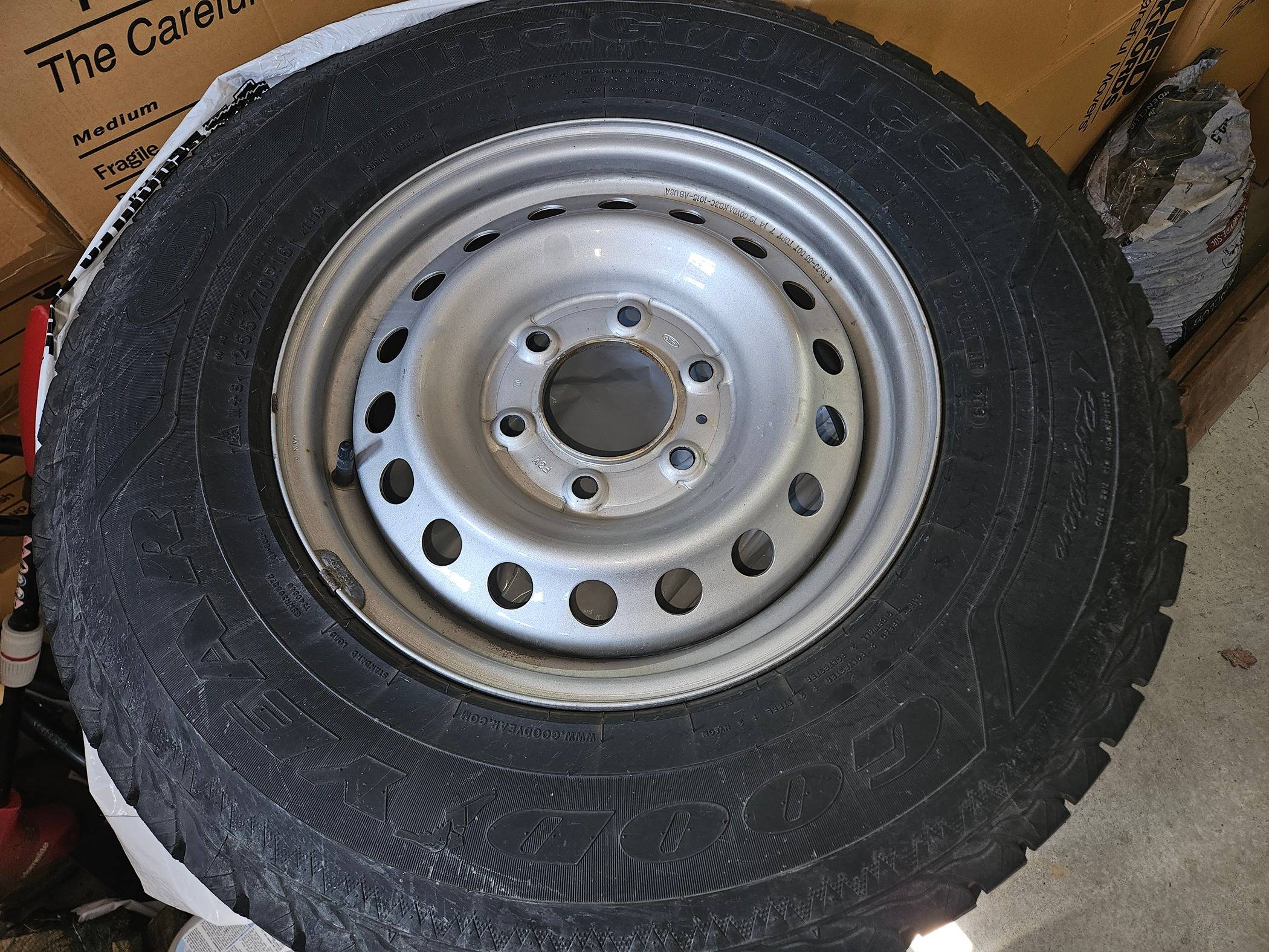

I had the dealership throw in a set of winter tires on steel rims, as I picked up my truck in Dec.; they gave me a set of Goodyear Ultra-Grip Ice, sized at 255/70R16 (my summers are the stock 265/60R18s):
I'm a little south of the Ontario snowbelt, so ice and slushy roads are more of a concern than snow, but these have worked quite well for the past three seasons. They're designed to incorporate studs as an option, but I don't have them.

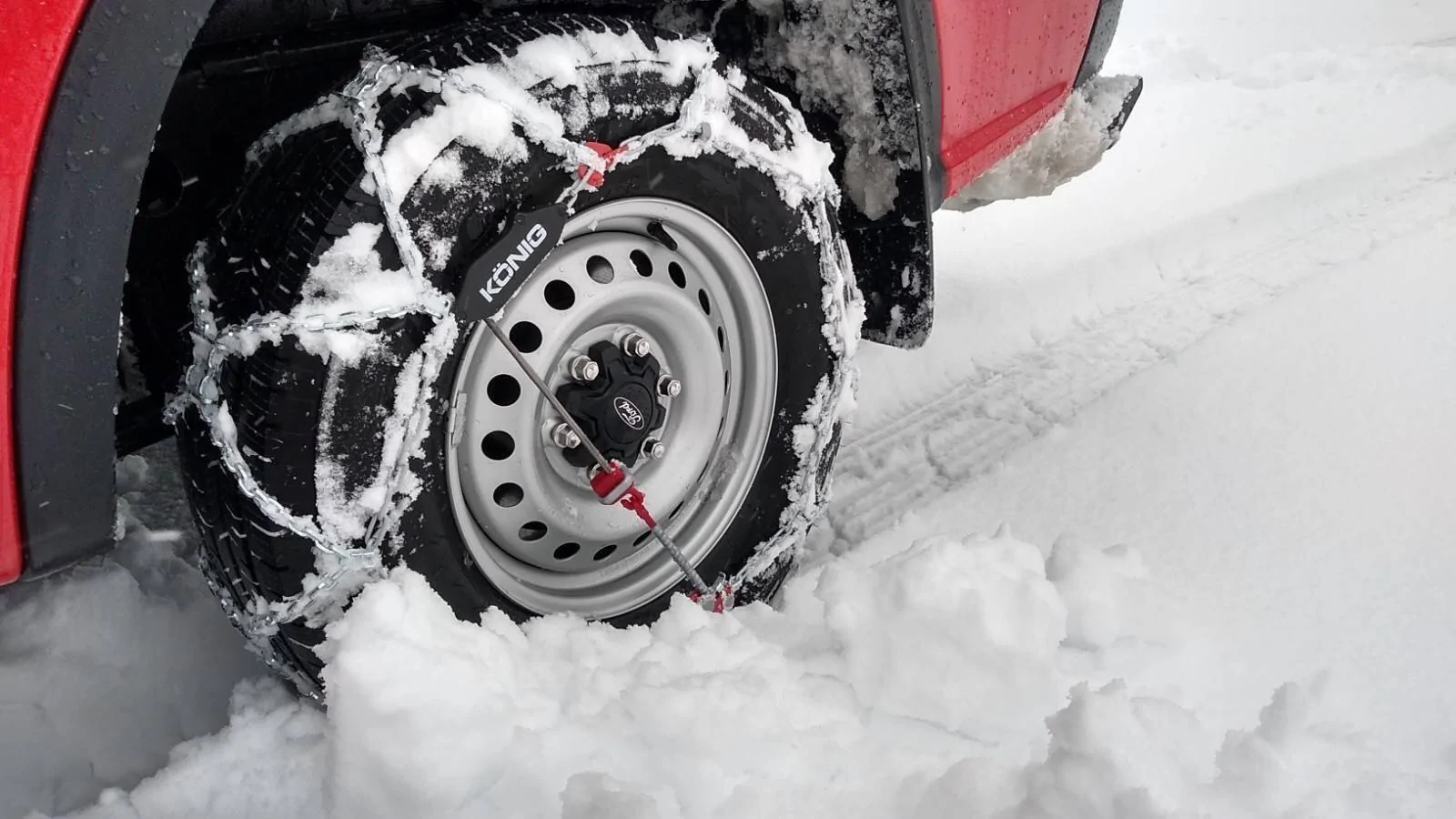

I'm also RWD and use chains for local driving, as needed.

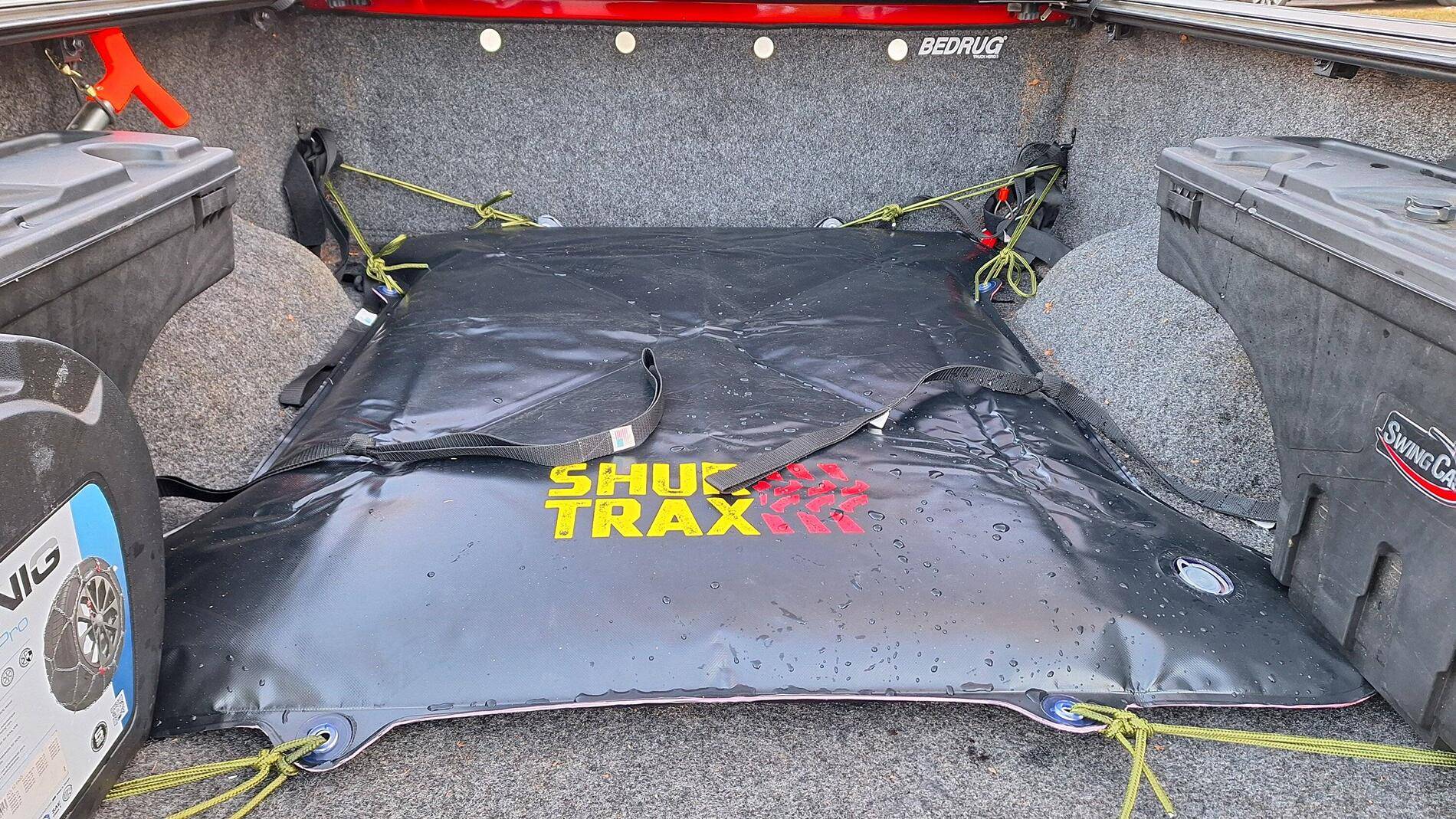

And because of old, abused, and painful shoulders, I no longer use tube sand but have this kooky thing for winter weight. It worked very well for last winter.
https://www.konigchain.com/shop/us-en/konig-xg-12-pro-1.html
https://www.amazon.com/dp/B000BV9MA2

Hey thanks for your reply! So, the water weight bag looked like a great idea at first when i saw your pic (and i really appreciate that!!) but my Ranger has a short short bed and wheel wells are almost right up against the rear cabin wall, so it likely would not fit correctly at all. So, gonna go with the sandbags (8 or 10 x 45lbs) this year. We'll see tho because my old, worn out back won't likely be able to do that for the next however many seasons either.
Sorry, I missed your response. It's 56" long, so it would fill your bed more. I have enough space for a row of plastic grocery bags. It's is slanted, so a second row of bags sit on the edge on mine in the Scab.
Nothing wrong with sand, it's my shoulders and back that complain. =)
