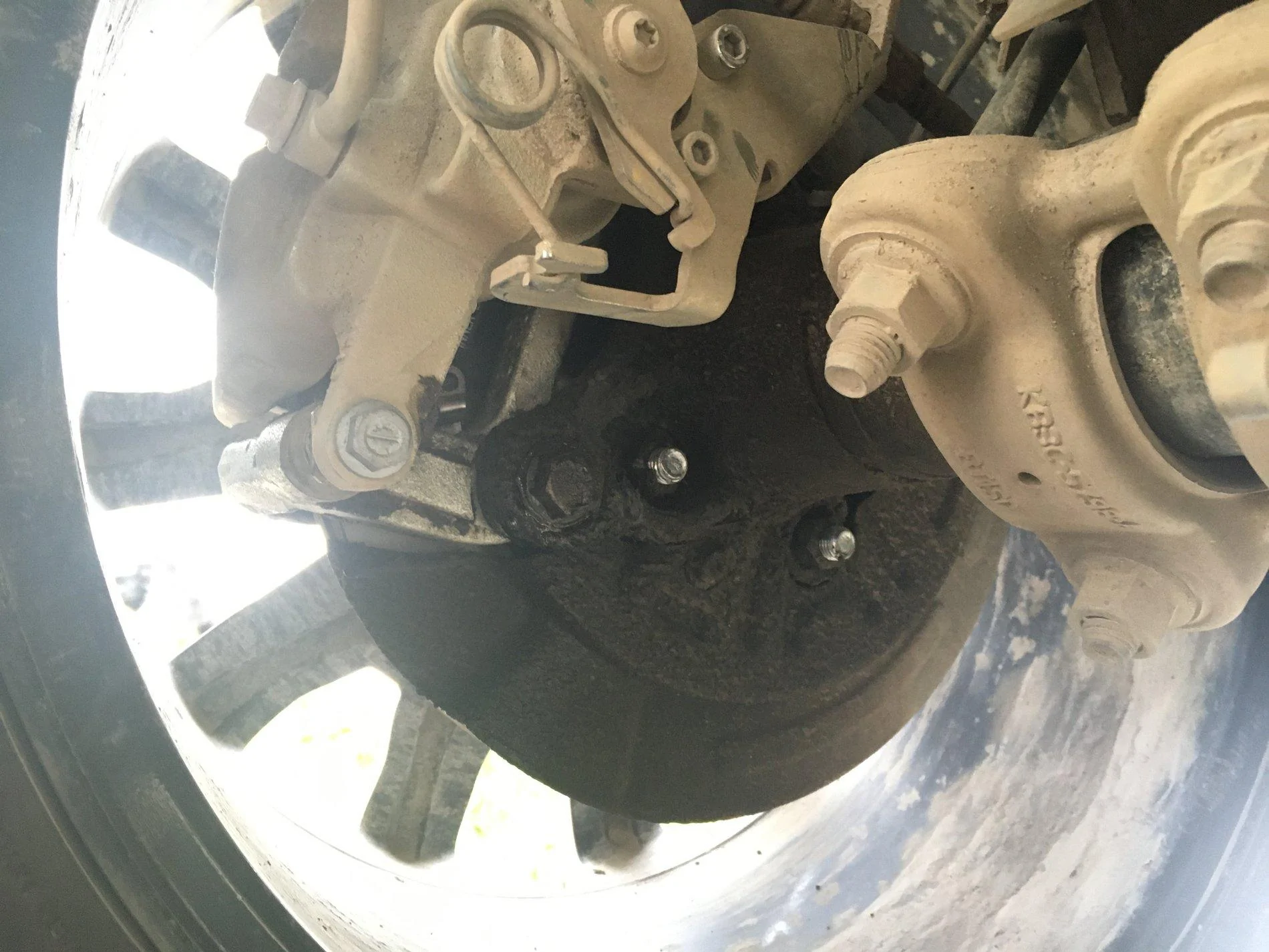

They didn’t even bother to clean it off...

Update on my truck. I would have liked them to replace the rotors too, but I wasn’t willing to argue about it. Should it happen again, I’ll be in fighting mode. I’ll take more pics of the axle when I get home.
Glad they got it fixed up for you finally. I would still keep an eye on it to make sure no more issue arise. New rotors would have been nice I guess, but if they machined them properly they should be just about as good as new minus the .010" they took off.

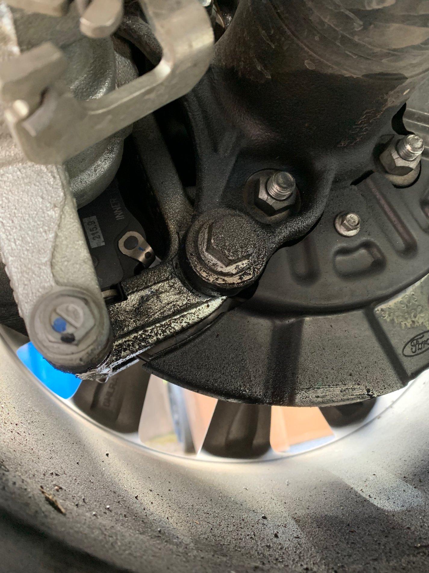

My driver rear axle seal is leaking now when I just went underneath to put on Eibachs I just noticed it. I am supposed to leave town Thursday so this is even more frustrating.
Post a pic to see how bad
I was in the same situation. Took it in and told them I had a trip planned and they examined and said I would be fine. Drove it from So Cal to Mt. Rushmore and back no problem, it is still leaking a year later, I'm waiting for it to get all gummed up before I take it back in to ask them if they really think it is residual

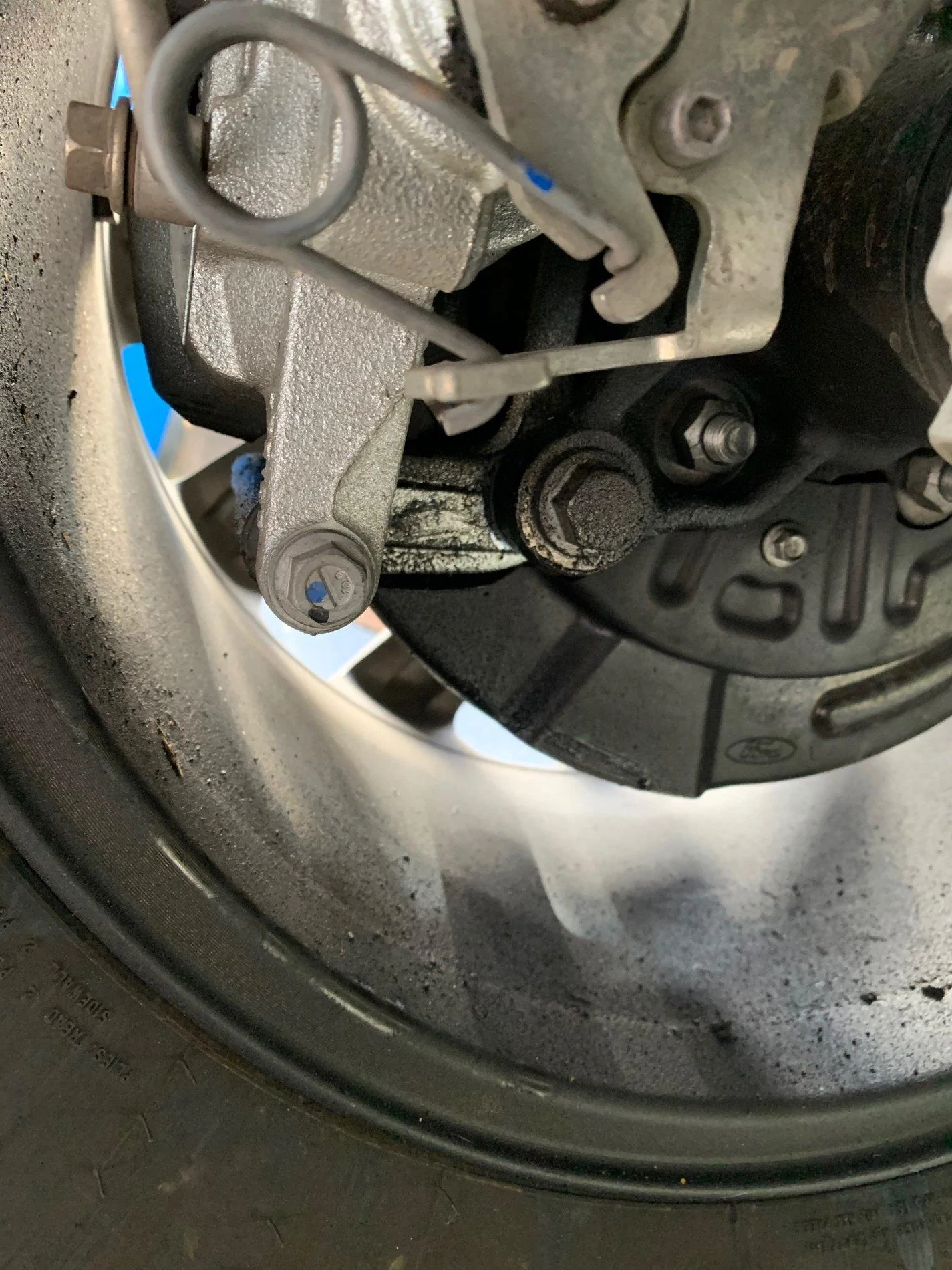

It didnt seem that bad, but for 4k miles i was pretty upset when i saw it. I am guessing the level didnt even go down 1/2 oz or so. I brought it to the dealer at noon yesturday, they tore it down and ordered the axle seal. Its supposed to come in today they said it would be done tomorrow. They put me in a rental for free and said i can go wherever i want, so i cant really complain.
Looks like mine. Seems like you got a great dealer too

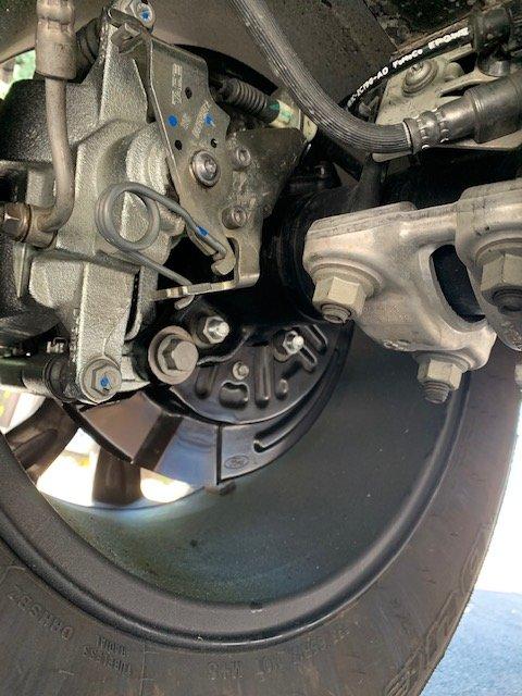

Just got the truck back today, according to the work order they replaced the axle seal and axle assembly. Apparently it was done in two days, i just happened to have been out of town. Ive only put a few miles on it, they put 30 miles on it, and so far no leaks.
Please keep us updated if it leaks again
Glad to hear your story is not so bad as ours
