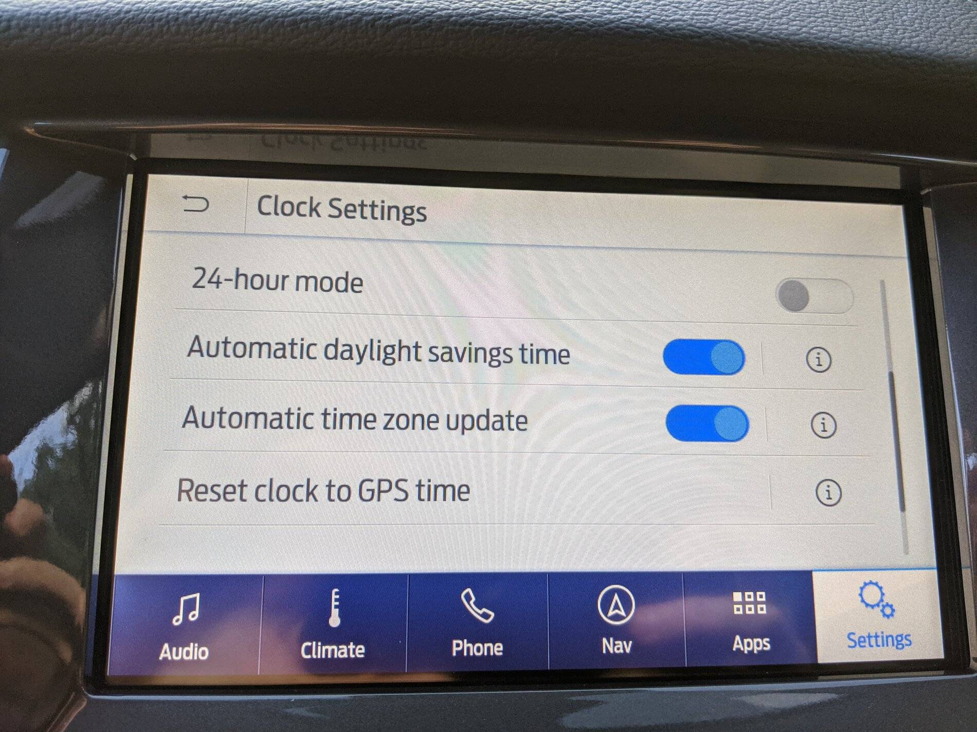

EJH
Ed
Oct 7, 2020
817
1,525
Subarus, 2021 Ranger
Here are the clock setup options on my 2021 with Nav,
