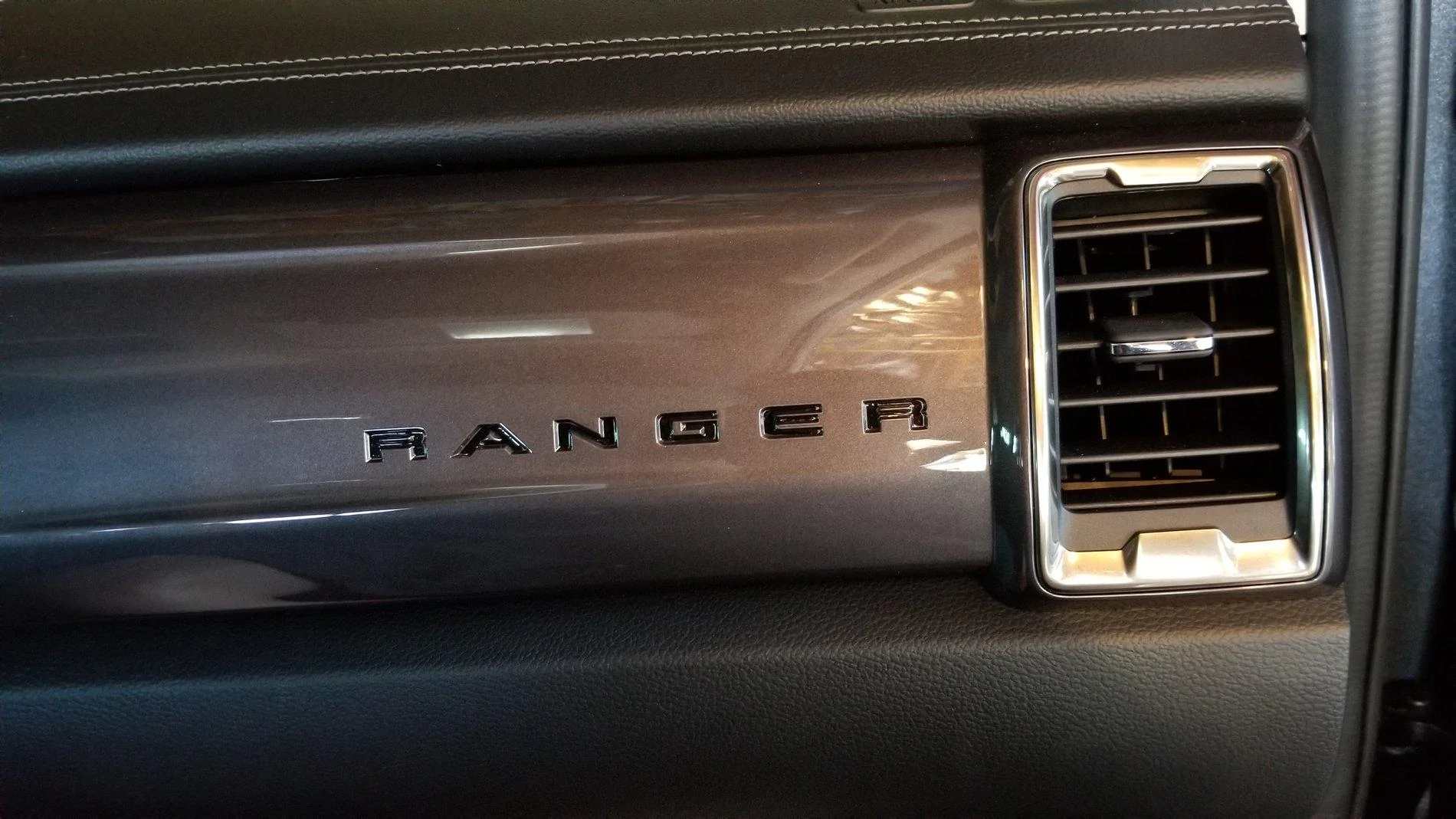

Dash inserts.

I have the dash inserts to install but every time I look at it i cringe thinking how hard they will be to install.

I have a spray bottle with water alcohol mix and spray it and apply. Once I have it where I want press and wipe with a microfiber towel.

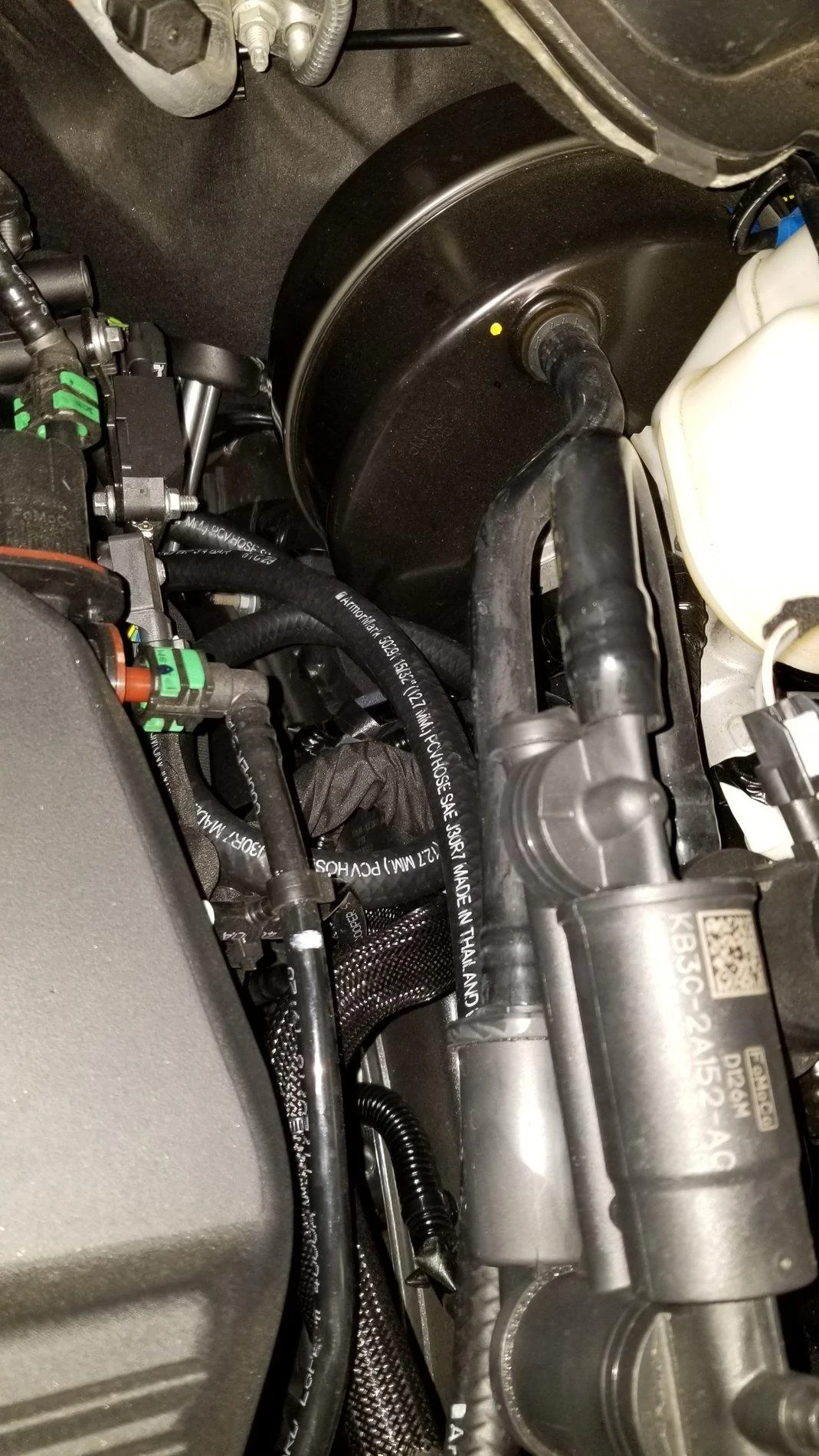

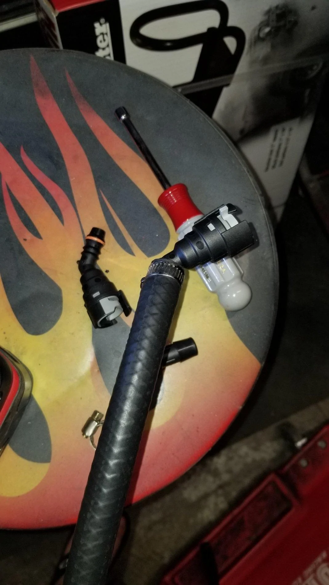

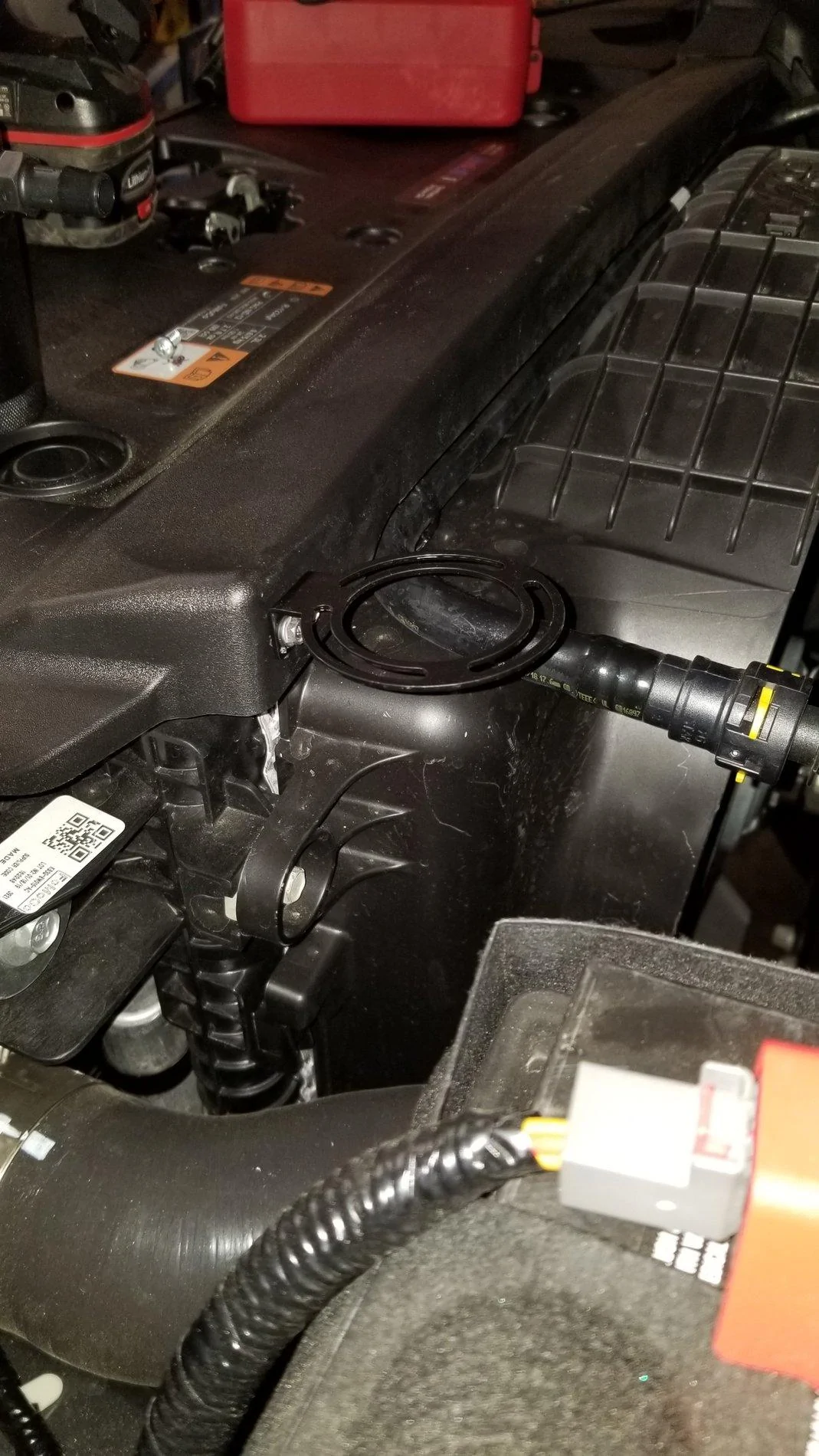

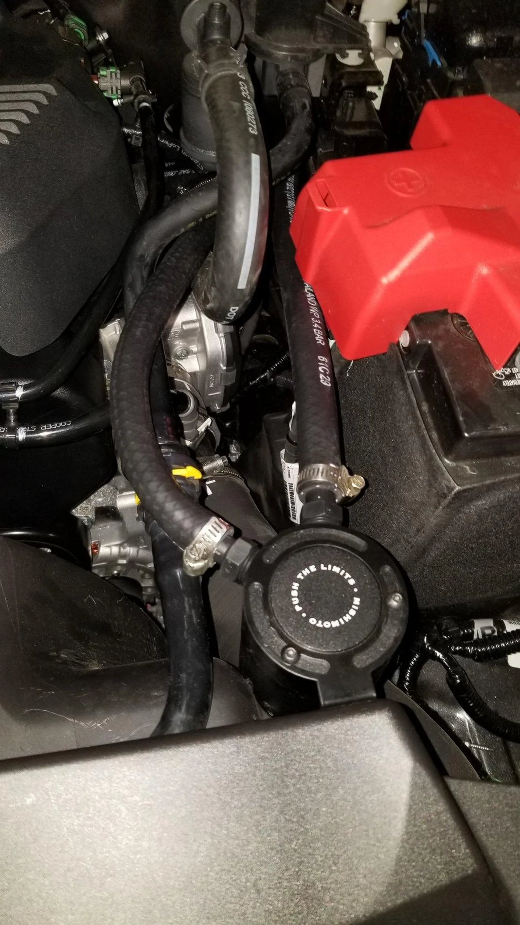

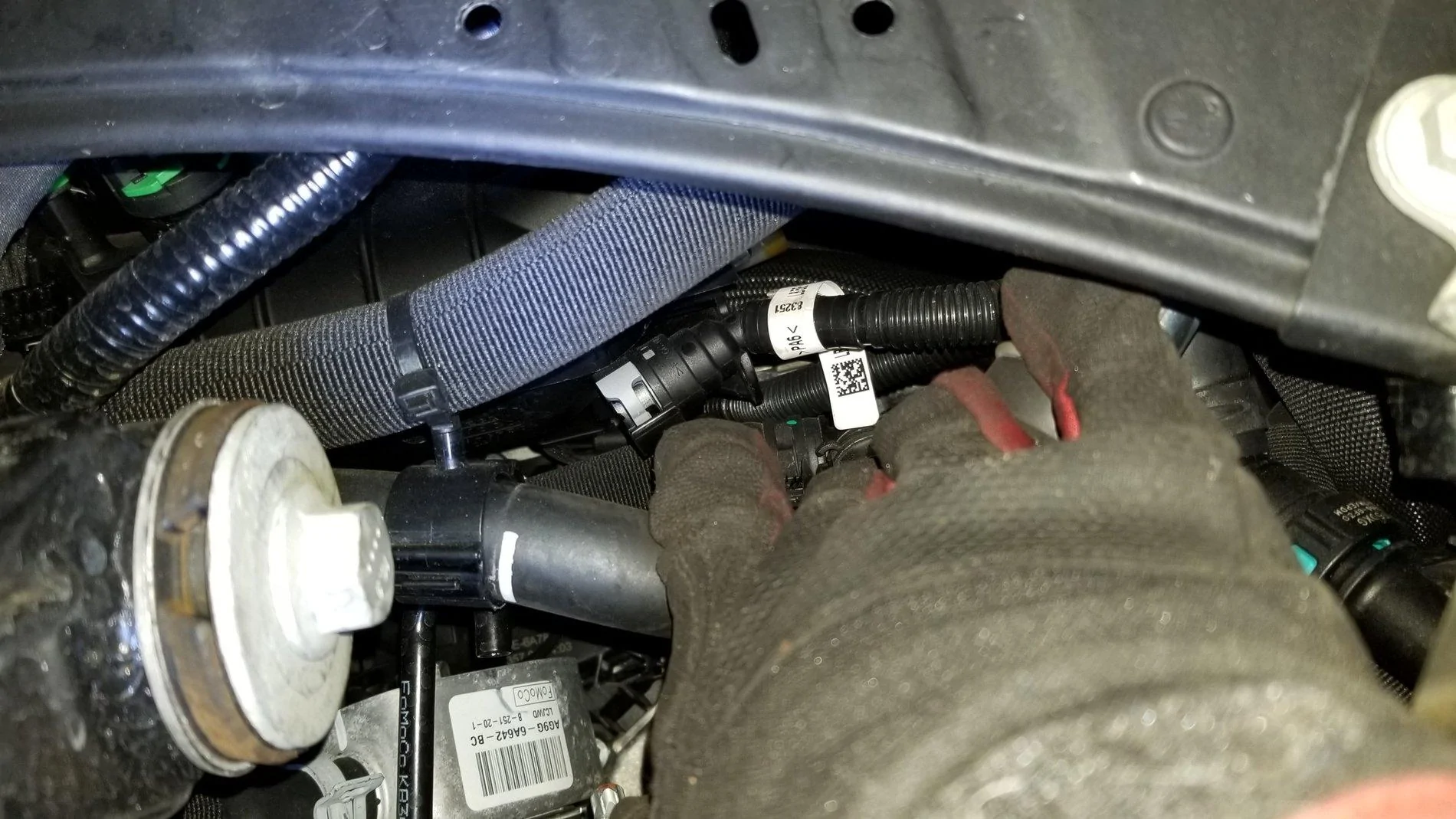

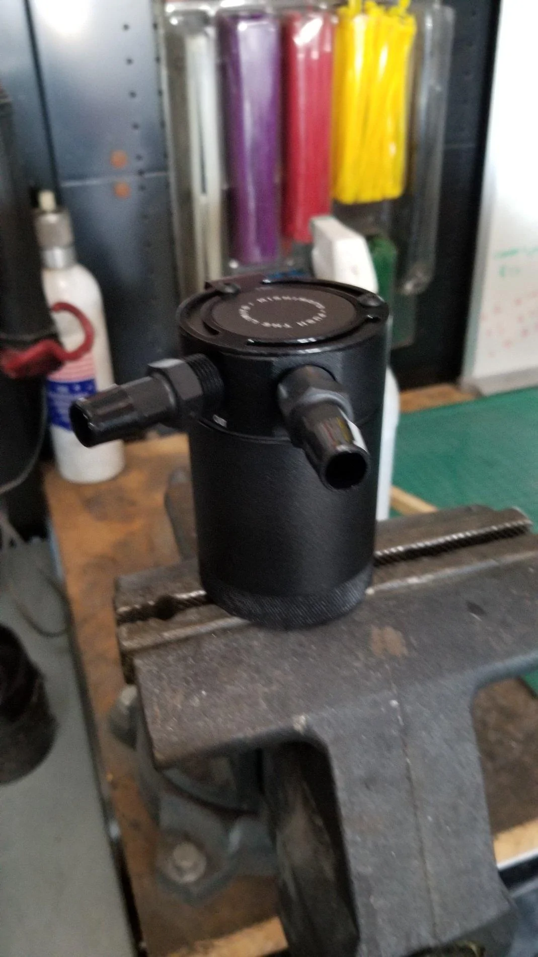

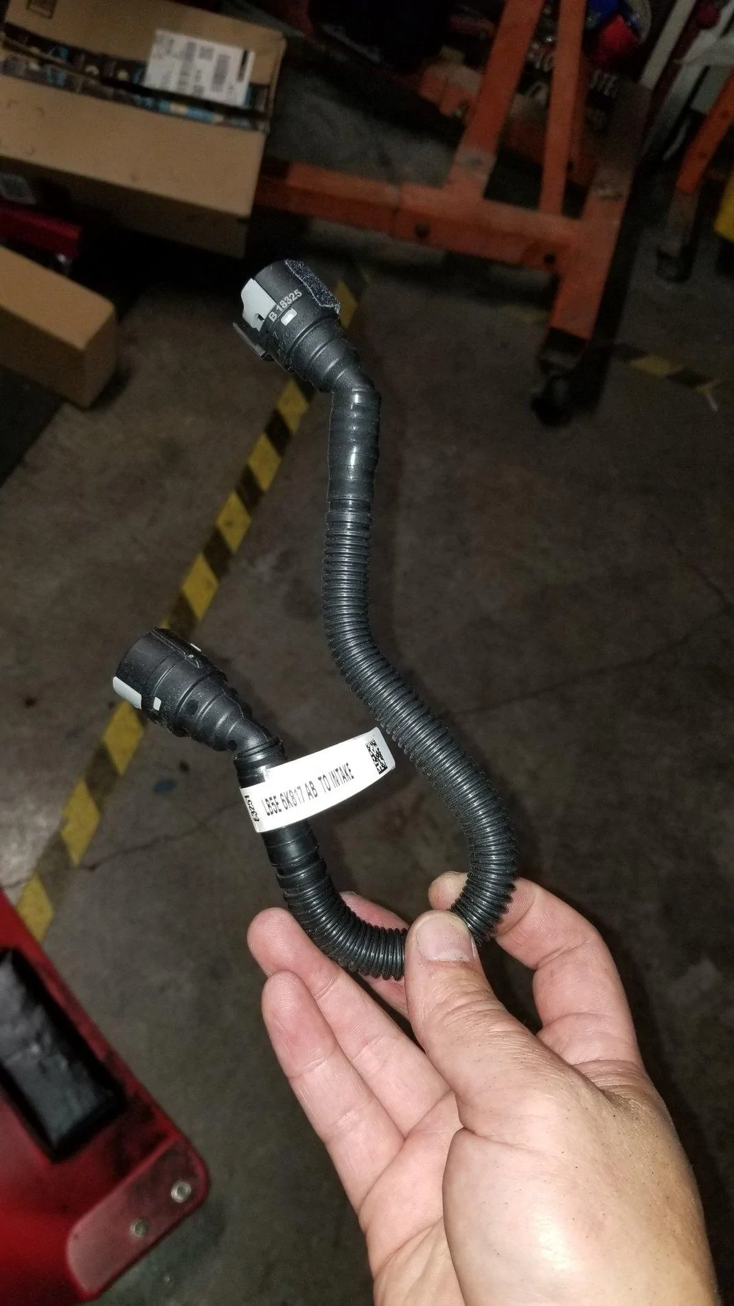

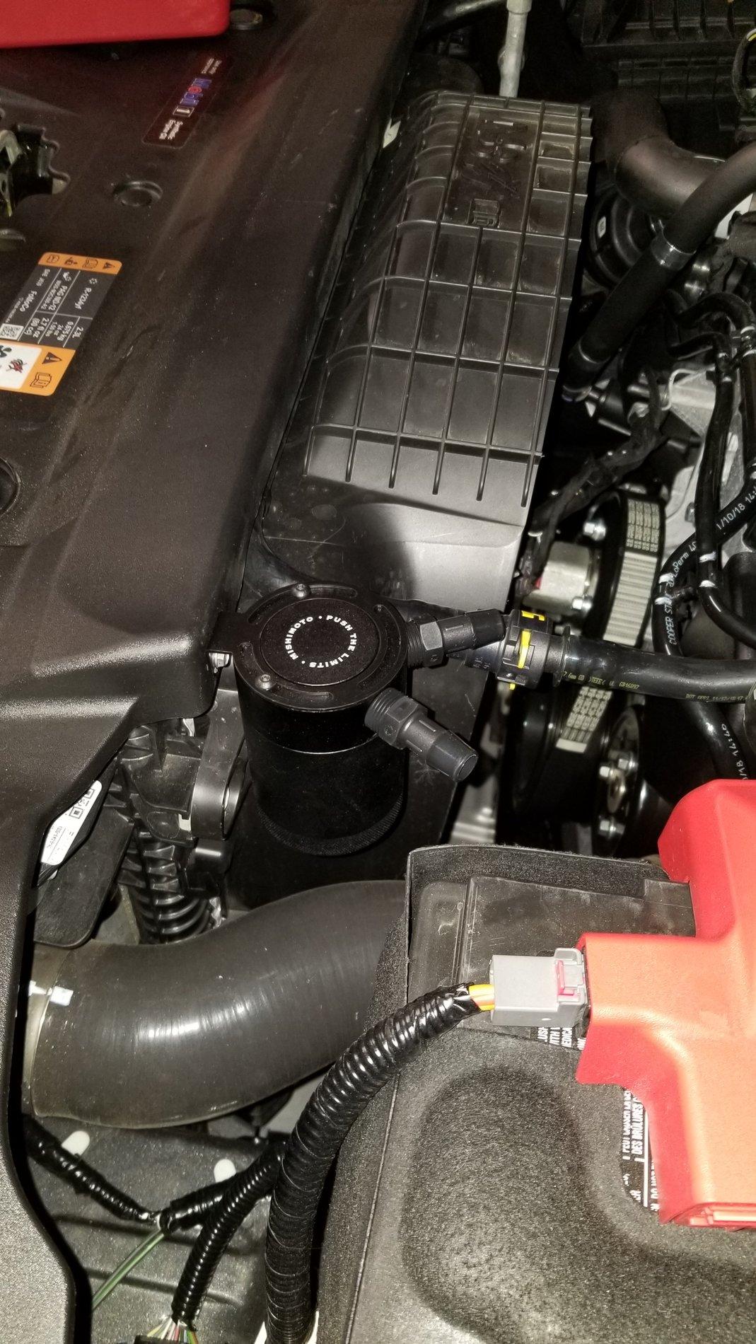

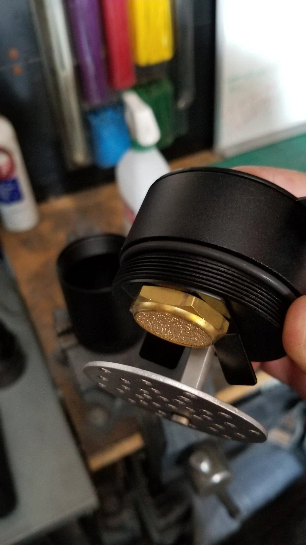

Since checking out the parts led to doing the whole installation the oil catch can is installed. Universal Mishimoto kit. I will be replacing one of the can outlets to a 45 degree as soon as I can find one to clean it up. It was way harder than a Mustang install. This is under a lot more stuff. Had to come in from the wheel well and do it all by feel. Can't see either of the original lines and the connectors.
Pull the flap just like when doing oil change.
Feel for the PVC and intake lines. Push the clips to release each side.
Remove the original line.
Use heat gun and remove fittings from hose.
I used 7' of 15/32" hose. Install pcv side first and run it up top.
Install intake side and run up top.
Connect to respective inlet and outlet on can.
As pictured I installed the can on the fan shroud. The total ran me $78.

So for clarity, you took the ends off your stock hose and used them on the mishimoto hoses? Did that end up destroying the factory hose? I did see some connectors like that available from UPR in case anyone wants to keep their stock hose unmolested.
I used the stock ends with the hoses I supplied. Using the heat gun allows you to pull the connector off.

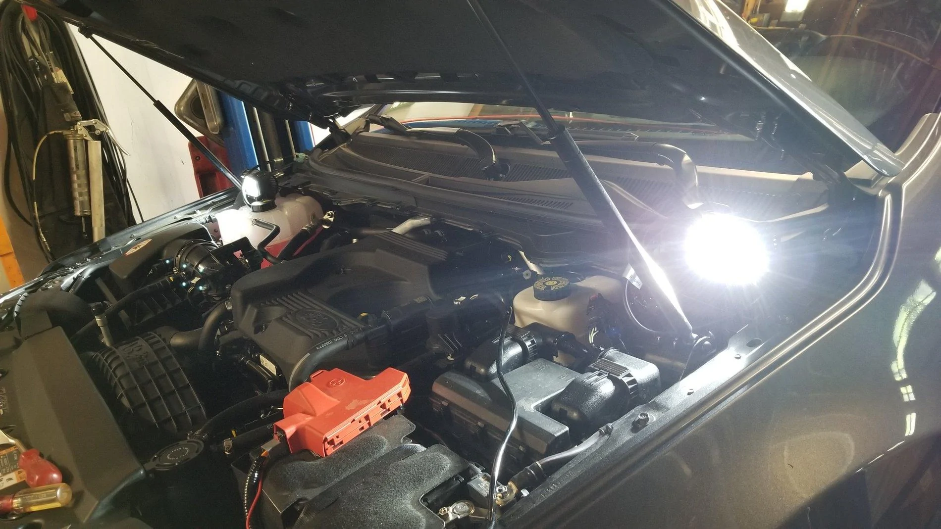

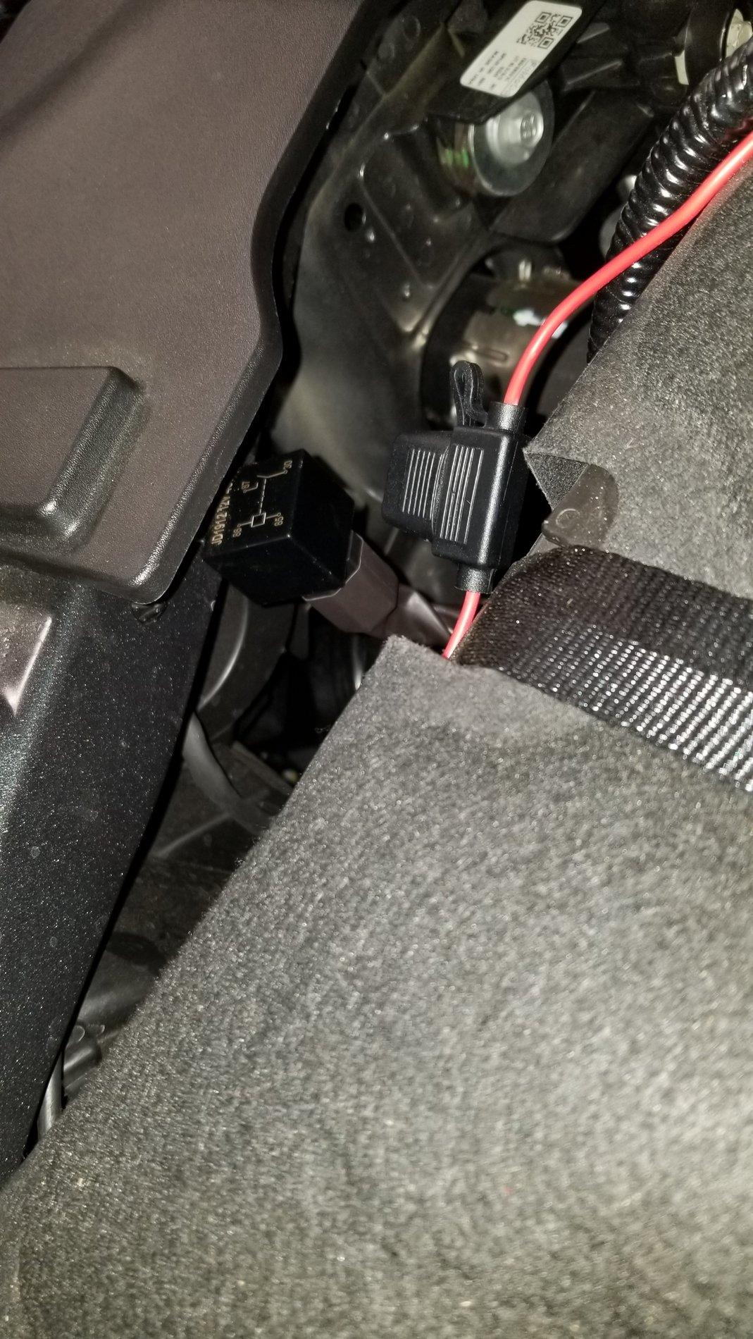

Prewired my LEDs while I'm waiting for the mounting brackets. It was a pain but I ran the wires through the main grommet that the hood release cable shares. Lightforce switch bezel is coming in the near future.
