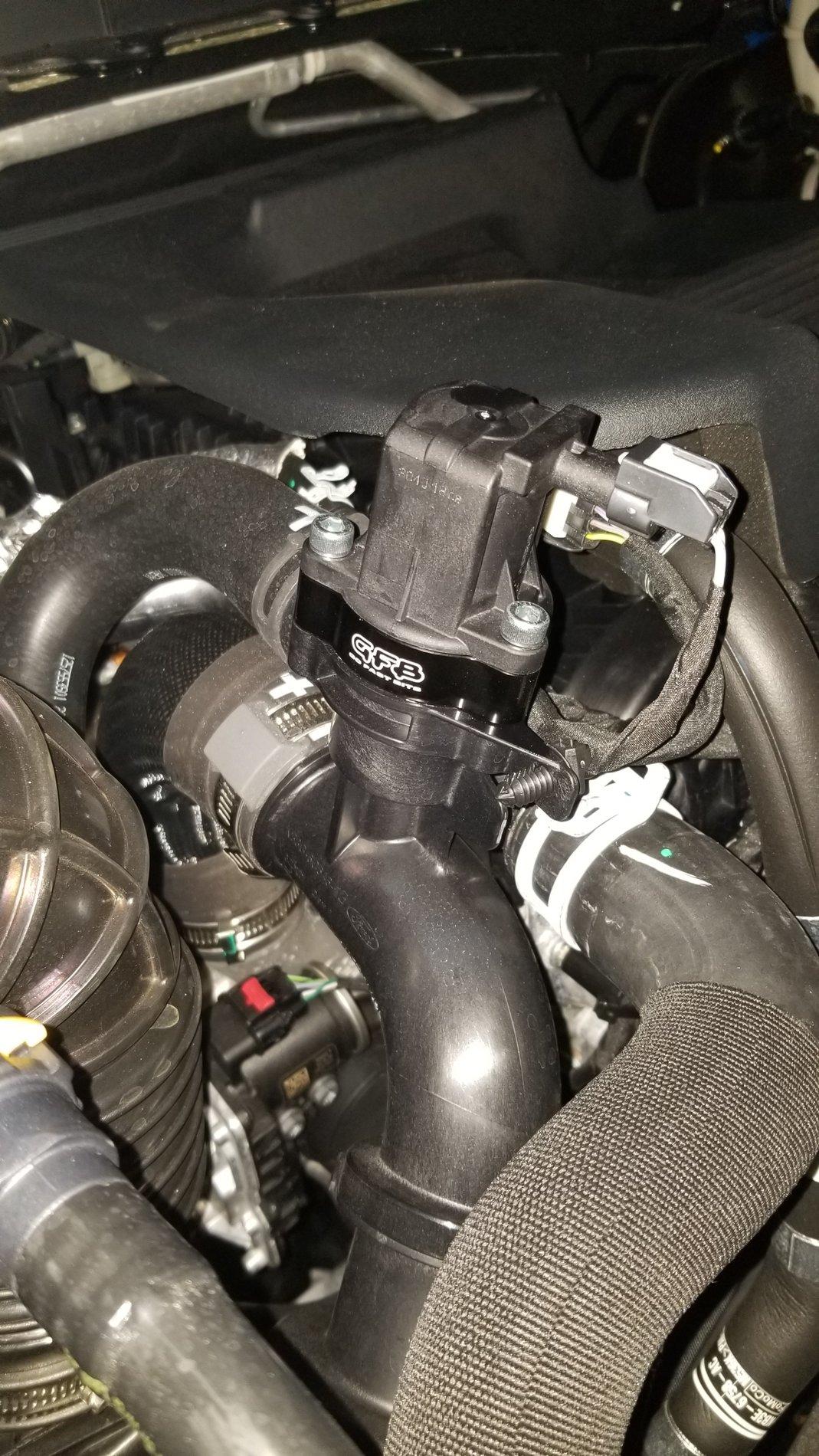

Update to the optimized throttle body. As expected on the way to work my instant MPG gauge was showing higher than normal on the same route. I'm reaching a higher speed with the same amount of throttle applied. It helping the low end as it's supposed to. I expect to see the mileage increase a bit like it did on my Fusion.
Looks like a good mod to do.. where did you source this from? Did you also do the blow off valve?

Cordova motorsports. It already have the stock bypass valve with the GFB. Anything else is unnecessary to me.

What GFB part number is that? Awesome truck BTW!
Thanks. there should be a link in one of the 2 threads for it through Panda.
Since you have some background … is this the unit that they offer for the 2.3 Mustang cause I emailed them and they couldn't tell me if it fit the Ranger..is it a direct swap?
The actual housing is the same but the electronics is different. After the TSB it did not like it at all. I had to go back to the stock one. The best thing to do is get a new Ranger one from Ford and have them port that one. I'm going to get one from Ford but I'm having it bored out to 64.45 mm. Stock is like 58-59 mm.

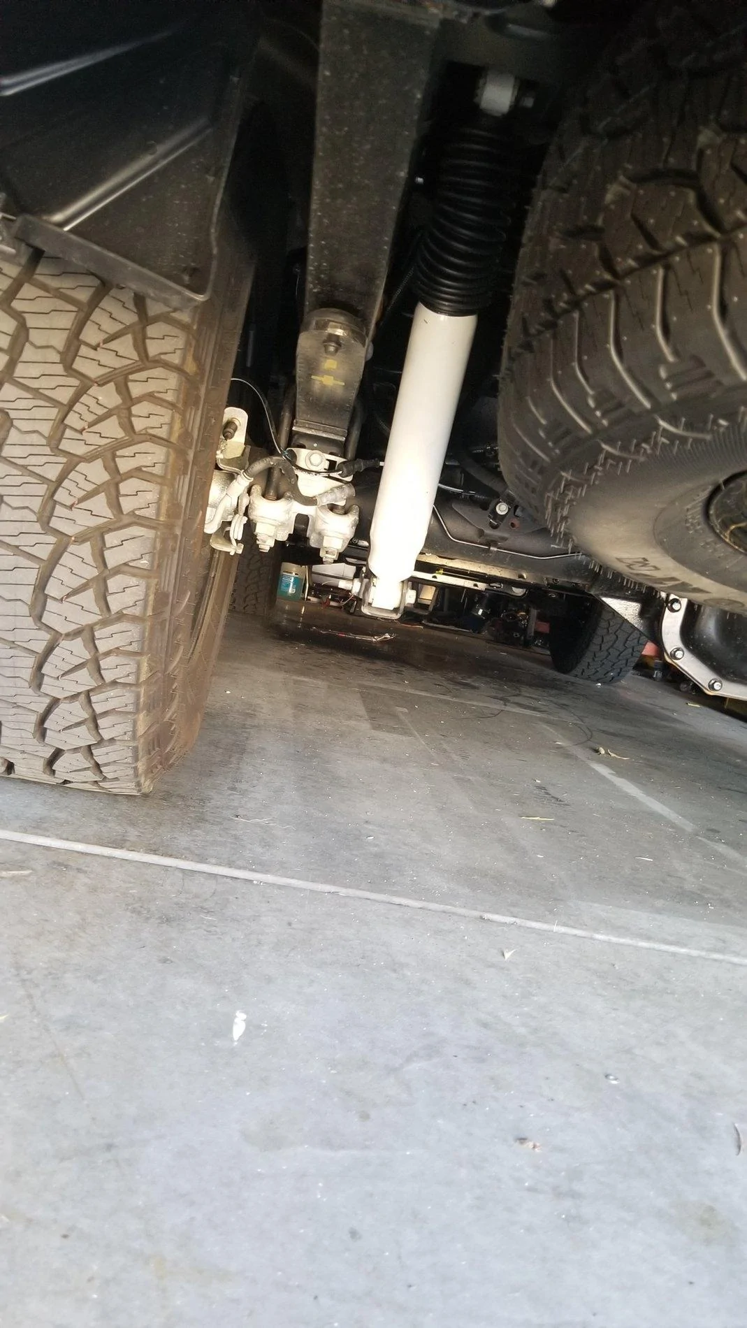

Installed a set of Fabtech rear shocks. Took away some of the stiffness compared to stock. It matches the front more now with the leveling kit. Not as jarring. FTS7265 and picked up a pair of Pro Comp shock boots as they don't come with any. 20 minute job max.
