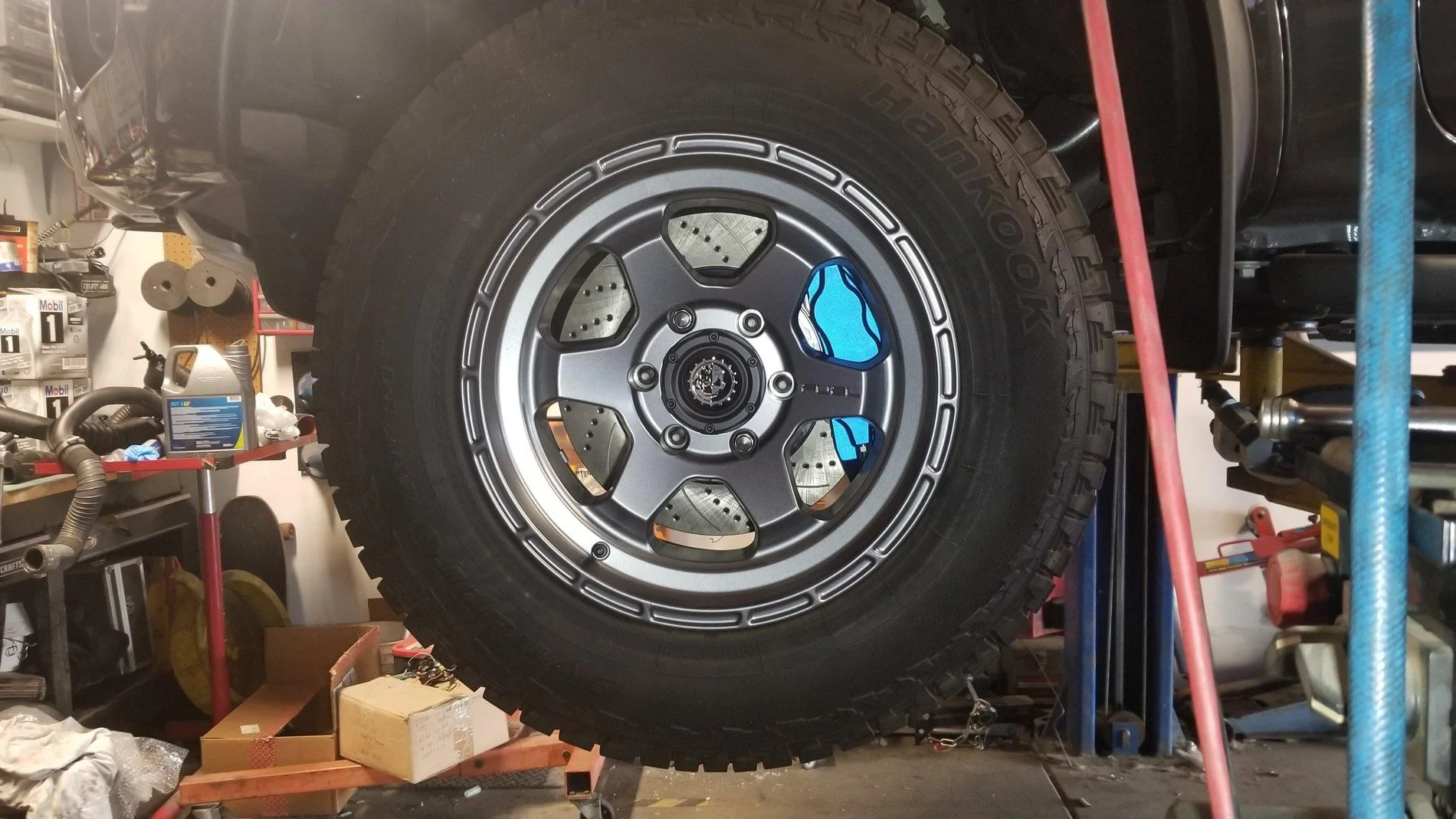

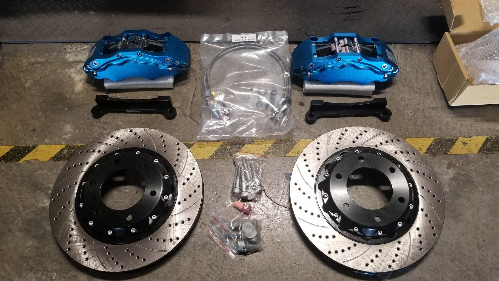

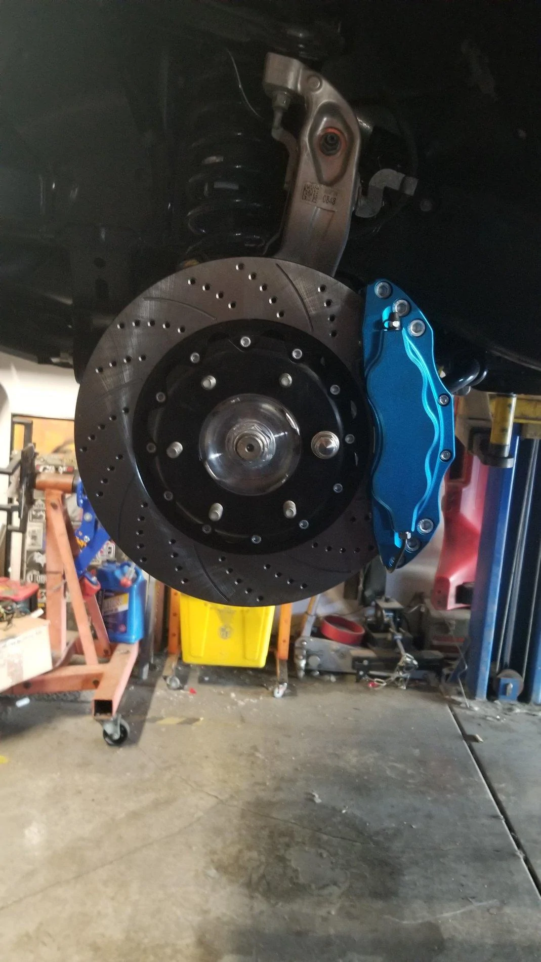

Finally got the kit but being the first NA Ranger it turns out the mounting bracket is different than the international model. New brackets are being made.

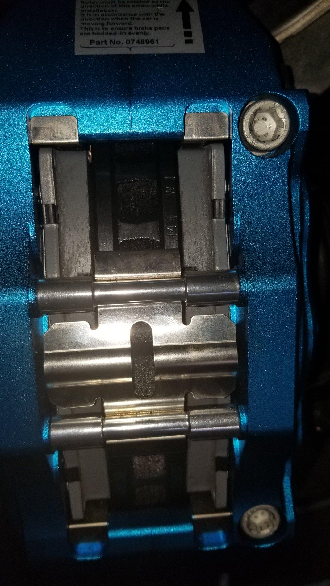

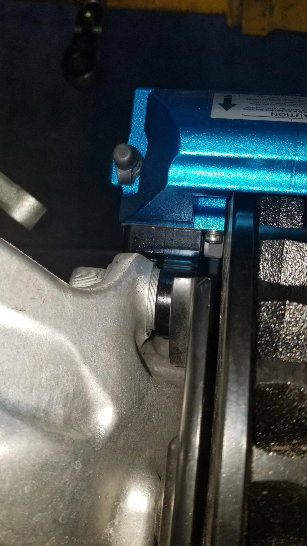

Finally got the different mounting bracket. Still had to shim but was able to shim this time to center the caliper. The worldwide Ranger is a different brake setup. The bracket that came for the worldwide version couldn't be shimmed in the correct direction. Stops better obviously and the pedal feel has firmed up a bit and doesn't feel as vague or spongy. Would like it to feel firmer so I'll see what rear braided lines will do.
Since its been 5 years... how are you feeling about these brakes? Still performing good for you? I'm starting my big brake kit journey and would love current feedback.

I've had zero issues. Still got good pad life left.

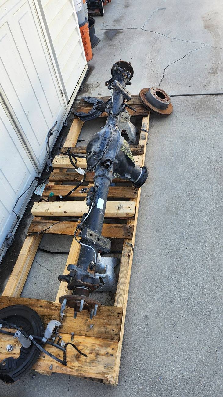

Stock replacement rear axle made it. Prepped and ready for install tomorrow. 4.46 rear and soon front will be ready for straight up sale. It'll come with super low mileage rotors and the ARB diff cover.
