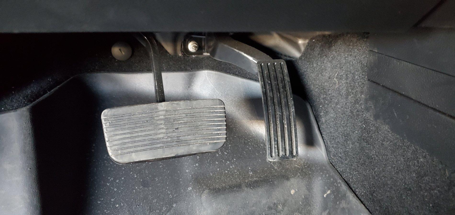

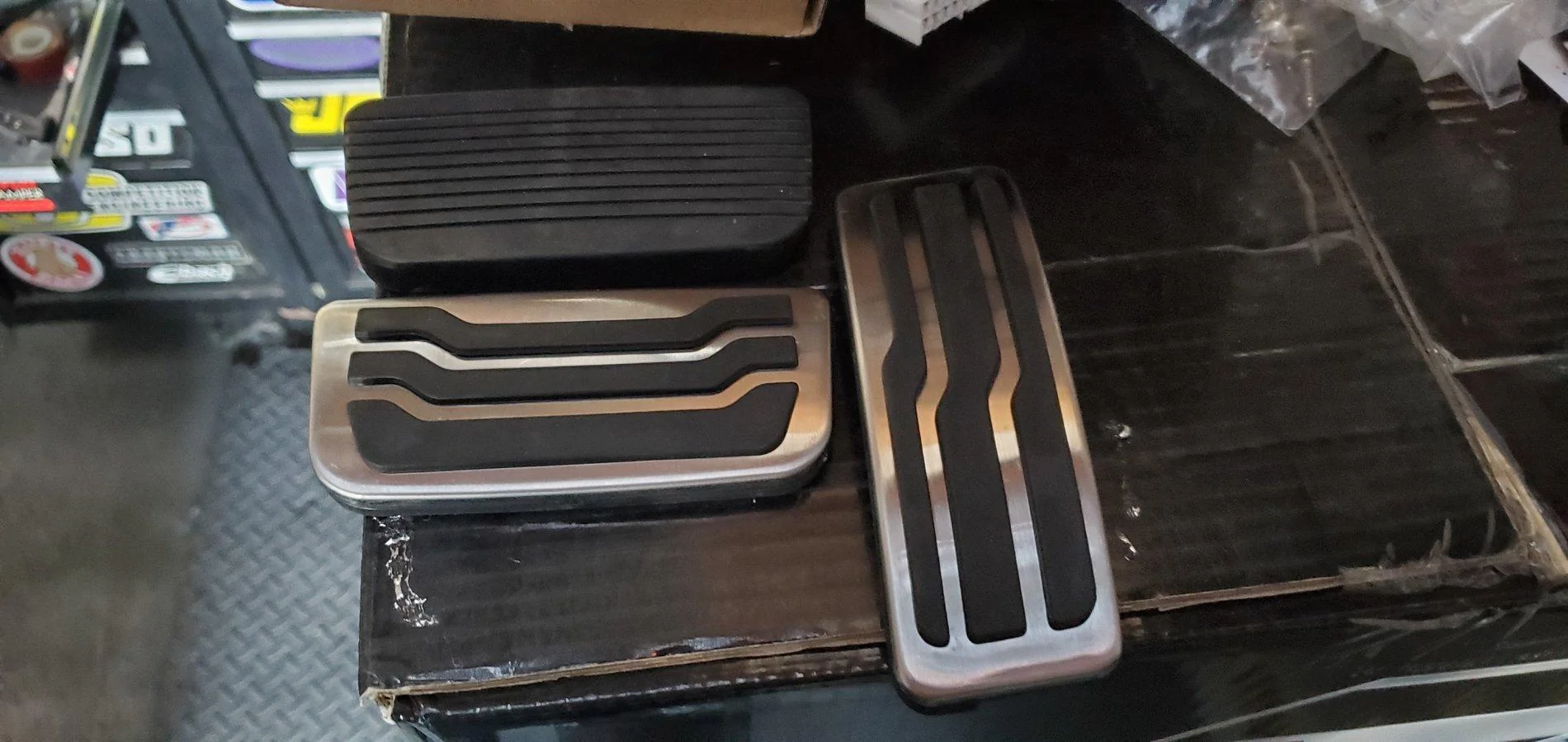

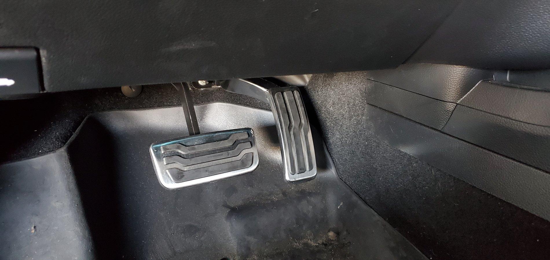

Snazzed up the pedals. The brake pedal replaces thre stock rubber pad and the gas goes over the stock pedal. Got a few extras if anyone is interested. PM me.

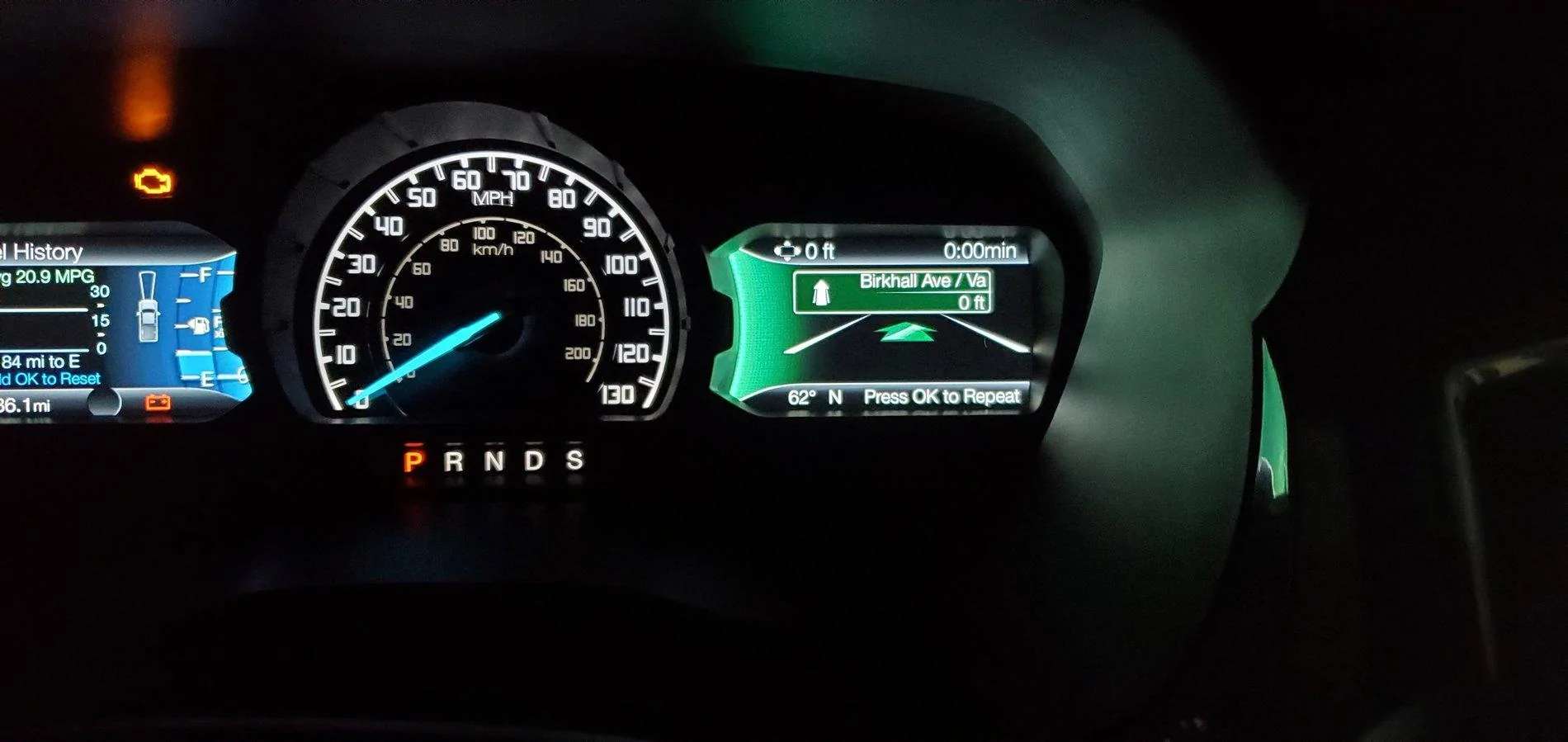

SYNC 3.4 19101 build successful. Google maps directions now show up on the productivity screen as well now.

Everything was as the instructions indicated. Just ignition on but I had the battery tender plugged in. The truck was less than 30 mins because of the larger file with the nav. My Fusion was less than 20 mins. Everything is there that was there before including the climate. You just download file for USB1, choose the file for USB 2 depending on your configuration, turn on the ign, plug in 1, remove and plug in 2 when it tells you, wait till 2 says it's done, unplug and it's pretty much done.
